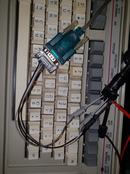

I have tried "inputattach -lk" with the MC7004 keyboard, with a converter like above, and a 12V power supply:
The result is not great, but it's also not a complete failure either: After I press a key, I do see the correct key being typed in linux, but the key is never released, so the os's repeat function comes in, and I just get a long string of the pressed key. This could have multiple reasons:
1) Maybe the MC7004 is only kindof compatible with LK201, and maybe it's missing some features. I think this is the most likely.
2) Maybe my MC7004 keyboard is damaged.
3) Maybe the inputattach code is buggy and needs some modification.
I think 1) is the most likely, so it will probably work fine with a real LK201.

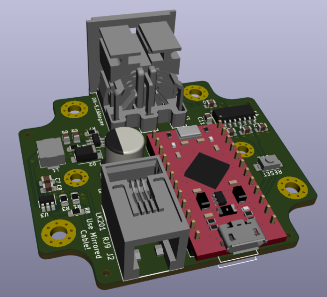

I also started a little project to make a converter for LK201 and MC7004 keyboards, that would show up as a USB keyboard to the host, and that you wouldn't need to run software such as inputattach. It's basicly a pro micro + max232 level shifter IC + a boost converter:
It got as far as ordering some PCBs from JLCPCB, but my first prototype didn't work as I expected, mainly because of the current consumption of the keyboard. I ordered the pcbs before even receiving the MC7004 keyboard. Looks like the LK201 is specified to consume 350 mA, and the mc7004 was specified to 500mA, and my thinking was: no way can a keyboard consume so much current @ 12 Volts, it must be less than 100mA, so I can use a boost converter to drive it off of a single USB port, and I just ignored the spec, I didn't believe it. Lesson learned, when you don't follow the spec, you support the consequences. The MC7004 keyboard I actually measured to consume 340mA. So there's no chance for the first version of my project to work.
So I temporarily left it there, at some point I will pick it up again, and make a version of it that requires an external 12V power supply. Or maybe I'll just mod a few of the boards to remove the useless boost converter, and add a DC jack. I just find it annoying that there's no way to convert it without an external power supply.
