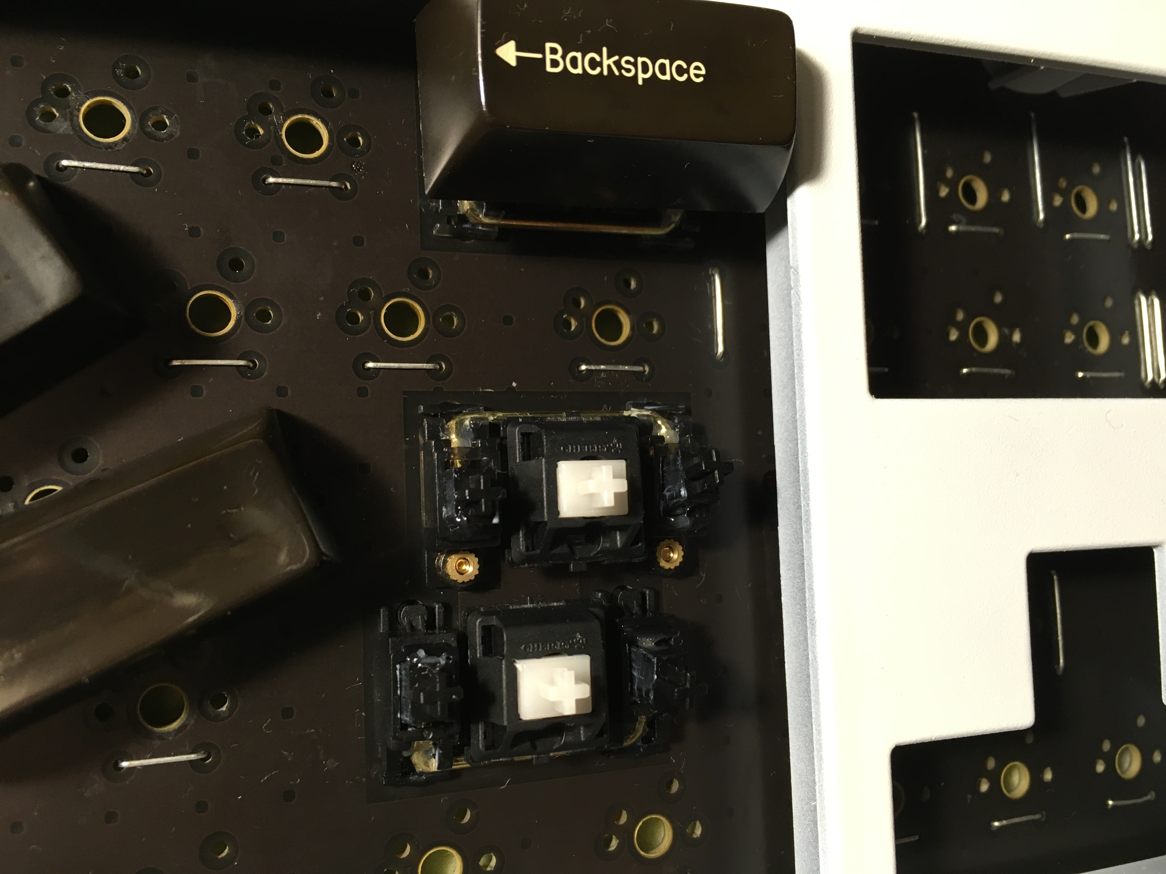

I got one of the G80-3000 with such switches , as for me very heavy springs . I think to replace it with 45g . does anyone use these switches as the main ones? ( In stock or converted ? )
- IMG_0193.JPG (1.83 MiB) Viewed 7427 times
- Elrick
- Main mouse: MX518
I've got a collection of ClearMX switched keyboards (stock and converted) that only I use.Jack/> wrote: 27 Sep 2021, 02:52 I got one of the G80-3000 with such switches , as for me very heavy springs . I think to replace it with 45g . does anyone use these switches as the main ones? ( In stock or converted ? )
The kids are always moaning about their stiffness and how their fingers get tired using them but alas, I have keyboards that they will leave alone.
Nice having keyboards in the house that are left alone, unlike the Thorpies, some Logitech's and Korean's.
