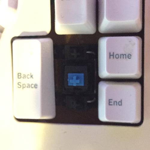

The PCB of my particular Kinesis (Model 130 that seems to be a mix of parts) has holes for installing PCB mount stabs, but no Kinesis I've seen actually have them installed.
Basically since it's a thumb key you aren't "reaching" to press it so in use it doesn't wobble at all. But when I try to wiggle it it wiggles like any unstabilized key.

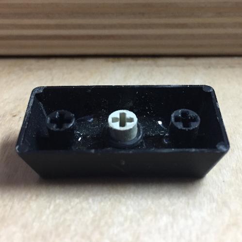

Rayndalf wrote: 13 Oct 2021, 21:57 The PCB of my particular Kinesis (Model 130 that seems to be a mix of parts) has holes for installing PCB mount stabs, but no Kinesis I've seen actually have them installed.
My KB132MPC has stabilizer holes; my 120 and Advantage don't. I installed stabs on the 132 after breaking a key on the Advantage, which was a nuisance to fix, but haven't got around to drilling the Advantage yet.
I don't think there are any available stabilizers that will fit three in a row, but you could use two switches per key, optionally giving one a lighter or no spring.
