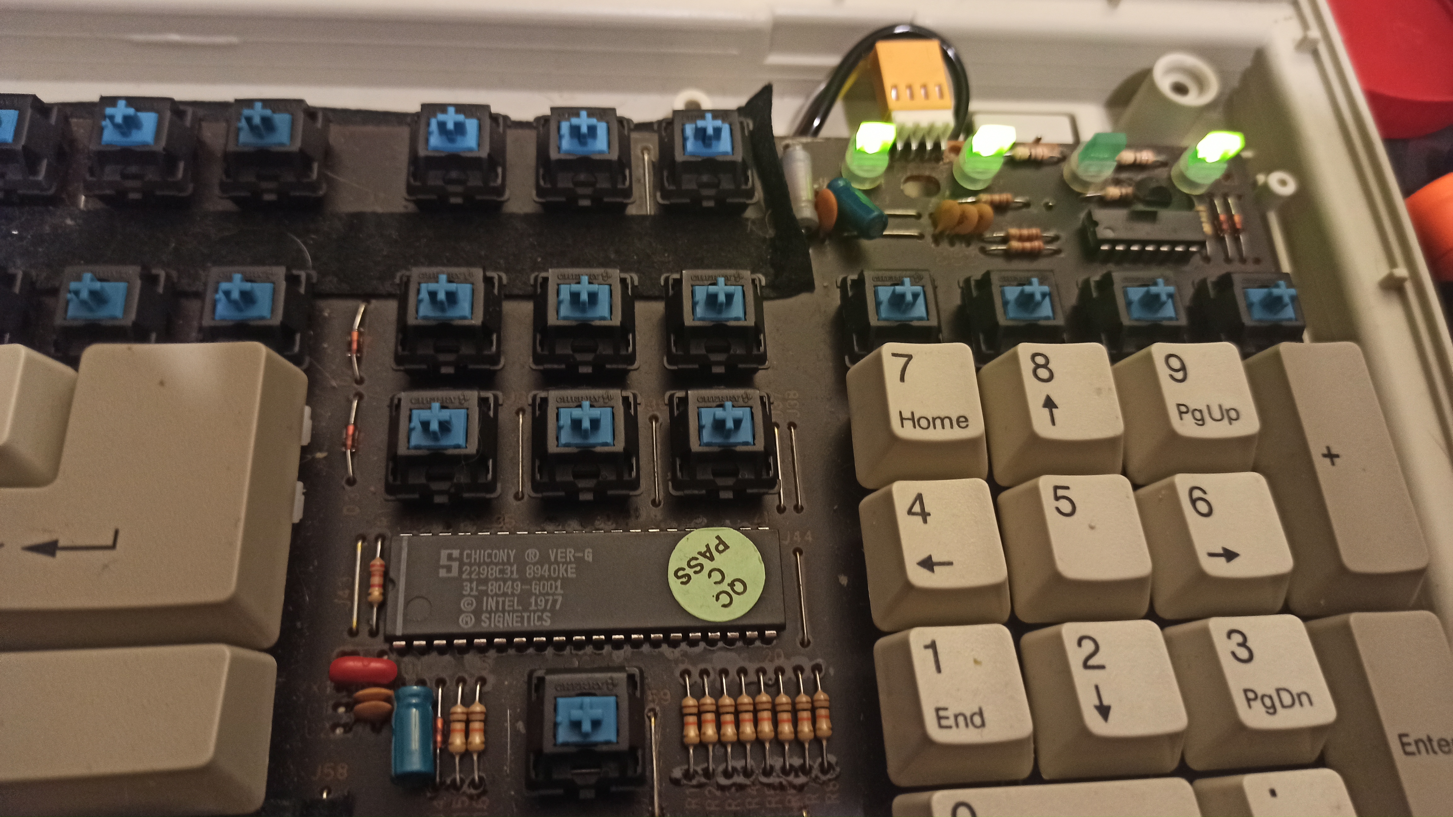

I got this keyboard from ebay in working condition, but because I didnt have a proper adapter for the din5 interface I made my own really janky din5 to ps2 adapter and it worked fine. Because I wasn't planning to keep using my abomination of an adapter I ordered one through aliexpress. Last night I tried the adapter, and the keyboard did not light up. Confused I began checking the cable with a multimeter, and to my surprise the vcc and gnd were wired backwards and the cable only had 3 wires. Realizing what I just have done, I mutilated the cable and wired up my own adapter to see if I killed it. Now the keyboard lights up all the status leds at once (scroll lock led was dead when I got it) and it doesn't register keypresses. This is my first vintage keyboard, and while not great I still liked it. I kinda overpaid for it too. Where do I start? Is the microcontroller dead? How do I check?

As a last resort, perhaps you have clock and data reversed? The locklights prolly signify a dead controller ):

It's most likely a custom chip made for Chicony; if you were to find a replacement, it'd prolly have to be from another board of the same model. Otherwise, you could map the matrix and solder in a QMK controller like a Teensy or something like a Pi Pico with KMK.

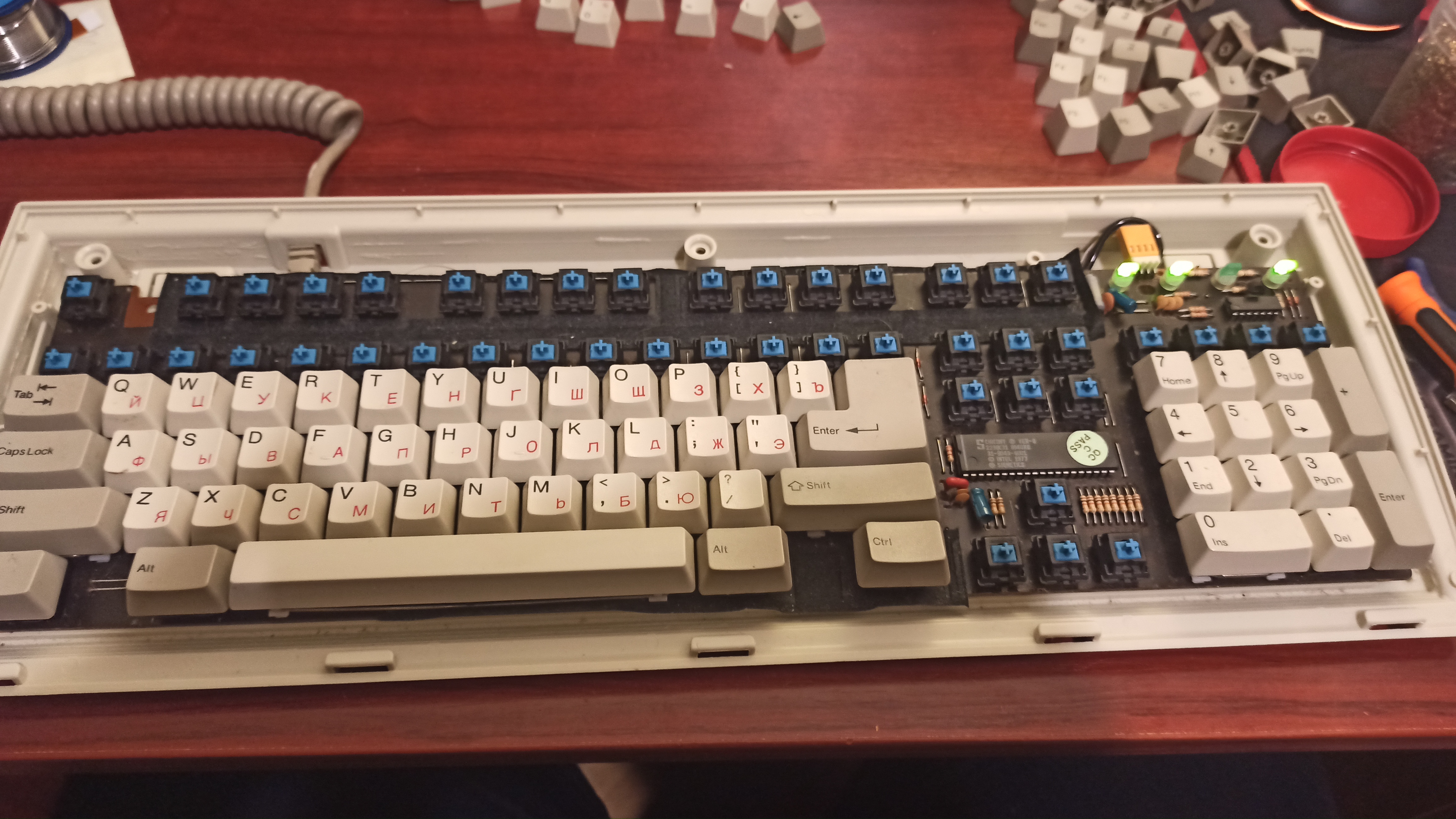

SK-8K
23 Oct 2021, 21:27
That PCB looks very easy to copy. I could design a replacement PCB for this model of keyboard if someone lends me a 5191.
