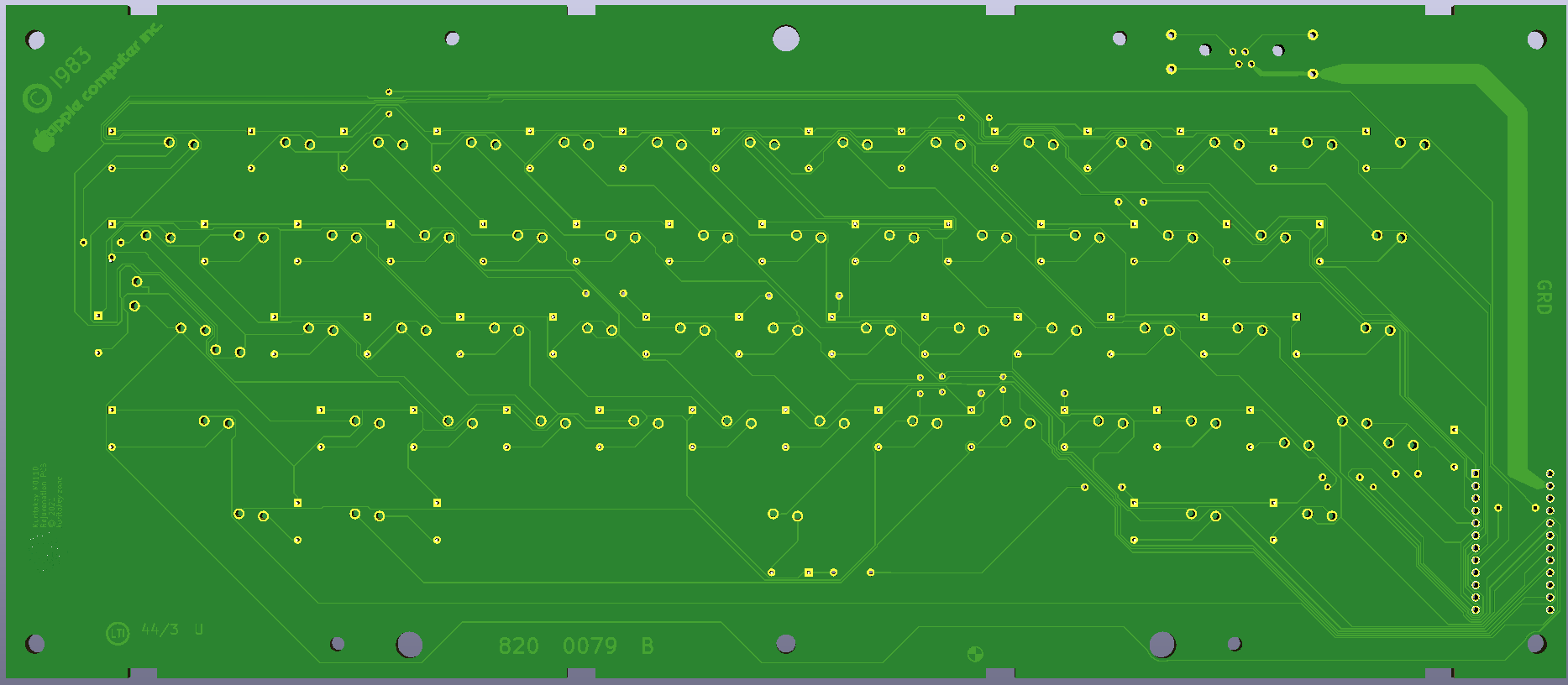

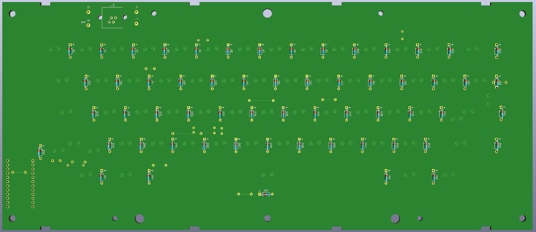

A faithful re-creation of the M0110 PCB, single-sided on CEM-1, with accurate markings and a silly cable system to preserve the external appearance of the keyboard.
Status
On sale NOW at kuritakey.store - Until December 1st
Features
  • Supports ANSI and ISO layouts
  • CEM-1 PCB substrate to preserve acoustic properties
  • Accurate markings in the copper layer - no silkscreen!
  • Similar solder mask color to the original
  • Pro Micro MCU
  • Preserves keyboard appearance with some smart cable chopping and re-use of the original 4p4c connector - same pinout as the M0110A PCB
  • N-Key Rollover - through-hole diodes only
  • QMK and VIA firmware

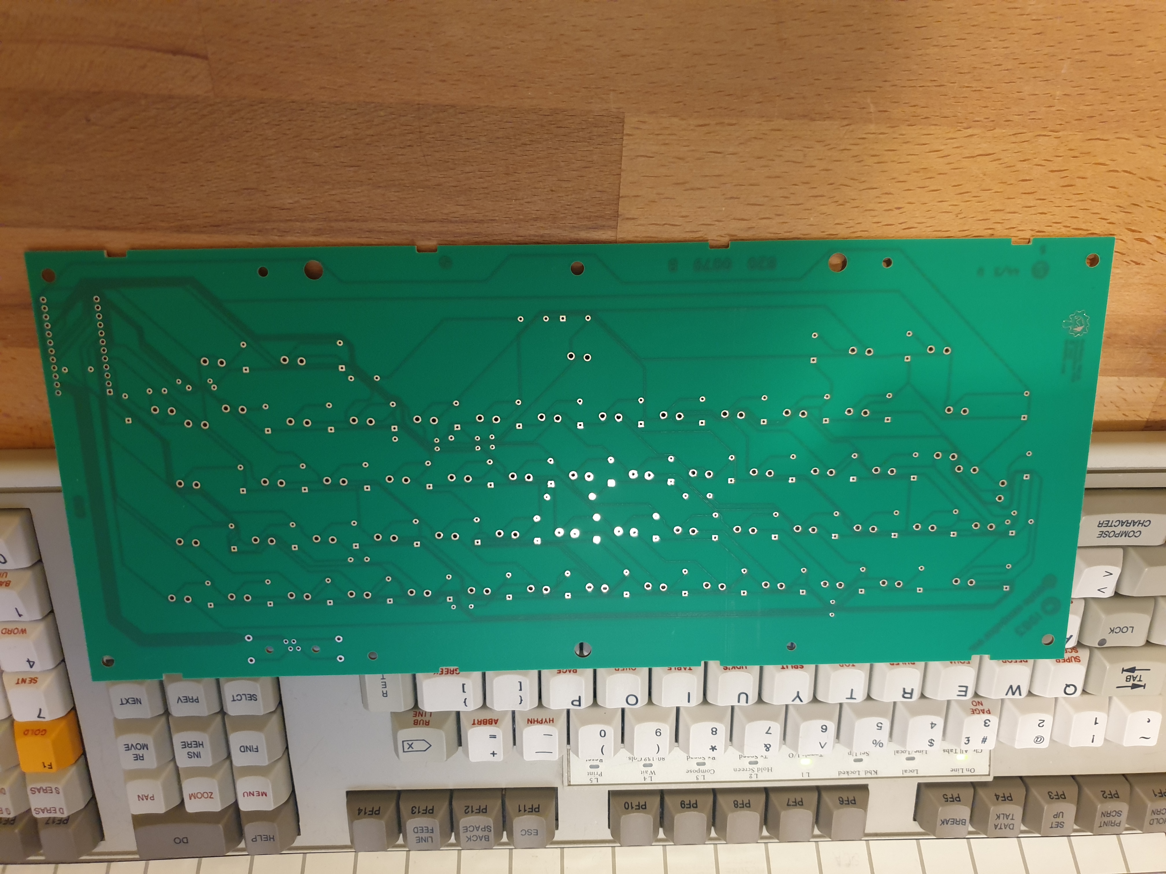

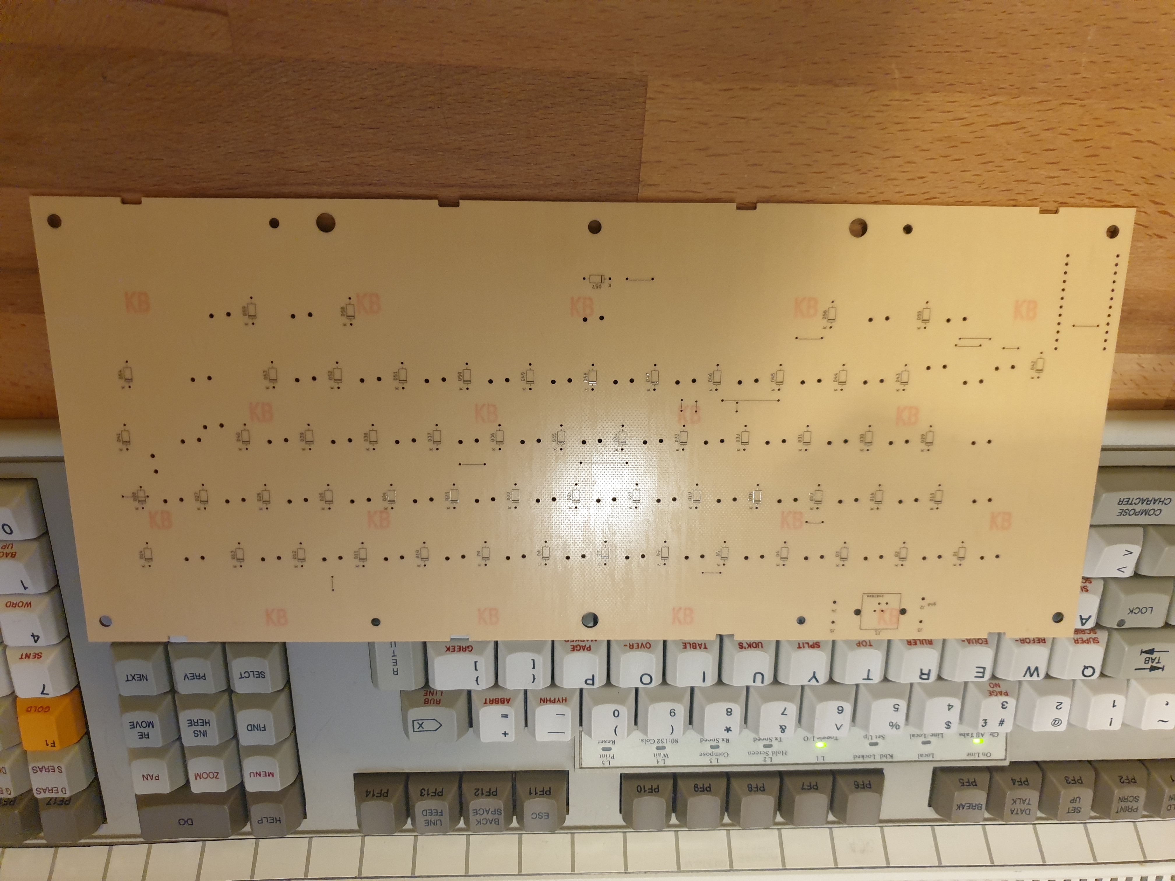

Protos are here! Some minor revisions to work in, as always with first revision, but 100% workable prototypes this time. The main issue is the inability to replicate the plated through holes that were there for the 4p4c connector on the original PCB, so will add a workaround for this, and pro micro placement is a bit off. I'll probably pick a different finish for the final product as well.

Can confirm, having assembled this, that the acoustic qualities are excellent. Will be moving towards opening orders very shortly
