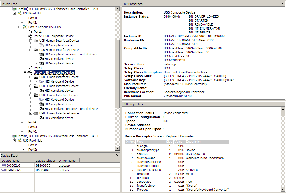

In that case I am at a loss. In aquakey it shows a lot more, but for some reason it doesn't register F2, F3 or F6 :S

EDIT: Doesn't this board send two seperate packages to enable higher than 6kro?
Soarer
05 Jun 2012, 16:50
Yes, most likely it uses multiple devices.
You need to highlight the Port in the tree, not the HID device. The USB Properties view will then begin with Connection Status etc. Like this...
Then the export from the USB Properties window gives a much longer dump, which includes all the reports from all the (virtual) devices attached to that port...
