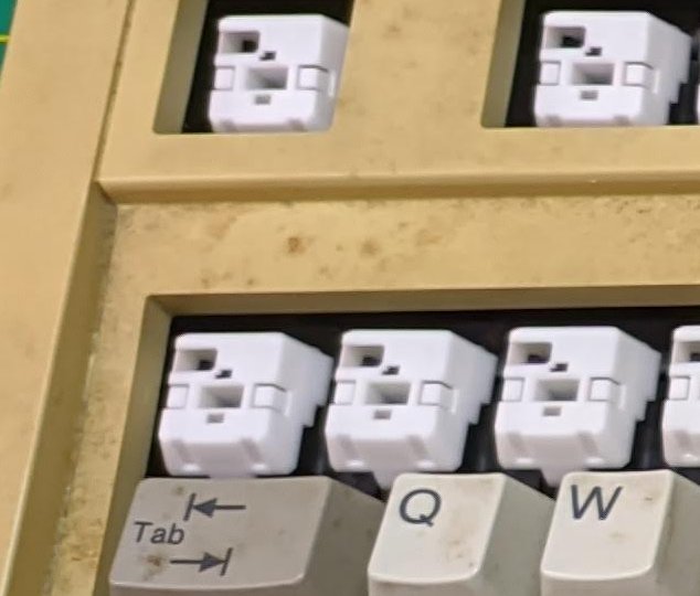

Which generation of Fujitsu Leaf Spring is this?
Reimu64
20 Nov 2021, 01:27

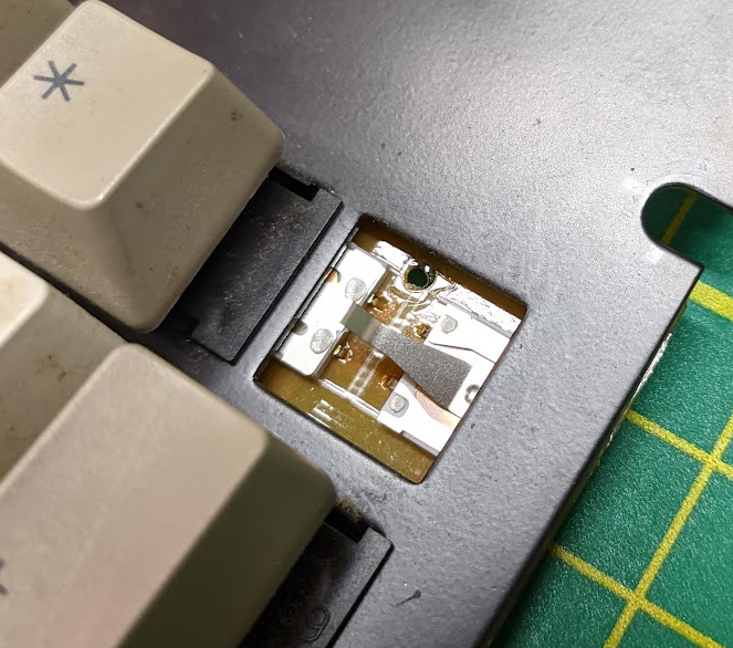

Switches:
There are no pictures of this particular switch mount on the wiki…and I’m left wondering if these are just regular gen 3 leaf springs. I've read of a 4th generation leaf spring from Telcontar, but found no other links.
Keyboard front:
If I didn’t remove the switch module, it could probably pass for a Peerless switch. The whole keyboard even looks like a FKB4700.

Reimu64 wrote: 20 Nov 2021, 01:27 Switches:
Keyboard front:
I was going to say, those sliders remind me of Peerless switches, as do the caps.
Noobmaen
20 Nov 2021, 16:11
The keycap mount and keycaps should be the same as peerless, unlike 3rd and 2nd gen FLS switches which have a slightly smaller side length. Be careful when removing caps, the stems easily snap off in my experience. I am not sure where this is positioned historically compared to "4th gen" FLS, which uses membranes but has the presumably older keycap mount.

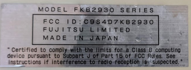

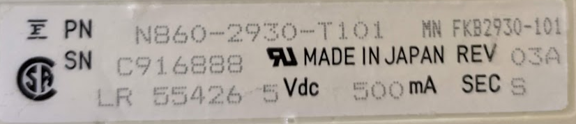

Crizender
13 Aug 2022, 22:26
Sorry to resurrect this thread - do you have a clear photo of the part number on the outside of the case? If you were looking at the back of the case its the sticker on the left.
The part number should look something like this:
N860-2930-XXXX (XXXX being the last part of the part number).
Thanks!

Crizender wrote: 13 Aug 2022, 22:26 Sorry to resurrect this thread - do you have a clear photo of the part number on the outside of the case? If you were looking at the back of the case its the sticker on the left.
Thanks!
I have one of these in pretty beat up shape. No Victor branding but it's the same PCB, switch, etc if it's of any use:
Crizender
15 Aug 2022, 13:57
Thats very helpful, thank you! These can come with other Fujitsu switches so I was wondering if the P/Ns were the same even if the switch was different. This gives me hope that the P/N dictates the switch you get (just need more pics of other FKB2930s to confirm) :)
