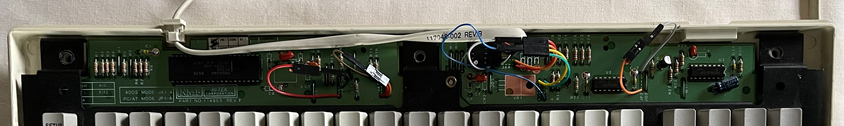

ADDS ASCII keyboards have four sets of jumpers that switch between PC/AT and ADDS mode. I believe most people just check these, replace with PC mode when necessary, and use the board with Soarer's converter, end of story. But what if one doesn't replace them or does so in the opposite direction?
I imagine ADDS mode was used by some earlier keyboard as the only mode. I do not have access to one of those, but it might be worth understanding the protocol for anyone who does.

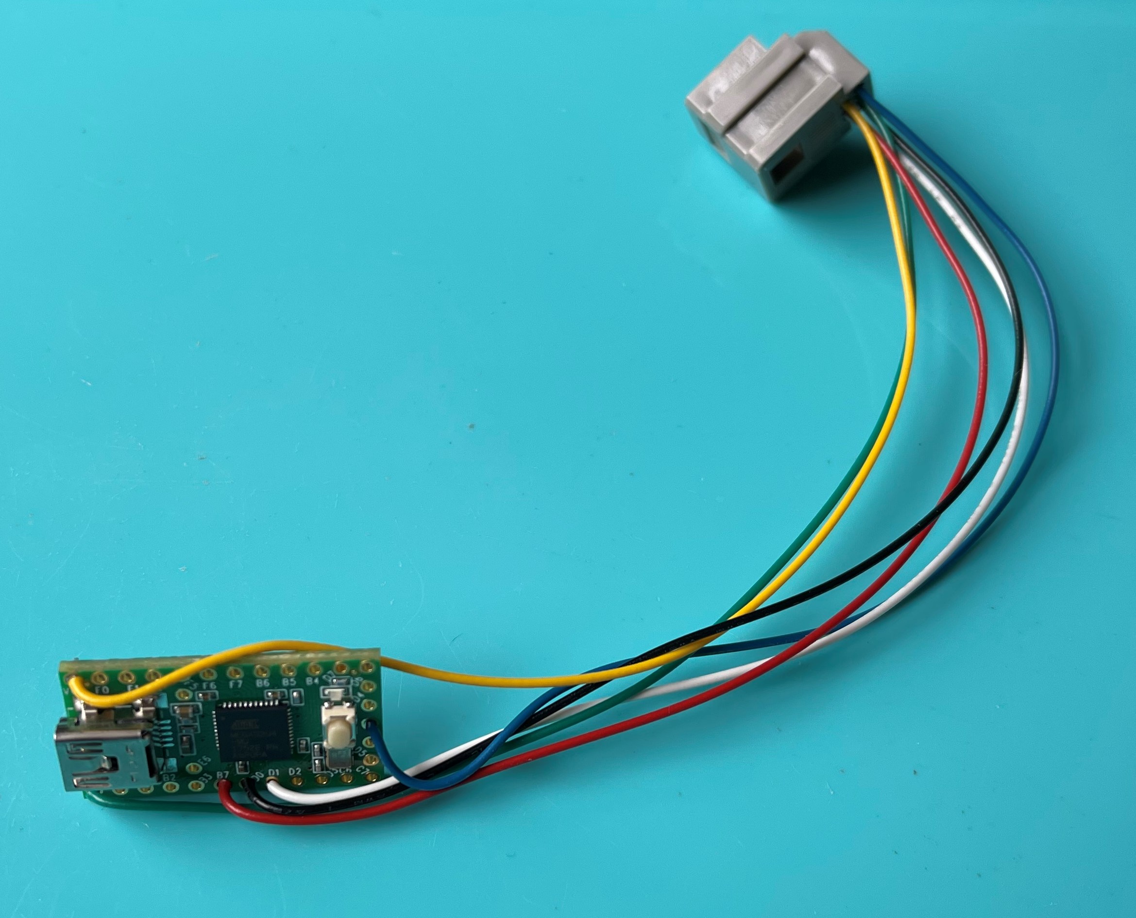

Rather than just replacing the jumpers, I wanted something somewhat switchable. There isn't room on the board for proper DIP switches. And it's too tight vertically for header-style jumpers, especially underneath the right-angle cable connector. So I went with some Dupont style jumpers.

The board contains:
  • U1 8749, the microcontroller
  • U2 7417, an open collector buffer
  • U3 74123, a one-shot
  • Q1-Q3 2N3904 transistors
In addition to the power connections, some important ones are:
  • PC data to U2:4A and :5Y, the two open collector directions.
  • PC reset to U2:6A.
The jumpers work as follows:
  • JA1/JP1: connects U1:INT to one of U2:2Y (JP1) or U2:3Y (JA1), that is, selects input to the microcontroller.
  • JA2/JP1: connects U1:P27 to one of U2:1A (JP2) or R17 associated with Q3 (JA2), that is, selects output from the microcontroller, with the transistor circuit copying the original board I'd guess.
  • JA3: grounds U2:5A, thereby constantly holding the PC data line low, and U1:P26, to give the microcontroller a mode sense line.
  • JP3: connects U1:RESET to U2:6Y, completing the reset circuit in PC mode.
  • JA4/JP4: connects the PC clock line to one of:
    • JP4: U2:1Y and U2:2A, that is, the input to INT and the output from P27,
    • JA4: R25 and U2:3A, along with the Q3 transistor, the corresponding ADDS inputs.
Summing up, ADDS mode has a single bidirectional signal on what is the PC/AT clock line. From here on, I'll call that the signal line, to try to avoid confusion while assuming ADDS mode. Power and ground are the same and the extra lines don't hurt anything, so there is no reason not to use the same converter as would work with Soarer's were the jumpers the other way. (Unless the UART proved to be useful, which it does not.)
