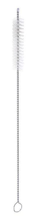

I've revived some very scratchy Ms with just a good cleaning though. When screw modding I soak everything in warm soapy water for a while. The stems get ultrasonic cleaned and I scrub the barrels out with a pipe cleaner.
