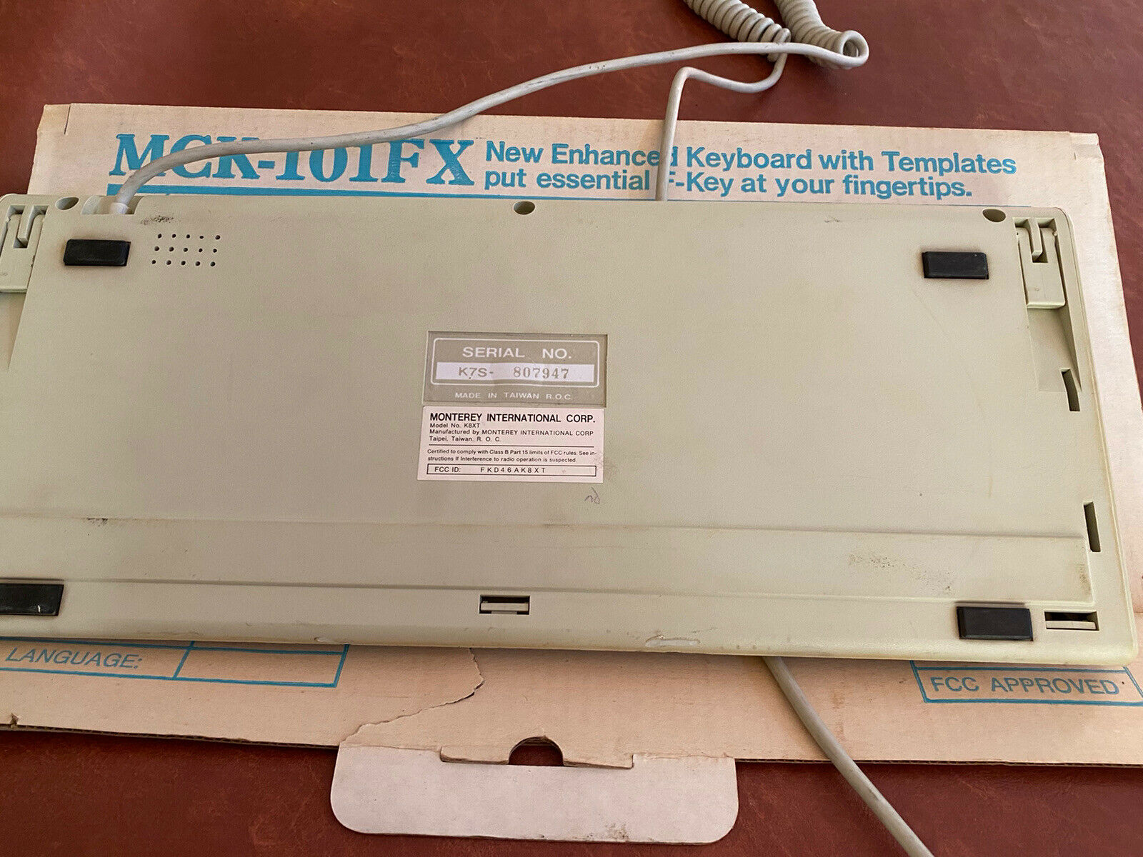

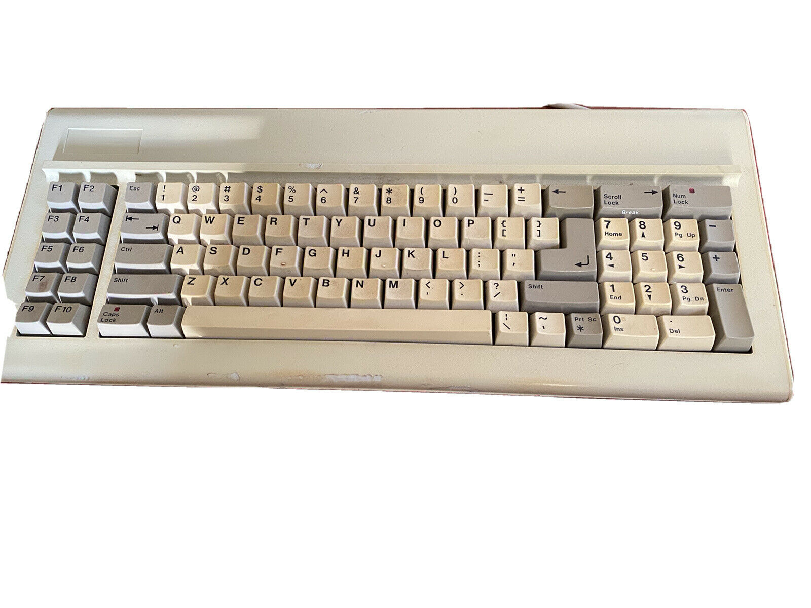

Polecat
04 Apr 2022, 03:48
Interesting, thanks for sharing! I believe this was also sold as a Monterey/Staff K7S. <attached, not my photos> I had one of these many years ago. Monterey K8S and K8XT are also related.
box is not for this keyboard
