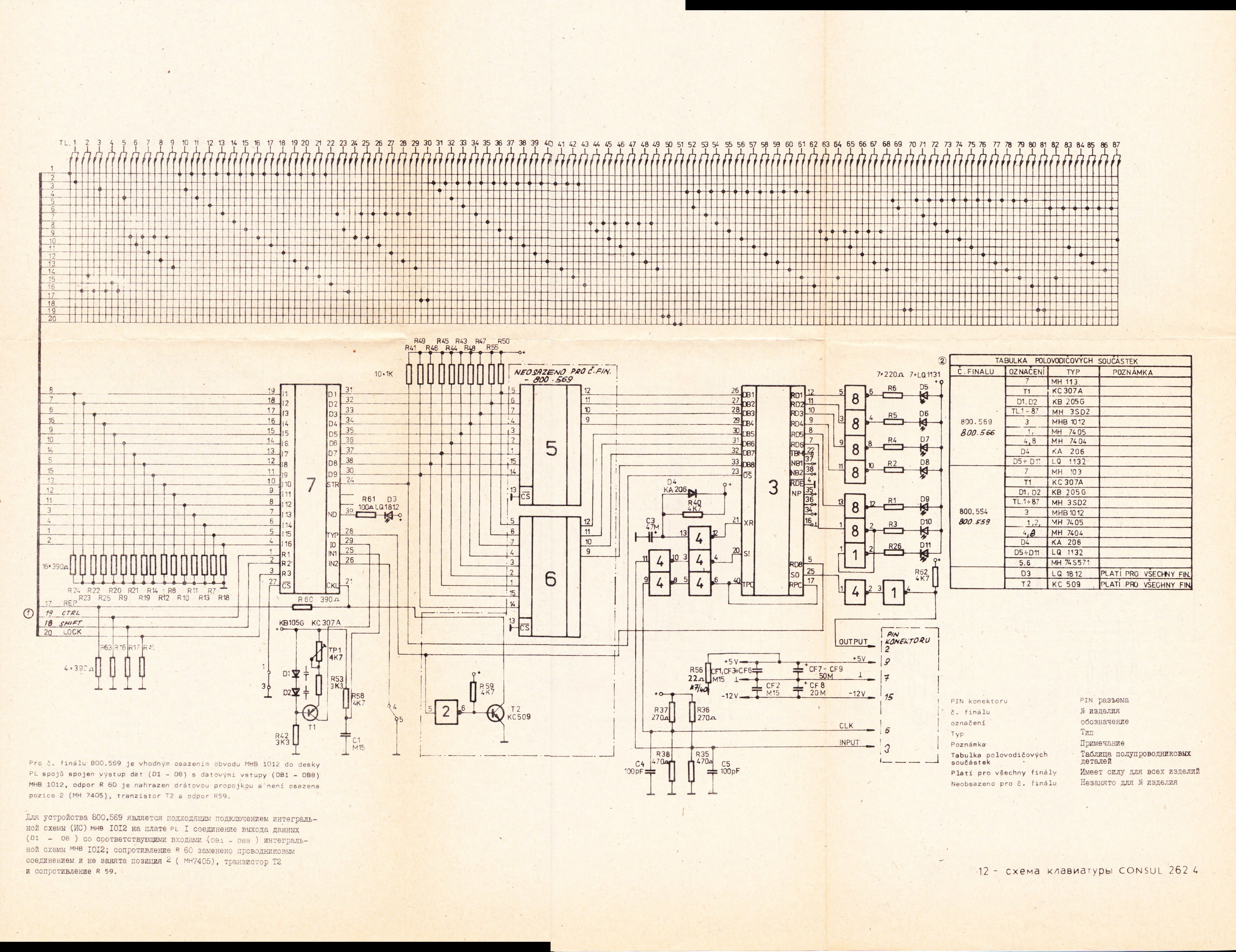

I do not have one of these keyboards, but I do have a Consul 262.3 and was asked about the difference and the possibility of converting the 262.4. Here are some notes on that.
The short version, as noted in passing here is that the 262.3 is a parallel ASCII keyboard and the 262.4 is the serial version.
Externally, the 262.4 moves the arrow keys, adds more keys in their place, and includes some LEDs. It has a 15-pin d-sub instead of a 24-pin ribbon cable.
Internally, they use the same PCB. The schematics can be found here in the original (Czech / Czechoslovak) manual.
Here is a stitched-together scan of a printed copy with Russian translations added that came with the 262.3:
The main active component in both is the a 2-of-N keyboard encoder which scans the keys and outputs strobed parallel based on a lookup table in its own ROM or two external 2048-bit 74S571 PROMs. On the 262.3, the strobed lookup through the ROM goes straight out of the keyboard.
The 262.4 populates some additional slots on the PCB. The most important is a Tesla MHB 1012 40-pin UART. This is a copy of one of the GI AY-5-101x series CMOS UARTS. The strobed output from the keyboard encoder loads the UART's serial output. The signals on the keyboard cable's connector are all for the UART (with some additional inverters, open collector in the case of serial output).
