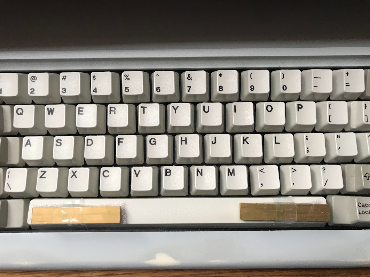

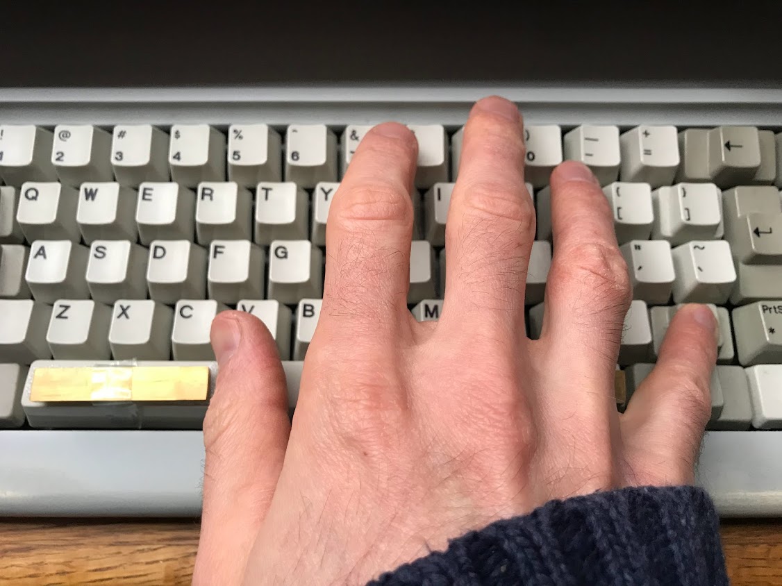

I mostly like my XT spacebar too: it's good for slow, considered typing, when you have to finish each word with a THUMP of approval. But for when I want to type faster, I use one of the following two tweaks:
This is even jenkier than hot glue and screws, but it's more easily done and reversible in seconds. Two slim brass ingots sellotaped to either end of the spacebar with some foam underneath to prevent them knocking. Each weighs 13g so 26g overall extra weight to the spacebar, which is now medium-heavy. I bought slightly wider pieces too which were 17g each and experimented with all the combinations of one to four pieces (13g, 17g, 26g, 30g, 34g, 43g, 47g, 60g). 26g or 30g seemed to me to give the best balance between retaining the original feel of the spacebar whilst reducing its stiff feel. Going for all four pieces (60g) meant every other word the spacebar would stay depressed. Other weights worked fine but the highest ones made the bar a bit too loose for me: it would accelerate too quickly down, and at 47g not spring back up so nicely. Obvious caveat: it's not so attractive, but I don't mind that, plus I can remove the weights in seconds. Another caveat: I only ever hit the spacebar with my left thumb, and always underneath the B or N key, so the weights never get in my way. If you have a different typing style, it might be tricky to place weights on a section of bar you never hit.
Visually cleaner, but I imagine this is even more dependant on having a certain typing style: remapping Right Shift to Spacebar. Since I always use my right hand for spacebar, and never use Right Shift at all for Shift, this works fine for me. It takes a minute or two of getting used to it if I'm switching straight from the usual spacebar, but I can type almost as fast with this configuration.
