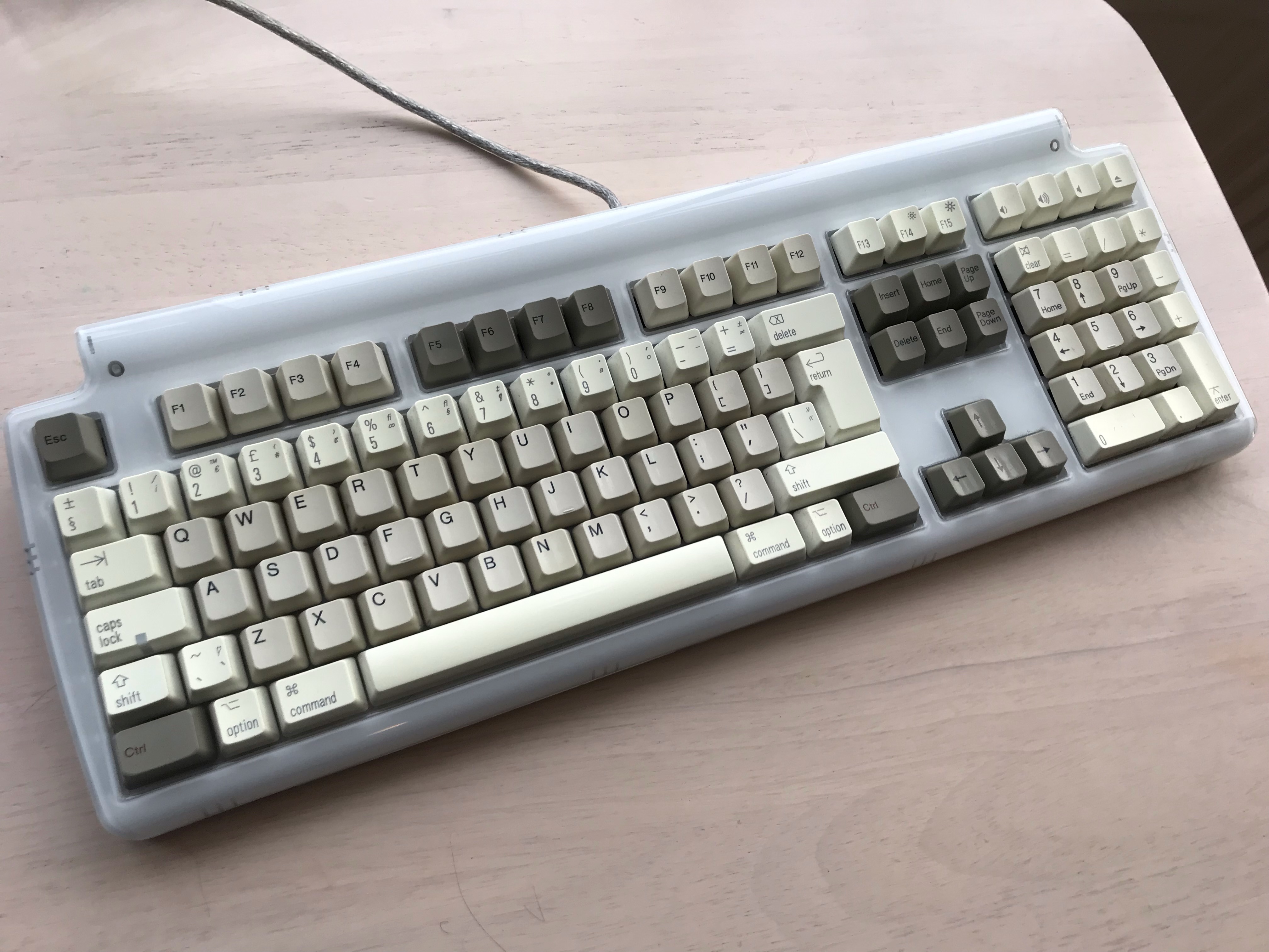

Found where my Matias was hiding. I’d forgotten I’d already dressed it up in some caps salvaged from another board, a cable-cut white Alps something-or-other. Quite a nice result, I think, the four shades. There’s probably a fancy name for it: colour some keycaps like this, call it Butterscotch Cream, and sell for $200

Far away from the soldering iron? Like every pet who's ever been to the vet!
Interesting colourway. I've just been playing keyset unsanctioned dressup with a certain board of mine, too. Pics when there's light to see it.

How is an AEK II after all these years? Pretty nice. Just pulled a cap to be sure: yep, creams. (My other one has whites.) This board's a nice mellow blend of tactile and quiet. It's definitely more "switchy" feeling than my daily HHKB. But it's really quite nice for a change, and the Apple native layout is a dream. I've mapped latching Caps Lock to Layer 1 in TMK, and I've made that layer "transparent" besides the numpad now mapped to mouse keys. I just leave Caps Lock toggled down and I don't need to reach my mouse. A use for full-size after all! Tempted to reverse matters and make mouse keys the default, actually…
As for this keyboard's almighty reputation amongst certain old-school Mac users: I can well understand it, if you've used no better it's really pretty good. The look is good, the key profile is very good, and the switches are better than most. If I liked more "switchy", latchey, mechanism-feeling tactility, I'd appreciate these. They're nowhere near as "mech" feeling as black space invaders, but they're a tiny fraction of the racket too!
I'm spoiled. It's always Topre for me when it comes to quiet keyboards. But this one's interesting, with a wealth of beige era Apple character, and it's just earned itself a place in my rotation.
