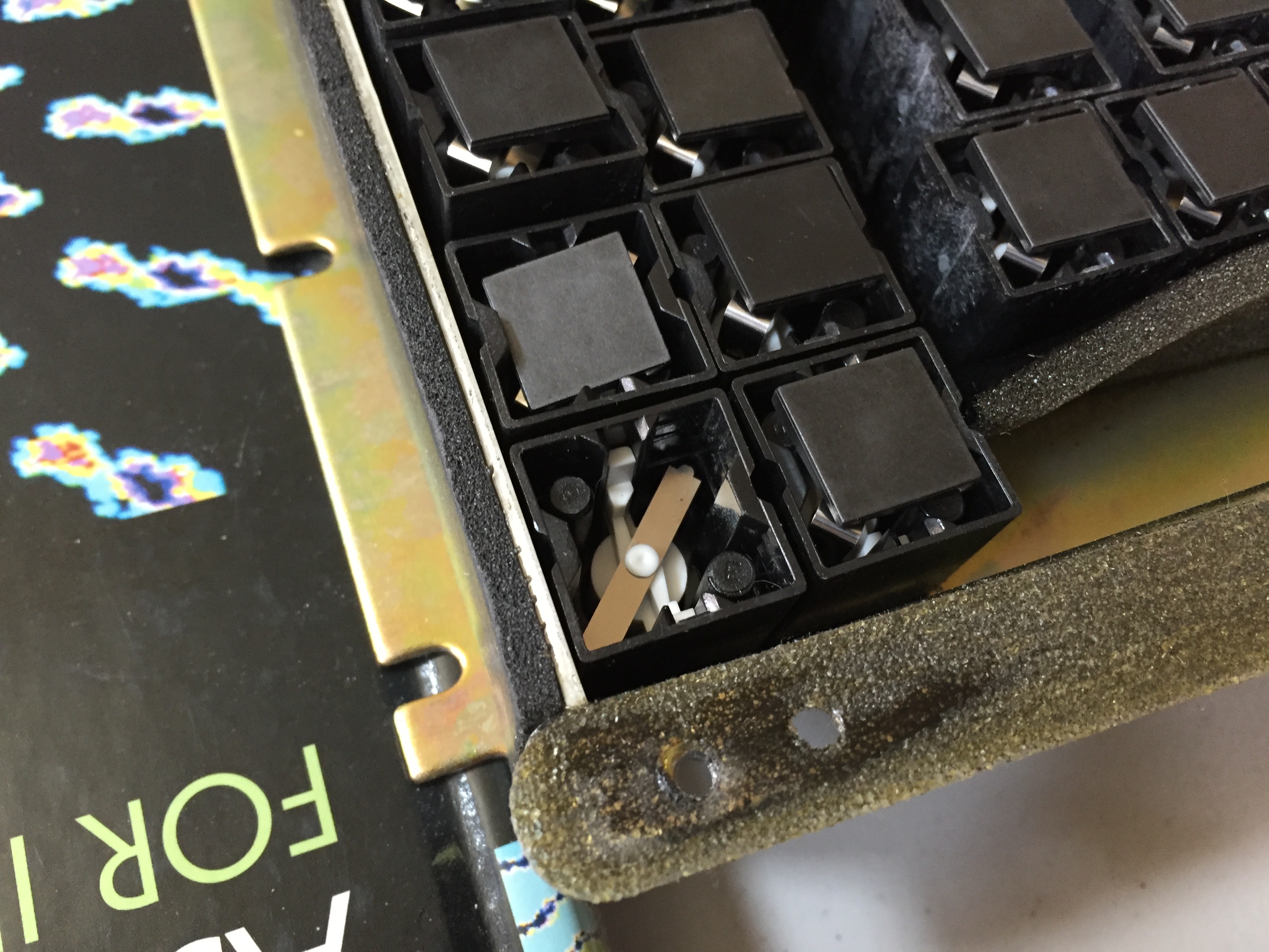

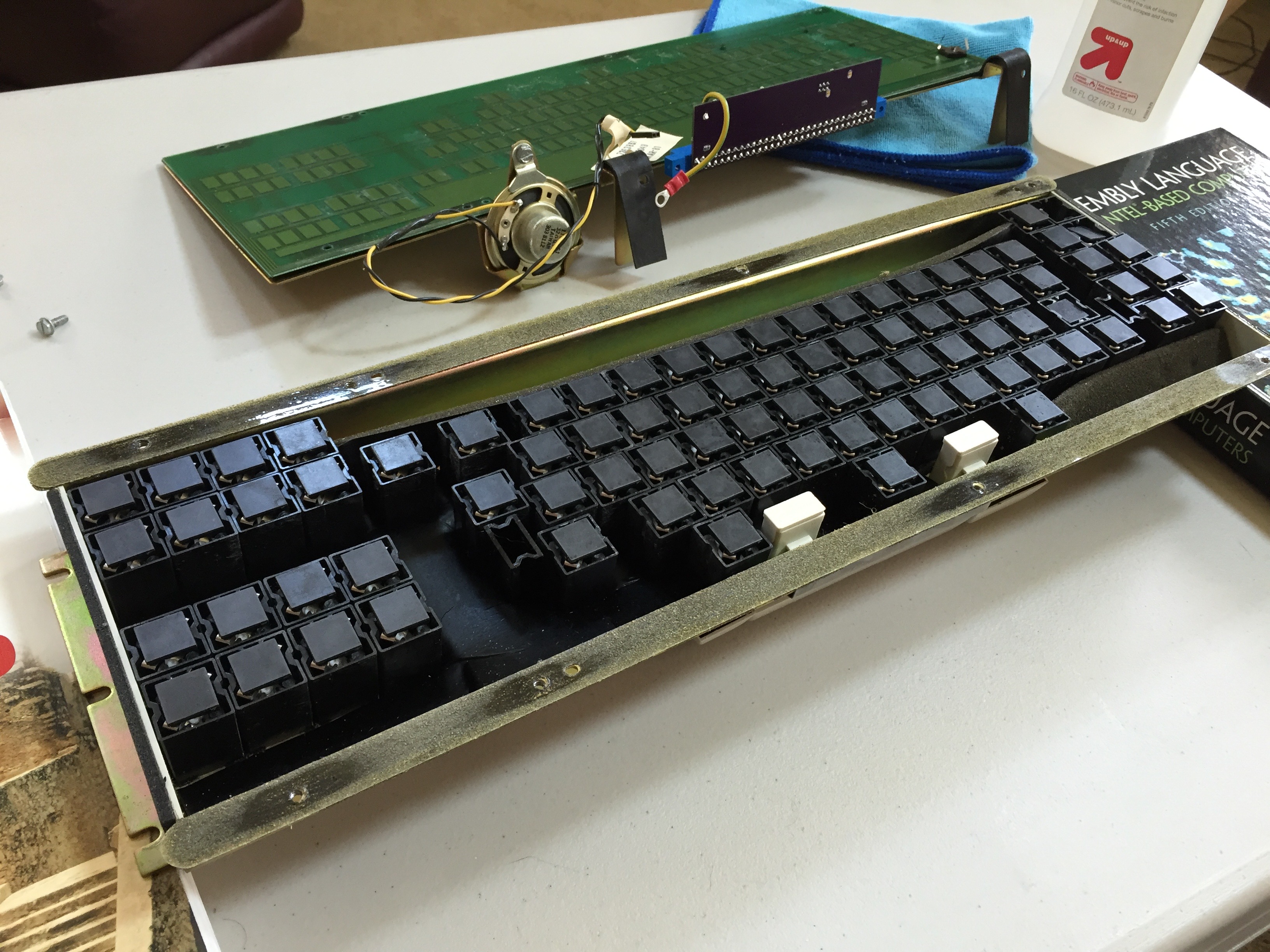

I was looking through some old photos I took, and it looks like I might actually still have the original foam. Can anyone confirm that's what I'm looking at?
(Obviously what's pictured looks like foam, but I'm unsure from these photos if this means all the foam is intact. It also seems to be in good shape. I'm not sure if it's original or was replaced at some point, but I'm the one who USB-modded it.)

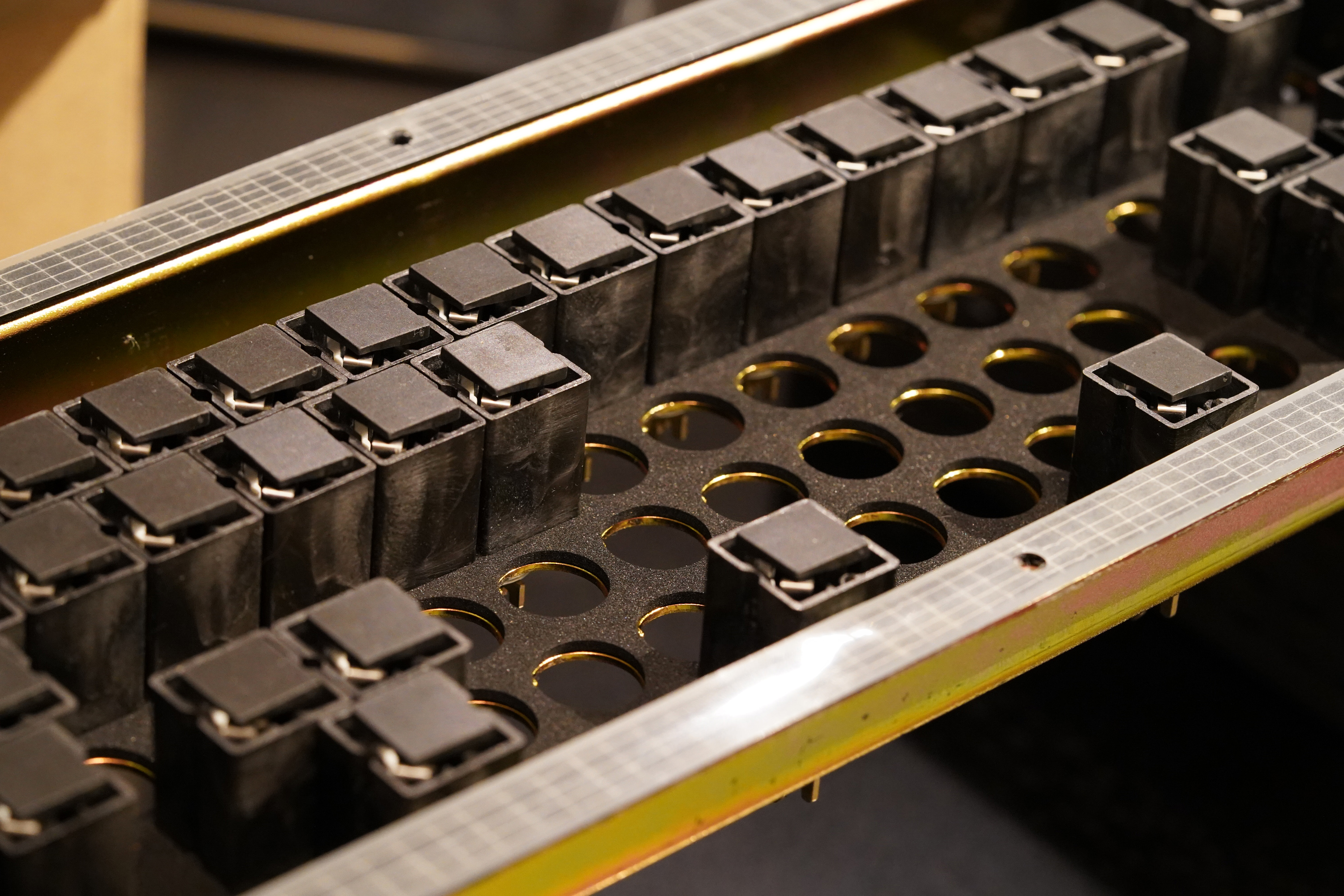

I recently finished my project to fully restore a 6580. The foam helps to stabilize the keys and definitely gives a better typefeeling. I needed to remove a fully rotten/sticky foam (so no choice in my case). Eventually the old foam WILL deteriorate, so when opening and cleaning the keyboard, I would recommend to consider replacing. When the foam crumbles, the pieces can give errors on the PCB.
Bought a foam replacement on eBay (search for "Replacement Foam for IBM Model F, Beamspring Keyboard XT AT F122 5251 3278 DW")" (Make sure you order the right version), worked well and worth the money if you don't want to cut yourself.
I used 2mm thick EPDM Celrubber tape with thin doublesided tape for the 2 mounting bracket sides. Same thickness as the key-foam to reduce any bending effects on the metal parts as much as possible when putting together.

28 Feb 2022, 21:07
That's how the replacement foam looks with the beamsprings.
