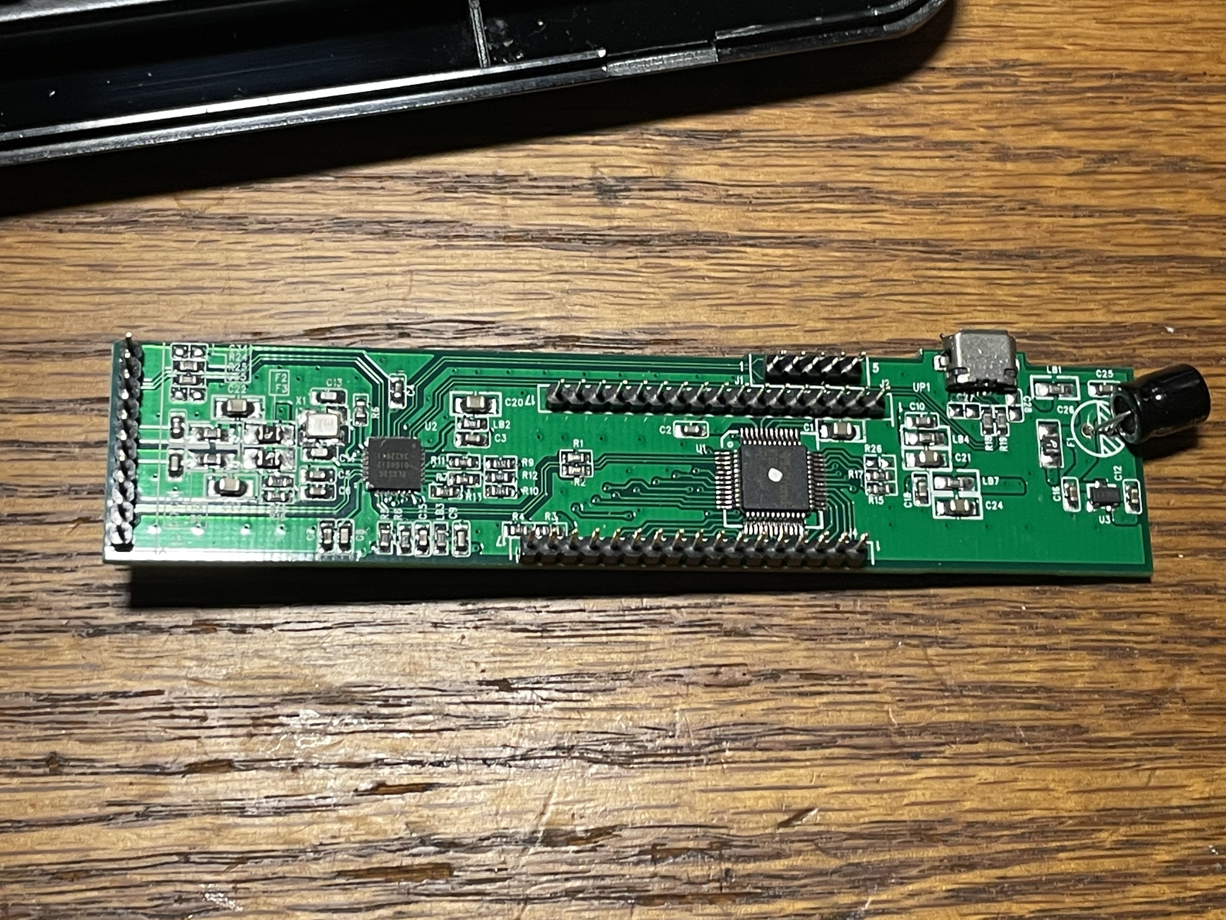

Long story short, the controller card on my Mini Quiet Pro crapped out on me. Rather than wastefully replacing the whole board, I'd like to get a new controller card, as the ones in this board are replaceable and swappable between the same model. However, if anyone has advice of where I could buy more/hack together a new one myself, I'll gladly take that. Thanks!

The controller for the usb hub and the actual microusb is on this:
I’d looked it up before, and someone(viewtopic.php?t=12704) had previously had the idea to wire it to a Teensy instead. The only issue I have is that Matias boards have usb ports on either side of the keyboard’s top, and I don’t know how I’d get those to work with a Teensy. Also, I don’t know how I’d line up the existing port hole with the port on the Teensy.

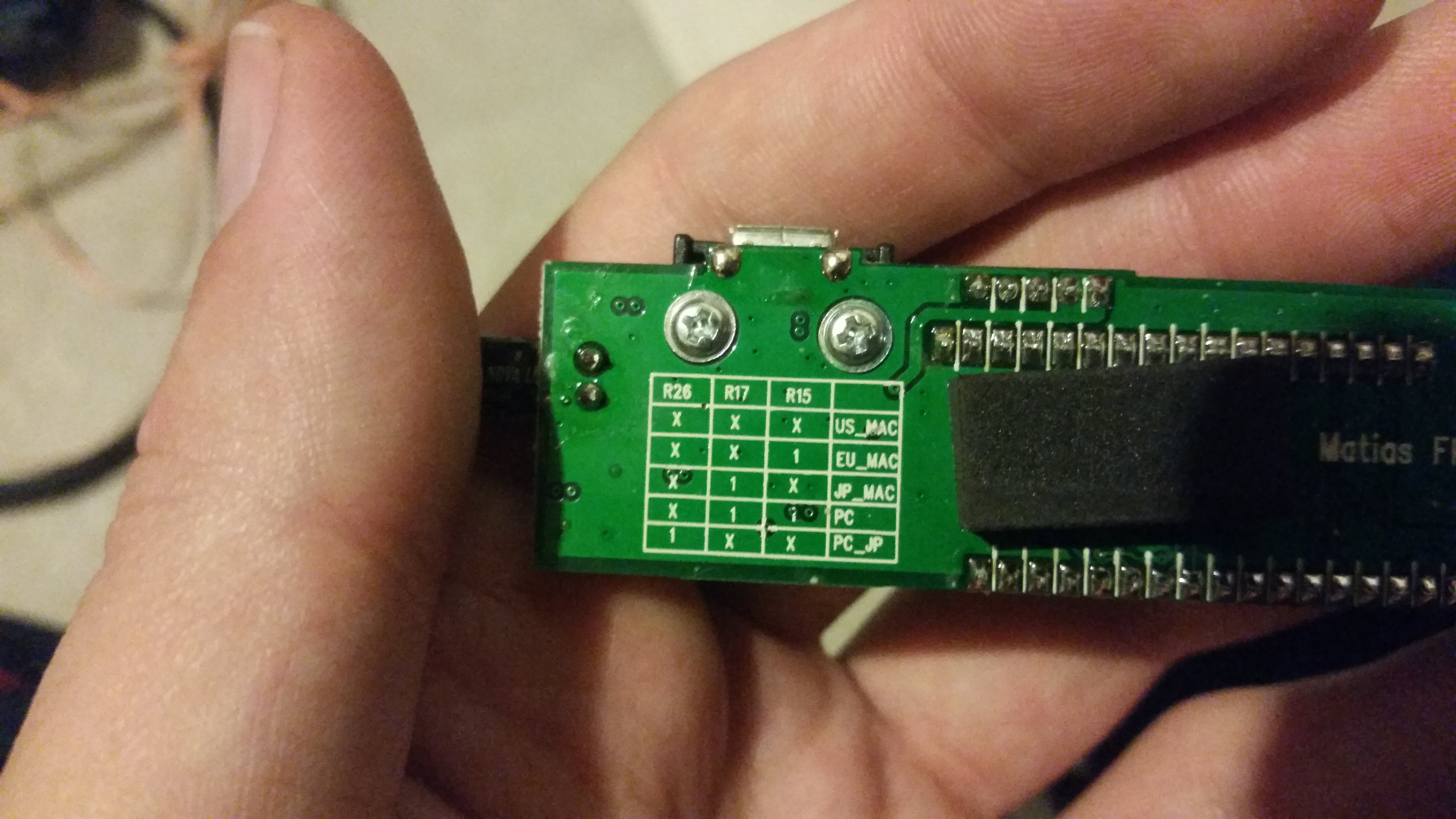

I know this is old, but there's useful information to add for anyone curious. Unless something's changed very recently, Matias will sell you parts/returned boards for $15 plus shipping if you ask their customer service nicely and they have any lying around. The one I picked up this way was literally just missing some caps and stabs and had some scuffs on the case. It was 100% functional.

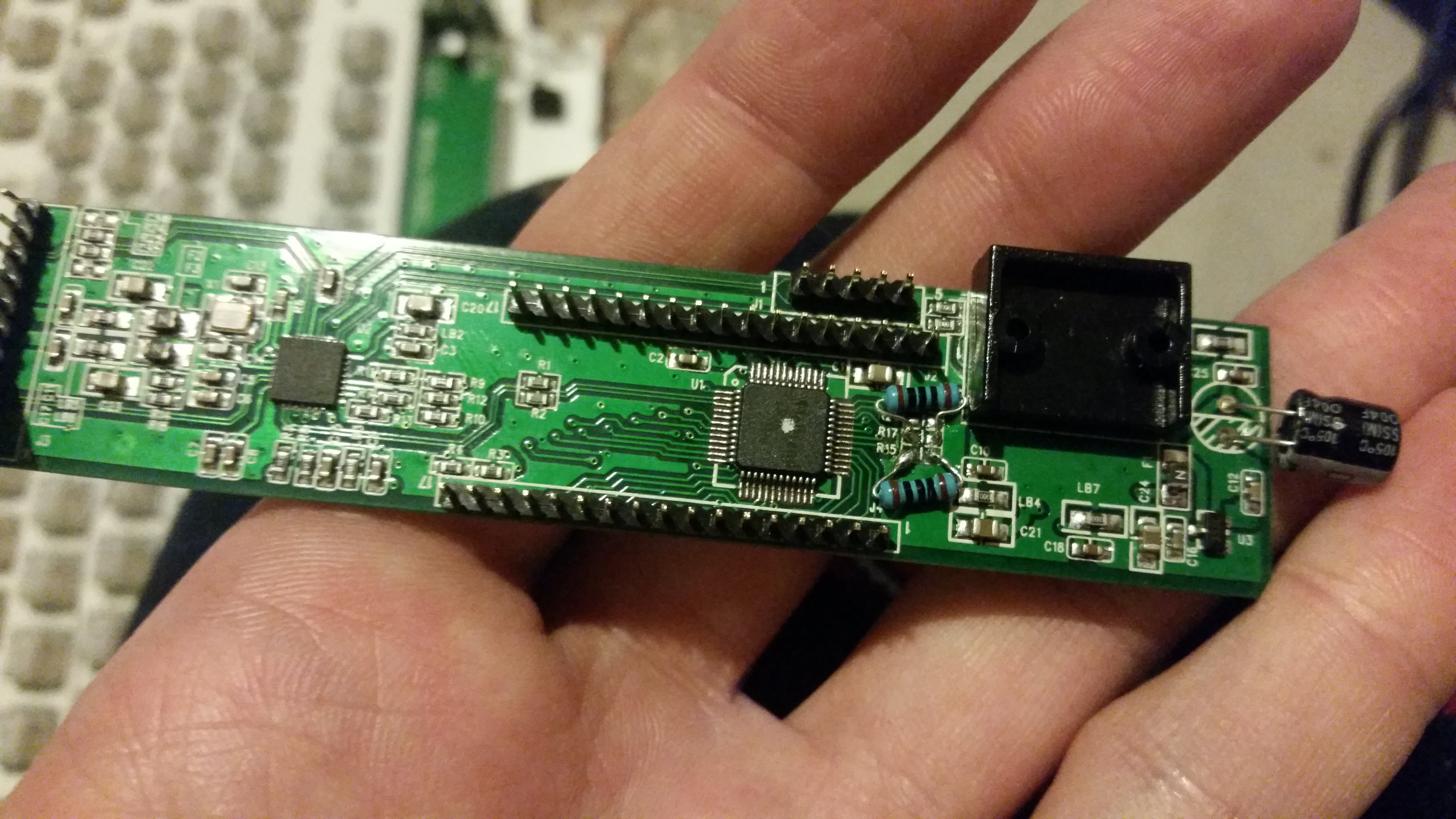

The controllers are the same between all of the mini boards, and the Mac variant is the easiest to convert to other mappings via soldering 100 ohm resistors to the pads helpfully listed in a table printed directly on the controllers. Changing it from Mac to a standard PC mapping requires the addition of just two resistors to unpopulated pads on the PCB.
They're meant for SMD resistors, but I made through-hole ones work. I have a detailed thread about this on Geekhack that should be easy enough to find. Not sure if I should link it directly.
What's wrong with the original controller? Was it one of the ones that didn't have the strap for the micro USB port? They're pretty fragile without it. I have been able to replace one that was damaged entirely with a female aviator connector, but it is a major pain to tap into the existing pins and/or traces.
