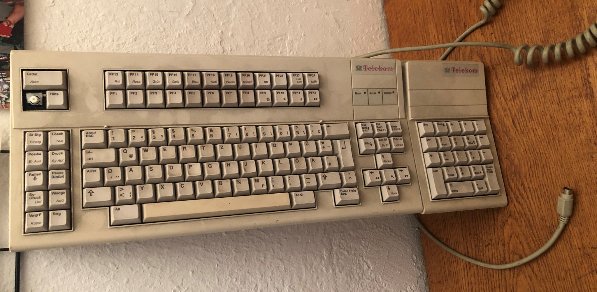

whole Board
whole Board
Overall in good condition, it turned out to be just telekom branded, since it was originally built by ericsson.
Sadlly, one of the keys was missing, but since iam planning to use it in TKL mode i will probably just steal one of the numpad ones.

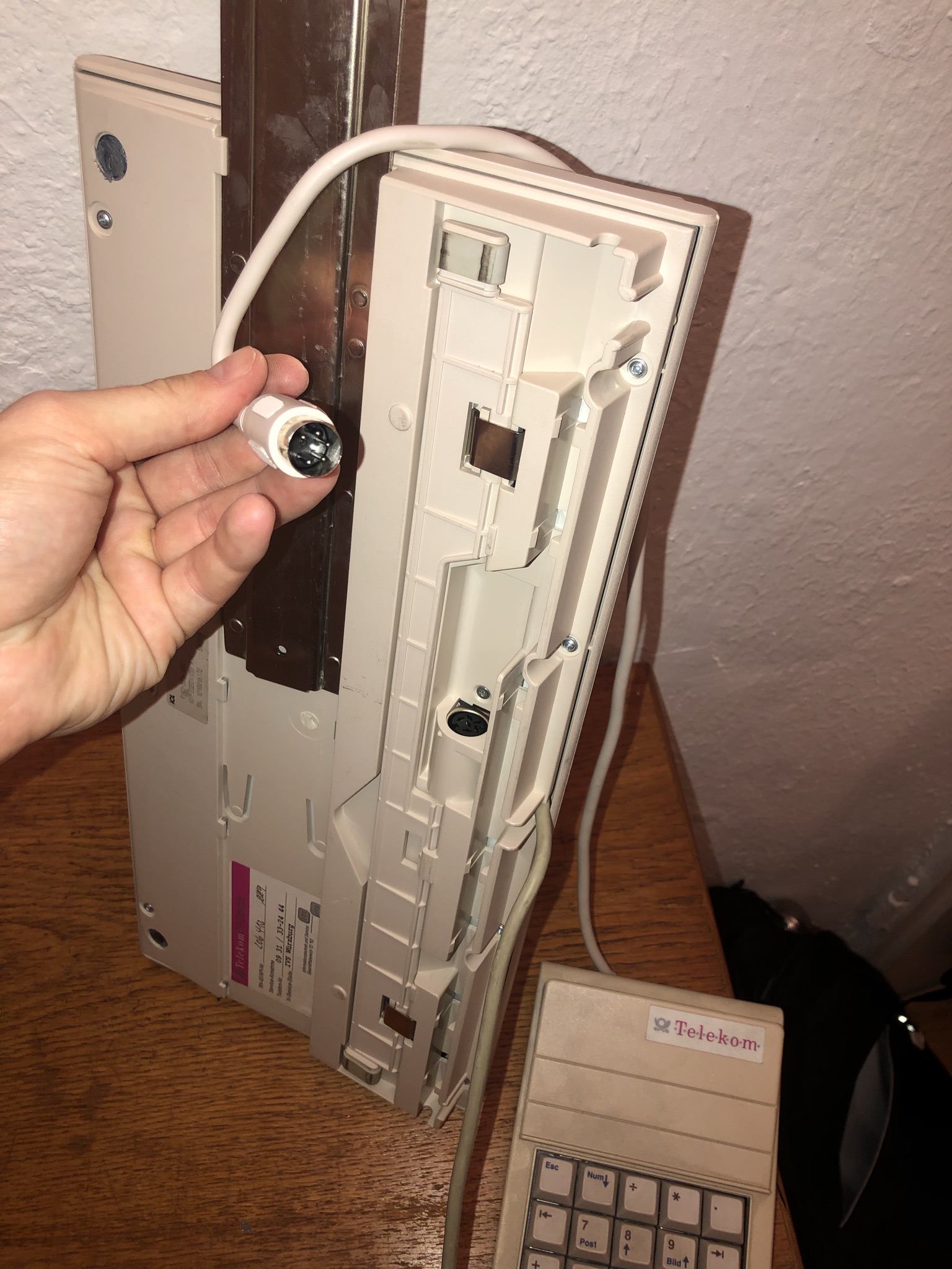

The Board is really two seperate boards, held together by a thick and sturdy metal bar, connecting the two pieces. The "main" Keyboard is PS/2 , but the numpad is connected to the main board via an AT Style connector i think.
AT Style Connector and Metal Bar

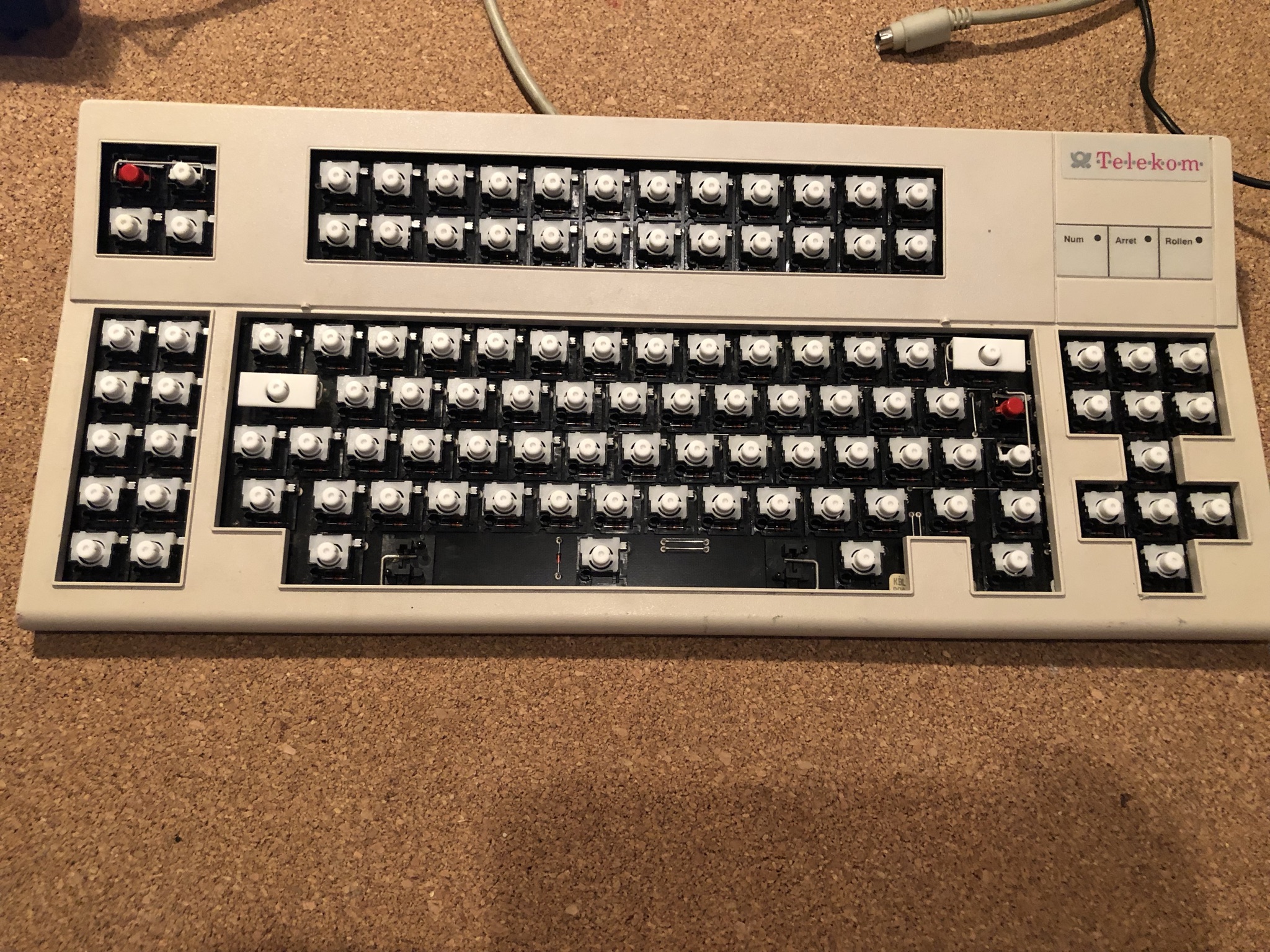

After seperating the two Boards, and pulling of all the keycaps, to clean them in the washing machine, the board looked like this.
Board without Caps
Board without Caps

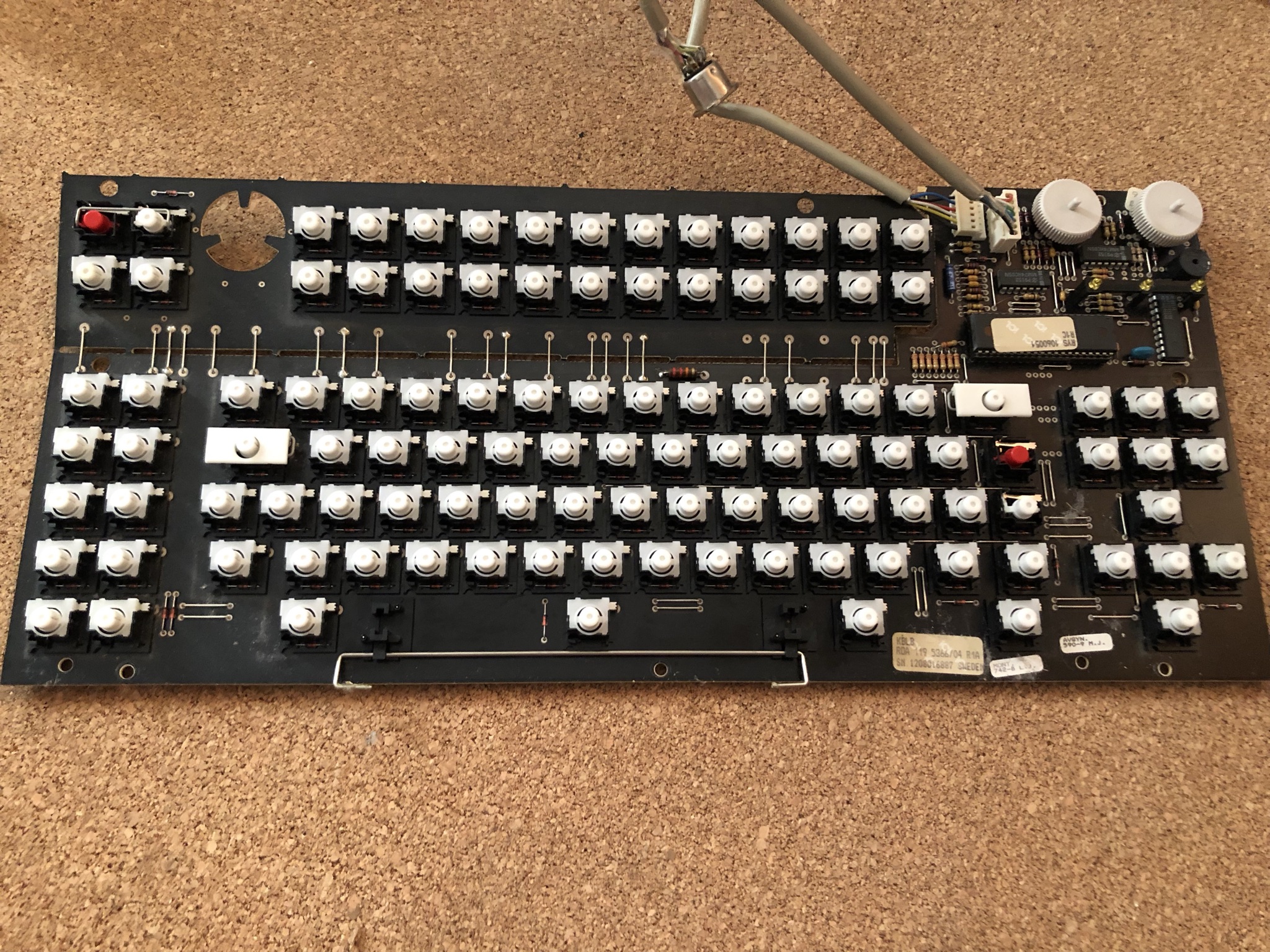

Since i plan to whiten the plastic with Hair - Bleach , i took the outer casing apart too.
naked PCB with switches looks like this:
naked board
naked board

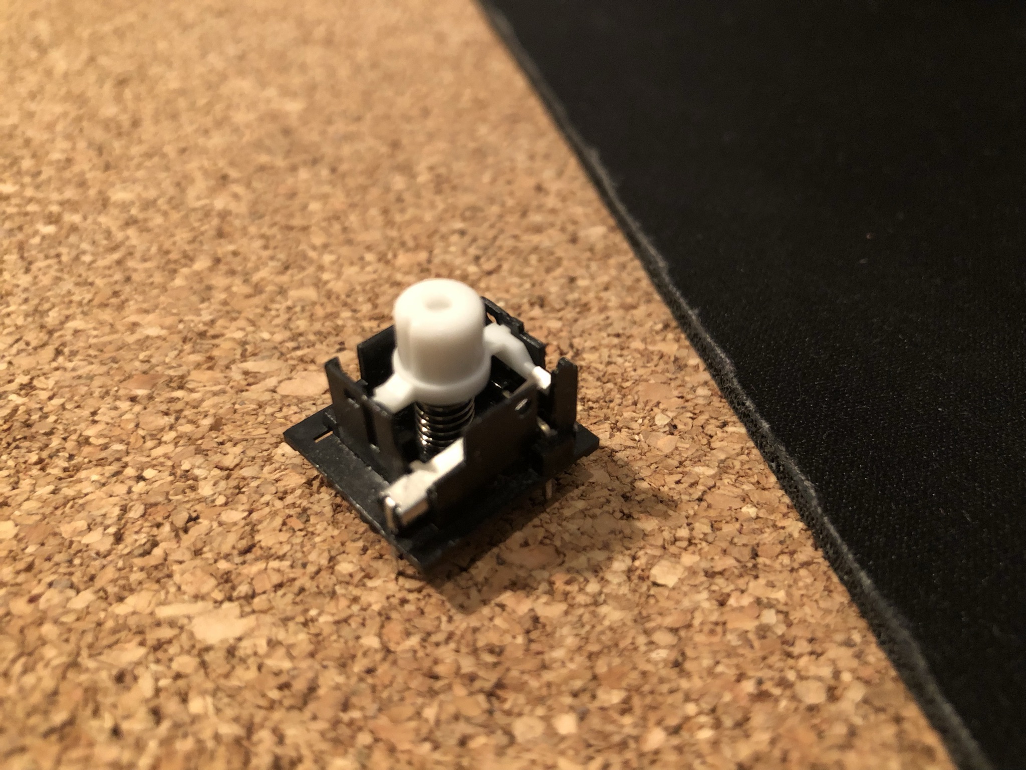

Single switch i desoldered from the numpad just to look at it.
single switch
single switch
Notice the two wheels at the top right ? While i dont know what the first one does, the other one is a volume knob for setting the volume of the inbuilt speakers, that makes a sound for each keystroke (u can disable it completly)
While plugging it into my ps/2 capable machine, i noticed all the "normal" keys seemed to be working just fine, while the double F row (F13-F24), just where the same keys like the row under it.
Also, some of the special keys at the side didnt seem to register on the keytesting site i used.

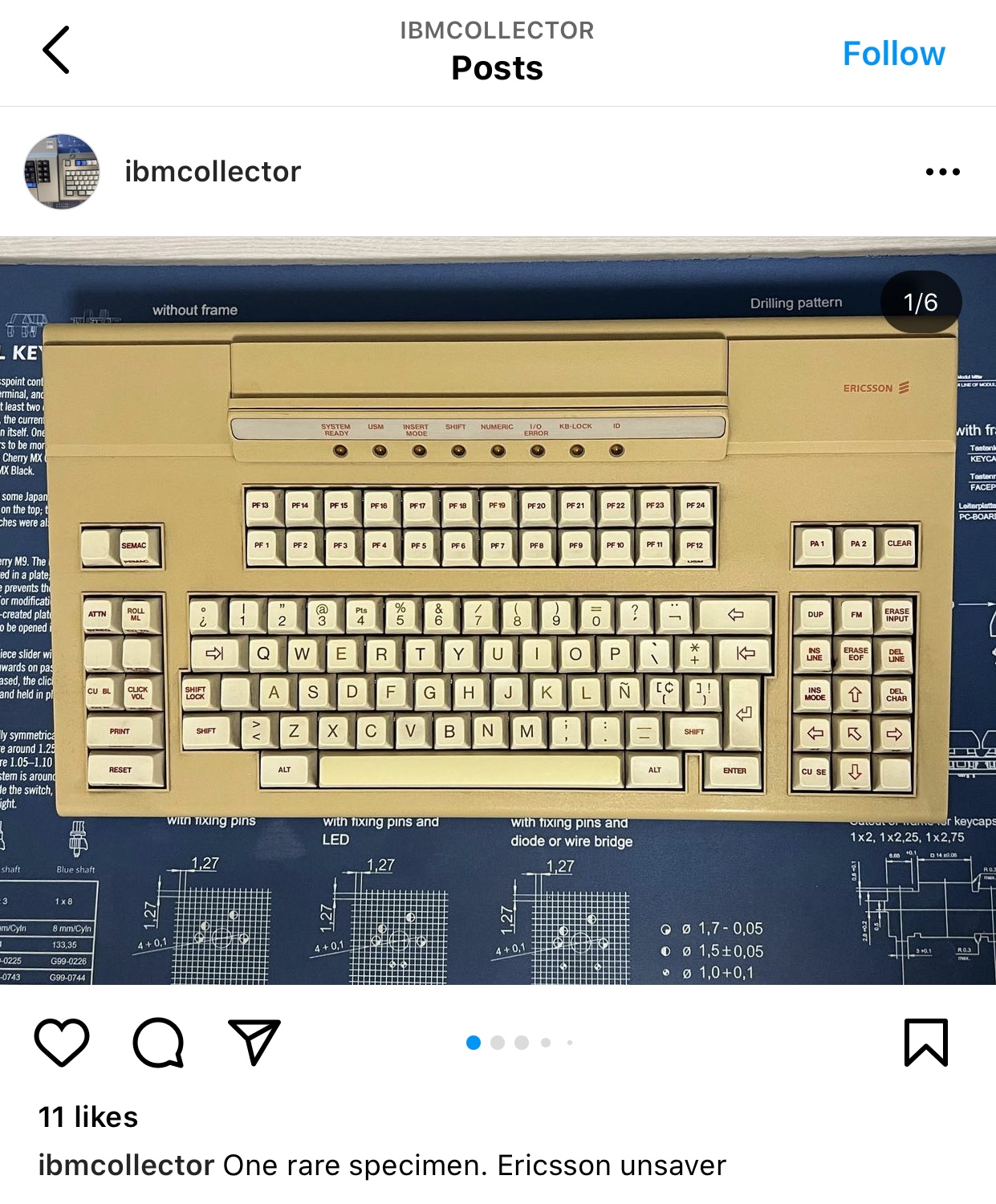

Aye. Nice Ericsson “Unsaver”. You done good on your first find. :D

Reminds me of this thing.

Just let me tell you that while it is among the rarer boards and switches , i didnt really like the switches. Some were quite scratchy and bindy , probably due to the open design of the switches:
download/file.php?id=73260

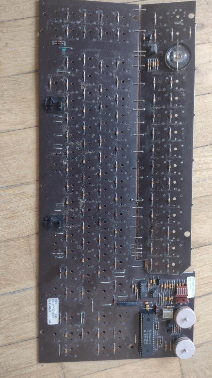

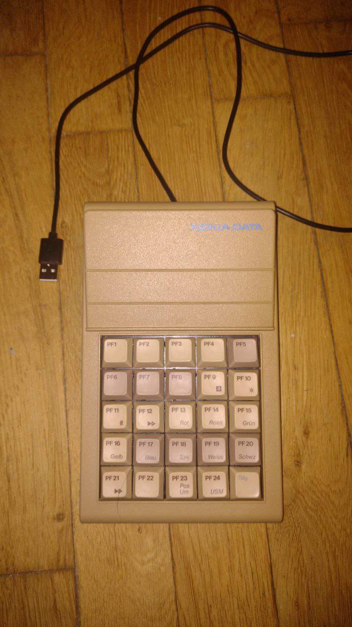

So I opened it, and there is no visible issue with it, im getting good readings on the multimeter etc.
So it either speaks moonspeak, and considering its quite unusual with 0 documentation, thats a dead end, or its just mega cooked beyond salvation, it does after all have chips like an old 80s home computer, so they might just be no good etc.
Its effectively scrap, and will be treated like scrap, which is a shame.
However, while the switch might not be fantastic, it would be nice to have a working reference so im thinking about getting the numpad up and running instead.
It has no microcontroller of its own, so it would have to be handwired, the dummy switches will be replaced by normal switches as well, creating a 5x5 numpad, and with all keycaps being a uniform profile I can pick and choose from the board carcass.
For now the main board has been robbed of switches, they will get a good cleaning until the arduino arrives sometime next week.

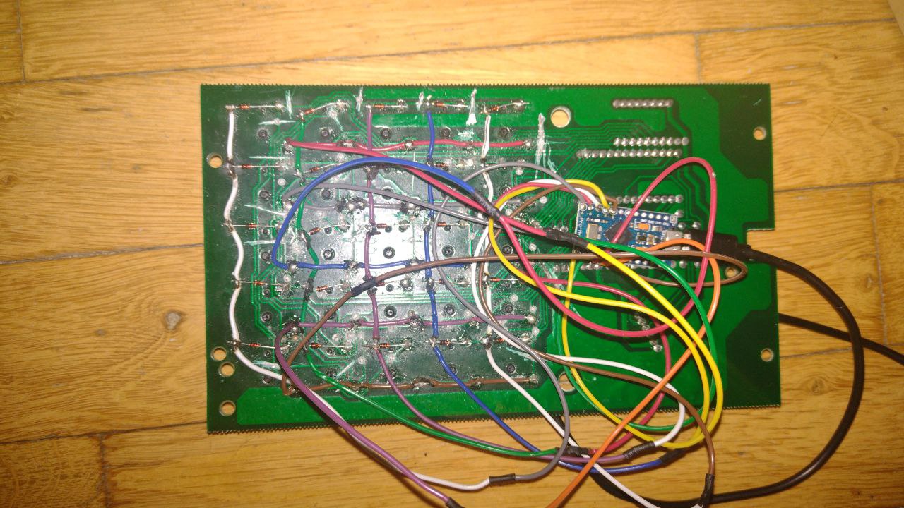

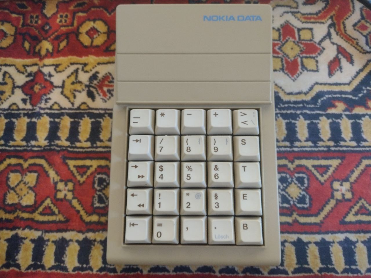

Status update: It lives!
So after a decent bit of troubleshooting, my first handwire project was successful:
It looks like an absolute abomination, and reusing the original PCB as a bracket to hold the switched ment I had to drill out the traces manually so nothing would cross and activate when it shouldnt, this took longer to trouble shoot than expected, but the end result looks fantastic:
photo_2022-12-17_19-16-43 (2).jpg (140.38 KiB) Viewed 6590 times
Before installation, all the switches were lubed with dry teflon lube, alas 3 switches died either during lubing or during the installation process as they are built like actual garbage, so as per request by guidemetothelight a soundtest will follow with lubed v unlubed switches installed on PCB with keycaps on.

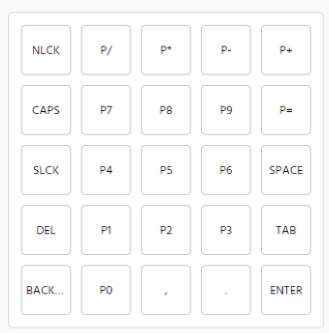

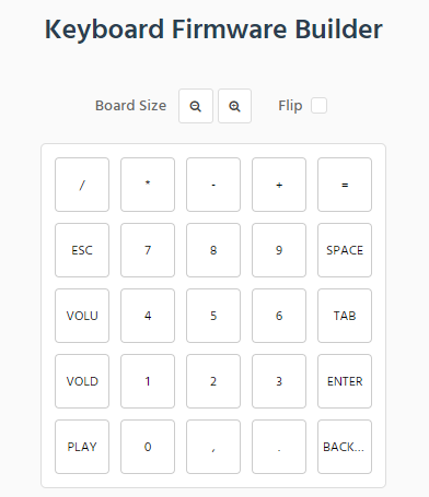

Lastly, its currently set up as a keypad with some extra features:
Ive never given a keypad layout much thought, if any of you have any good ideas for a 5x5 keypad layout let me know!

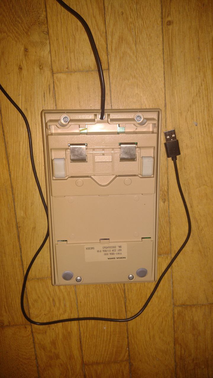

The Finale
The end is here, as the numpad is now actually operational, it ate a pro micro in the process but with the bootloader button installed, ideally this contraption will remain forever shut.
And as promised, sound test.
I think its pretty clear which is which, the sound and feel is much improved, they arent actually too bad in their lubed state.
https://soundcloud.com/dan-254739213/rmd973
