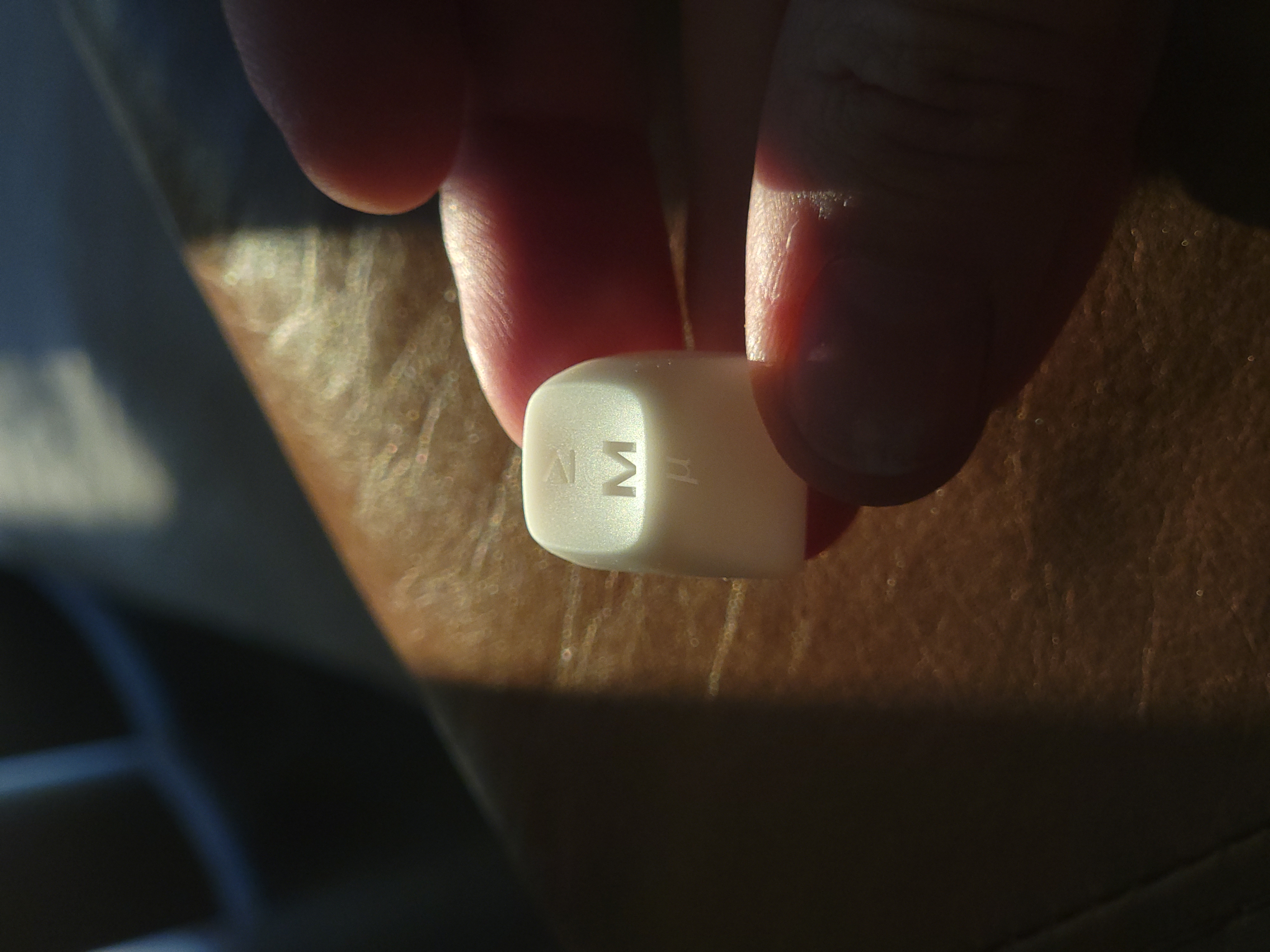

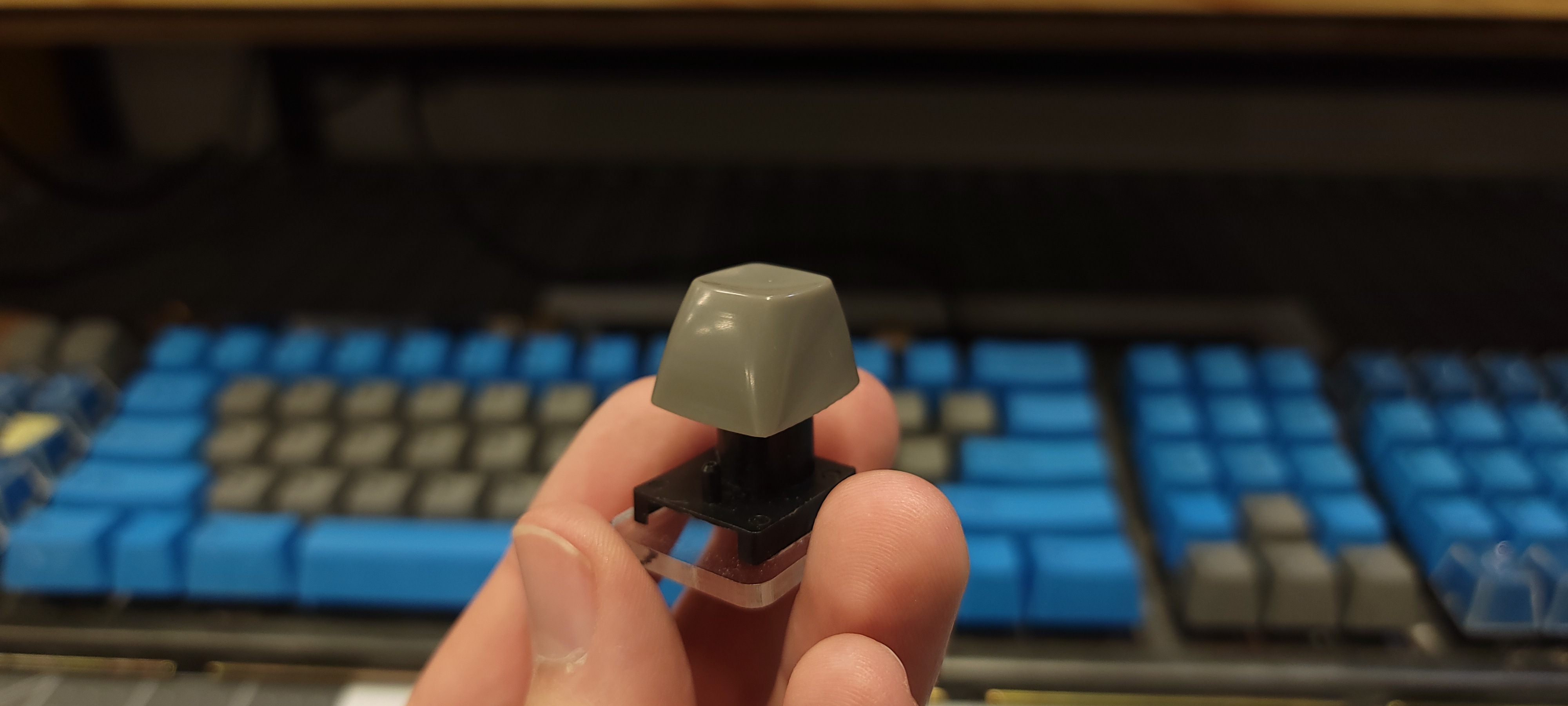

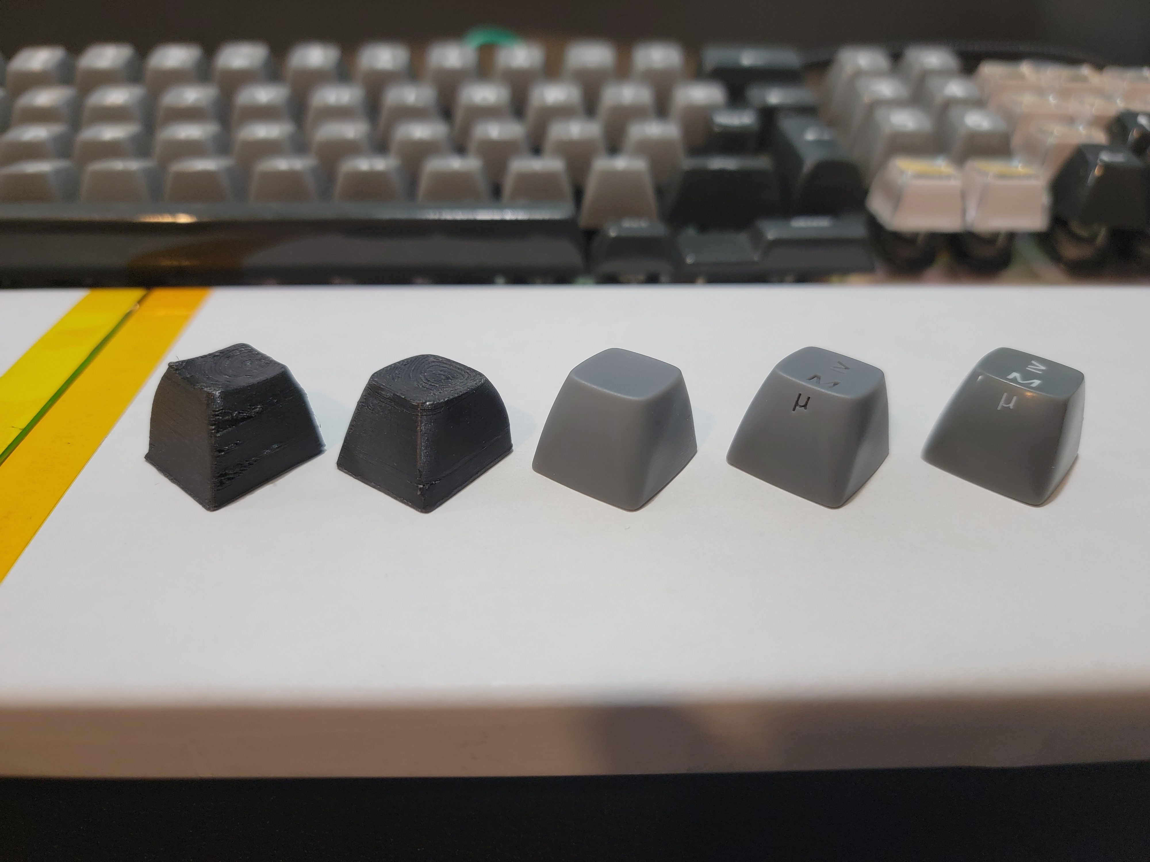

My name is Matt. In August 2021, I started 3D printing spherical keycaps for my Model F.
Here's how it started:
blob
blob
Here's how it's going:
Ooooo Shiny
Ooooo Shiny

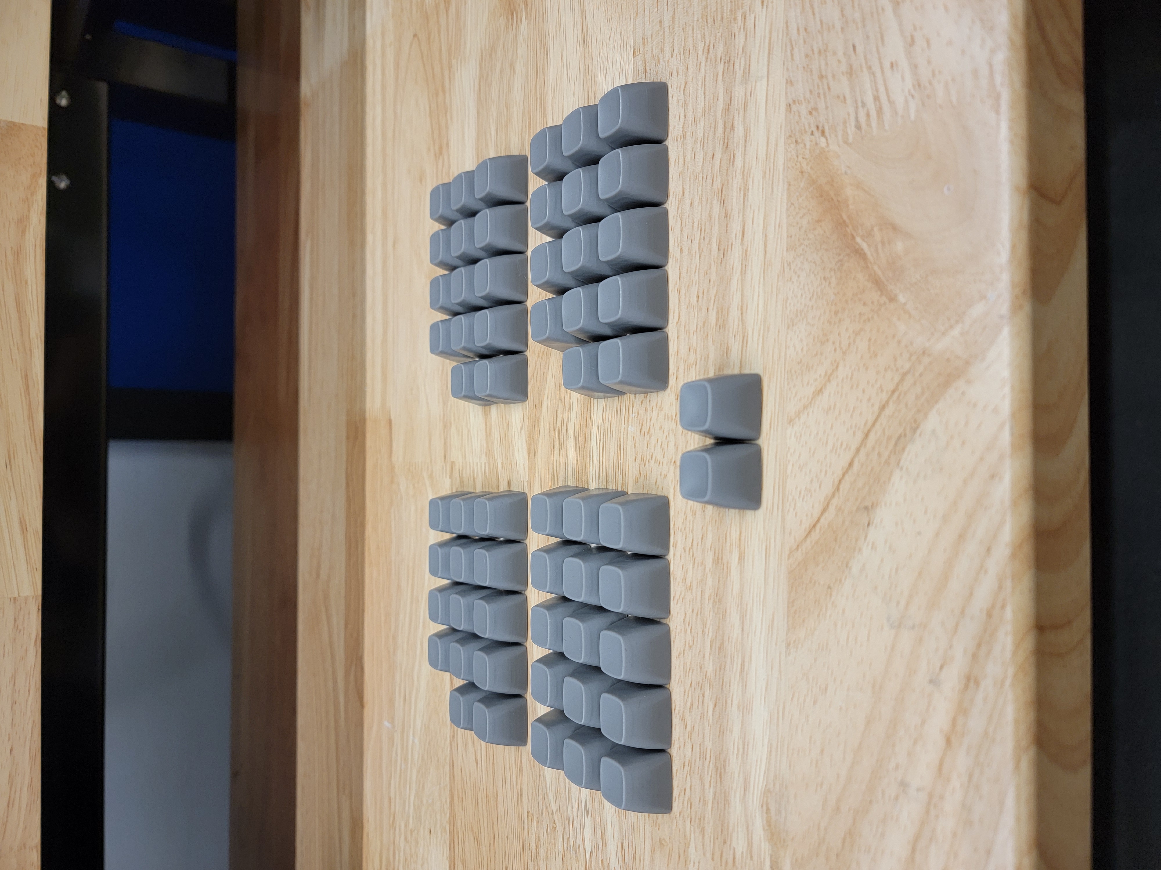

I recently made a batch of blanks for them in beamspring gray, so look for their awesome 5251-themed XT soon!
Keycap Army
Keycap Army

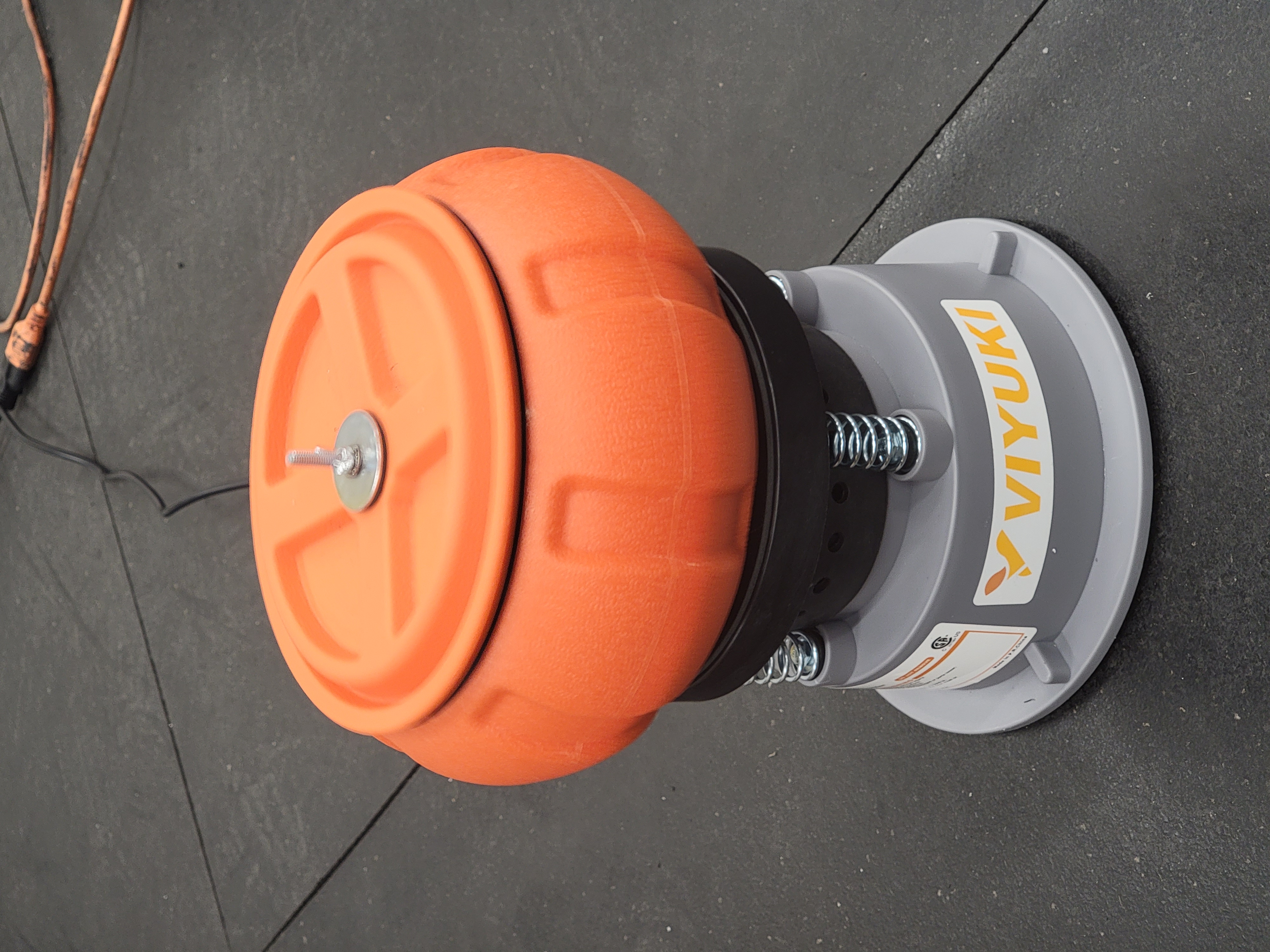

  • I bought a vibratory tumbler for polishing! It's running atm. It's loud and it looks like a pumpkin. Dice makers have been getting great results: https://youtu.be/B6_9cxKXSoA
Growling_Pumpkin
Growling_Pumpkin
Ta-ta for now!

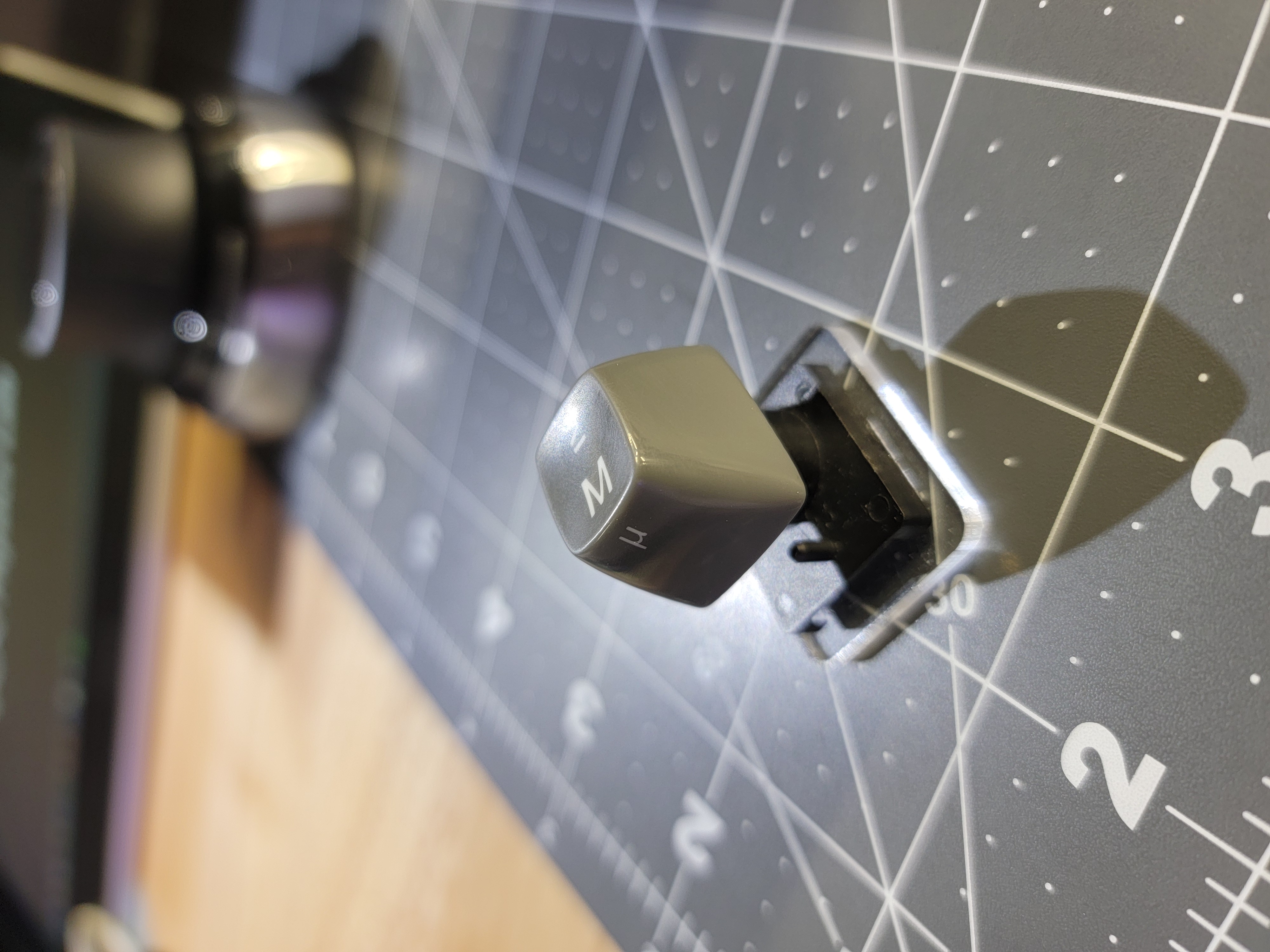

Vibratory polishing is going well. It took a bunch of testing to figure out which media and abrasive will work best (and which ones won't work at all). This test cap needed to be left in the coarse media longer to get rid of more layer lines, but it's enough of a result to say that vibratory tumbling will indeed work for resin prints. This is a critical factor in producing custom keycaps for others. I wasn't about to hand polish y'all's keycaps... More details to come in a larger update.
Tumbling Results
Tumbling Results

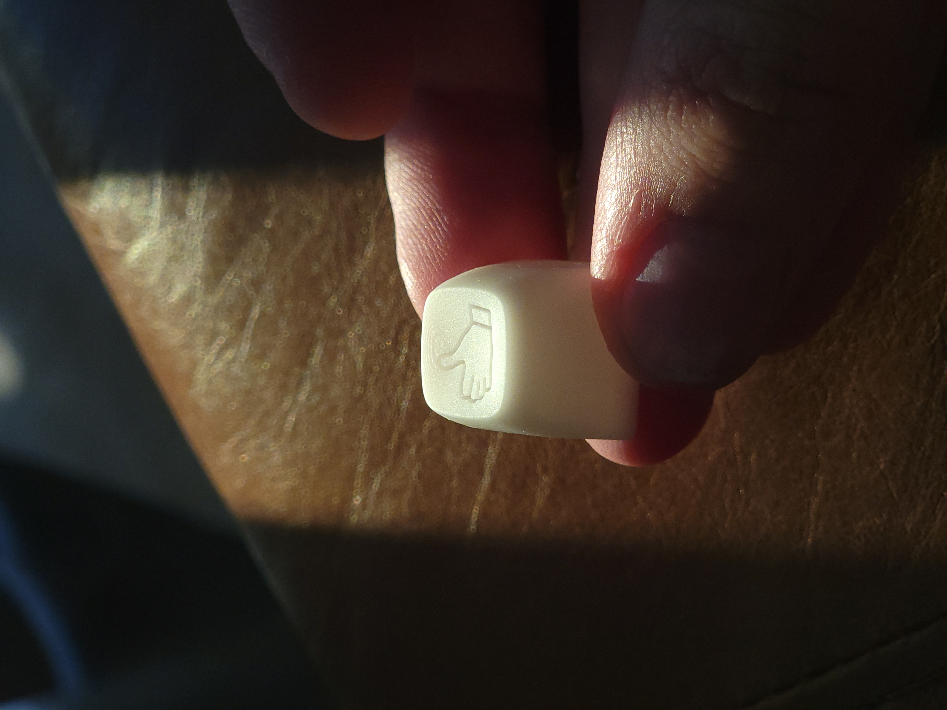

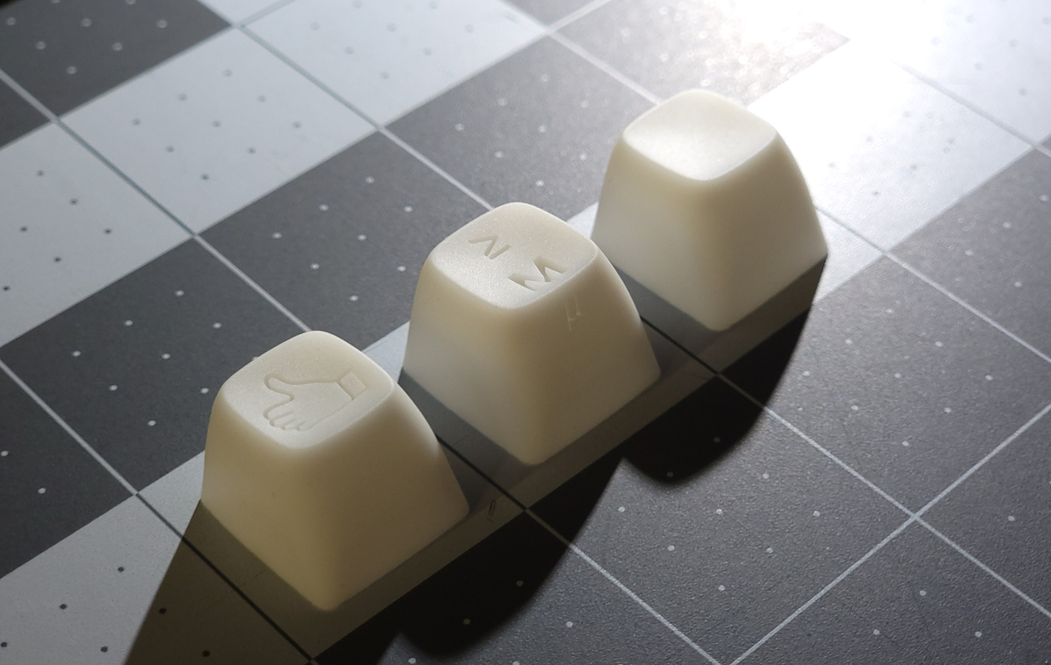

I was wondering, how do you create those razor sharp cutouts for the legends?
ThermometerSandwich
26 Jun 2022, 02:12
TNT wrote: 26 Jun 2022, 01:14 I was wondering, how do you create those razor sharp cutouts for the legends?
Thanks for asking :D The cutouts are done in Fusion 360. The depth is ~0.8 mm. The most recent pics are of caps fresh off the printer (and washed and cured). I'm using a Mars 2 Pro with a layer height of 0.02 mm. I really want to get a 8k printer though.
Exposure calibration is a must!!! Dennys Wang has a great video on the subject: https://youtu.be/vf_2OZgDCMM I had a lot of exposure issues before I started calibrating.
