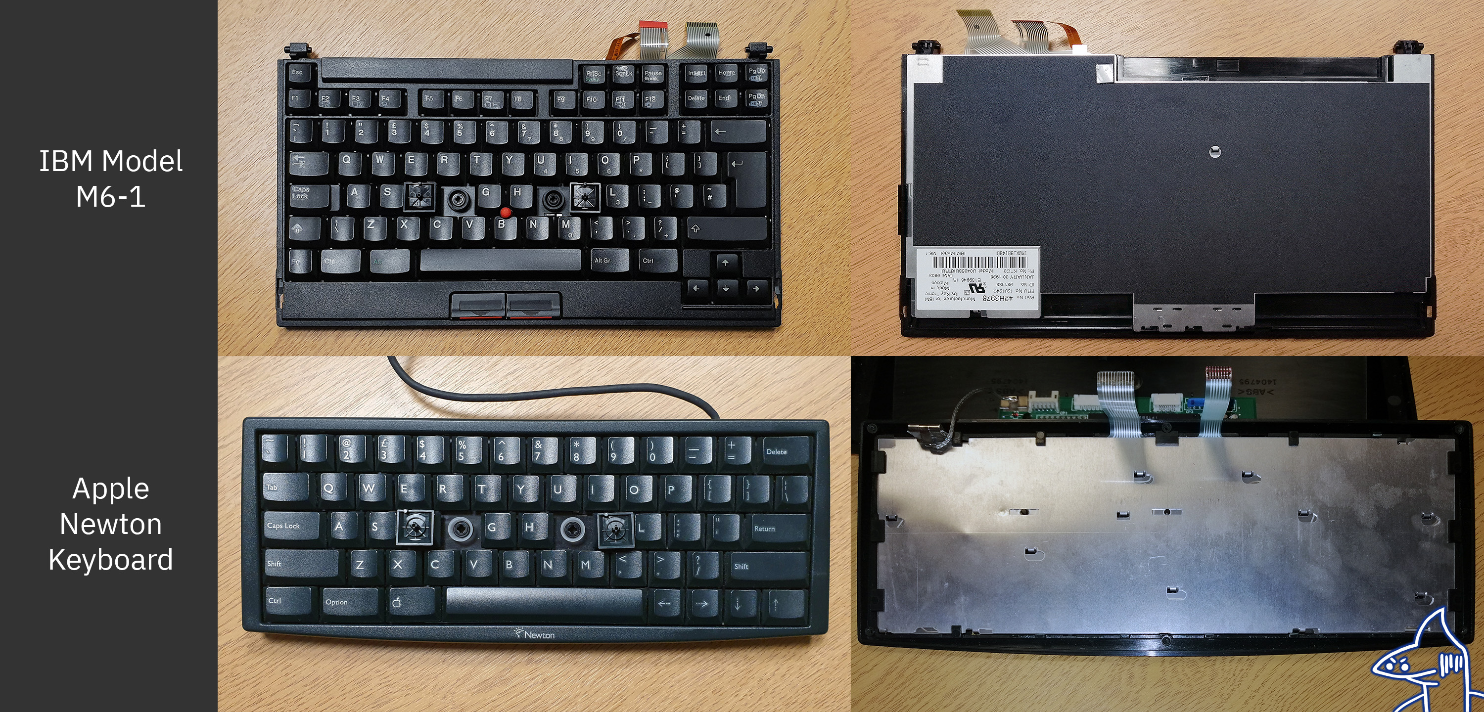

Once again, I've got more buckling sleeve Model M content but with an interesting twist this time around! The Apple Newton Keyboard (model X0044) turns out is a Lexmark keyboard design and is a derivative of the IBM ThinkPad 500 and various Lexmark Lexbook (IBM Model M6/M6-1) keyboard assemblies, something that may give both Apple and ThinkPad folk the shudders.
Included is a brief tour around the keyboard, explanation and evidence of how it's related to the Model M family (via Model M6-1), comparison of two discovered revisions, and pointers on how you can convert one to USB (including pinout diagrams)!

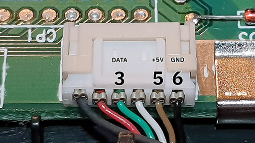

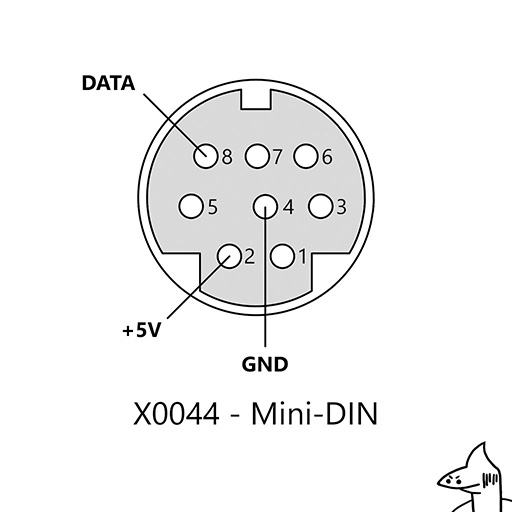

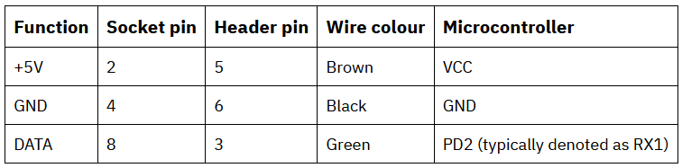

Re converting an X0044: I'll extract this part of the article for visibility and ease of further reference and finding. The X0044 is not ADB and uses a 8-pin mini-DIN connector. Thankfully, TheMK has made a port of TMK that supports this keyboard. For help with wiring, here is the plug pinout and the inner header pinout.
X0044 plug pinout.jpg (40.65 KiB) Viewed 3997 times
X0044 header pinout.jpg (105.98 KiB) Viewed 3997 times
X0044 pin mappings.png (17.14 KiB) Viewed 3997 times

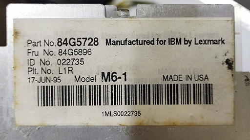

I read "Manufactured for IBM by Key Tronic".
The cross-shaped plunger with integrated snap is a design that I think is distinct for Key Tronic.
See this Key Tronic patent that uses it: (US5298706A).
sharktastica
16 Apr 2022, 01:33

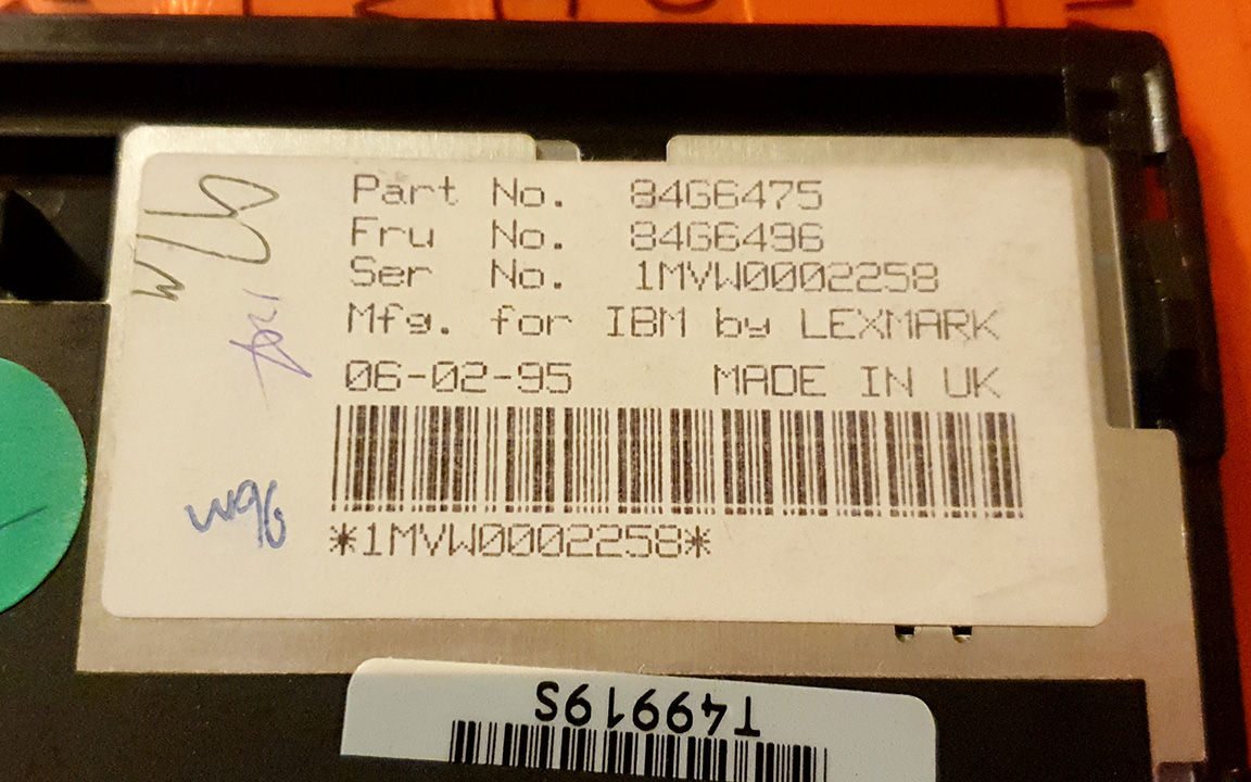

Findecanor wrote: 16 Apr 2022, 01:11 I read "Manufactured for IBM by Key Tronic".
Yes, the example I used is a later Key Tronic M6-1 because it was the most 'photogenic' I had at the time I was taking photos for this article. Doesn't make much of a difference though since KT M6-1s use the same tooling as Lexmark ones. Same as with M4s, KT took over immediate production after Lexmark 'lexited' in April 1996.

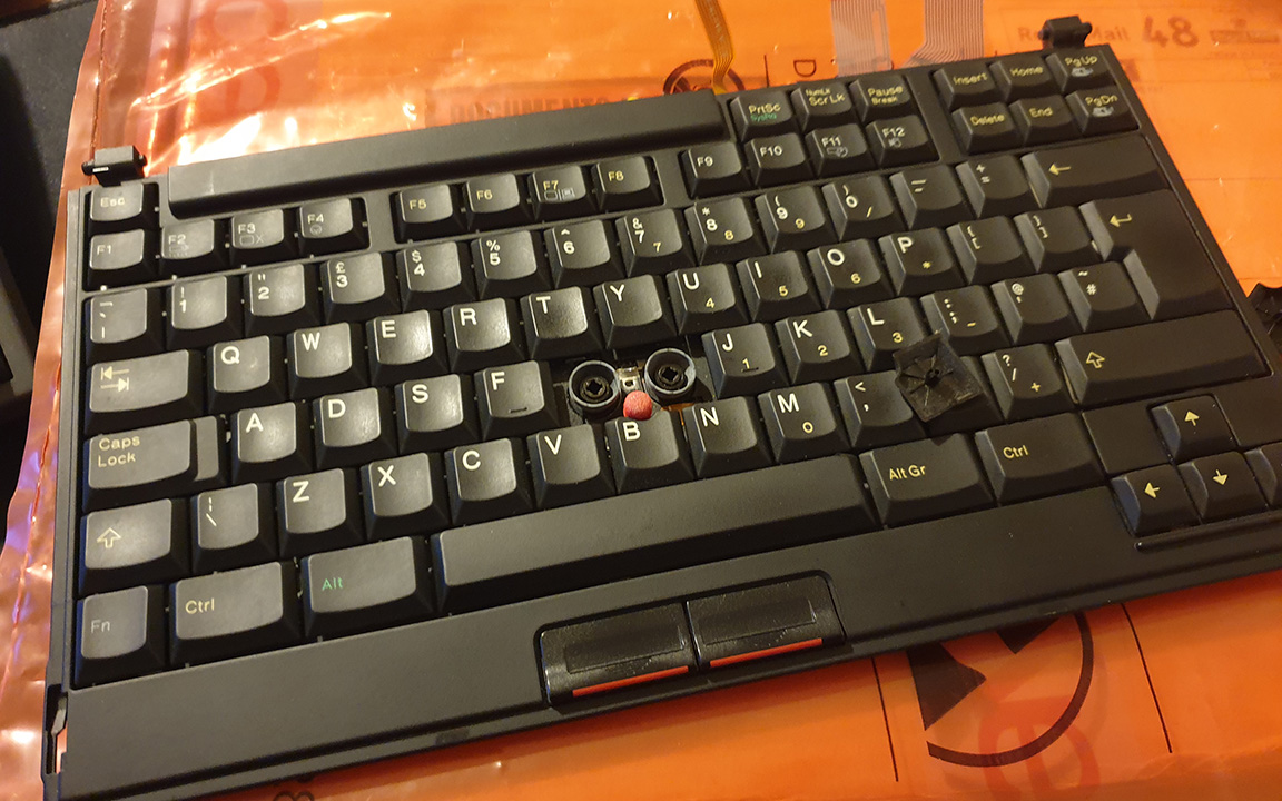

Here's a Lexmark example I got recently. I didn't retake the photos with this one since this UK-made example is missing the "M6-1" designation I wanted for show.
Here's what it should look like on a US-made example, I just didn't have my own example to take higher res photos of (but I've now included anyway in the article to hopefully resolve any future confusion):
Findecanor wrote: 16 Apr 2022, 01:11 The cross-shaped plunger with integrated snap is a design that I think is distinct for Key Tronic.
IMO, that patent looks to be more related to the IBM TrackWrite Keyboard that KT made for the ThinkPads 701C and 701Cs. Those match the sleeve orientation shown in that patent and use a plunger (although of a different shape). M6s and M6-1s use a barrel fixed slider instead with the keycap having a small crosspoint mount. That said, I can't find any specific patents that match these designs but then again I can't find any for the earlier version the M3 had (and the M4s also used) that predate both of these designs (would have been circa 1990).

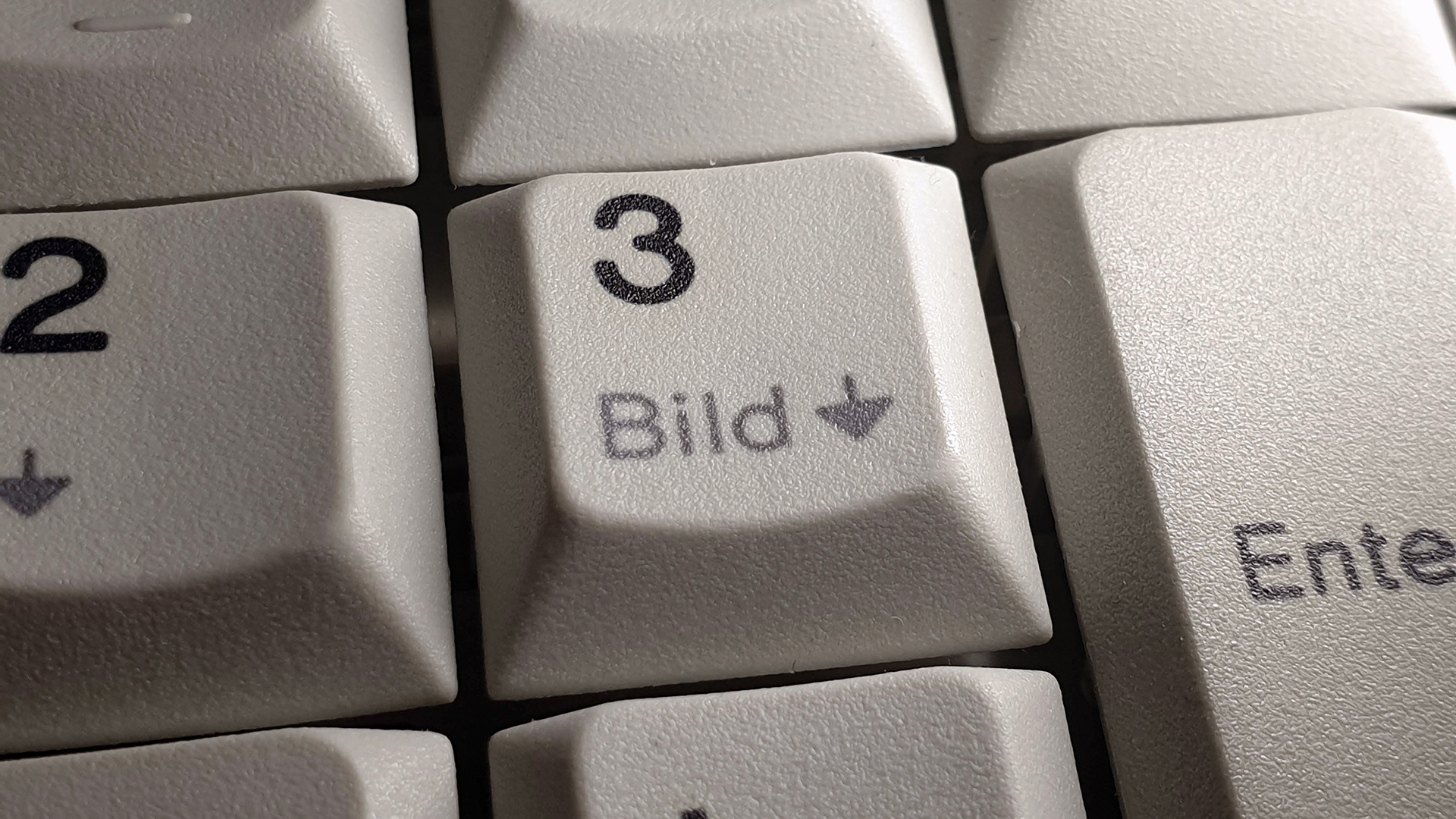

Muirium wrote: 16 Apr 2022, 18:59 They do come in dyesub and compact layouts, right? :roll:
Pretty much all biege IBM buckling sleeve keyboards pre 2002 seem to be PBT dye-subs. The Models M3 and M4s certainly are, and the Models M7, M8, M9 and M11 POS keyboards made by Lexmark and Maxi Switch were too. However, after 2002, IBM changed OEMs for their POS keyboards that changed to lasered and pad-printed legends.
Here's a close-up of my M3 keypad's legends:
In terms of compact layout, that'd be the Model M4/M4-1. It's a compressed tenkeyless design (compressed since the inner keyboard assembly was originally the Model M3 fitted on the IBM PS/2 L40SX and CL57SX).
