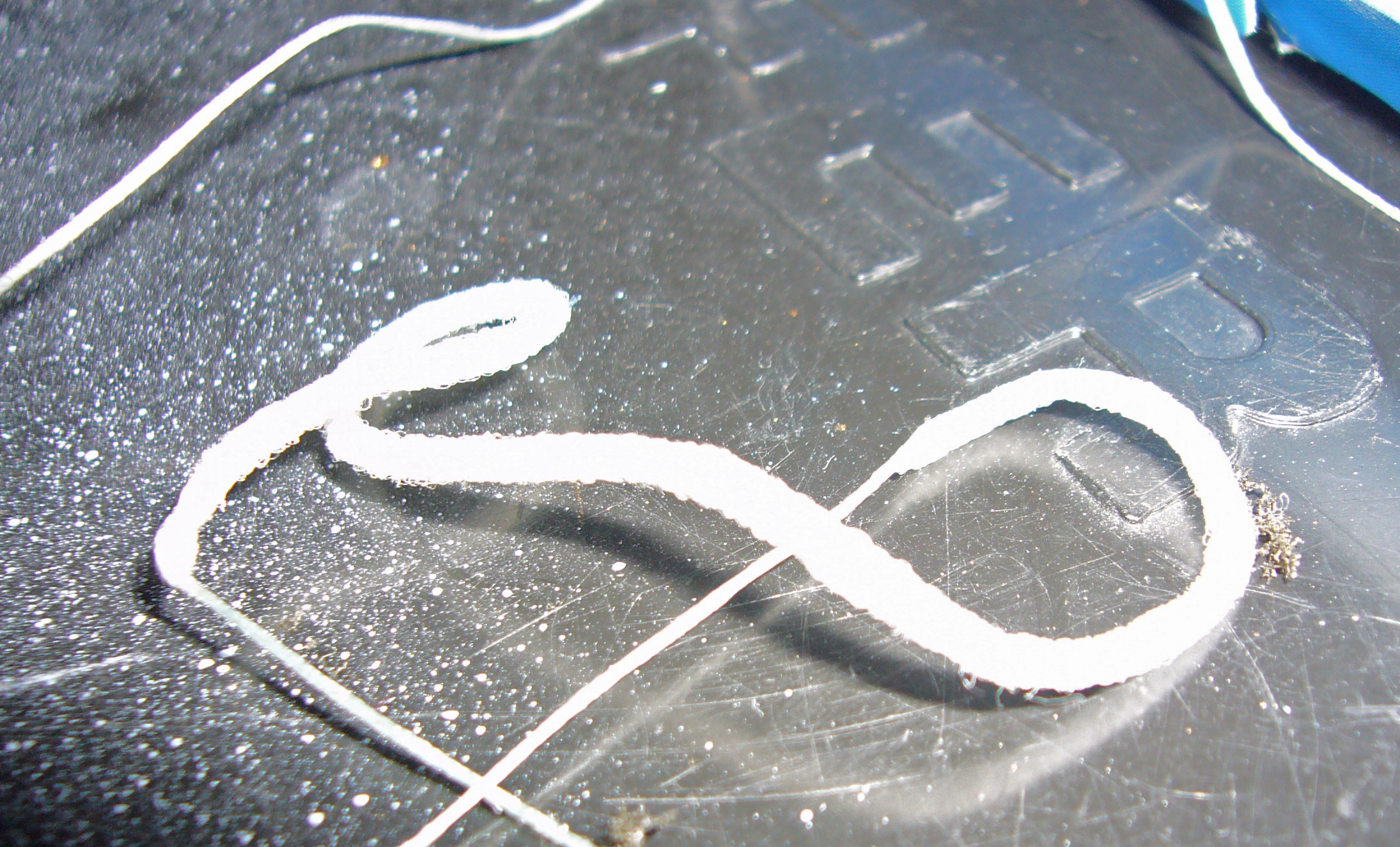

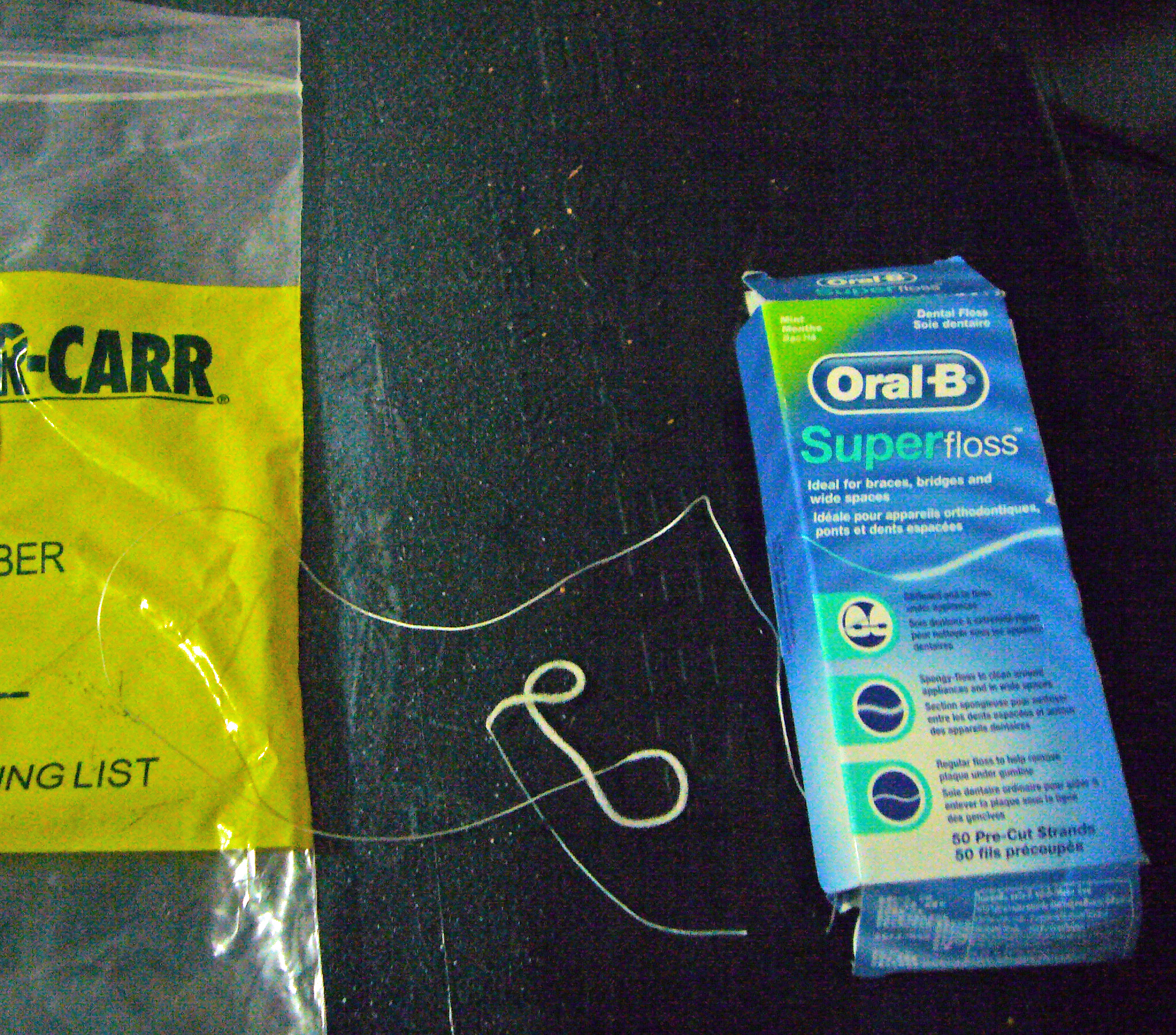

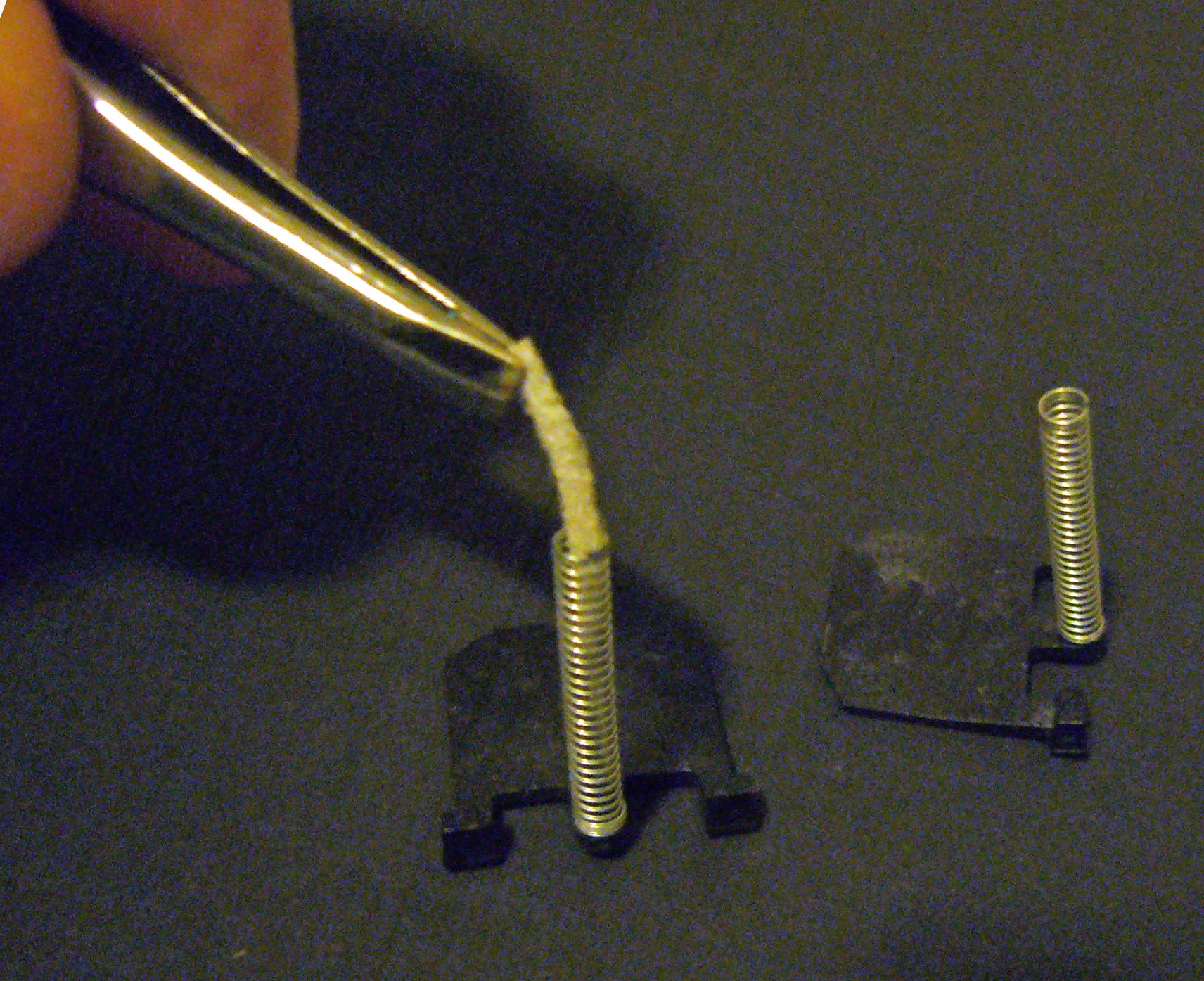

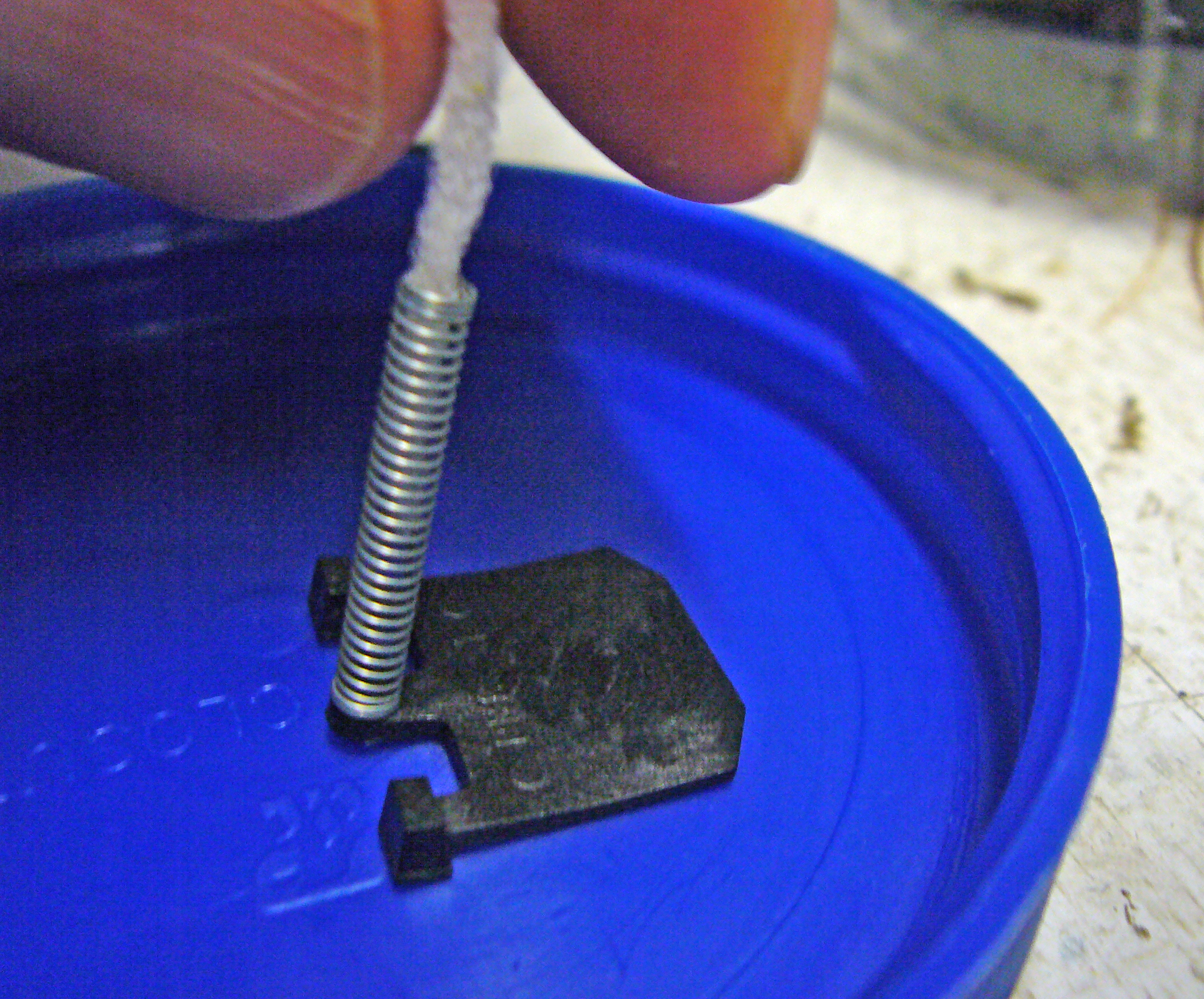

The floss mod can be a big help by reducing ringing (aka singing) overtones that may be the primary source of your neighbors' irritation.
- F-122-floss-mod-004.JPG (389.39 KiB) Viewed 8531 times
- F-122-floss-mod-003.jpg (3.97 MiB) Viewed 8531 times
- F-122-floss-mod-002.jpg (2.52 MiB) Viewed 8531 times
- F-122-floss-mod-001.jpg (4.95 MiB) Viewed 8531 times

This video shows before & after & the process of floss modding
https://www.youtube.com/watch?v=VD0AUUwh7cc
When I've done it in the past, I've never noticed a difference in feel, but the sound (to me at least) sounds arguably better since the ringing kind of gets on my nerves when I'm not wearing headphones while typing - and the floss mod eliminates said ringing.

I've done this floss mod and didn't think it made a significant difference as far as 'office collateral damage' type things go.

FWIW, I floss modded my daily driver Model M a while ago and then had to laboriously un-floss mod it as it was driving me nuts with inconsistent sound and feel between keys. Maybe I didn't do it right but I'm not sure how precise you can be with bits of fuzzy polyester string anyway.
