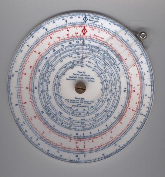

If you like, I could convert that number into old Danish units, using this :
