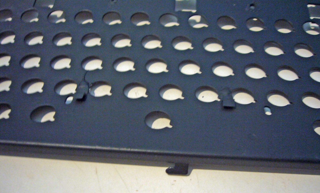

There are now multiple methods for stabilizing Model M space bars in non-standard applications.Muirium wrote: 25 May 2022, 10:04
Scuffy spacebars, wobbly spacebars, shiny, tacky, chintzy spacebars all drive me nuts.
The simplest is using 7/16" SAE washers (there may not be a metric equivalent) which can stop the C-V and M-. keys a whisker short of the regular bottom-out depression which might bother a heavy hitter.
The best (although I have never seen Ellipse's new part) is to fabricate your own hold-down tabs unless, even if they aren't visible, you can't stand knowing that they are there.

I tried the washers on my Kishsaver. I must have done it wrong because the result was comically awful! Lots of nasty metal sound from the washer(s) (this was maybe 2014 so I forget how many and in what configurations I used that one afternoon) and still persistent wobble. I just had to whip it out before I disgraced my beloved Kishsaver too much for it soon forgive me!
After that experience, I balked good and hard at the idea of epoxy putty for making my own stab clips, as you’d expect. If it ain’t broke, etc.

Those in my photo were sheet metal (from the top of a food can) bent to shape and epoxied down. Being on the thinner side, they have the advantage of being able to be bent slightly to "tune" their hold-down effect.
Were you using actual 7/16" SAE washers as wcass recommended? The SAE part is imperative. They do rattle a bit, but unflossed Model Fs are pretty noisy anyway.
Another method is to use a material like the 60 mil EPDM roofing material that I used to sell for mats. If you cut a rectangle about 6-7 units wide and punch 6-7 holes to slip over the C-V-B-N-M-, barrels and stop the bottom flap short of the barrel for the space bar, you don't get any rattles.

As I recall, yes, I got the exact type and dimensions. I expected better. No matter how many or few I tried, they jangled around like coins in there! It made me chuckle and wince, at once. Either I’d been had, or I was so wrong about this self evidently simple procedure I couldn’t even…
Still, at least it was undestructive and quick enough I could just pop back to the hardware store to return them!
I’m fine with my Kishsaver as is. My lasting interest in these Model F spacebar stab mods is really about ANSI mod on my AT, and just what to do if we ever get around to Model MFs again.

You only use 2 washers, one on each barrel, I used V and M. I contemplated dipping them in "Plasti-Dip" (there must be many others) like you would for the handles on a pair of pliers, but never bothered.Muirium wrote: 25 May 2022, 17:08
