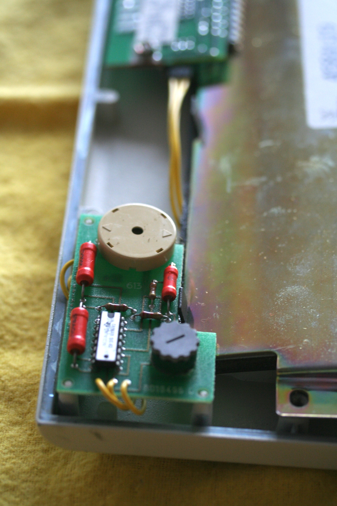

The 4704 Kishsaver has a beeper. Not a speaker per se but one of these:
viewtopic.php?p=160956#p160956
It produces a medium high pitched EEEEP when activated, which sounds like a sawtooth wave rather than sine or gnarly square wave to me, as I recall. There’s a volume knob on the underside of the keyboard I keep habitually at zero! :D
I’ll dial it up sometime and see.
In any case, it surely sounds nothing at all like the solenoid in my beamspring. But the psychological effect is identical: BIP BIP BIPITTY-BIPITTY BIP. Ugh. I’m turning this hyperactive feedback off! :lol:

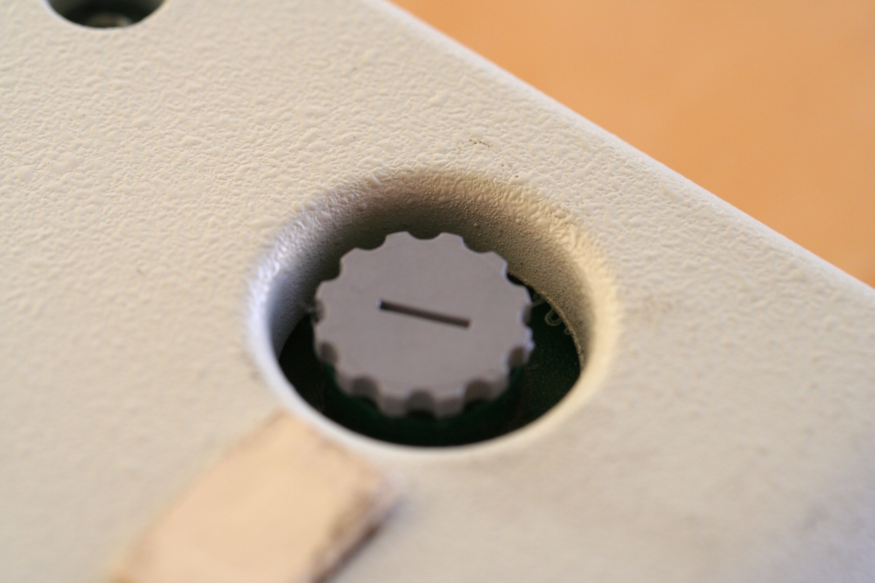

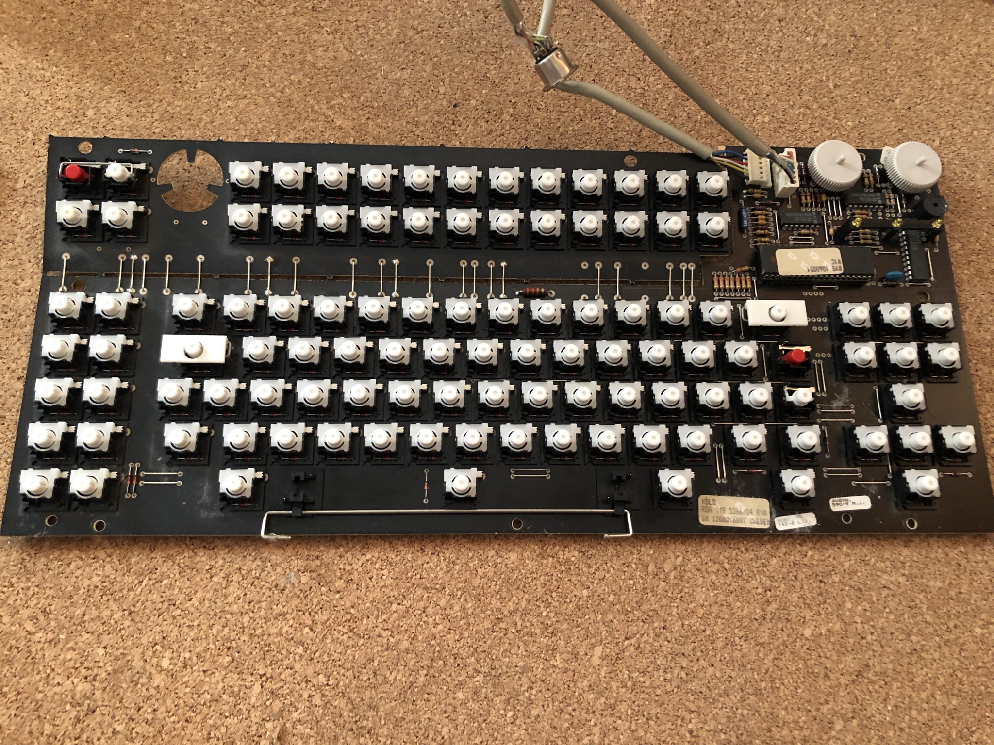

My Telekom branded Ericcson Unsaver Keyboard has a very similar Buzzer as the one from Muirium.
download/file.php?id=73259
U can change its Loudness with one of the two scrollwheels. (Both Buzzer and Scrollwheels are at the top right)
As for the Sound , its a short, relatively high pitched metallic click it produces.
In low volume quite pleasant.

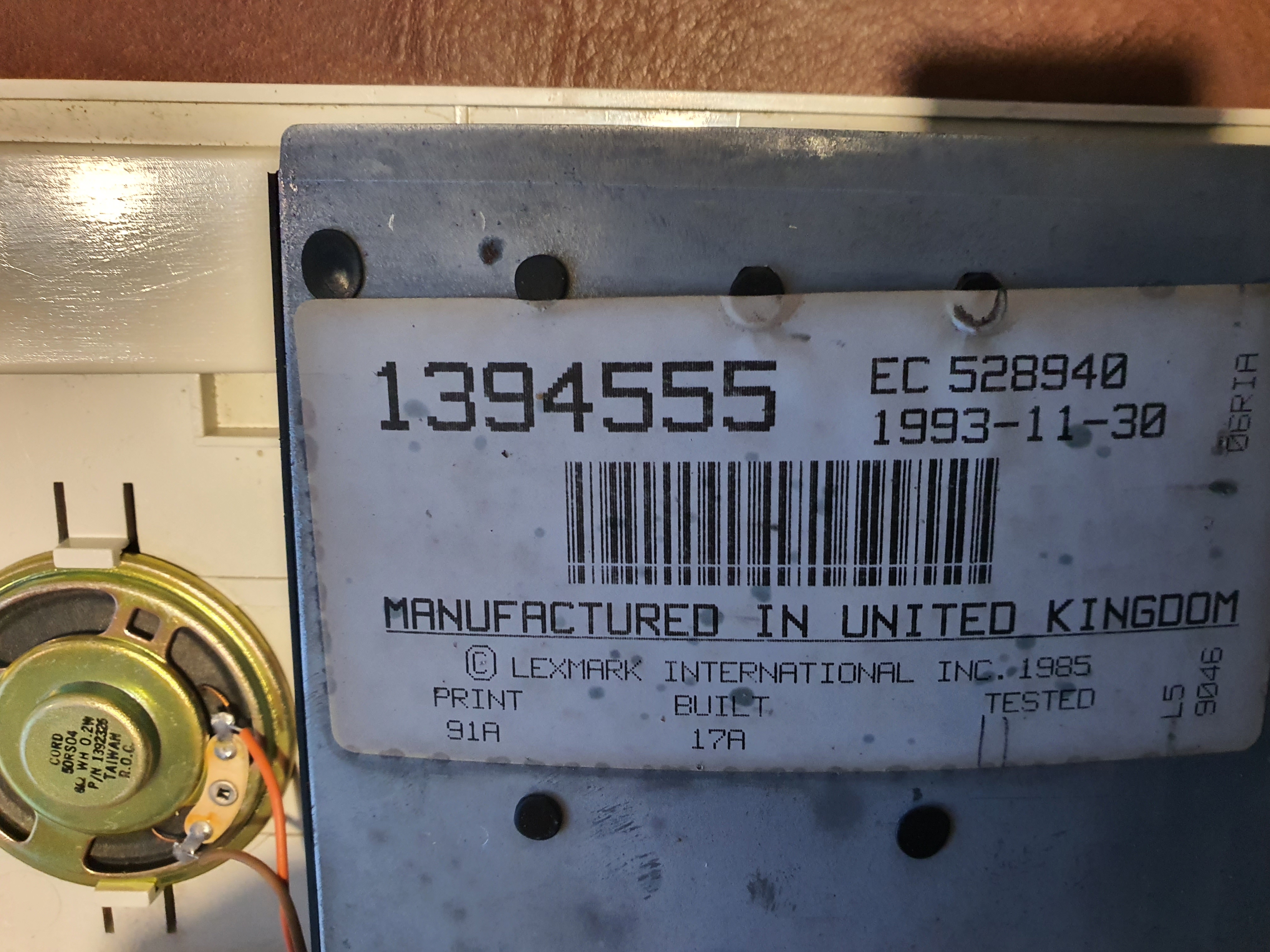

Three examples of IBM model M keyboards that have IBM OEM speakers installed into rear keyboard case.
IBM part# 1394540
https://www.clickykeyboards.com/product ... h-speaker/
IBM part# 51G8572
https://www.clickykeyboards.com/product ... speaker-2/
IBM part# 8184692
https://www.clickykeyboards.com/product ... 10-mar-94/

Muirium wrote: 25 May 2022, 17:13 Are we certain IBM / Lexmark ever actually shipped any fitted speakers at all?
It was usually present for Model Ms destined for IBM RT PCs (such as P/N 1392366) and RS/6000 workstations (like the three clickykeyboards posted).
