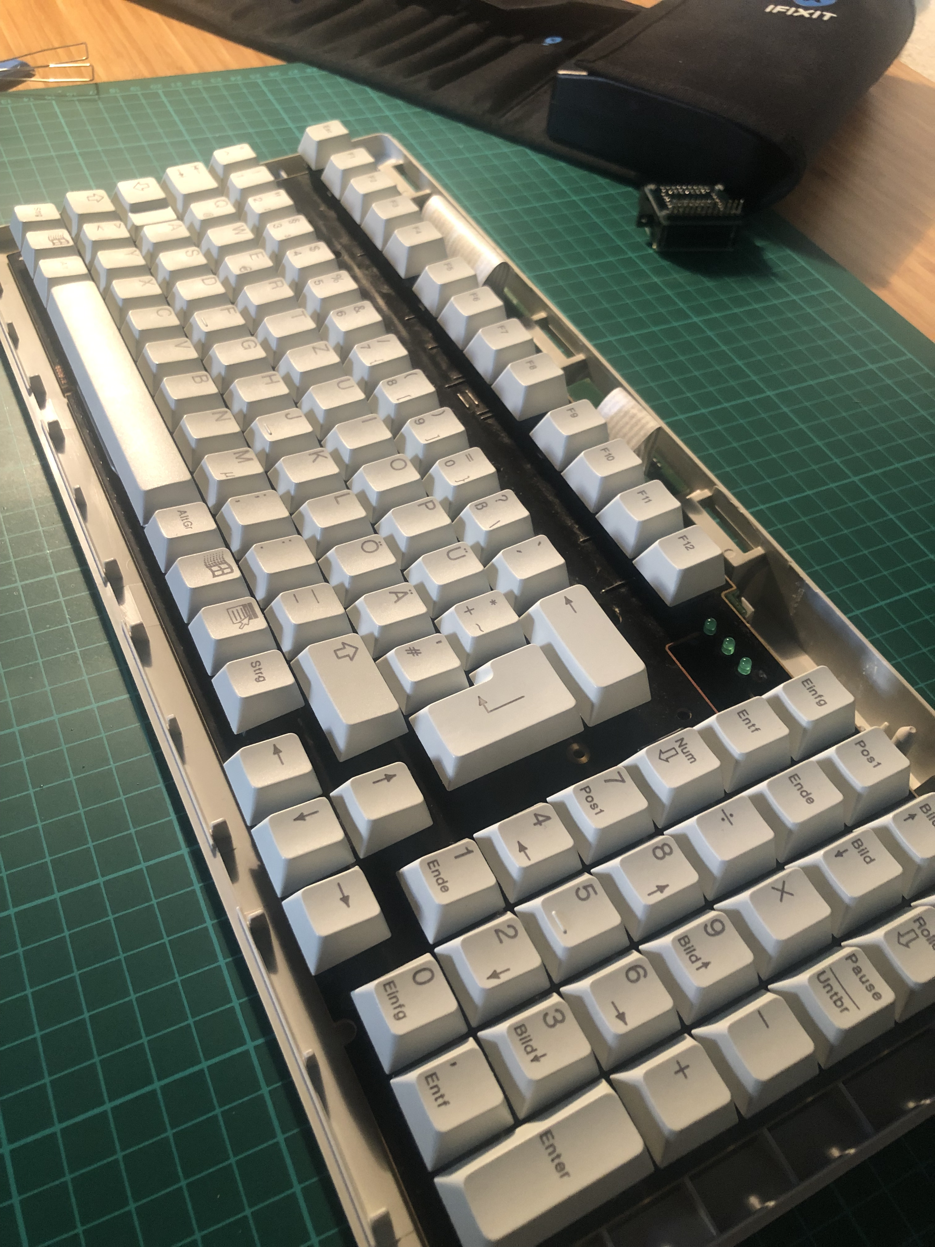

Hello Dear Community,
i recently bought a cheap lauren fischer branded cherry g80 for basically nothing
download/file.php?mode=view&id=74250
I just bought it cause i thought it could have vint blacks ( i know :? ) in it.
no branding nor sticker at the back. no idea if they are vintage (westgermany built , cause thats where i live) mx blacks.
download/file.php?mode=view&id=74258
Well , i kinda fell in love with it. The way the board flexes a bit, they "smooth" feel of old cherry mx blacks, the simple aesthetic.

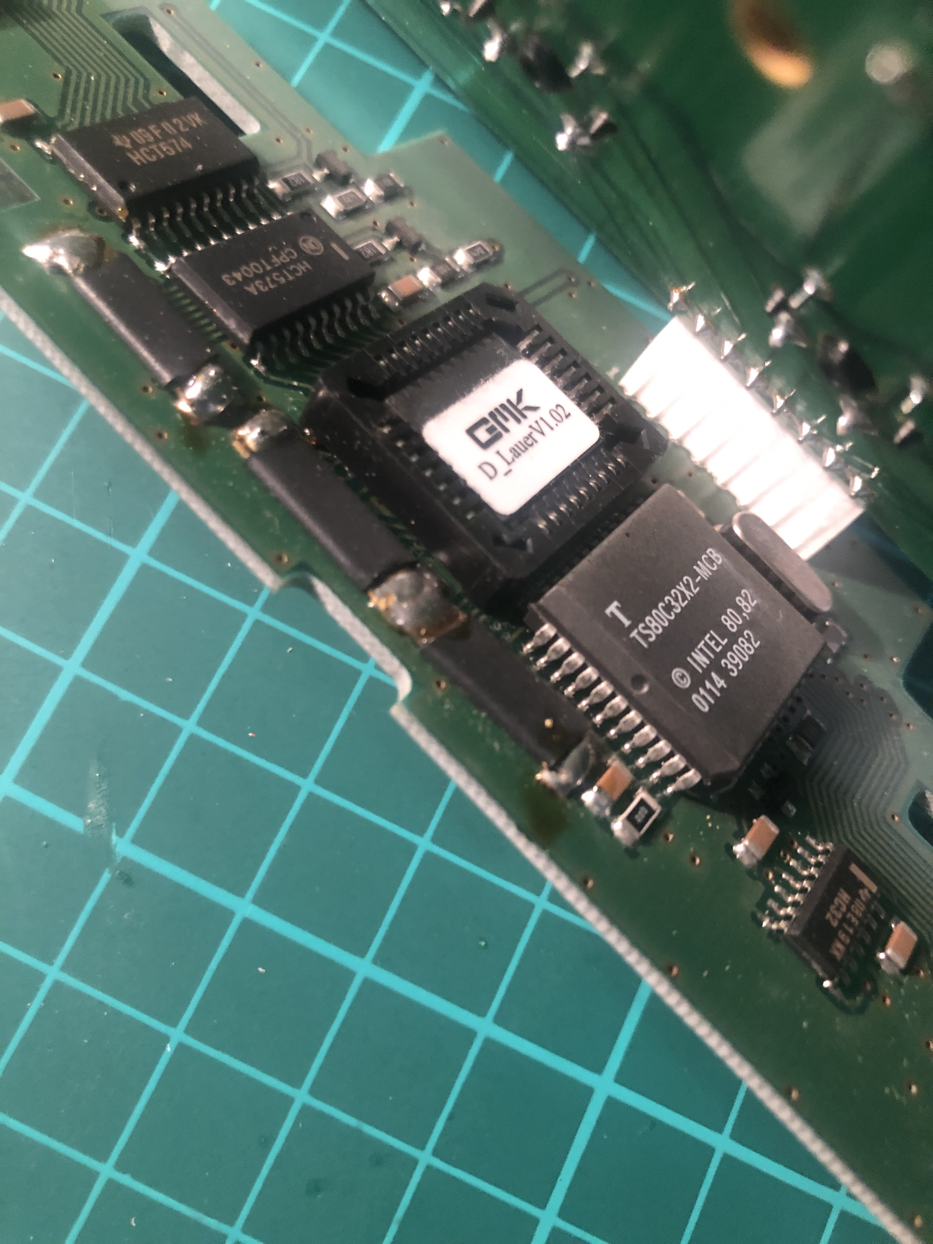

Some Random things that say GMK fell into my view.
download/file.php?mode=view&id=74256
My Plan is, to tinker a bit with it , put some non conductive putty in the hollow shell , maybe retrobright or airbrush it ( or maybe hammerit , for that norbauer vibe) , treat the stabs with some lube and most importantly: mod it to usb c.
download/file.php?mode=view&id=74257

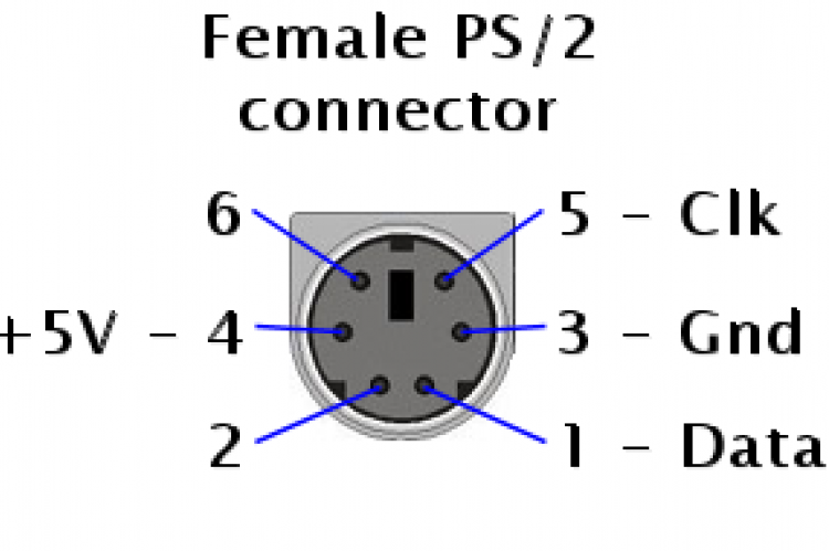

Now comes my question.
Can that even be done, while not using that much space. The best thing for me would be , if it can be integrated into the shell of the keyboard.
I have decent soldering skills and really basic experience with coding.
Do u Guys and Girls have any ressources or sites u can point to ?
I only heard from soarer´s software and found stuff like that:
https://www.tinkerboy.xyz/product/tinke ... -firmware/
online as a prebuilt to buy.

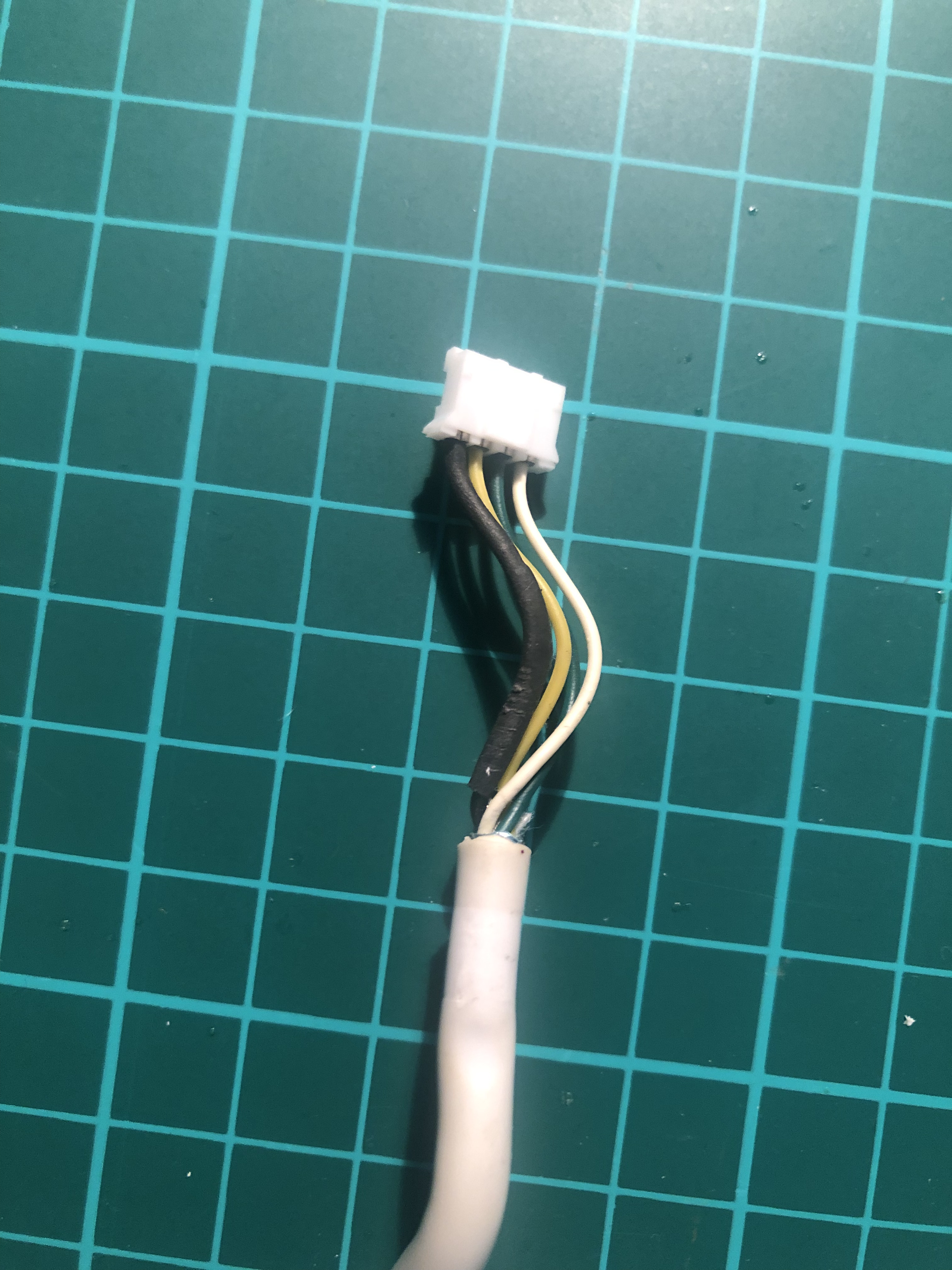

Or does it simply work 1 to 1:
download/file.php?mode=view&id=74254
download/file.php?mode=view&id=74253

13 Jun 2022, 21:20
There should be some room under the nav keys, if I remember correctly.
You could get a microcontroller board with a ATmega32u4 microcontroller on it for €5 if you're lucky, flash Soarer's or the TMK PS/2 converter firmware to it and fit it under there (with some insulating tape).
The Pro Micro (clone) is popular, but another with the same chip could be used if it can be flashed over USB and it exposes the pins that the firmware uses.
You could figure out the pinout of the internal connector using a multimeter to check the cable.

13 Jun 2022, 23:06
I'm sorry: forgot one important thing: The board should be a version that runs on 5V.
(3.3V Pro Micro has a jumper to make it run on 5V)
Microcontroller boards with the ATmega32U4 chip, such as the Pro Micro should otherwise be very common, found at any store that caters to electronics hobbyists. Also common on eBay and AliExpress among others.
A German components store that you know might be best for you if you are in Germany. That's why I didn't post any links.
Anyway, here's one.
Some stores that cater especially to DIY keyboard hobbyists also tend to have Pro Micro-clones with a USB-C socket, but in this case, I don't think it would be of much use unless you would mount the board so that the connector sticks out of the case.
