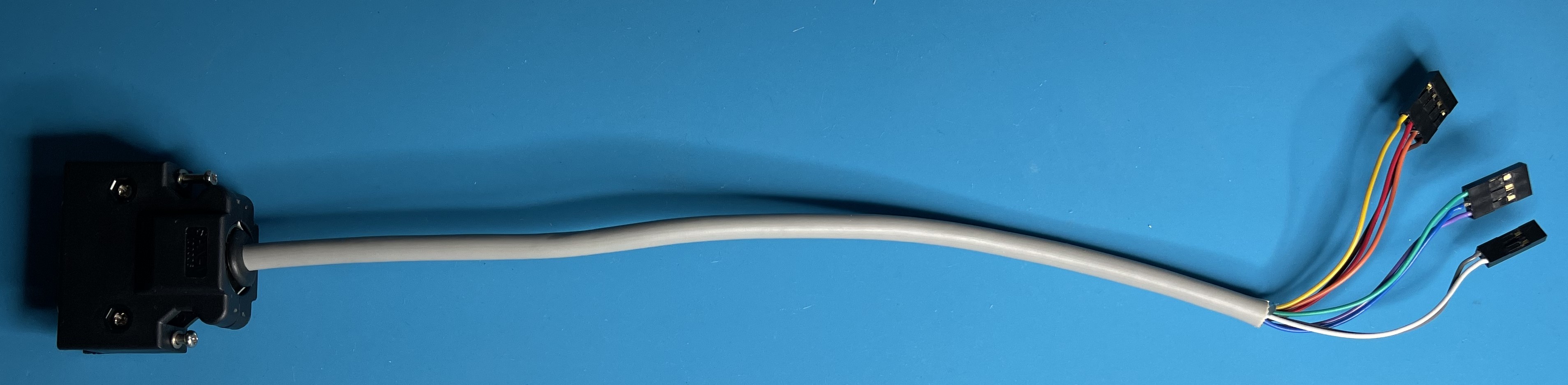

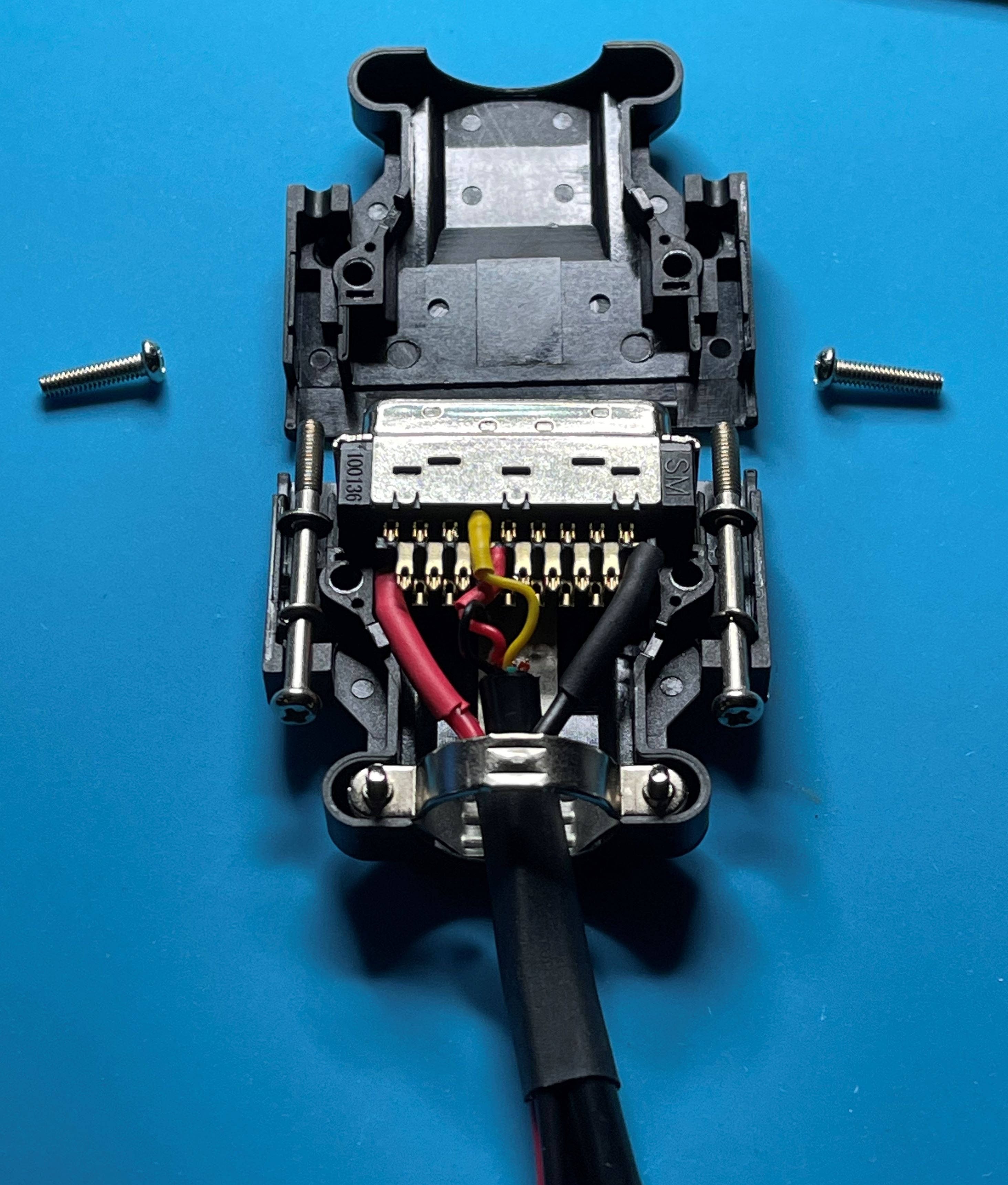

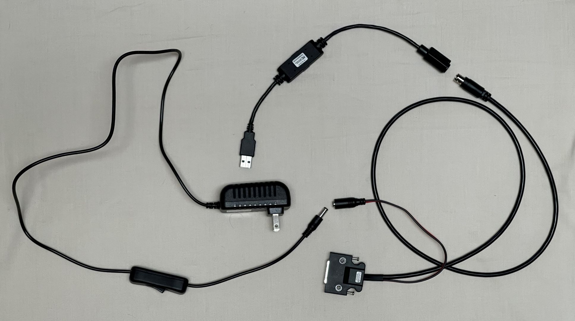

The easiest way to interface without a Connector Box is using PS2. Get an MDR 36 male connector from AliExpress or eBay. Build a cable that gives 12VDC from a wall wart to the two ends of the connector (- 1,19, + 18,36) and wires a 6-pin mini-DIN male (cut up an old cable) to Port 1 Clock, Data, and Ground in the center (12, 30, 11). Then, if USB is required, use a dumb converter or Soarer's or TMK. Note: it is not practical to power the keyboard just from USB with a boost converter; it needs too much current.
Observe that this is just an adapter with appropriate connectors; there are no active components (except in the Soarer's).
Even though Port 2 is labeled on Connector Boxes for a mouse, it can also be assigned to a WS keyboard. This means that by connecting two DIN connectors to each of Port 1 and Port 2, it is possible to have two keyboards and switch between them.
If one already had a Sun converter, it could be connected to the inverted TTL serial Port 3. As might be expected, the baud rate isn't fixed to 1200 and the nominal keyboard and mouse ports can be assigned to anything.

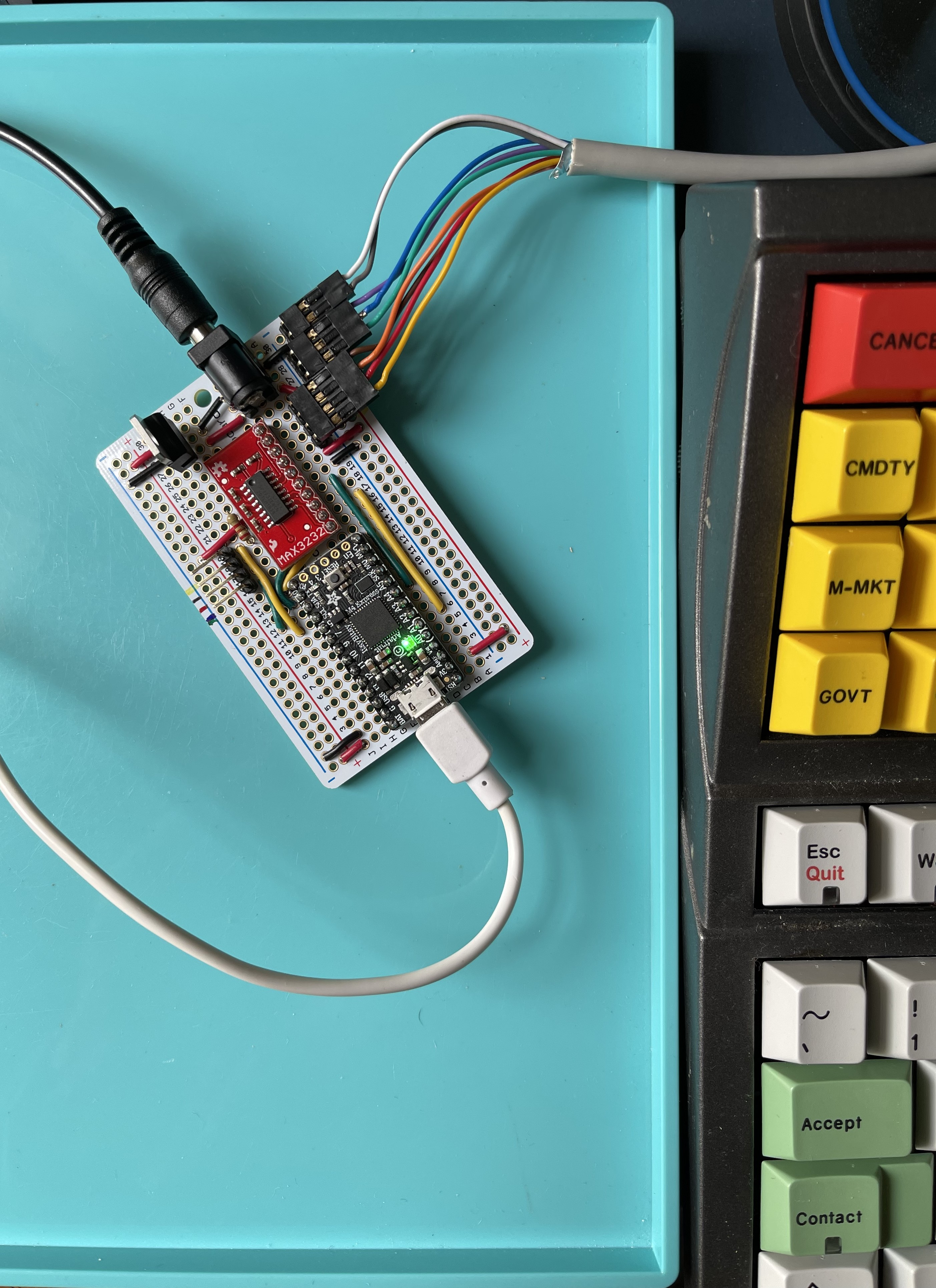

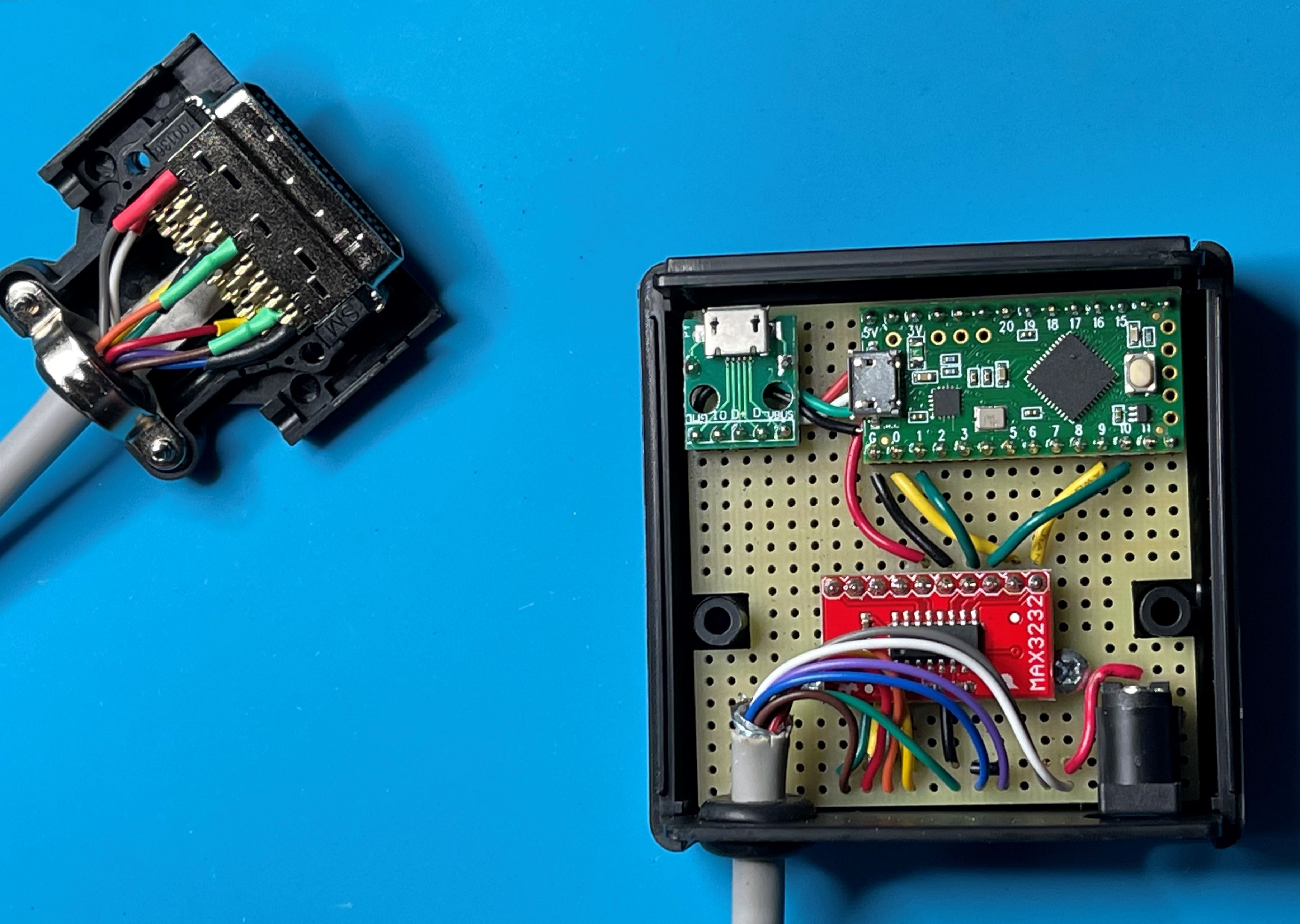

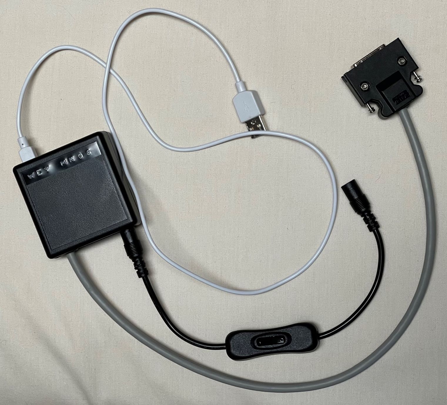

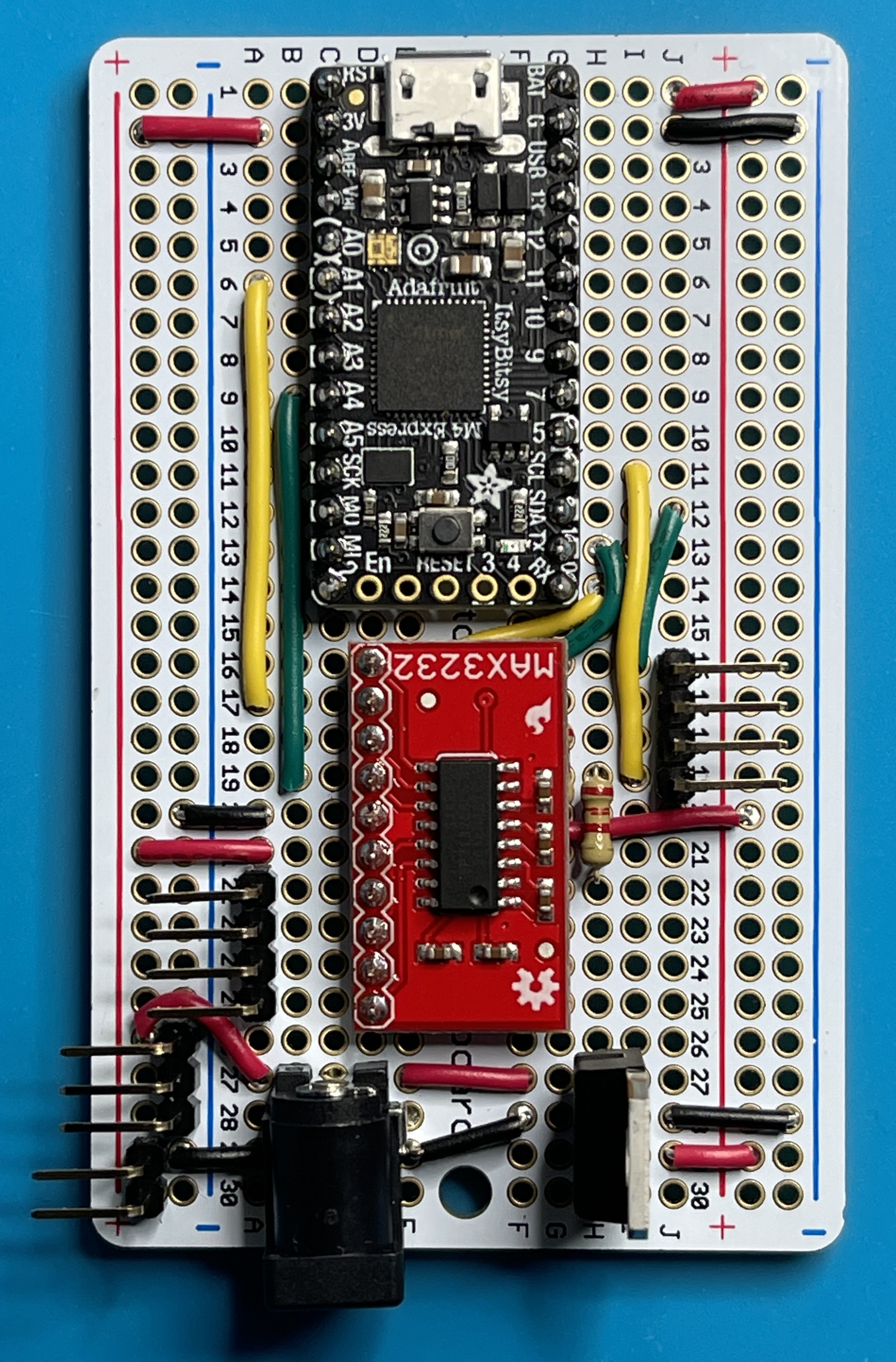

A converter specifically for the MK06 interfaces to one of the serial ports. This could be directly to Port 4 or Port 5 and so implementing a single workstation. More interesting is to implement the DLINK protocol and so work for multiple workstations, possibly with different layouts or function keys or macros. Even better is to also implement the Host Terminal protocol. DLINK multiplexes the actual keyboard / mouse data for a WS. But the Host is informed of which WS is active, allowing the converter to change layers in response, for instance.
Because of the RS-232 or RS-423 voltage levels, a transceiver like the MAX3232 is needed.
An 8-bit AVR like the Teensy 2.0 or Pro Micro is not a great choice, because it only has one UART. Also powering the MAX3232 with 5V means its driver will do ±10V, fine for RS-232, but out of spec for the RS-423 receiver chip in the keyboard, which is rated for ±7V. One of the QMK-supported 32-bit Teensies is fine: they have (at least) two UARTs, plus 3.3V power to the MAX3232 means ±6.6V. Teensy 3.2 is slightly better because it has a FIFO, which would enable running DLINK at a fast baud rate, and more program memory. But they are out of stock everywhere and NXP isn't planning to even start making the chips again until next year. So I just used a Teensy LC.
Concerns about baud rate turned out not to matter, as the External Port always runs at 9600, no matter what it is configured to, at least in the firmware I have here.
MMcM
18 Jun 2022, 16:44

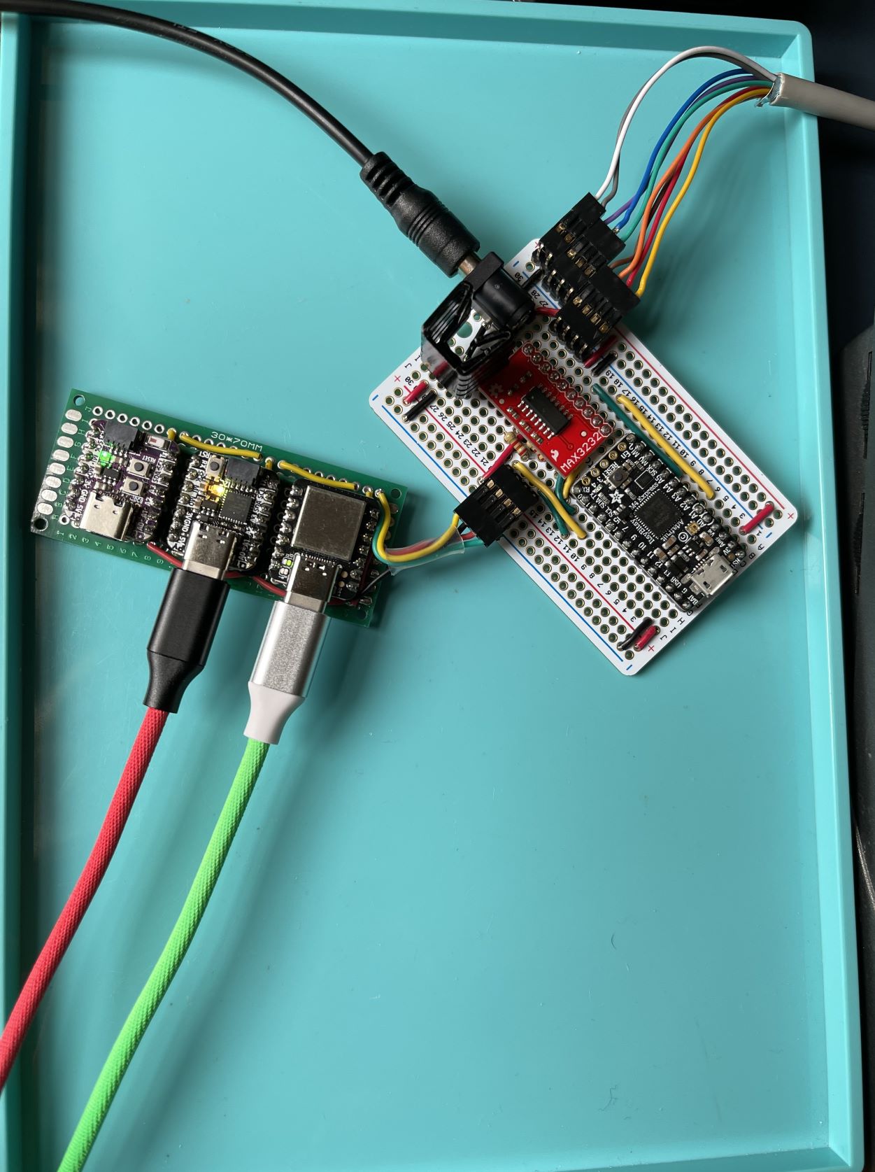

The global chip shortage got me thinking, though, about going outside the QMK ecosystem to CircuitPython. So, here is one with an Itsy-Bitsy M4 Express using the Atmel SAMD51.

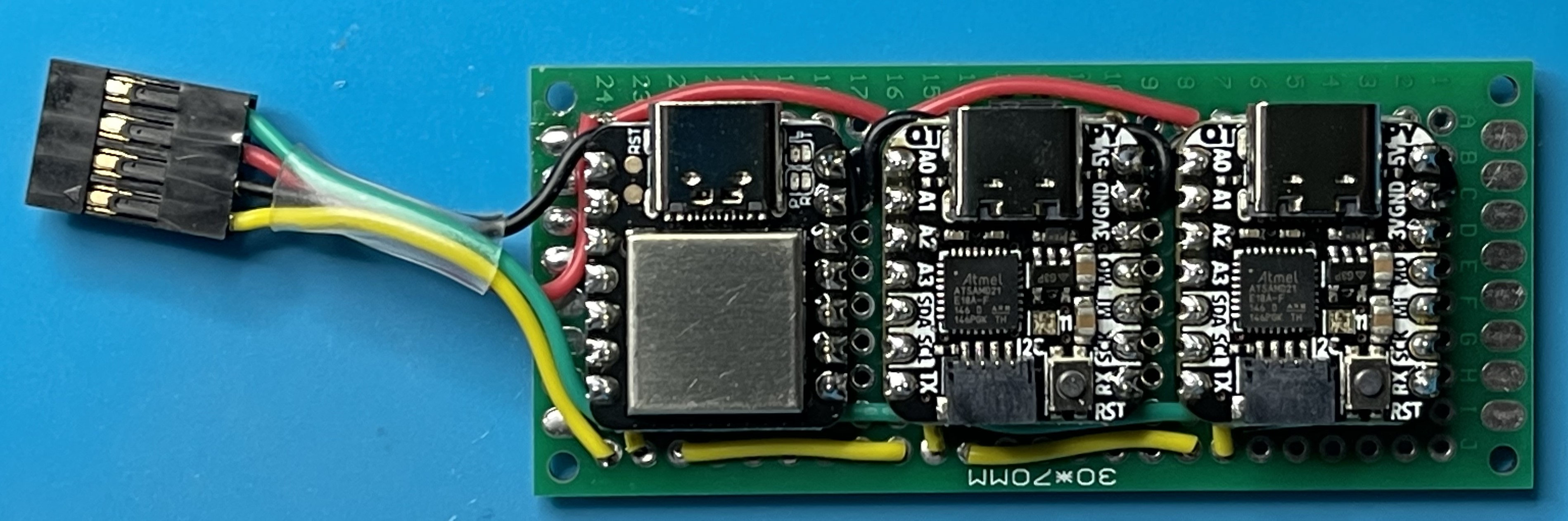

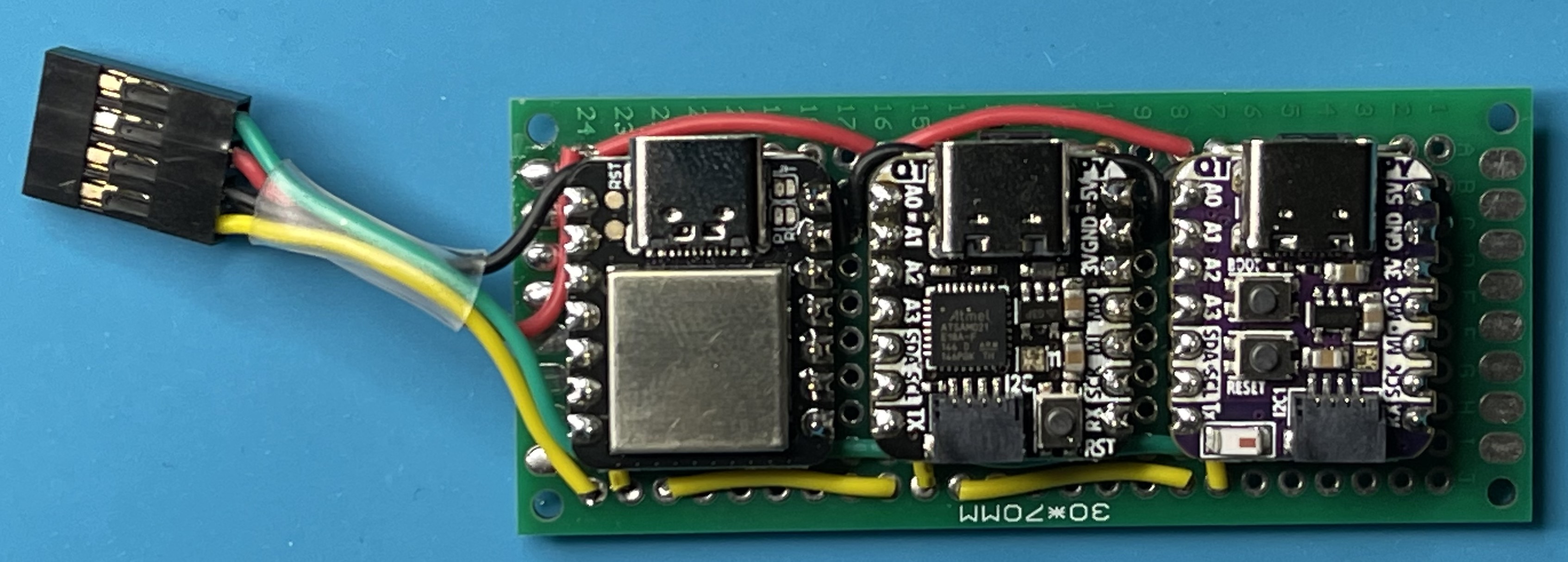

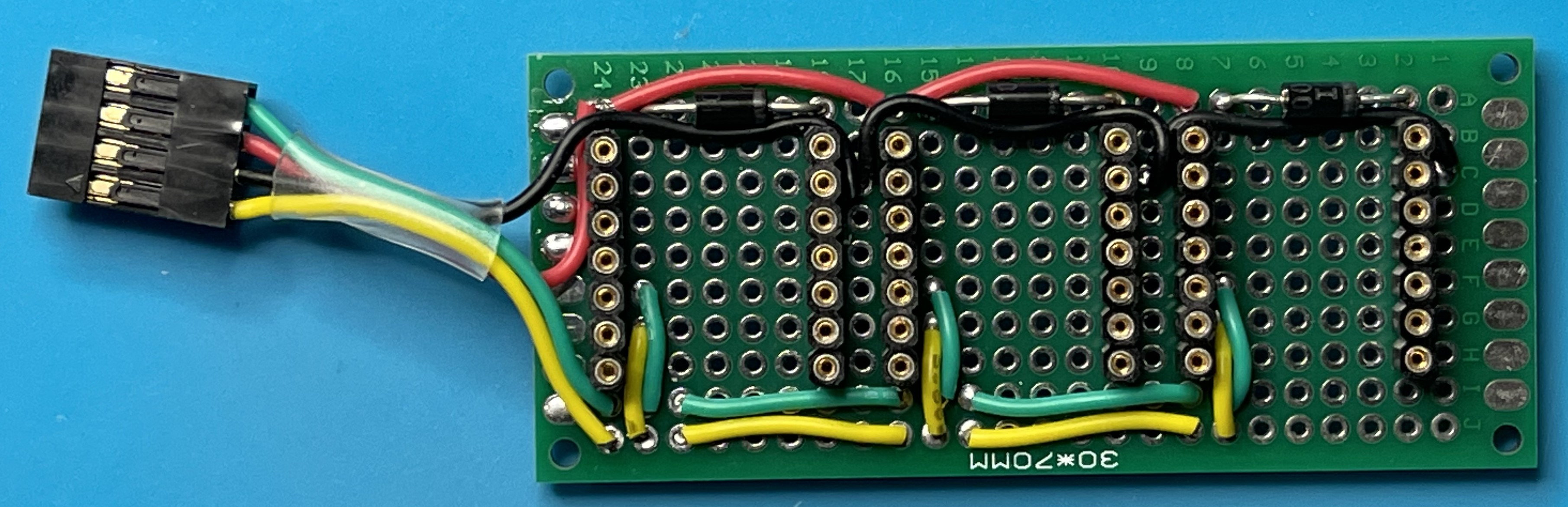

Now suppose one actually wanted a KVM (well K+M) keyboard with multiple USB ports. It's hard to get actual USB driver chips without designing a new PCB. But there are small, cheap (under USD10), CircuitPython boards using the Atmel SAMD21, like the Seeed XIAO or Adafruit QT Py. For interfacing to these, there aren't enough additional UARTs, but there is I2C. Here one issue is that if the target chip isn't powered, because USB isn't plugged in, it kills the bus. But we've got plenty of power from the 12V line needed for the keyboard. Run it through a 7805 regulator and it can have each chip always powered. Add a 1N400x diode just in case.
Note that additionally powering the main converter MCU this way makes the Itsy-Bitsy M4 a better choice than the Feather because its BAT line is just a diode into the 3.3V regulator and not part of a charging circuit. Also #chipshortage.
Because there are a bunch of SoCs with the XIAO form factor, socket them to mix and match.
A little script on each little board forwards i2c requests from the converter to usb_hid.
Having gone this far, why not Bluetooth as well as USB to be able to interface to even more computers? I realize that BT keyboards usually have multiple profiles so one can switch between systems. But this is somewhat slow as it must disconnect and reconnect each time. And the spirit of a KVM is that the host thinks the keyboard is right there. In fact, the MK06 has a mode where it jiggles the mouse a little periodically on inactive workstations to keep the system from going to sleep.
Turns out there is no board that supports CircuitPython for both i2cperipheral (TWIS, now called "target") and BLE HID. Of boards with the necessary hardware available in this form factor, the nRF52840 lacks the peripheral support and the ESP32-S3 the GATT server support. These both should be able to have a port that auto switches between between BLE and USB when plugged in. Other possibilities requiring only CircuitPython software changes include the ESP32-C3, which lacks USB HID -- it just has Serial-to-USB, but still has BLE.
To get it working for now, and since the QT Py ESP32-S3 is out of stock, I put an Arduino sketch in an ESP32 Pico.
Here it is in action. Green means the active port, in this case the BLE one. Yellow means connected but inactive, for one of the USB ports. The XIAO only has a yellow LED, no NeoPixel; so it only has on/off to indicate active/inactive.
