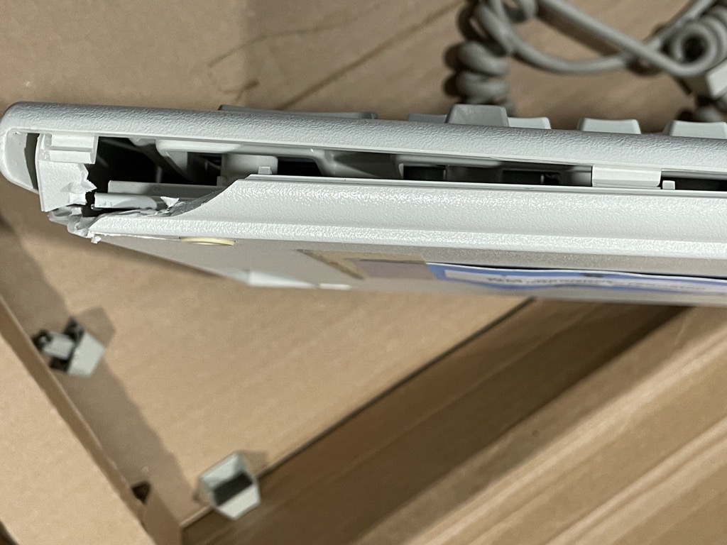

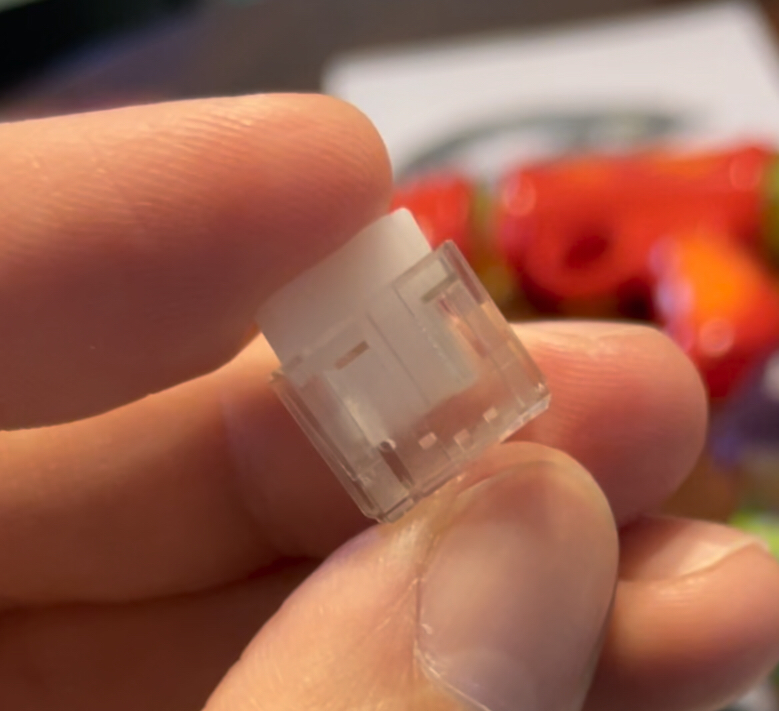

My biggest blunder was trying to drill additional relief into the rivet holes of backplate of my Model M during a screw mod. The additional relief was to allow the screws on the bottom to not push against the case and I was almost there, but went too far on one and drilled a big hole right through the plate, membrane, flipper and barrel plate:
After opening it I realized the damage was beyond repair.
I asked clickykeyboards.com for help and at brought the keyboard to UPS and they said they would pack it, but didn’t and the keyboard case and some keys were damaged during shipping.
My lessons were to use the right screws so relief isn’t needed and to always pack your own keyboards for shipping!

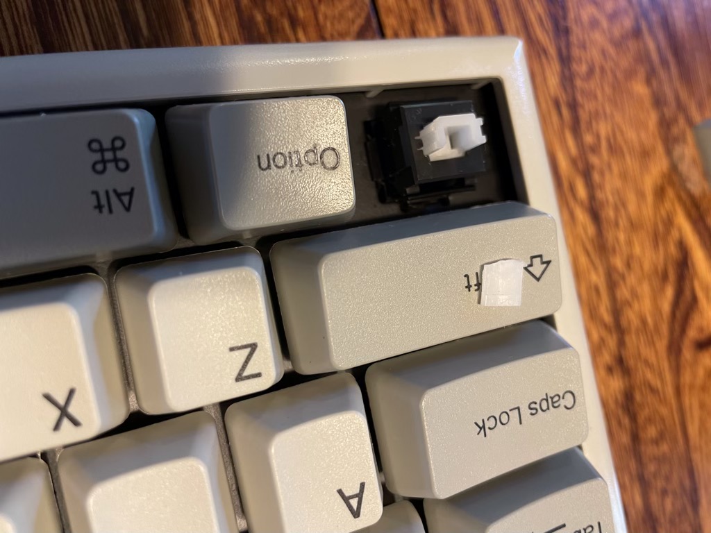

Another mistake was breaking an alps stem while pulling a key from a Data Desk Mac 101-E. I didn’t use the right kind of puller and the stem gave way while pulling it off.
I used a Matias stem and noticed it was smaller and wobbled a lot but still worked. It turns out the alps stems are larger and won’t fit in the Matias housing.
Open IMG_2043.png (1.01 MiB) Viewed 12977 times
My lessons there were to aways use the right puller and don’t expect any genuine alps parts to work with Matias.

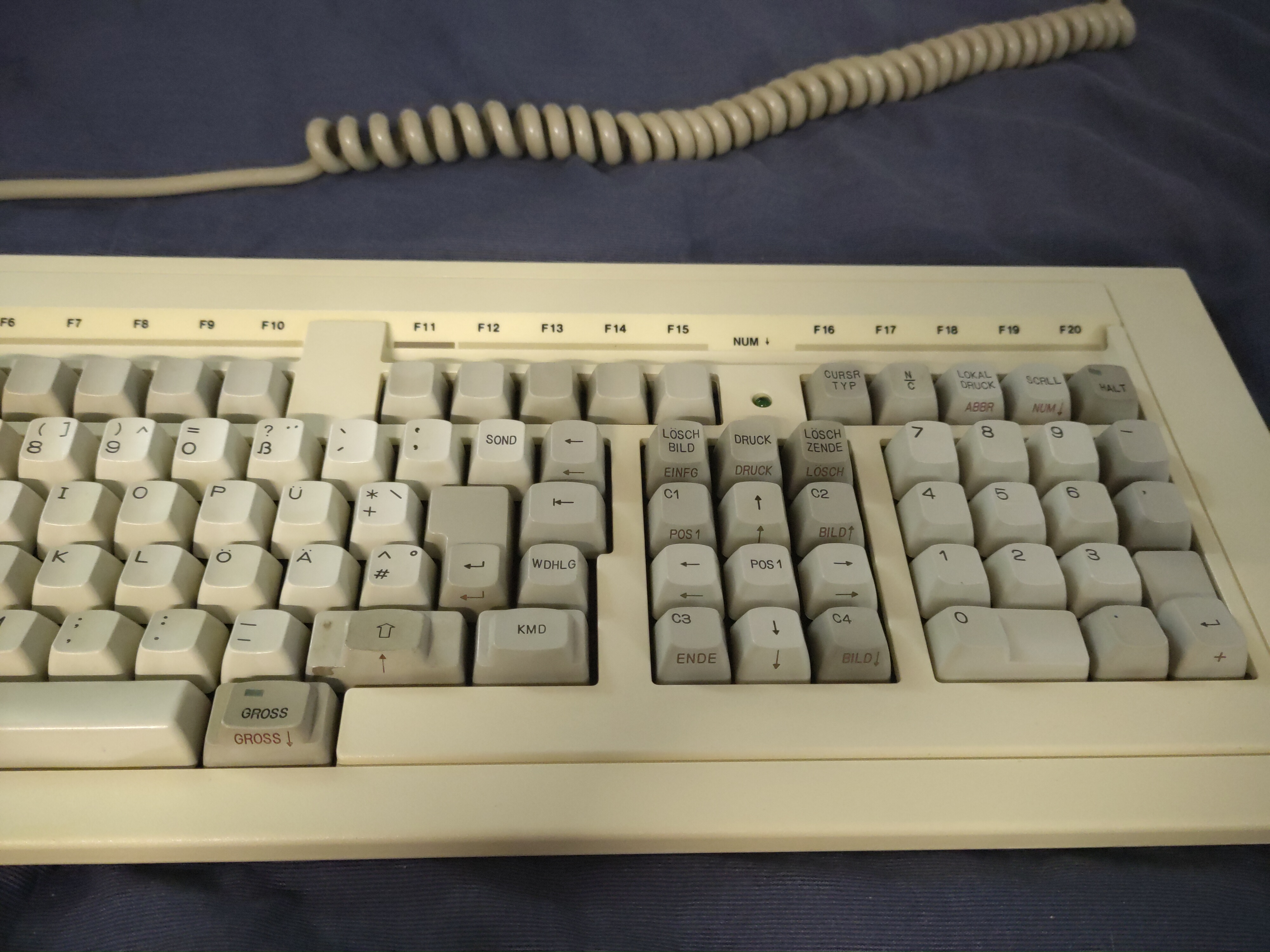

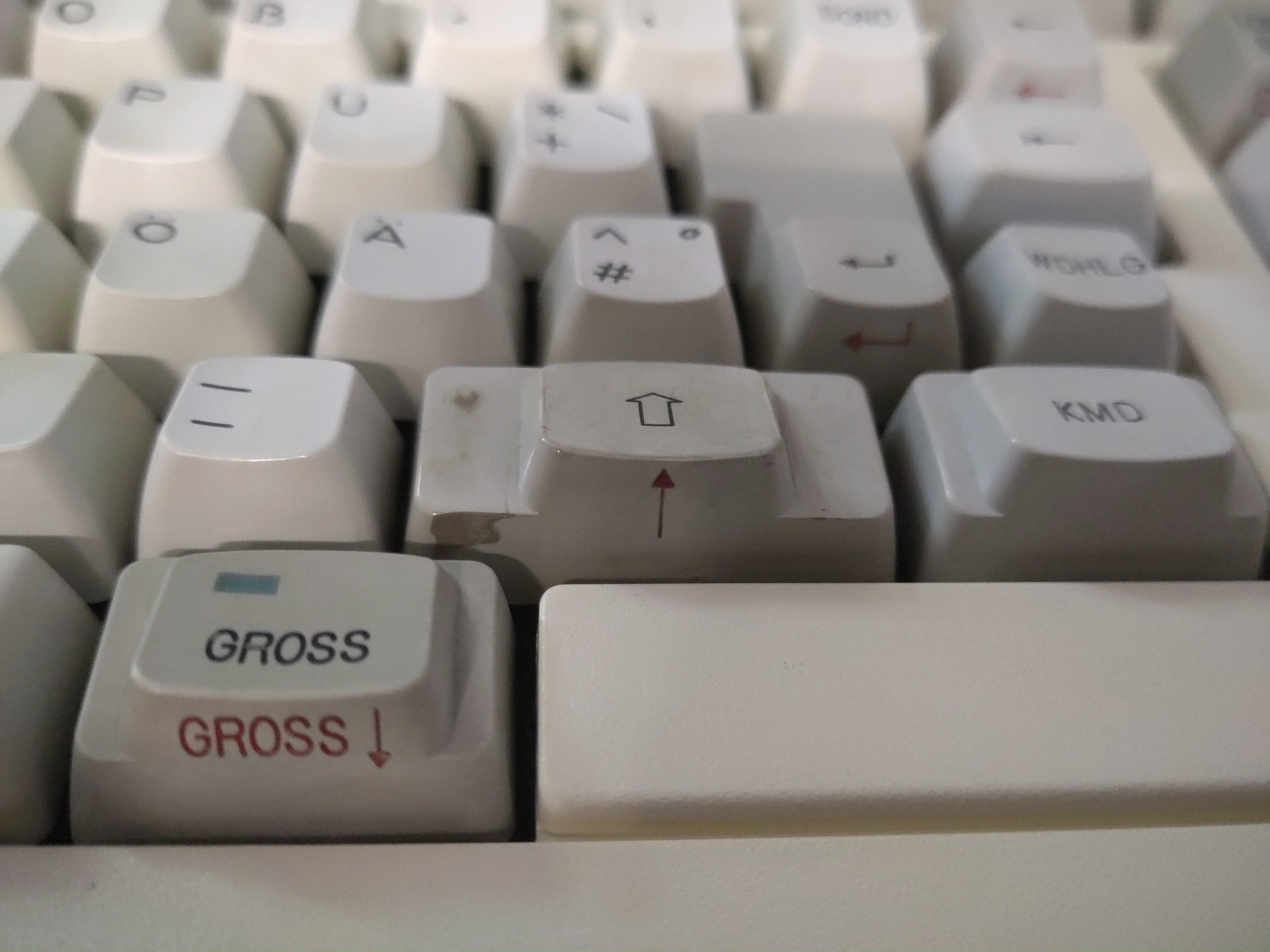

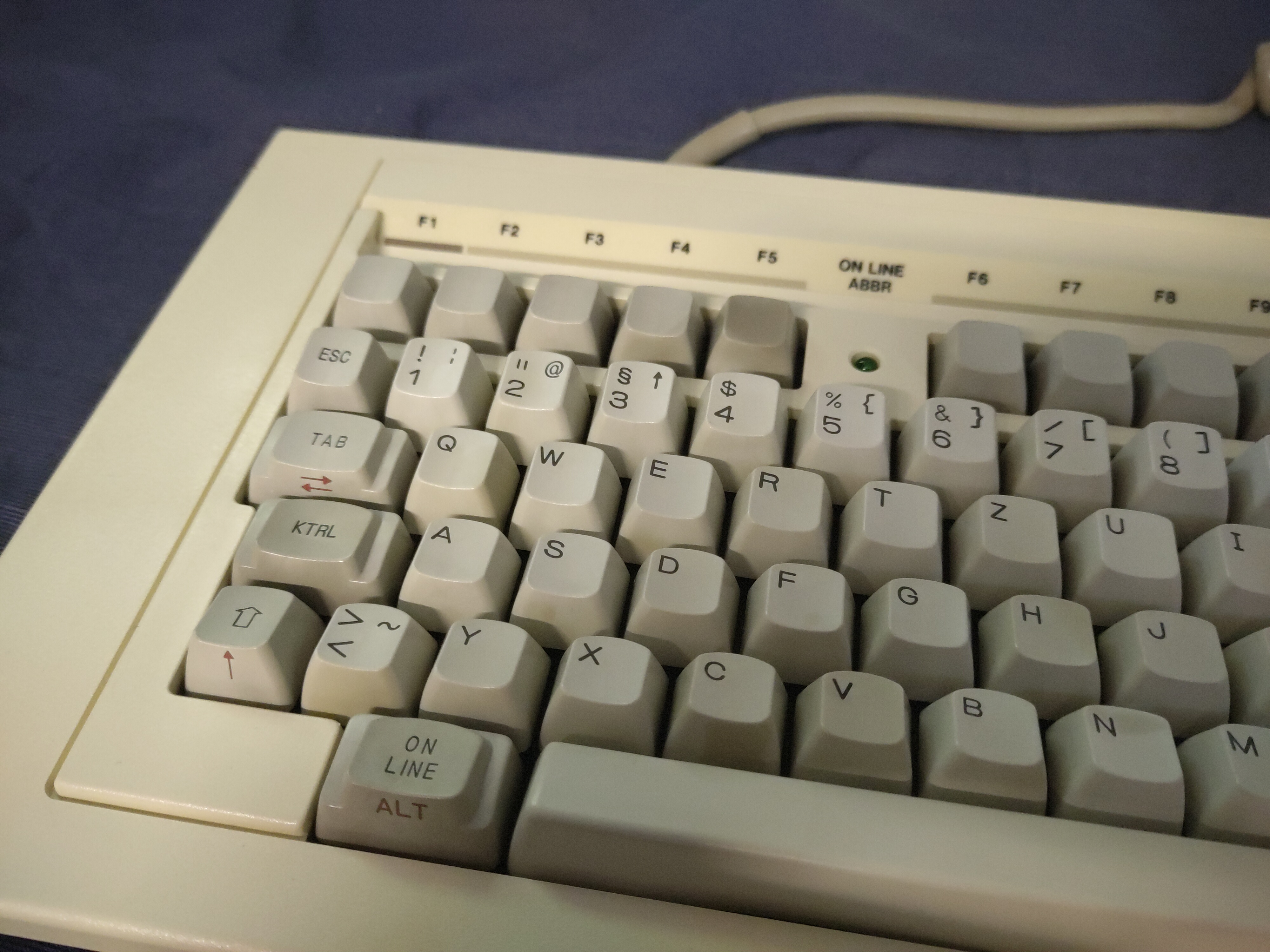

When removing some really stubborn spots of dirt from my Zenith Z-150 I eventually overdid it with the scrubbing. I was using a cocktail stick with a cotton pad drenched in isopropyl alcohol attached to one end. I scrubbed so hard and fast, the heat from the friction melted the texture of the plastic on that spot. It's noticably enough for me to be bothered every time. Still a very small blunder compared to probably my biggest one:
I was retrobrighting the caps of my Data General 6348-A and I made the mistake of throwing the dark grey caps in there along with the "normal" ones. Then I let the waterbath get too hot. All of the caps got overbleached badly (which is a such a shame, those FLS keycaps are thicc and super beautiful). In an attempt to fix it, I tried to sand/polish down one of them partially, but immediately stopped when I realized what I was doing. If only I had chosen a less obvious spot & key. Results are to be seen in the picture (gross indeed). This is what they're supposed to look...
Good luck finding another one of these, those boards are super rare to begin with, and this one was QWERTZ :cry: That happened 2 years ago btw, still not over it
07 Jul 2022, 21:29
Doesn’t look too bad when you don’t know they’re not supposed to be hellgrau. Takes a bit of mental limbering up to get there now, but until I saw your linked pic I honestly wondered what the problem was. :P

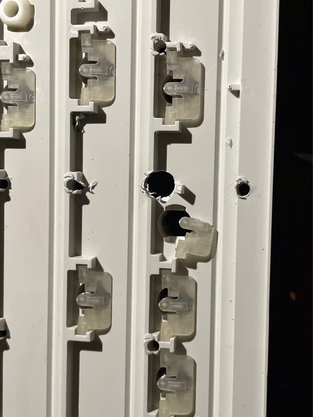

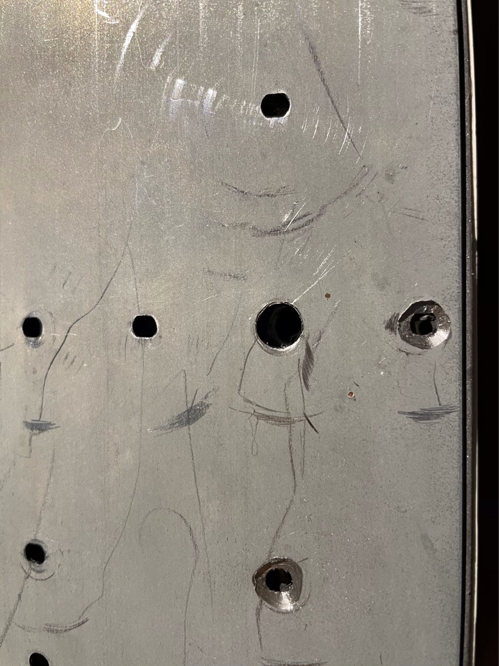

My biggest blunder was something that was not terribly traumatic for me, but when I first started restoring IBM Model F 122-key terminal boards I decided that since re-assembly was sometimes so difficult that I could devise a better system than the original "sliding force fit" ....
So I put the board together, drilled a number of holes (a dozen or so, as I recall) and then cut off the alignment tabs. And since it worked fine that time, I put together a guide showing how to do it.
The second time I tried it, I realized that the tabs were really a very good and successful method for plate alignment, and that the additional aggravation of putting them back together, with the assistance of multiple clamps, was not really all that difficult.
So I built a new guide that recommended keeping the tabs in place. Unfortunately, people kept finding the old guide even though I deprecated it and added language saying not to cut the tabs, I kept hearing from people who were doing it.
So my mistake continued to plague other people for years down the line.
TNT
08 Jul 2022, 00:24
Muirium wrote: 07 Jul 2022, 21:29 Doesn’t look too bad when you don’t know they’re not supposed to be hellgrau. Takes a bit of mental limbering up to get there now, but until I saw your linked pic I honestly wondered what the problem was. :P
Most of my restoration blunders just haven’t happened yet. Too lazy / fearful I’ll do it wrong. Mine is the lesser regret, I suppose, but still.
My phone didn't do that good of a job capturing it. It's pretty apparent when you see it in person. They look "dusty" or "cloudy" somehow. Also the two spots on the right shift + the FN 5 key don't hide it very well :?
I mean, it could be worse, but again, what are the chances of finding that beauty again to somhow make right what I did

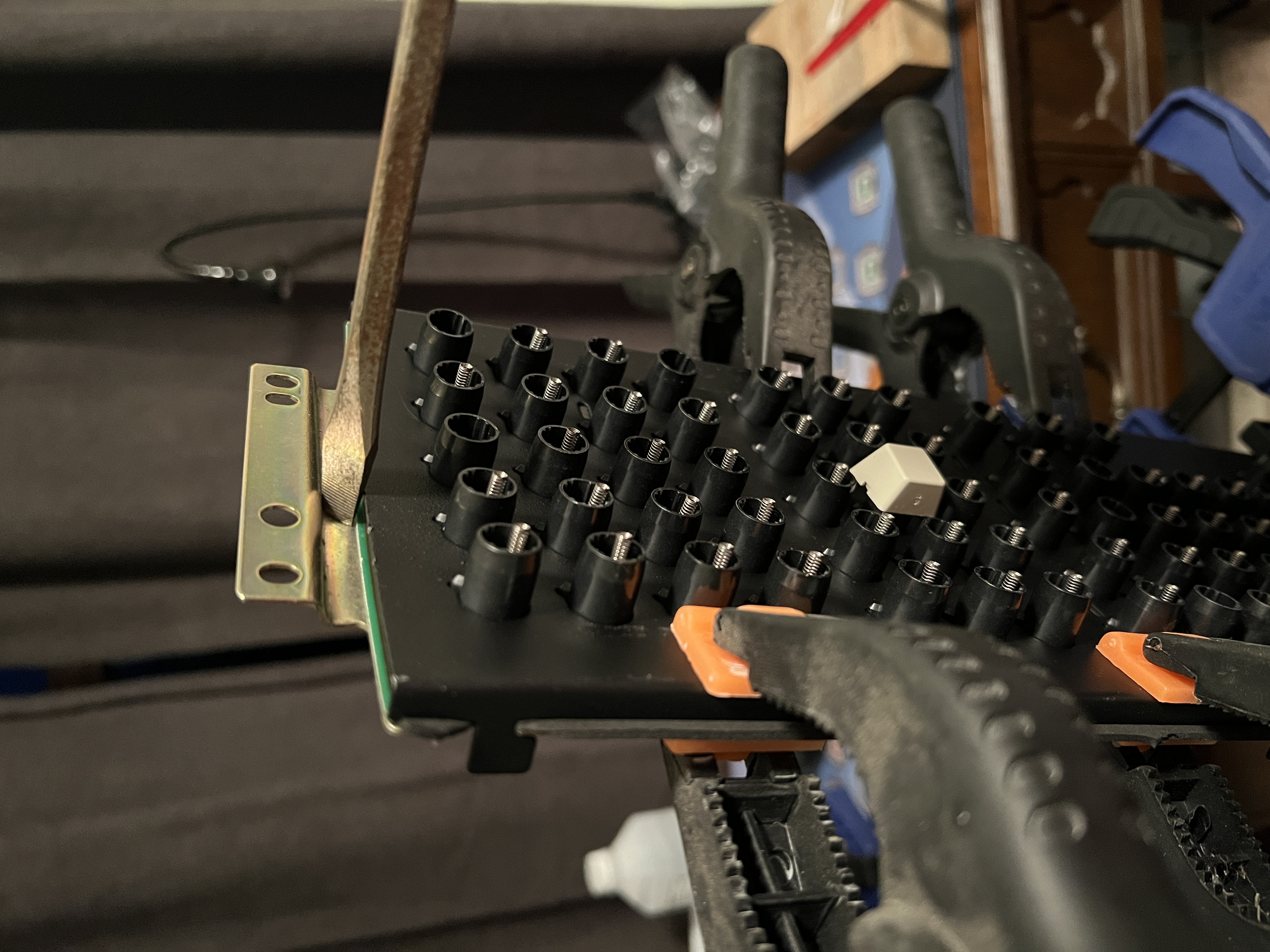

08 Jul 2022, 01:35
fohat wrote: 07 Jul 2022, 23:33 My biggest blunder was something that was not terribly traumatic for me, but when I first started restoring IBM Model F 122-key terminal boards I decided that since re-assembly was sometimes so difficult that I could devise a better system than the original "sliding force fit" ....
I’m not sure if this is unique to the F107, but when I started my first Model F restoration I found it easier to use a large flat head screwdriver to separate and secure the barrel plate. I put the flat head I the space between the back plate and barrel plate and twisted it to separate them and used the same method on the opposite side to reattach. Below is a picture for reference.
Weezer
09 Jul 2022, 03:39
Your description of sepating plates with a screwdriver made me wince, but the picture clarified what was happening immensely.
I've never used clamps or anything for any model f resto. I can't figure out why you'd need them unless the new foam was extraordinary thick?? I just clench it together with one hand and tap it together/apart with a hammer.
I had a hard time getting all of the alignment tabs to slide onto the back plate so I decided to use the clamps. I think removing it was easier but the foam was decently thick and it wouldn’t stay secured enough on its own without some assistance.
hellothere
12 Jul 2022, 18:41
Just while we're on the topic, I can say that using clamps in my Model F XT builds made my life considerably easier ... after I found the post that recommended using clamps. YMMV with other Model F variants.
I'll also add that it's cheaper and easier to buy the finished foam insert for Model Fs than it is to DIY it. Although, that could just be me.
Bjerrk
12 Jul 2022, 18:43
hellothere wrote: 12 Jul 2022, 18:41 Just while we're on the topic, I can say that using clamps in my Model F XT builds made my life considerably easier ... after I found the post that recommended using clamps. YMMV with other Model F variants.
This! I had such a hard time getting my XT back together without clamps. It was a breeze with clamps, though!
