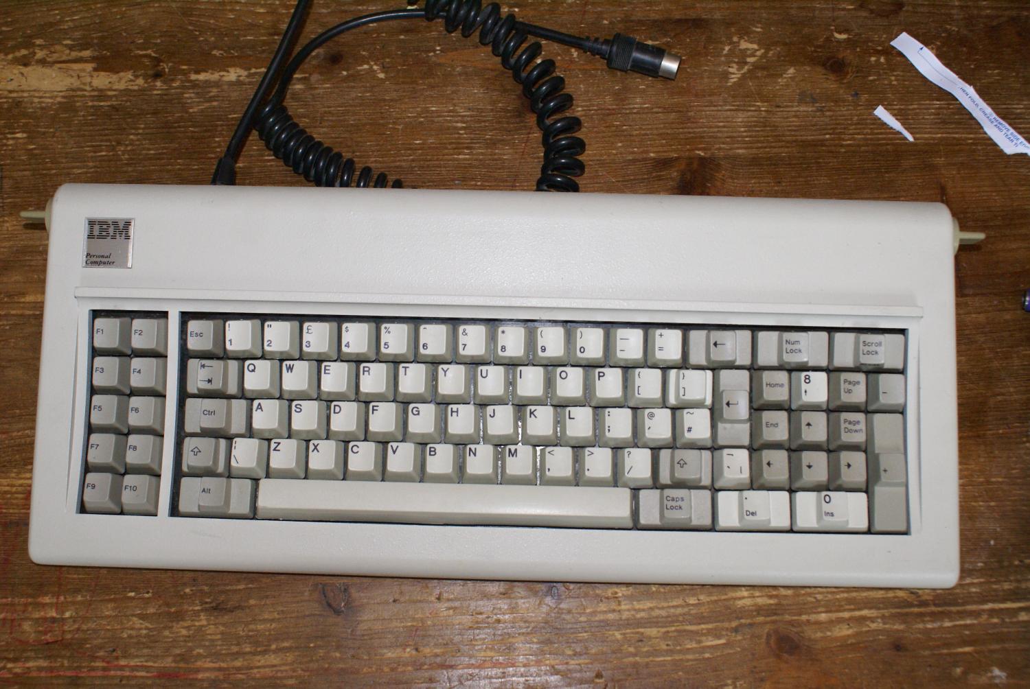

I've been hovering around 122-key Fs for a while but in the end decided they are just too expensive. It turns out however that with a bit of effort even a plain old XT F can be made quite usable. In case anybody is interested here's what I did.

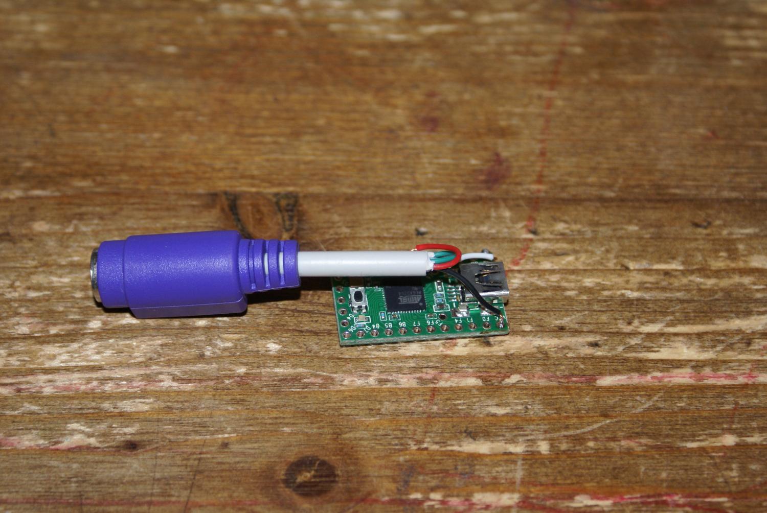

First I had to make the physical adapter. Luckily the price+shipping for teensy boards is *just* below the tax limit so they are still affordable even in UK. My experience with electronics and soldering consists mainly in having watched my father doing this kind of stuff (a long, looong time ago). Surprisingly, however, even though the holes on the teensy board are scarily tiny I managed to connect all wires with only one retry. It doesn't look pretty but it works.

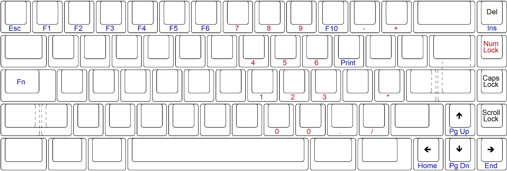

Uploading the firmware was a breeze, following soarer's instructions. Now I had a working XT Model F, however, with a layout that I found really hard to get used to. Fortunately though, remapping keys is fairly straightforward with soarer's firmware. The keys from a Model M work fine in the F, so I could just use some Model M spares to get the layout I wanted. This is the "pseudo-tenkeyless" layout I came up with:
Suggestions for what to use the keys around the top right corner for are welcome. Extra points if someone has an idea how to get a 'meta' key to replace Caps Lock with ;-).

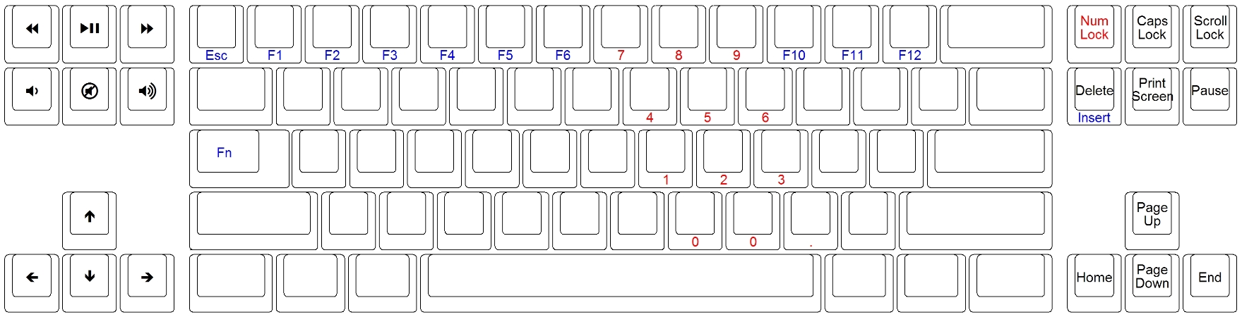

i'm playing around with something like this now. after modding up an AT (see what i did at http://geekhack.org/showwiki.php?title=Island:25919) i plan on making a new matrix and top plate for an XT so that it will resemble a modern layout.
Icarium
14 Jun 2012, 10:13
wcass wrote:i'm playing around with something like this now. after modding up an AT (see what i did at http://geekhack.org/showwiki.php?title=Island:25919) i plan on making a new matrix and top plate for an XT so that it will resemble a modern layout.
Nicely done. Too bad there is no good way to make a new PCB for these. Do you have any ideas on that or are you going to reuse the standard one?
wcass
14 Jun 2012, 17:20
will be cutting the XT controller off the matrix straight across the top of the matrix. there are 20 test points on the controller side for the traces from the matrix - will solder on wires or pins.
i have some .031 double sided 1 oz copper clad coming later this week. i will etch out a few key pads following the design of the XT and AT. will then test with the controller and a teensy to see if the keys register. if they do then i'm golden. if not, try again with .5 oz and 2 oz.
first "new" keyboard layout will re-use the XT case (but remove the vertical F keys separator). will likely look similar to this:
next keyboard layout will require a custom case:
