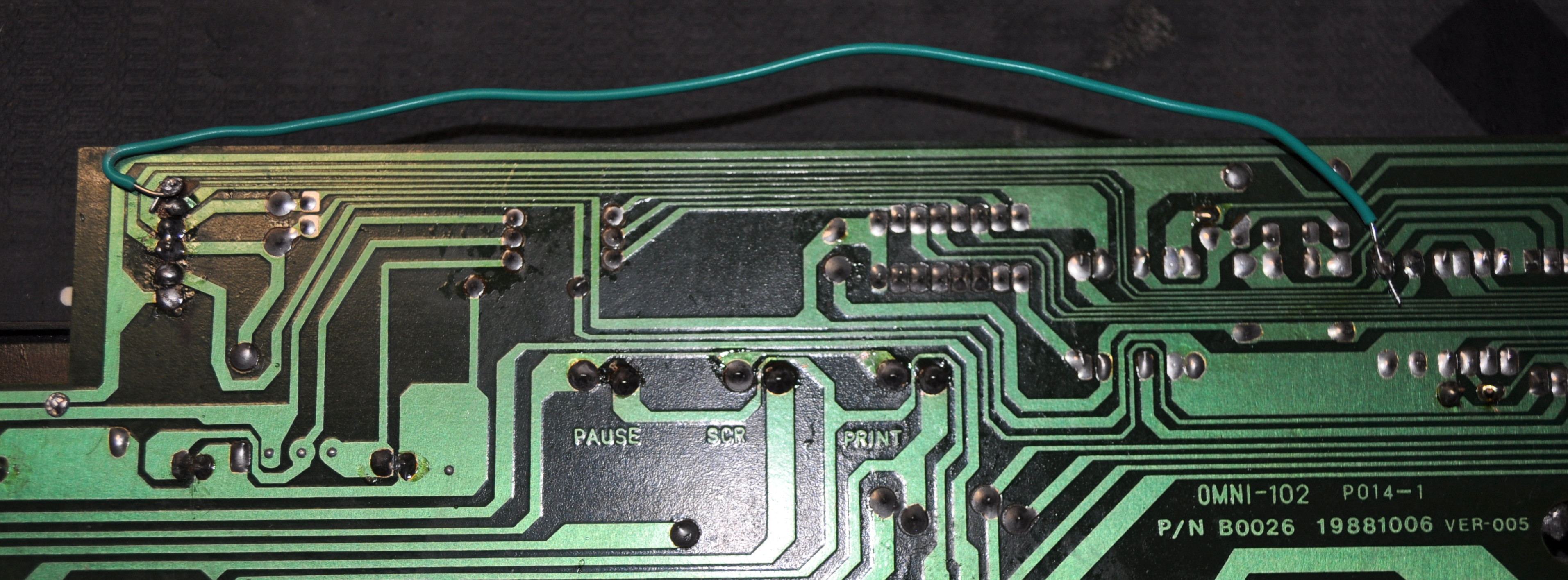

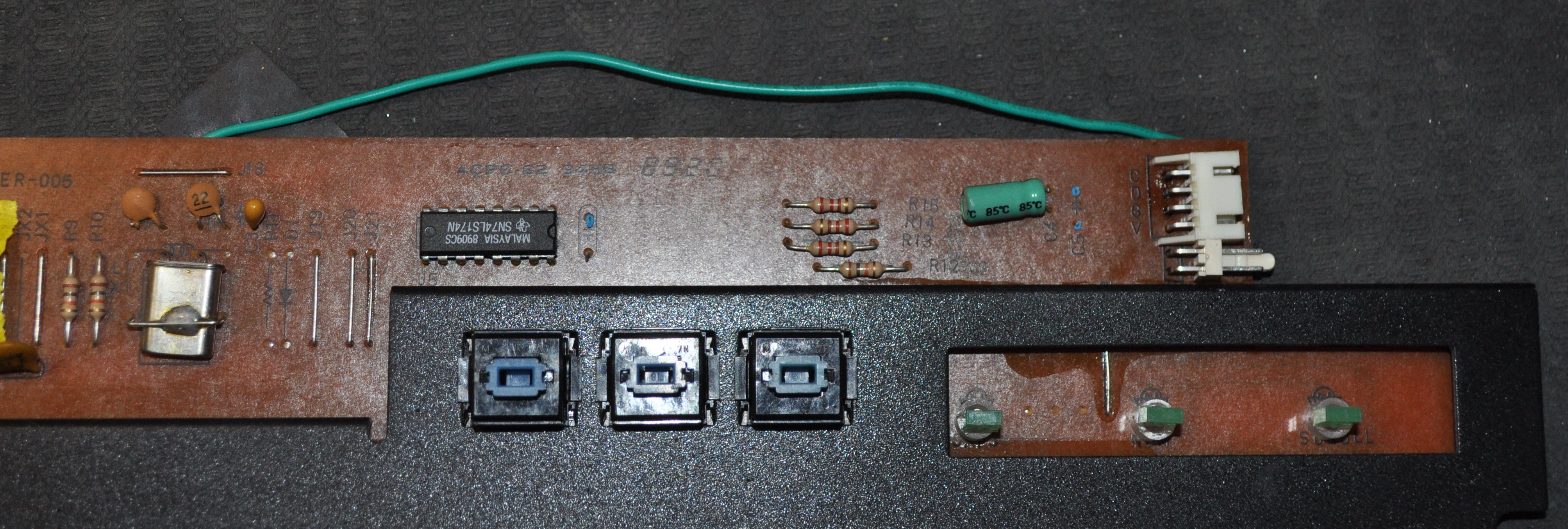

I purchased an OmniKey 102, a couple weeks back. The main problem: someone physically ripped out the keyboard connector, which removed and lifted a couple of tabs on the PCB where the connector was, then they cut the keyboard cable, just to be extra thorough.
I was able to follow the traces for clock, VCC, etc. from the missing keyboard connector to the correct places on the PCB using a multimeter, checking for continuity. I was able to determine that only ONE trace was bad, the one for clock. Groovy. I soldered in a keyboard connector from another same-age, working OmniKey, then soldered in a wire from the keyboard connector to the end of the trace, which goes to a resistor. Plugged in the keyboard cable from my other OmniKey and used a known-working DIN 5 to PS/2 adapter and connected to my computer (it has a "real" PS/2 port), then started up the computer. No lights on the keyboard. Keys don't do anything. Powered down. Reconnected with a DIN 5 to PS/2, then a PS/2 to USB active adapter. The computer does the USB "noise" indicating that it found something USB, but no worky still. I also tried the computer logged in, then connecting the USB adaptor. Still no worky. I also have a powered USB hub. Still no worky. I have a known-good Hasu TMK adapter, so I tried that. The USB connector noise goes off every second and only stops when I disconnect the TMK. This model OmniKey only has a XT/AT switch and I tried that, too. Still no worky.
It doesn't look like I have any blown caps and everything else looks OK. Anything else I should check? Please note that while I have a multimeter, this does not mean that I know electronics.

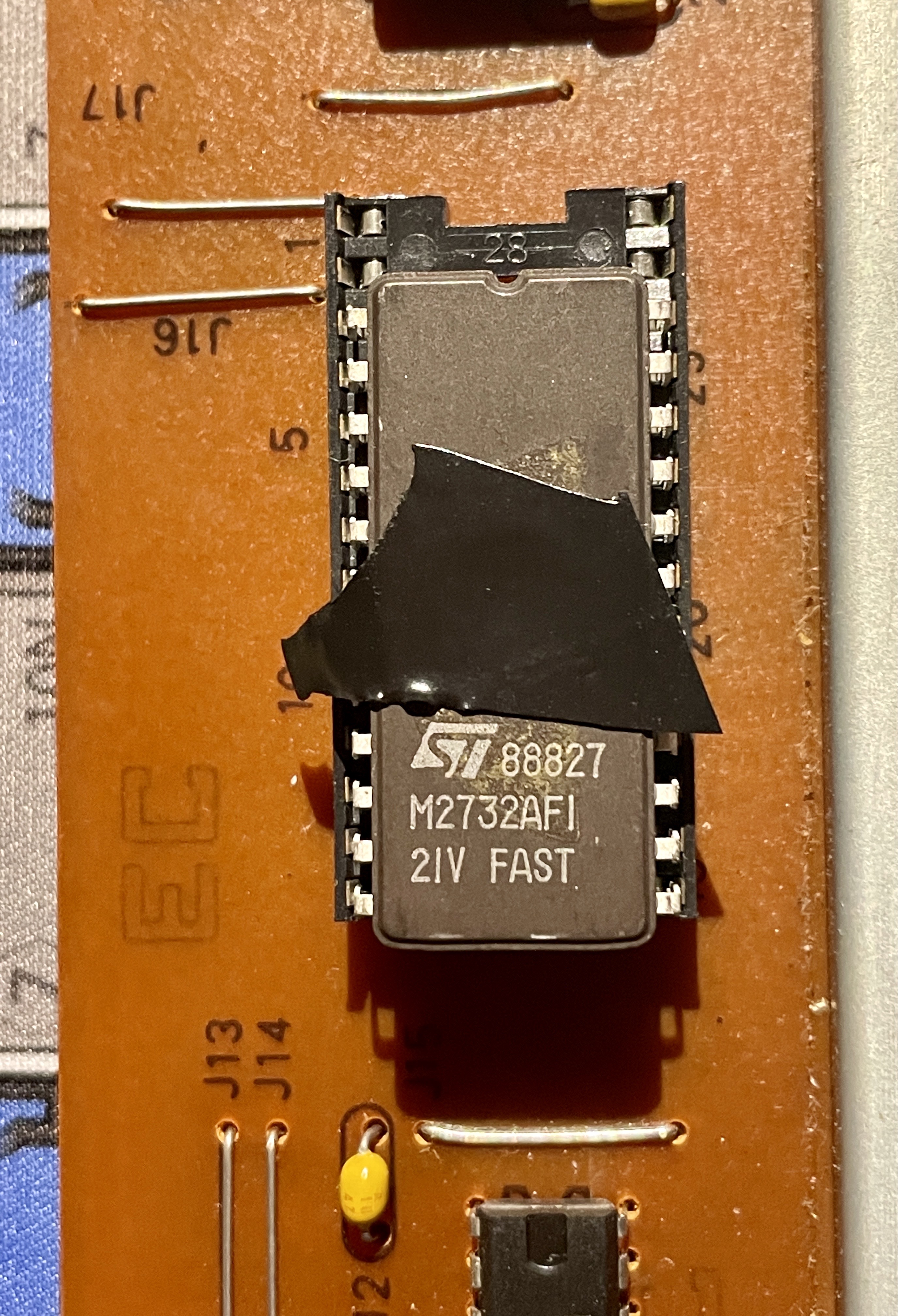

I can only speak for my Gold Label OmniKey 102, but it has a removable controller - no soldering needed. Below is a pic of mine which was not working and replaced with a “full size” version thanks to Northgate Bob. The black tape was to prevent sunlight erasing the firmware, but I may have been too late!

Polecat
15 Jul 2022, 17:35
thefarside wrote: 15 Jul 2022, 14:10
That's actually an EPROM which contains the firmware, but they can go bad or get erased if exposed to UV light with the window uncovered. The controller is a separate 40 pin chip, usually soldered in place.

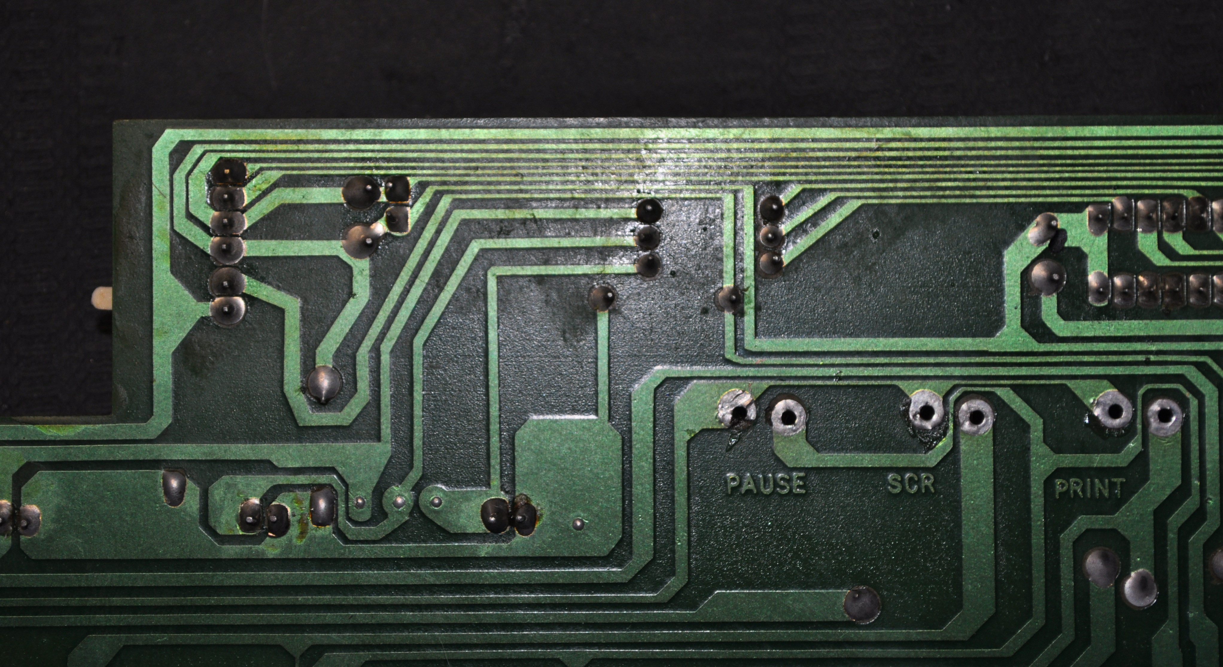

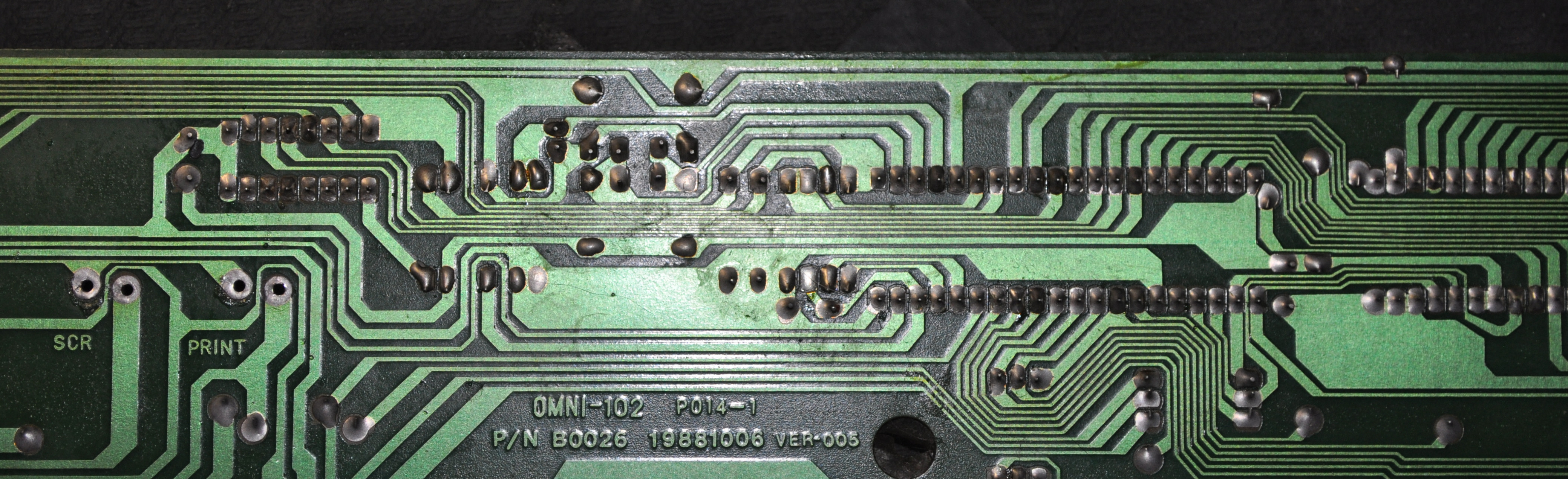

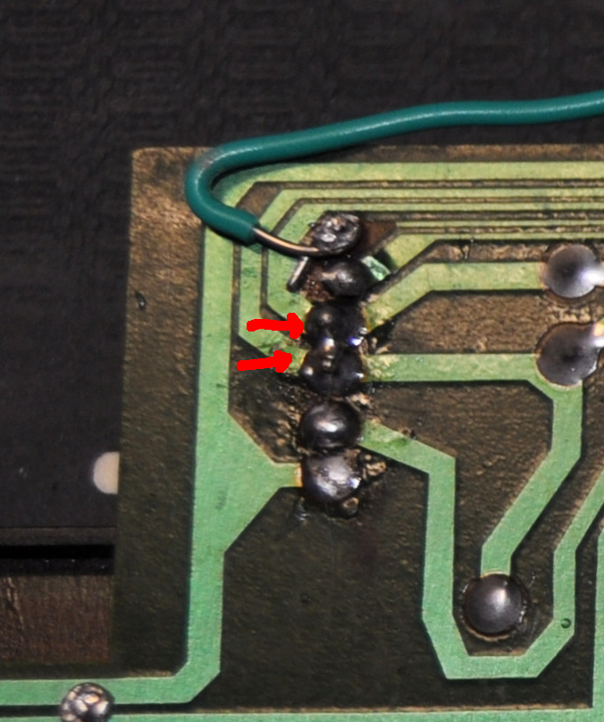

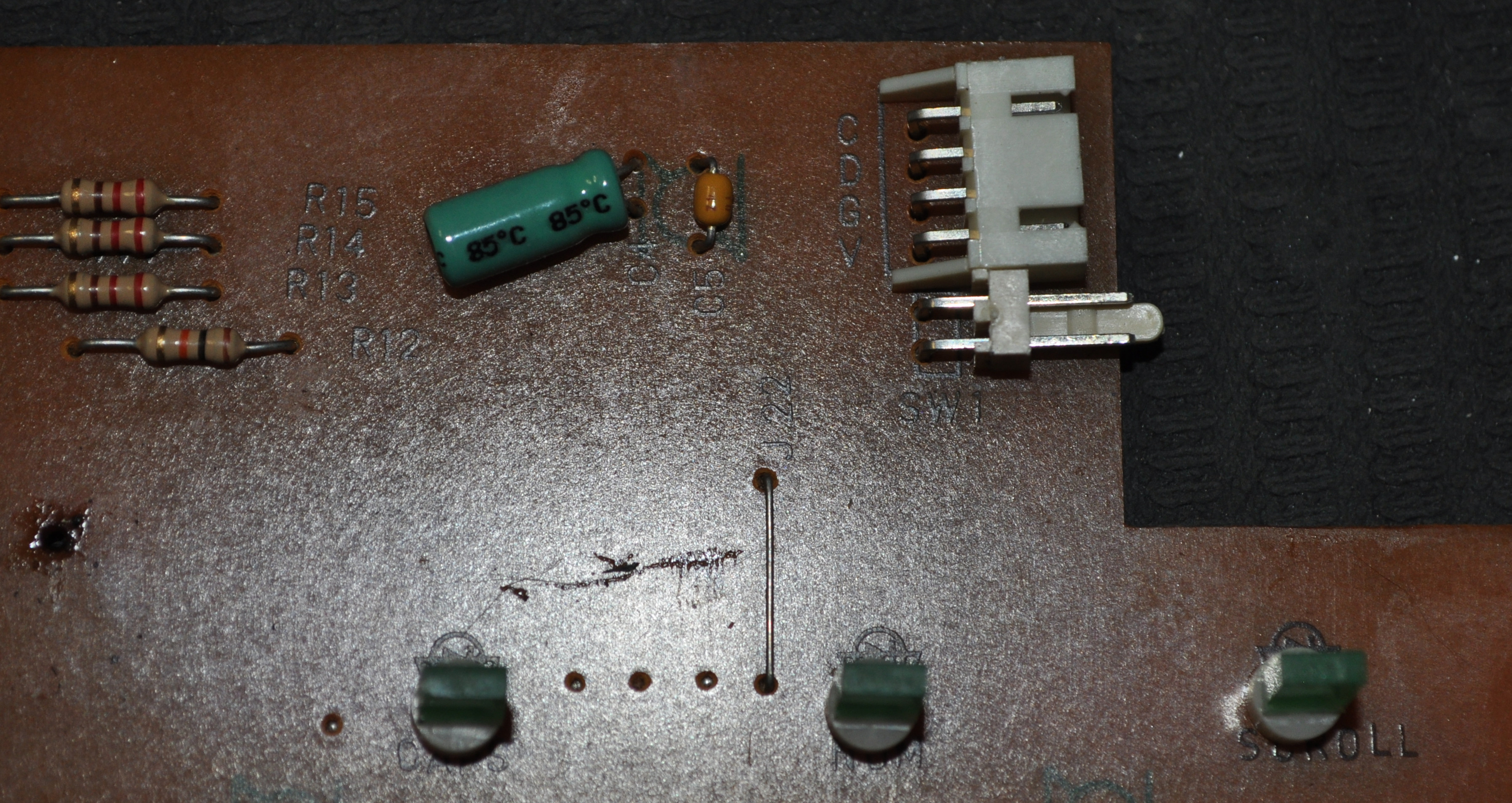

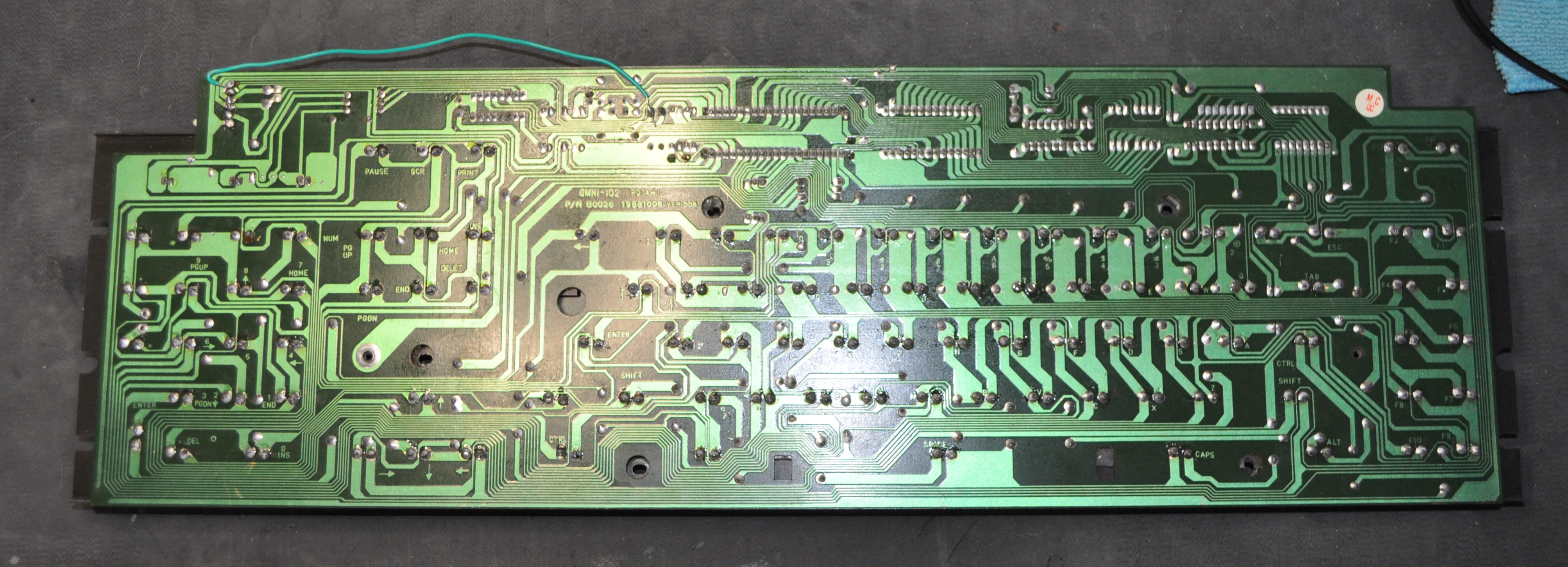

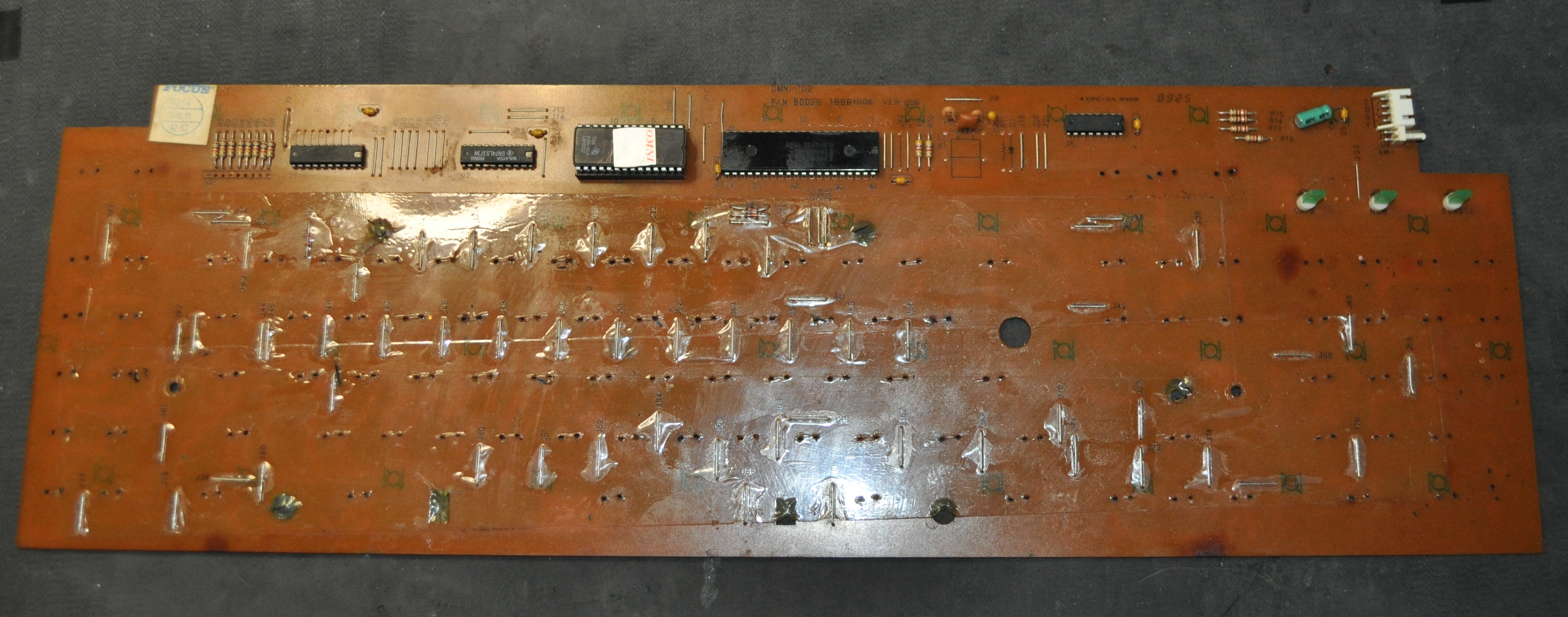

Pics of the problem PCB:
bad-full - Copy.jpg (1.49 MiB) Viewed 3793 times
bad-front-closeup - Copy.jpg (1.58 MiB) Viewed 3793 times
bad-closeup - Copy.jpg (1.21 MiB) Viewed 3793 times
Pics of a good PCB:
good-back-closeup - Copy.jpg (1.92 MiB) Viewed 3793 times
good-back-closeup2 - Copy.jpg (1.51 MiB) Viewed 3793 times
good-closeup - Copy.jpg (1.69 MiB) Viewed 3793 times
good-full-PCB - Copy.jpg (1.35 MiB) Viewed 3793 times
Notes:
"CDVG" (4 pin white connector) is clock, data, VCC (power), and ground.
SW1 (2 pin white connector) is the AT/XT switch.
Yes, the front/brown side of the PCB has tape all over. This is original.
The green wire on the misbehaving PCB goes from clock to the top wire of R10. I don't know if that's + or -. It's beyond my electronics knowledge.
Thanks to everyone for looking.

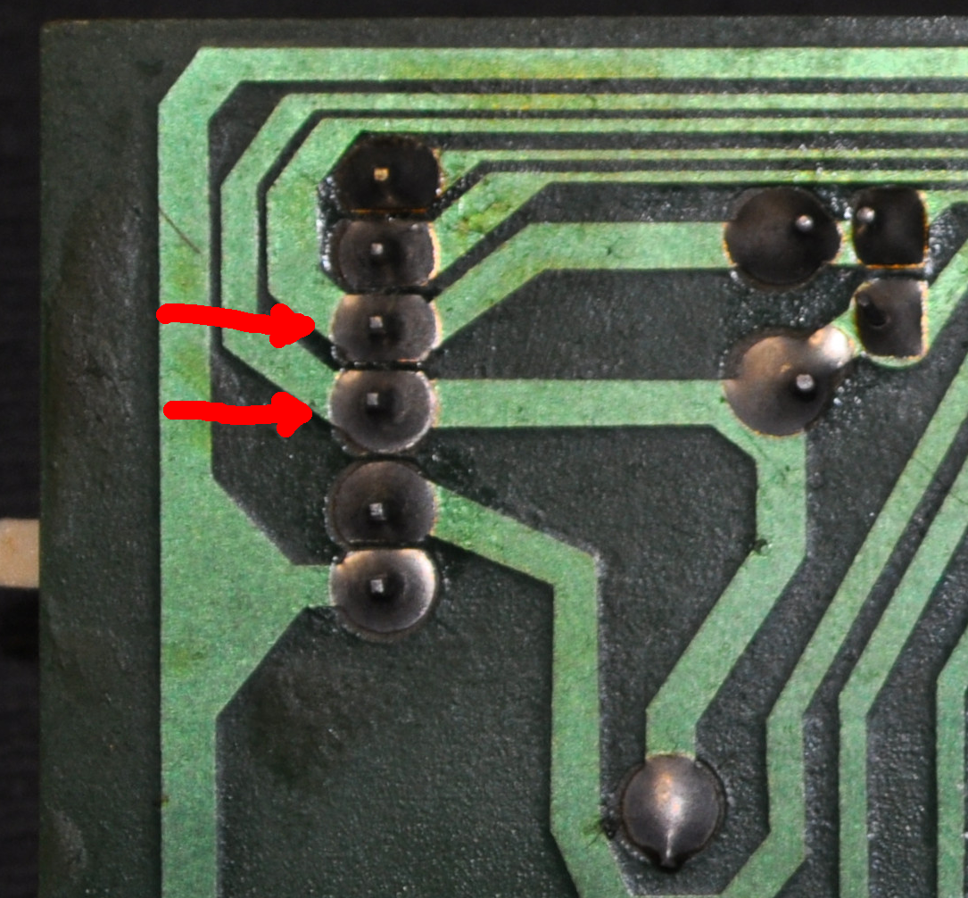

Bjerrk
15 Jul 2022, 19:03
Now, bear with me, this is probably a very silly question.
In the good PCB, is there continuity between these two solder joints?
They seem to have flown together in the bad PCB, at least:
(And yes, I was lazy, I haven't followed the traces down the line to check the significance of it :) )
BuGless
15 Jul 2022, 21:36
Bjerrk wrote: 15 Jul 2022, 19:03 In the good PCB, is there continuity between these two solder joints?
In the good PCB they are not connected. It would not have made sense if they would have been connected. If they would have been supposed to connect there, then the traces would have been either completely parallel or there would have been just a single trace leading to both together.
Most definitely, yes, and most definitely not good.
15 Jul 2022, 21:46
☝️ Correct on both counts. Someone done gone messed it up.
hellothere
16 Jul 2022, 00:48
Bjerrk wrote: 15 Jul 2022, 19:03 Now, bear with me, this is probably a very silly question.
Possibly silly, but a good question. You were correct that the solder joints were touching. I dragged out my 5X magnifying lamp and re-soldered all the joints. Connected back to my TMK converter and got the Num Lock light to come on. Shut all the way down, just connected AT to my PS/2 adapter and worky, worky! Well, other than the dead switches. I expected a few. So, thank you very much for the silly question!
I seem to have a hardware problem with either the TMK I made, cabling, or some adapter. I had been using the TMK with another OmniKey for a couple days and that just quit working. Same with my PS/2 to USB active adapter: I tried that with both Omnikeys and no worky, but it did a few days ago. Hmmmmm.
