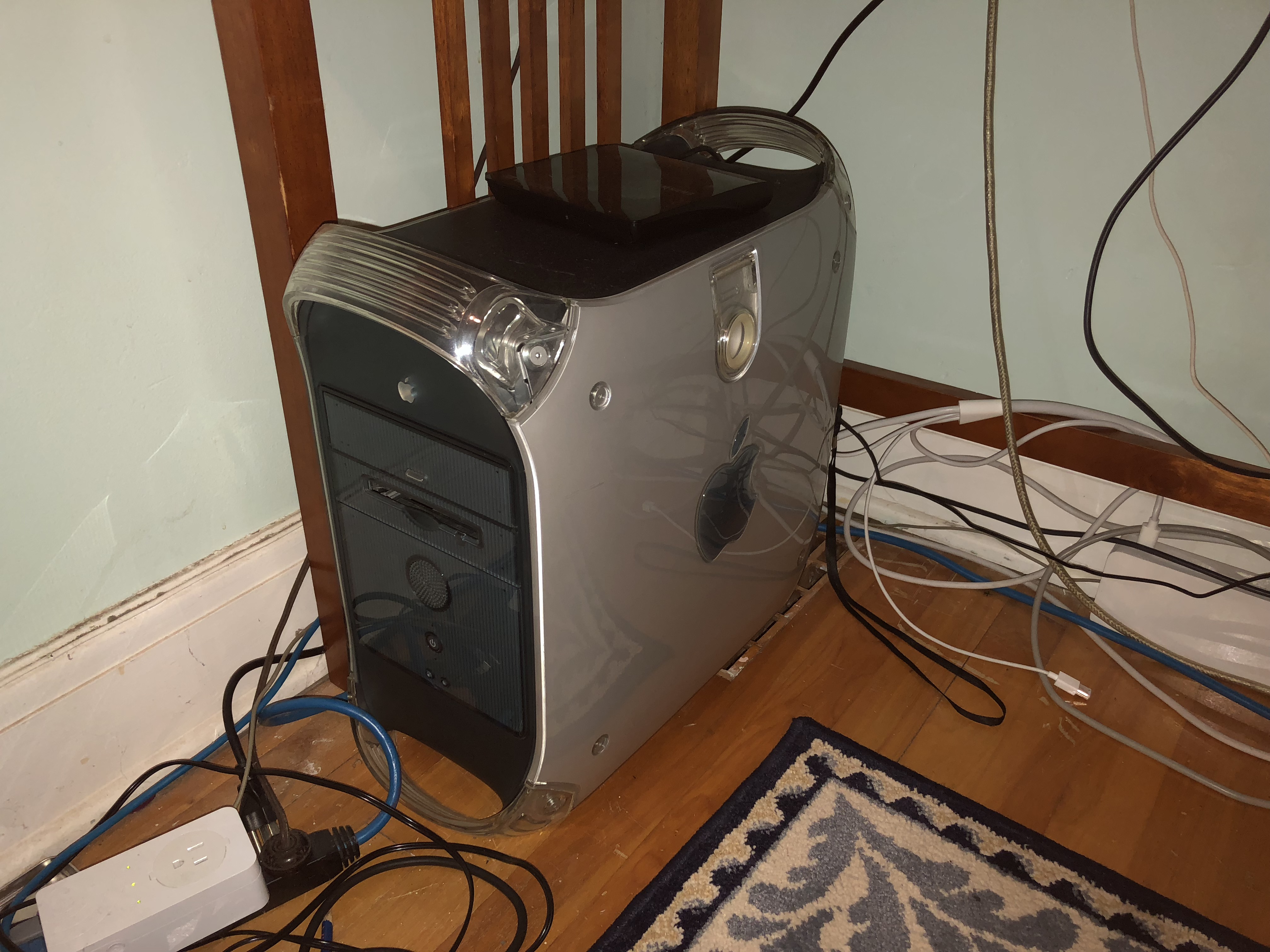

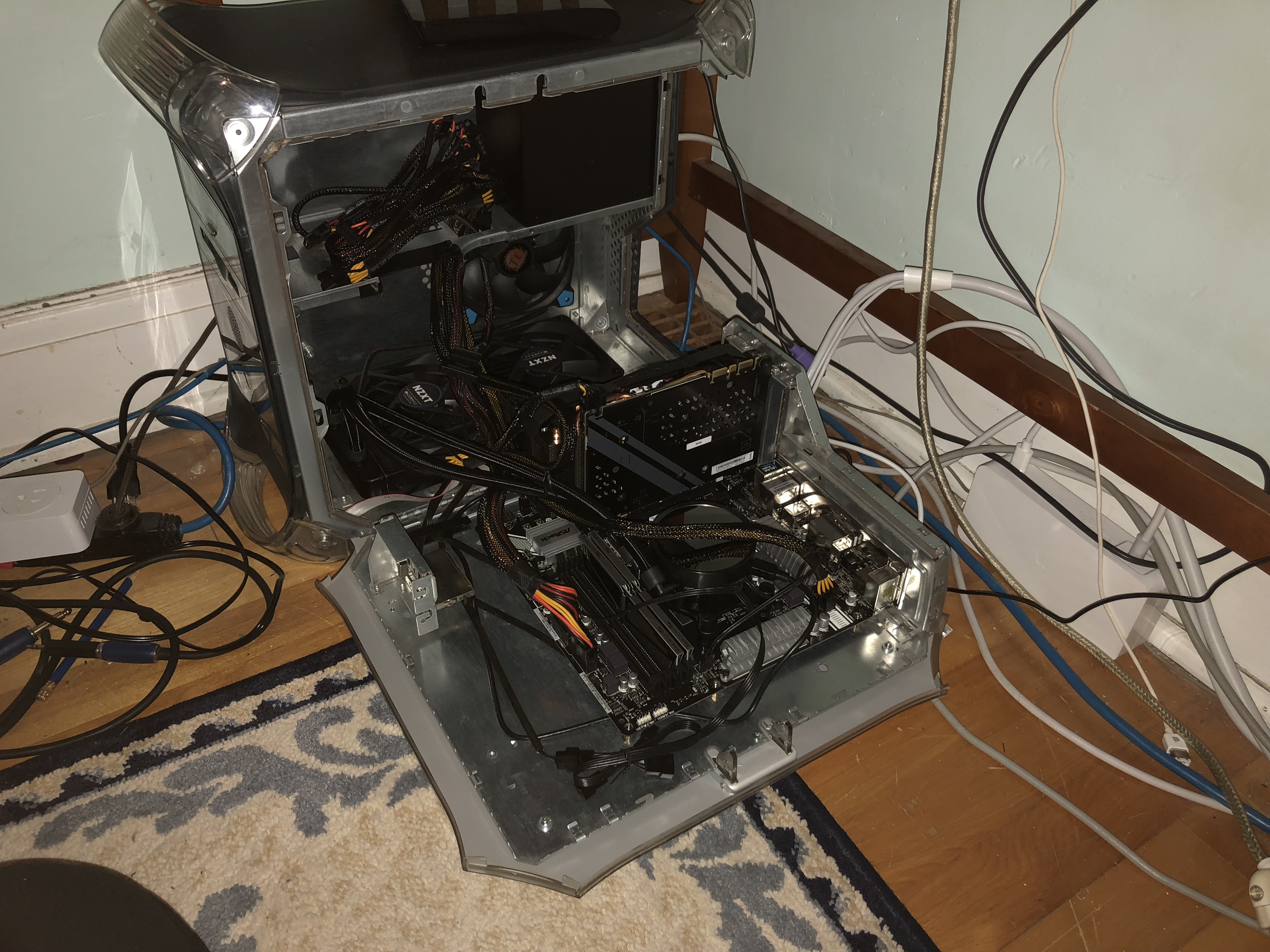

I recently put together a new PC. I'm not going to go into details on the specs of the system, but I wanted to make it unique. For my last PC I did this by building it in the case from a Powermac G4 (below). Unfortunately, Apple cases don't have the best cooling (I know shocker) so the system was endemically hot.
Powerhack G4

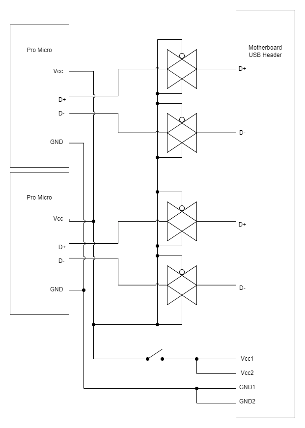

With this goal in mind, I came up with a simple circuit to do this. It consists of a quad transmission gate chip (MC14066) to disconnect the data lines of the USB between the motherboard's USB header and the pro micro based adapters and a single pole single throw (SPST) switch to disconnect the power to the pro micros and enable or disable the transmission gates.
Schematic
Keyboard Adapter.png (46.04 KiB) Viewed 2084 times
Depending oh how familiar you are with electronics you might ask why not use a triple pole single throw switch (basically three separate switches that all open and close at the same time) to disconnect each adapters instead of the transmission gate setup? I probably could have, although the impedance discontinuity might have been too much for the data lines of the USB to handle. The reason that I didn't try this is that I couldn't find any that were available and reasonably inexpensive. Generally, they were about $20-$30 Canadian. By contrast the parts for this adapter were $0.90 for the MC14066 and $6 for the toggle switch. Everything else I used for it, I had on hand.

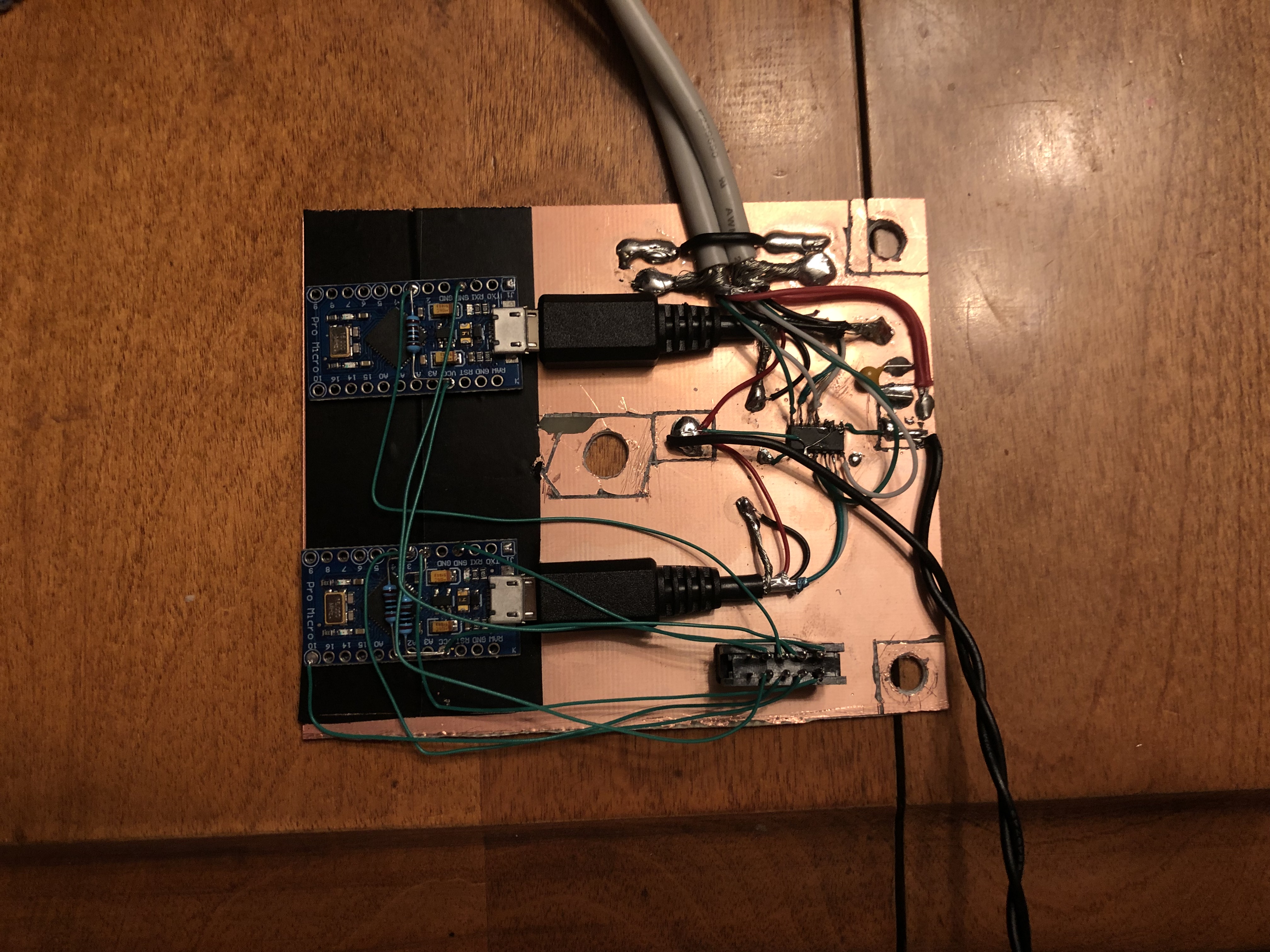

The adapters themselves are standard tmk adapters that are well known on here so I won't go into detail on them. I made the board that they're mounted on from a piece of single-sided copper-clad board. I used a modified xacto knife to scribe away lines of the copper to create different isolated pads to solder to. Since I could only find the MC14066 in a surface mount SOIC14 package I used a technique called dead bugging where you glue the components upside down onto the board you're building and then run wires directly to the pins that are now sticking up in the air. The motherboard side USB header came from an old computer that I took apart years ago and the micro USBs were harvested from old USB cables.

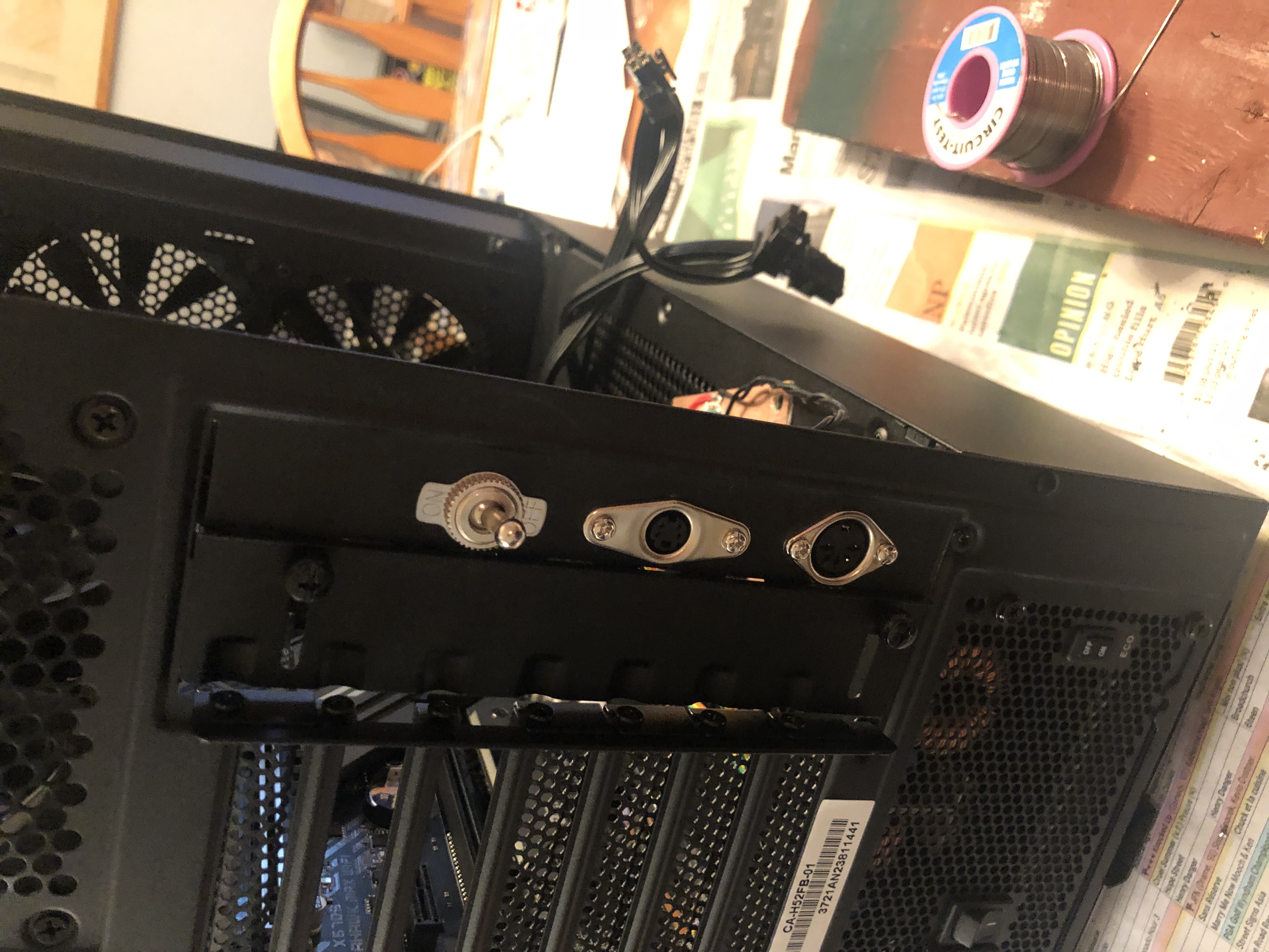

For the ports themselves, I got panel mount DIN 5 and mini DIN 4 and used ribbon cable to connect them to the pro micros. These along with the SPST were mounted in holes drilled in the back of the case and the adapter board was zip tied to the 'basement' of the case.
Finished build
Early version of the adapter. Originally I was going to use a header to mount the ribbon cable to the adapter board then wire from that to the pro micros, but that ended up being a pain so I removed it later.

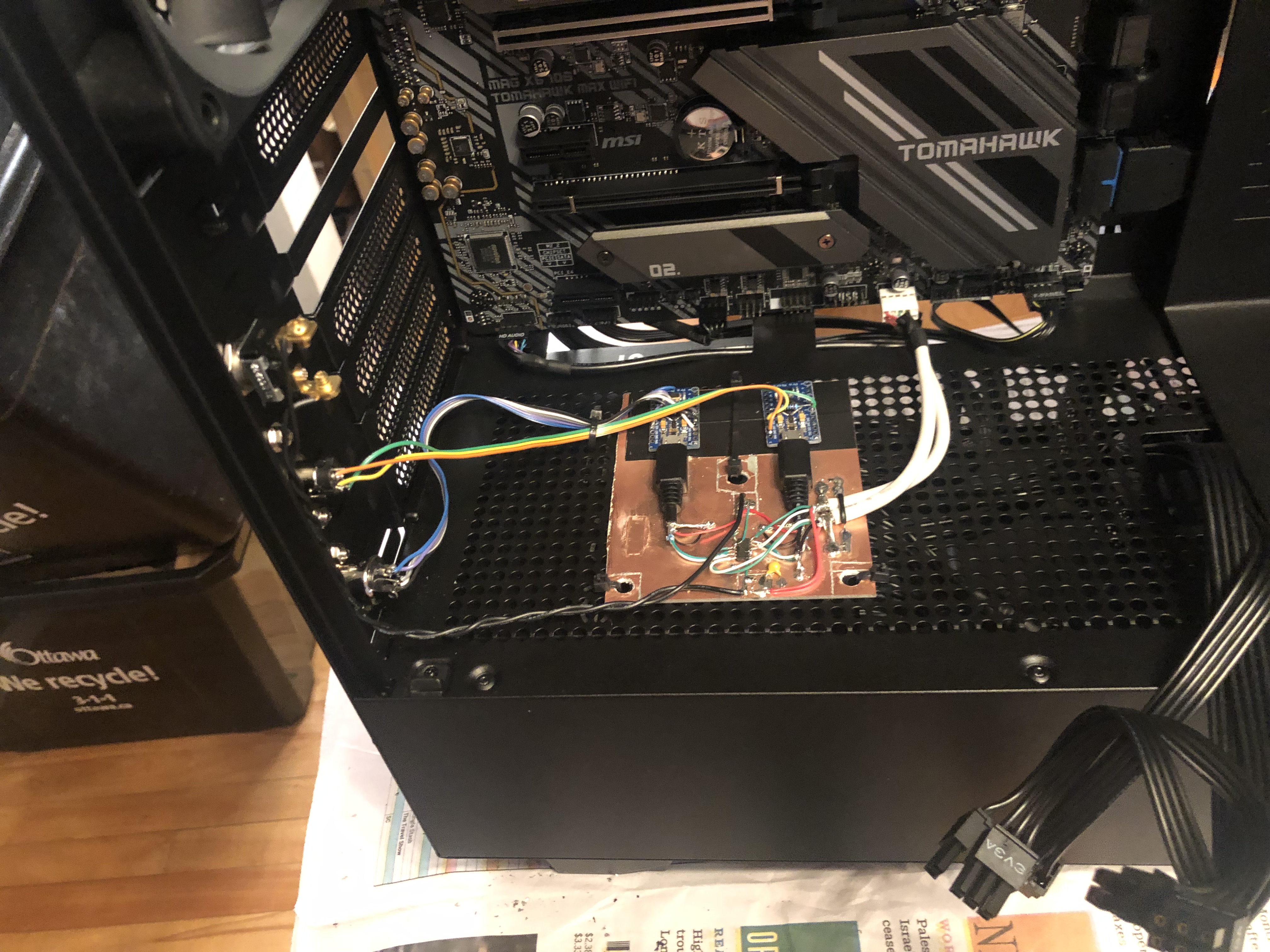

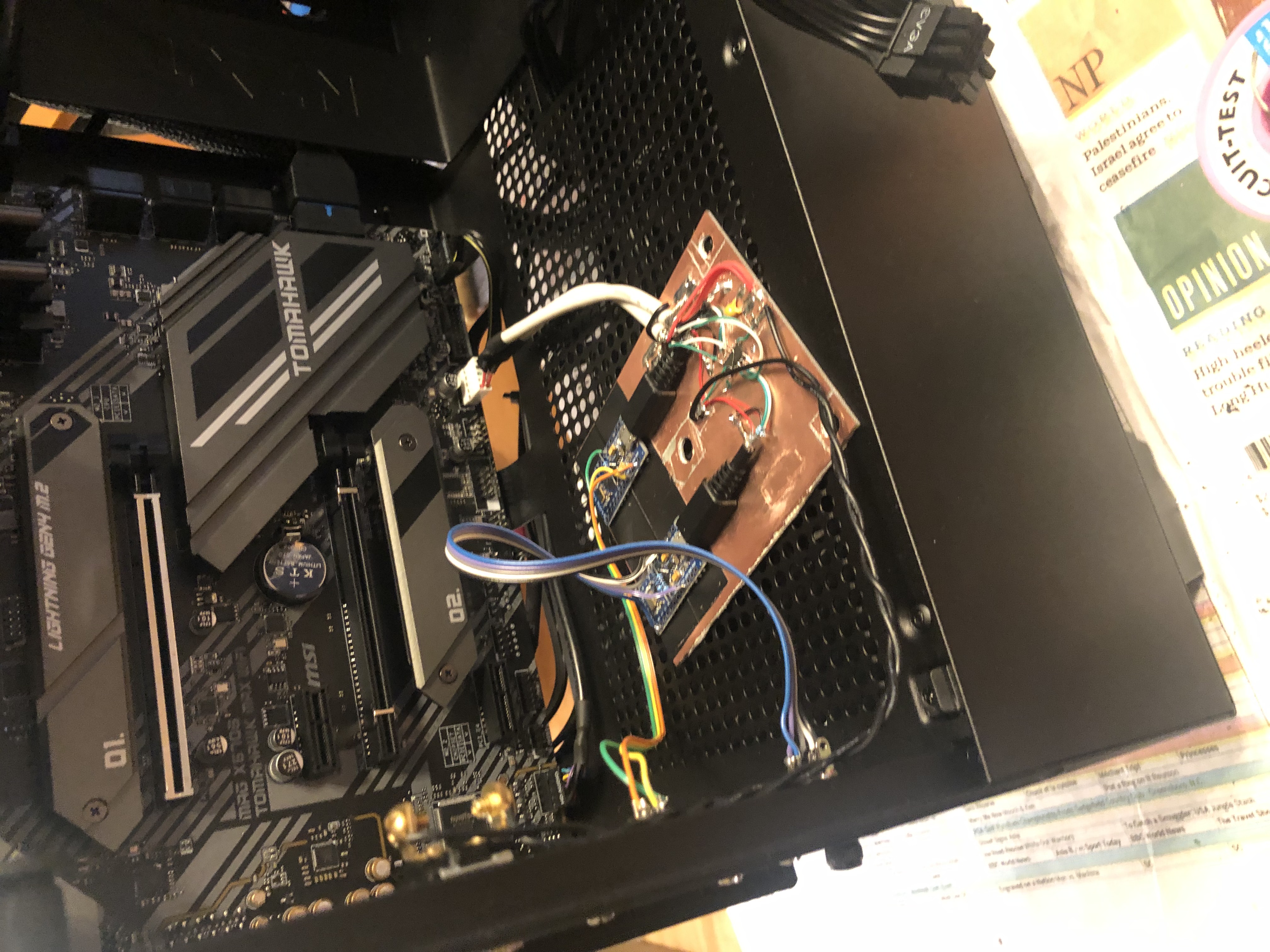

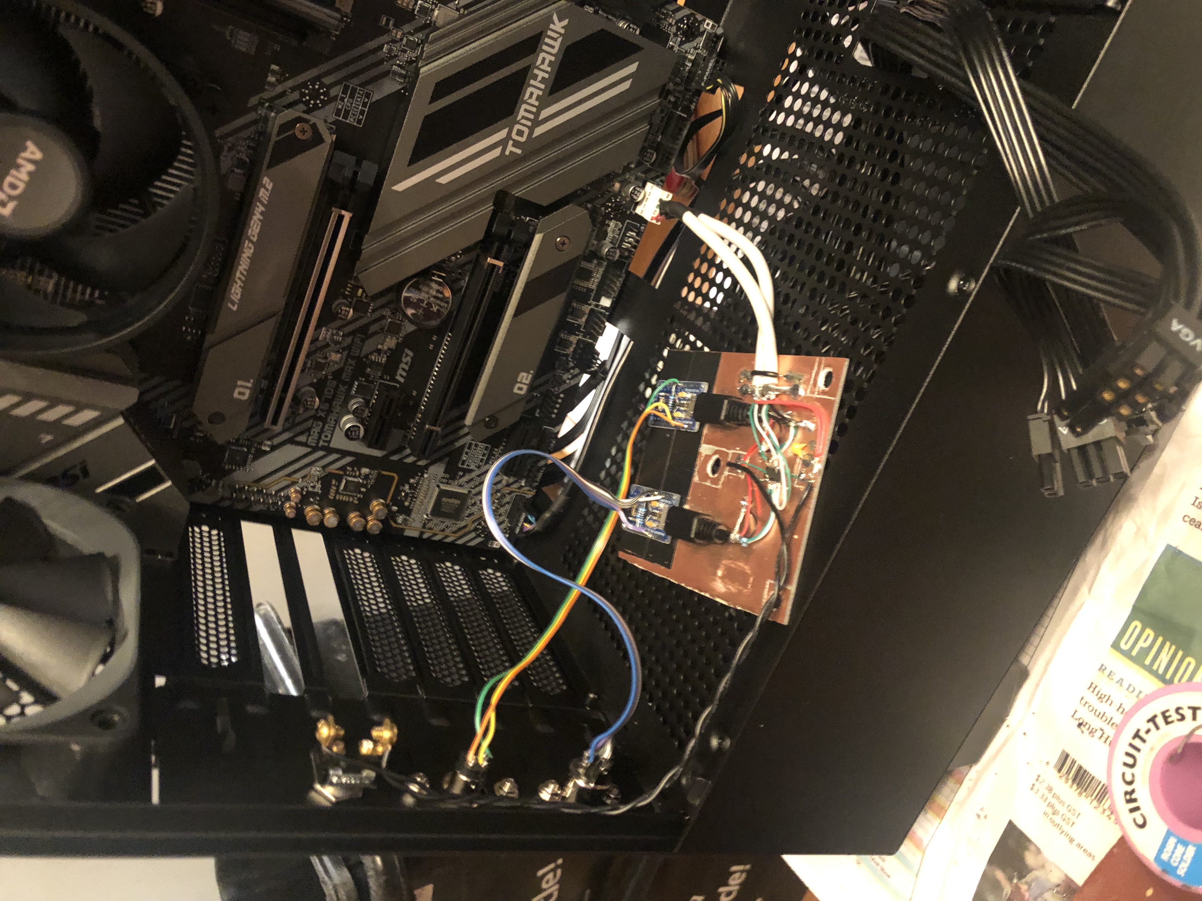

Several photos of the adapter board in the case.

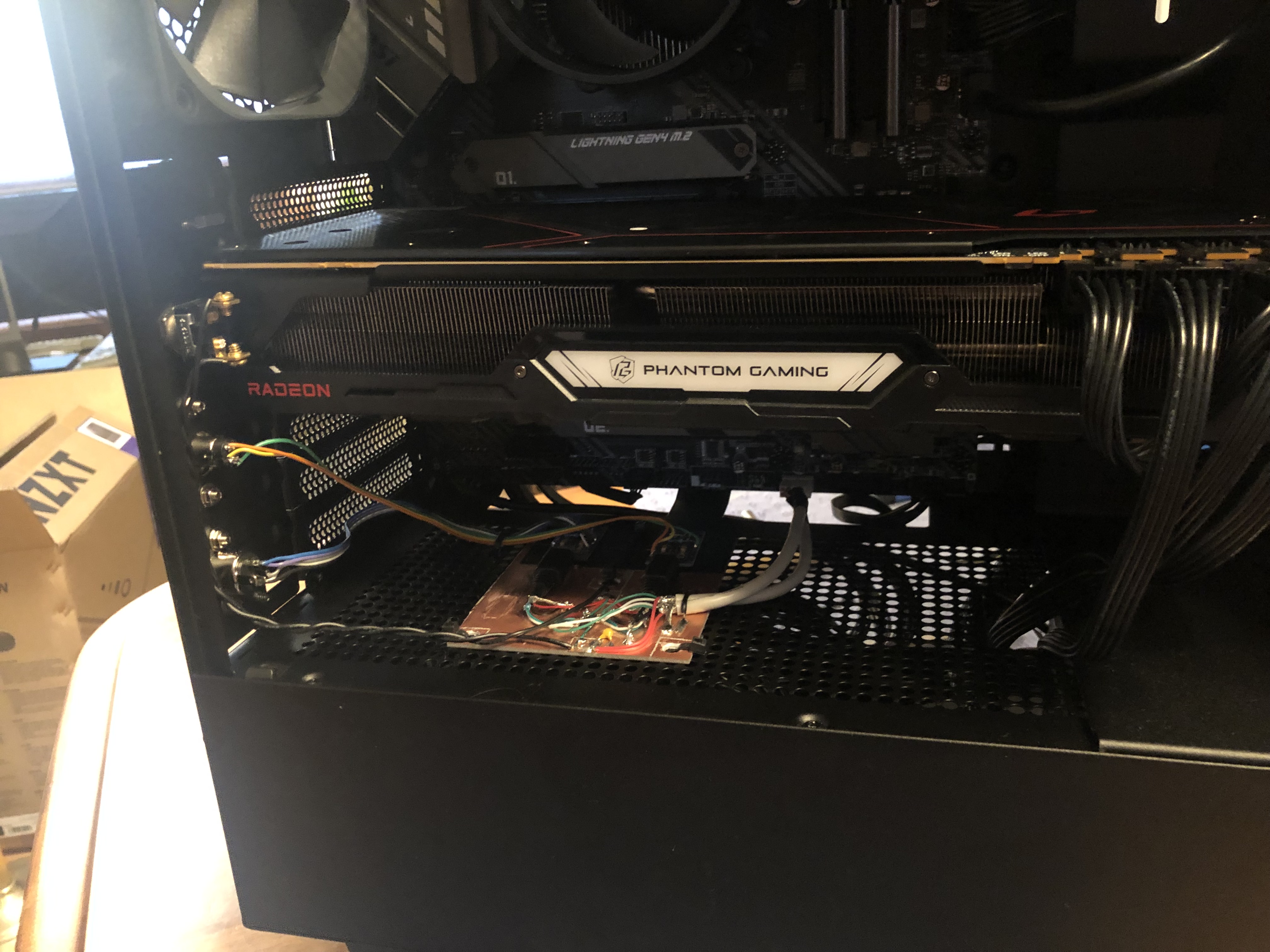

Finished board installed with the GPU back in place (I took it out to have more room to work).
Back panel of the case with the mod finished. Shows the two adapter ports and the switch that turns them off and on.
