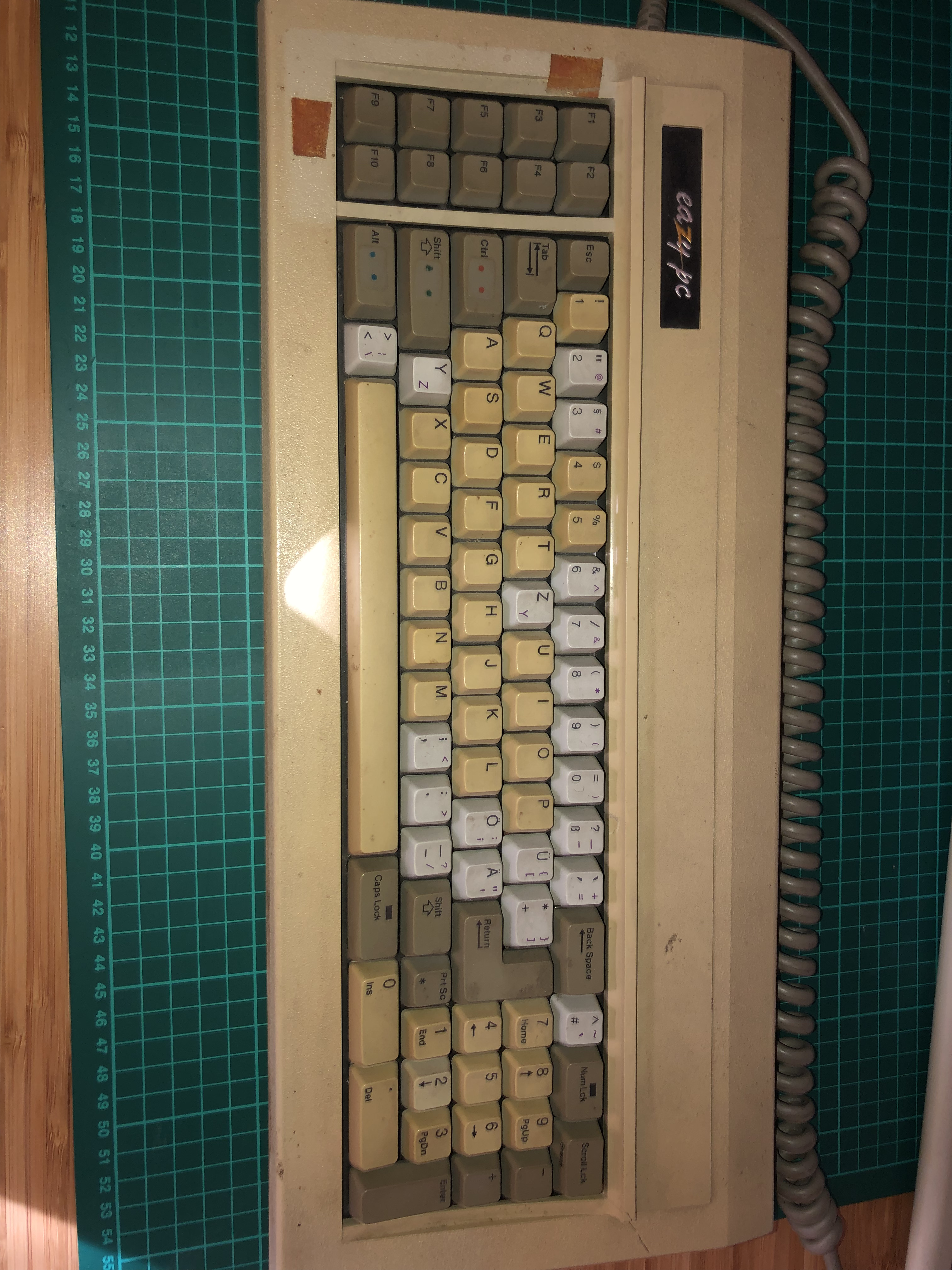

Hey Guys,
after searching countless time on ebay, i finally managed to get my hands on my dream board.
Well almost, i was searching for a ZKB-2 , but iam content with a Z-150. ;)
assembled
assembled
Its a german board , so there are a few ( a little annoying) differences.

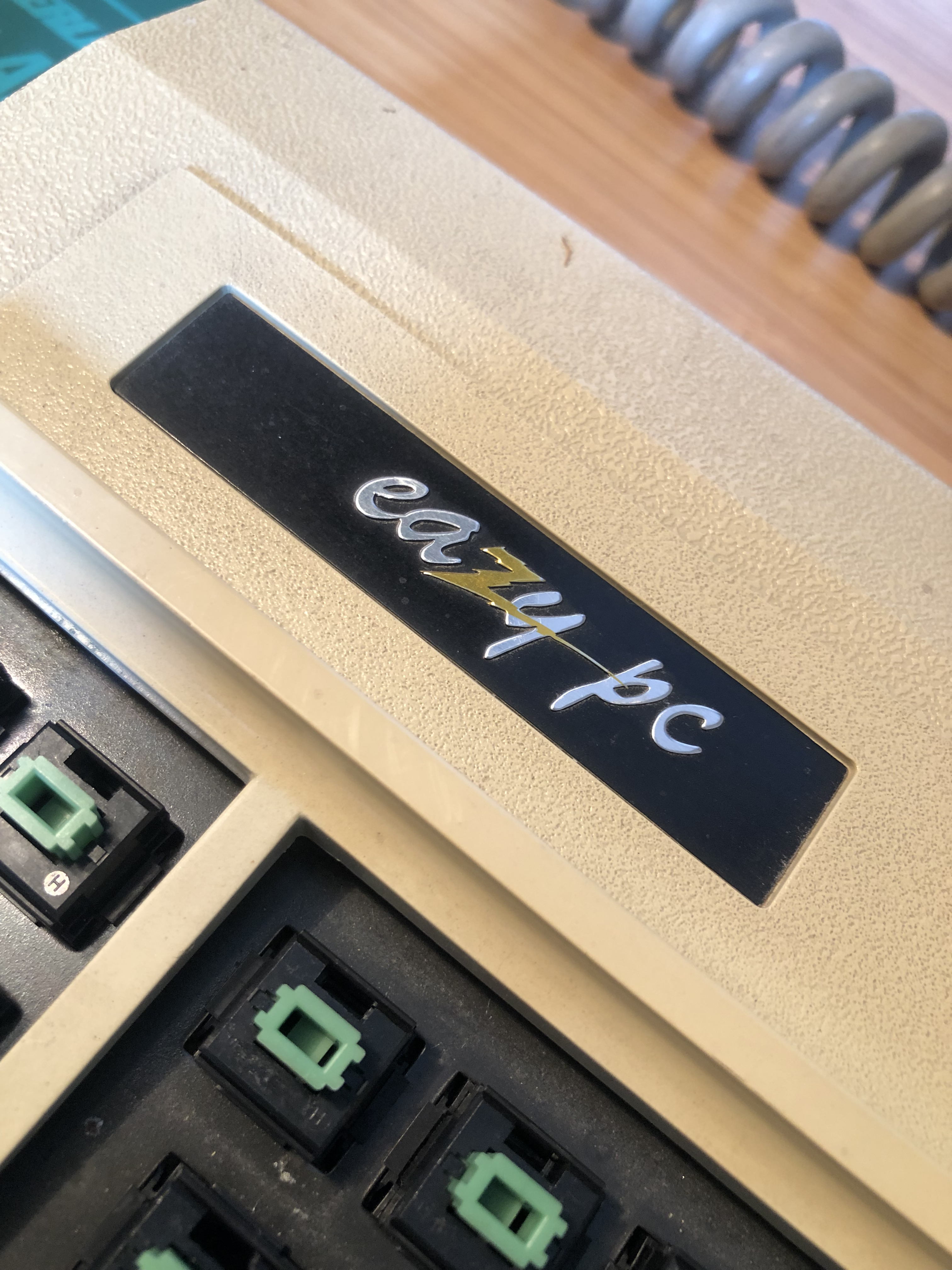

The branding sticker on top says eazy pc , but luckily , it still has the very stylish Zenith "Z" .

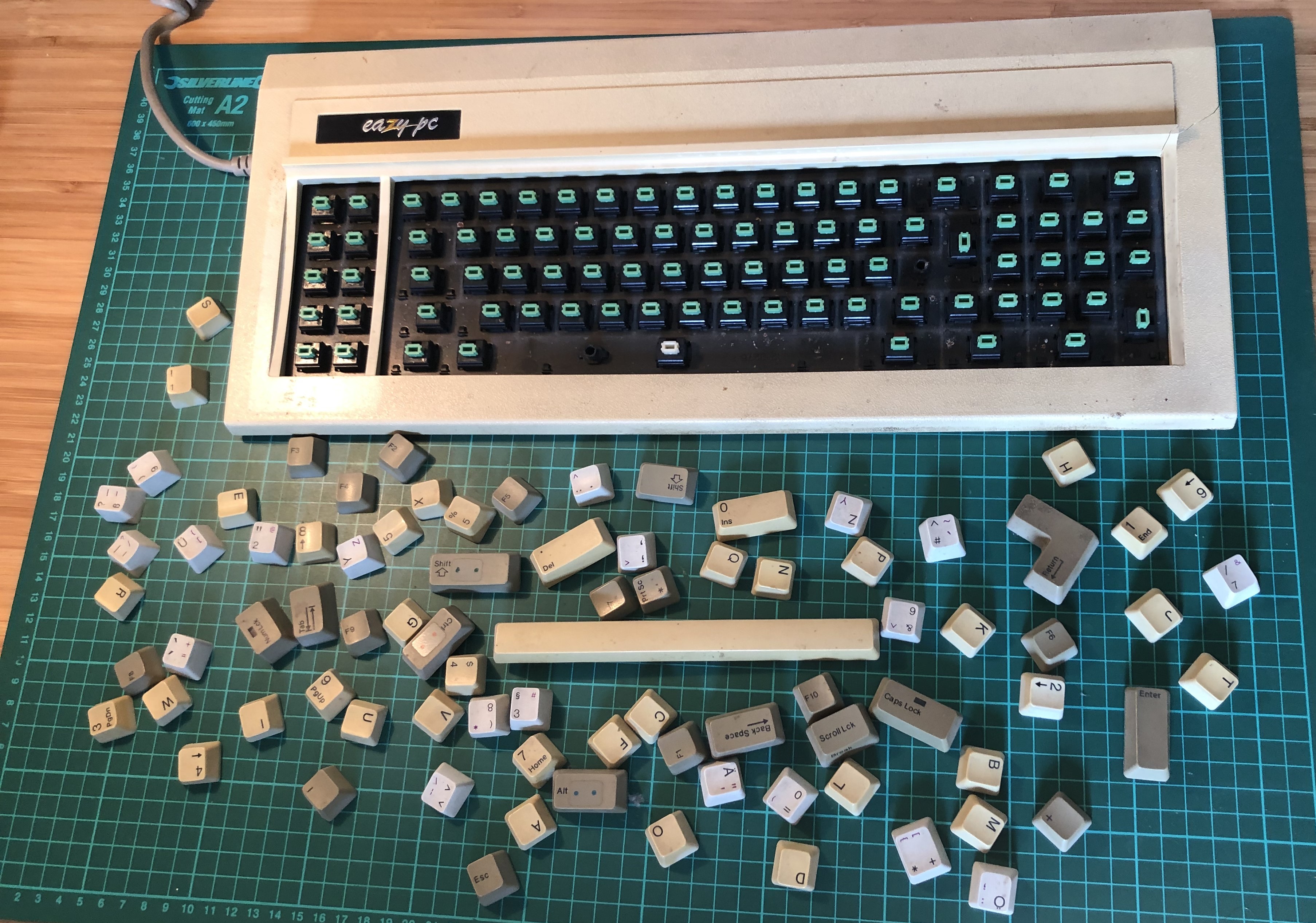

disassembled
disassembled
Iam planning on retr0brighting the keycaps , but since the dyesub caps are pbt, i dont need to worry about removing the legends on them, since they dont need to be retr0brighted.

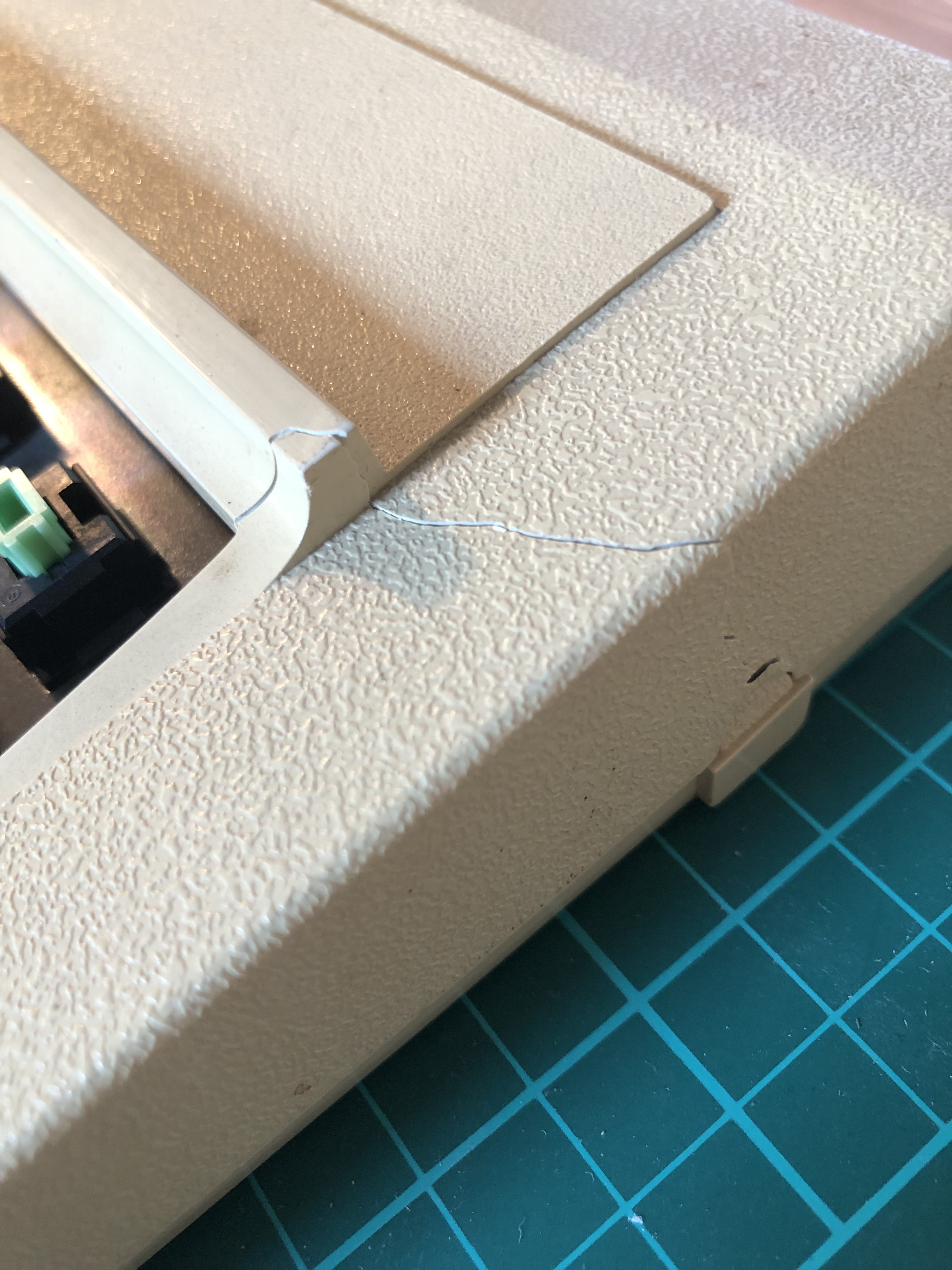

There is a small crack in the upper housing, any tips on how to fix that so you cant really see it ?

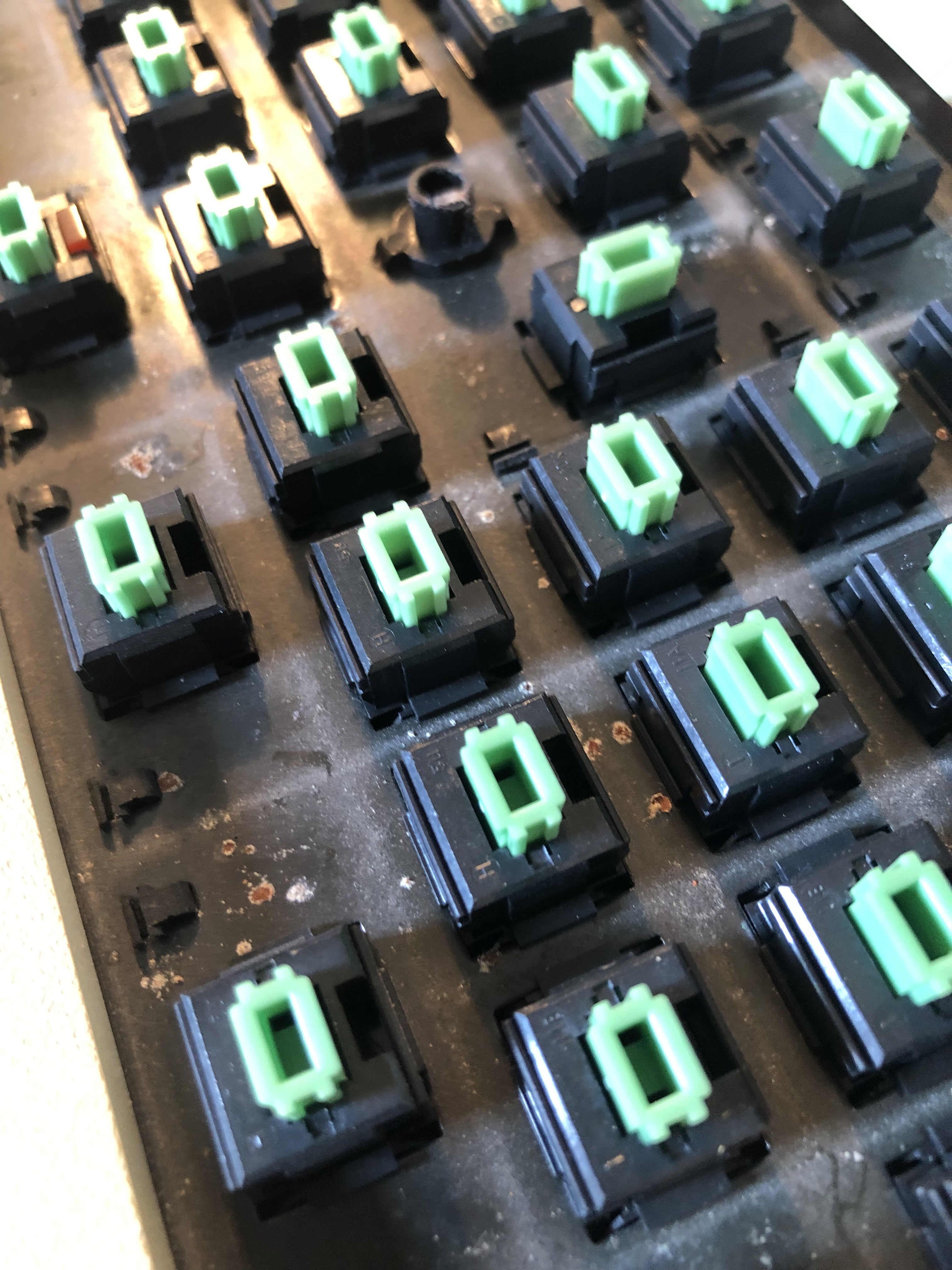

My ultimate goal would be to completely disassemble it, ultrasonic clean the switches and lube them. What is the best way to "lube" Alps Green ?

Those housings are notorious for getting brittle with time :/
I've had good results with the baking soda - superglue trick (not on this housing tho). It might be quite hard to make it not noticable

I've filled large cracks with JB Weld and judicious use of clamps. I've used superglue on small cracks, smoothing them out with sanding. In your case, I wouldn't do any sanding, except on the inside of the case. Sanding will remove that texture, so be careful.

Almost all of the keyboards I get have rusted switch mounting plates, so I just expect to de-solder all the switches, sand down the mounting plate, re-paint, and add the switches back. You don't really *need* to do that. I just don't call it "restored" unless I do. Remember not to do so many coats that you can't get the switches back in!
On all the green and yellow Alps keyboards I've had I used this. I don't also see any problem with doing the infamous wax-boil method. No click leaf to worry about. I've tried it on orange, blue, and white Alps without any problem.
You can also boil the top housing, bottom housing, and slider after ultrasonic-ing.

wow, i hope mine will look like that ! I just need to find a Zenith Badge, they look so much better then the german branded eazy pc does :roll:

hellothere wrote: 23 Nov 2022, 23:15 I've filled large cracks with JB Weld and judicious use of clamps. I've used superglue on small cracks, smoothing them out with sanding. In your case, I wouldn't do any sanding, except on the inside of the case. Sanding will remove that texture, so be careful.
Got it , no sanding :) I think i will use super glue and then just clean the shells , and spraypaint them.

hellothere wrote: 23 Nov 2022, 23:15 On all the green and yellow Alps keyboards I've had I used this. I don't also see any problem with doing the infamous wax-boil method. No click leaf to worry about. I've tried it on orange, blue, and white Alps without any problem.
I heard of that stuff on here before ! maybe even from you. Would you advise to do both the wax boil and the finish line stuff , or only one of those ?
hellothere
24 Nov 2022, 17:02
I'd say that you should do one or the other. I've had thoughts of doing both the wax boil on the sliders and Finish Line on the top housing "slider channels," but that's sounded like too much work to me. Especially for a keyboard I was going to resell, anyway. Might be kinda interesting on an Alps linear switch, though.
