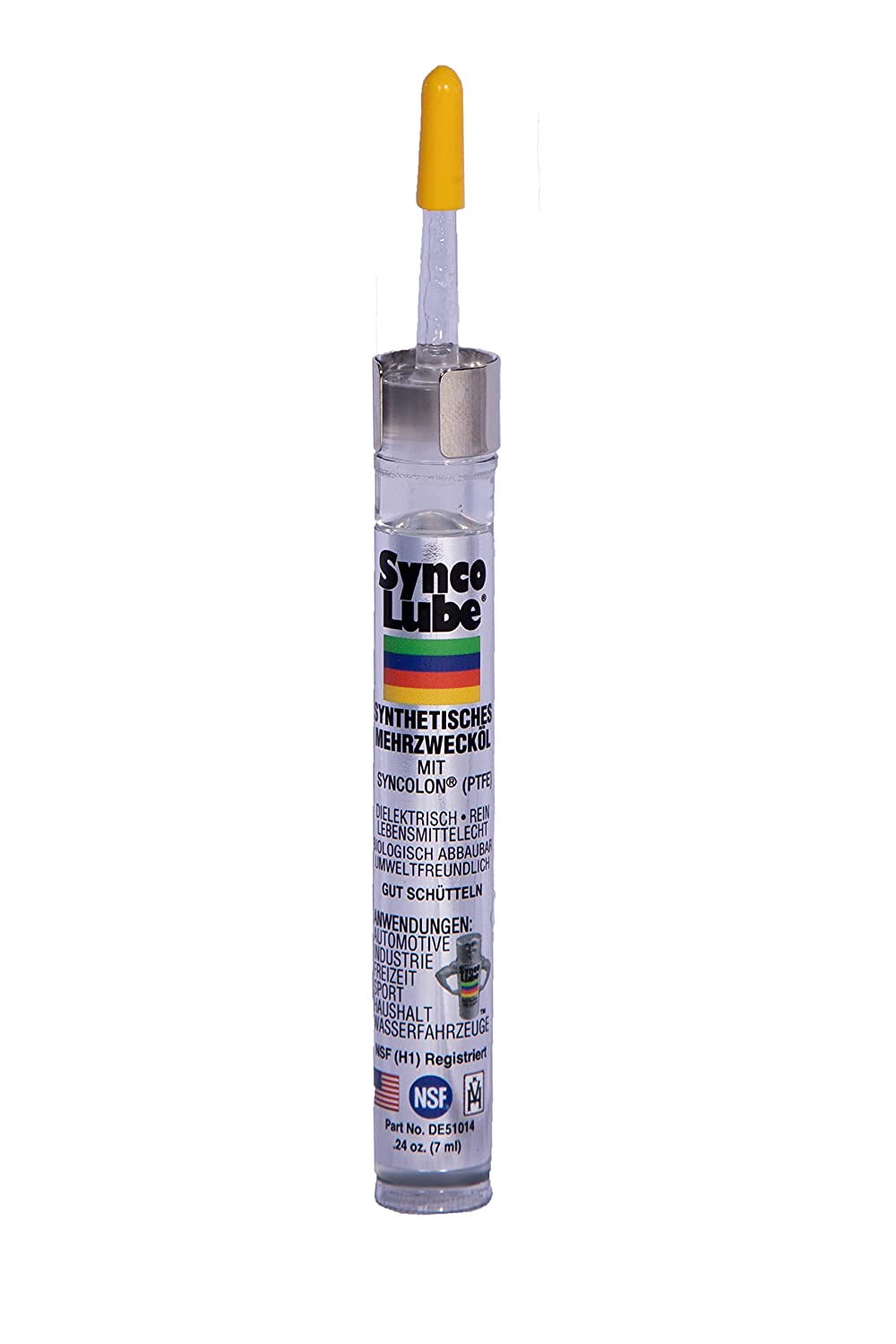

TNT wrote: 25 Dec 2022, 12:53 That's Mitsumi Miniature Mechanical (the white, tactile version). Usually not held in high regards by basically everyone in the community, but this one is brand new, so no use and also no dirt and dust. No binding, no scratching, just a very satisfying tactile bump before you bottom out. My secret Santa also lubed parts of the board which makes a noticable difference in both sound and feel. A bit of a shame you can't really use it because the switches will go bad with that :(
Can't wait to bring this one to the keyboard meetup in January :mrgreen:
Hey, could you maybe elaborate on why switches go bad with that kind of lube ? I recently built a Board and lubed the switches (outemu silent white`s) with that exact kind of lube & would hate to see it go bad.
I can recommend the Synco Lube method where u use a wooden dental stick to press down on the stem while you put a drop in 2 of the 4 corners of the switch, but sadly i know heard multiple times that this kind of switches will destroy switches so i dont really know.
Maybe someone else has more experience with that kind of lube. Sadly i already used it on one of my boards before.
And while it is working perfectly right now and the lube did help out those cheap outemu switches, i dont know if it will continue to work in the future. :roll:
Edit: apparently the lube isnt damaging to the switches at all :lol: just misread a post about it
