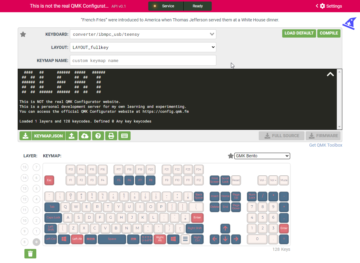

As some may already know I recently needed to setup a personal instance of QMK Configurator to test some things. I did a full write up on my site about how to do this but wanted to post this as well on the forums to spread the info a bit more since my blog is tucked away. Here's a link to the instructions on my site:
https://www.snacksthecat.com/p/setting- ... vironment/
Intro
This guide explains the steps I went through to setup my own instance of QMK Configurator. These steps should serve as a general how-to guide and hopefully fill in some gaps for people who may have gotten stuck. Some of the details, specifically adding your own custom keyboard to the configurator, can be approached a few different ways; so the information in that section may be less prescriptive and more for reference.
I did this on a machine running Ubuntu Jammy. I was not able to get this all working locally due to some networking challenges I couldn’t figure out. Due to that issue (and since I wanted to give some people access over the Internet anyways), I hosted my configurator using a cloud service provider. I chose to use Kamatera since they offer a 30 day free trial for 1 server and pricing beyond that was reasonable, but anything similar would work.
As a prerequisite you’ll need to already have Docker and Docker Compose setup. Instructions for installing Docker on Ubuntu (and other distros) can be found on the Docker website. You don’t need Docker Desktop unless you find that useful for managing your containers.
I’d recommend reading through this full post first before trying to follow it step-by-step. I don’t explicity state it in any of the steps but you should try building the containers at various points along the way. The command is: docker compose build

4. Add a Custom Keyboard
If you’re setting up your own Configurator, it’s likely that the reason for this is to test out your own keyboard firmware. The instructions below will explain how to do that.
It took me a lot of experimenting before I was able to get everything working. I wanted to avoid modifying any of the submodule files but found that some were unavoidable for various reasons.
Note: These instructions explain how to point the configurator to your own keyboard list. So the default list will no longer be available after doing these steps. The steps below are only necessary if that’s your intention.
Custom Keyboard Data
The configurator pulls both the list of keyboard and the individual keyboard info/readme files from https://keyboards.qmk.fm

6. Docker Compose
Finally it’s time to build and launch the containers which should bring your configurator online and make everything work end-to-end with all of your changes.
Navigate to the main project directory:
cd ~\qmk_web_stack
Run the following command to build all of the Docker containers. It will take some minutes.
Hopefully it builds OK. If so, launch all of the containers using the following command:
docker compose up
You’ll want to keep an eye on the log output and make sure that all service workers get launched. If you see some ugly errors, most likely one of these failed to launch and you’ll need to backtrack.
Now you should be able to visit your configurator at: http://<your_url>:5000
Congratulations, you're done!
