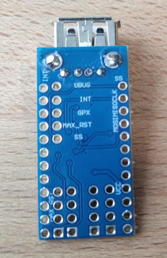

Hello everyone
A few months ago I bought a usb host shield, to mount a usb-usb converter (like this one https://yaowei.dev/posts/usb-to-usb-converter/, for example).
It is supposed to be able to directly attach a promicro or similar microcontroller (I have a Chinese clone saved for it).
The right column of the usb host shield is labelled as in the picture:
The problem is that the order on that row of pins should be (from top to bottom), SS-MOSI-MISO-CLK.
Looking into the issue, it's not clear to me if it's a problem with the labelling, or if the MOSI-CLK pins are actually crossed. Most mini USB host shields sold on Aliexpress are labelled like mine; I'm surprised that all of them are wrong.
Thanks in advance.

Actually the labels are saying otherwise, but I don't know if the pins are in correct order.
Well, the promicro (and clones) pinout:
The elite-C one:
and even the new RP2040 based microcontrollers
use the same pin order (from bottom to top, SS, MOSI, MISO, CLK)
So I wonder why a board intended to work alongside (literally, pin-to-pin) with this class of devices, has a pair of twisted pins.
Thanks for reading.

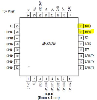

If you want to be extra safe you can add a ~1kOhm series resistor on the data lines. You can also look up the pinout in the datasheet for whatever chip is on the shield and trace the pins back to it visually or with a multimeter.
Not sure what exact chip you have but here's the first one I found:
caberolo
22 Oct 2022, 17:15
jsheradin wrote: 14 Oct 2022, 16:55 Not sure what exact chip you have but here's the first one I found:

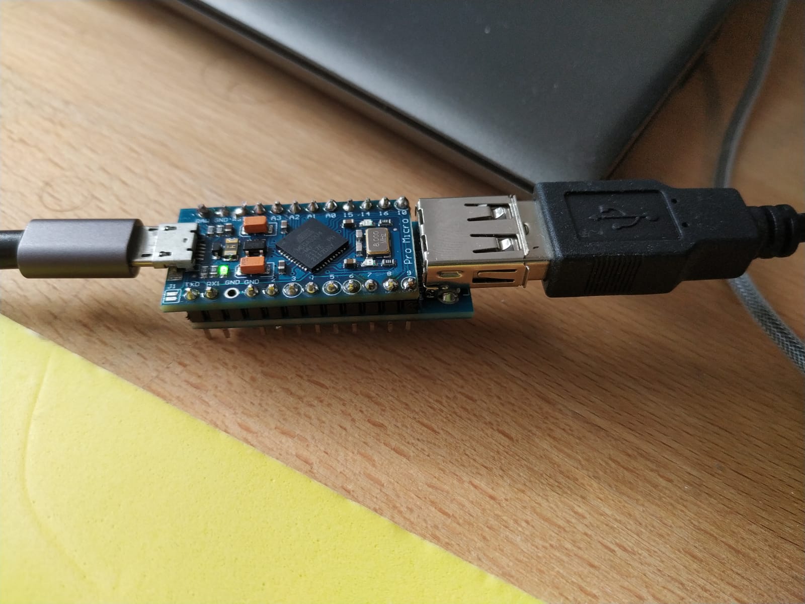

Finally, I was able to confirm that it is a labelling problem with the USB host shield. After reading your post, I looked up the diagram of my chip (which is the same one you linked to), and followed the path from the corresponding pin to its hole. Indeed, the UHS pins are correctly positioned and incorrectly labelled, as I suspected.
Also, I wrote to Deko (the Japanese guy I mentioned in the OP), who confirmed that the Chinese clones of the UHS must be mislabelled.
I soldered my UHS to the promicro, and it works perfectly. This is what it looks like:
Not the best soldering in the world, but it works.
Thank you all for your interest and help.
Best regards.
