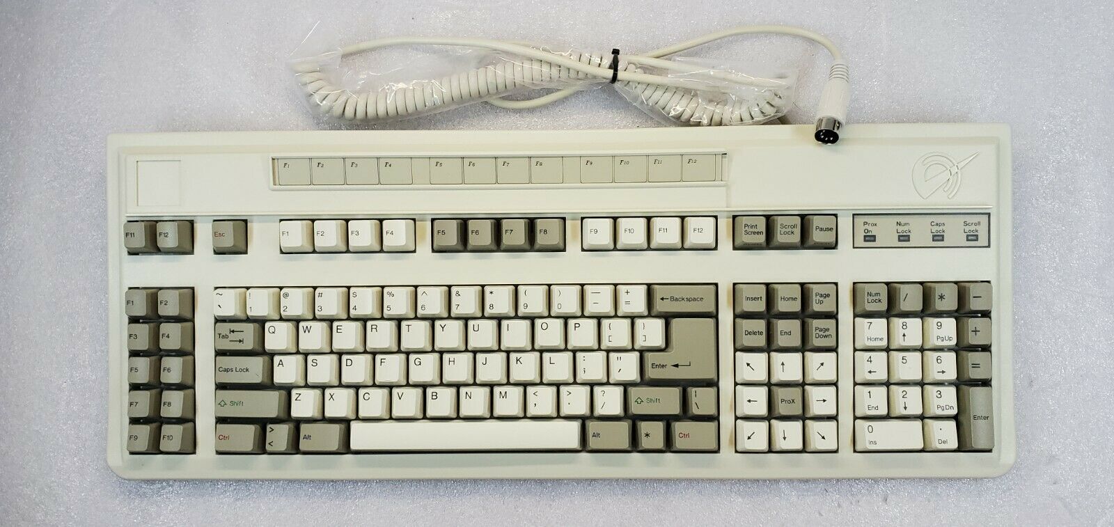

Here's an old ebay photo of an Alps ProXellent. The <> and * in the bottom row should work as Windows keys once reassigned, as long as you can come up with keyboard shortcuts for those keys to be reassigned to (Ctrl-Esc and ??).engr wrote: 22 Nov 2022, 03:00 Added ProXellent Alps-compatible boards to the title. While they don't have Windows buttons, it's a solid chassis with hardware-level programmability.
- ProX2_.jpg (192.26 KiB) Viewed 55768 times
- engr
- Location: USA
Unfortunately, there doesn't seem to be a way of making them work like Windows keys. You can make these buttons open Windows menu with Ctrl+Esc, but all the shortcuts involving Windows key, like Win+E to open File Explorer, won't work.Polecat wrote: 22 Nov 2022, 05:36 The <> and * in the bottom row should work as Windows keys once reassigned, as long as you can come up with keyboard shortcuts for those keys to be reassigned to (Ctrl-Esc and ??).
- Polecat
You can do most things with a macro even with no Windows keys. For your example, to get to explorer type Ctrl-Esc, type cmd, then type explorer. Easy to do that as a keyboard-based macro. I have only one or two keyboards with Windows keys, which I never use. Can't miss what I never had.
- engr
- Location: USA
I think I tried something like that on my Ortek and it didn't work very well. I suspect it needs a slight delay between commands to let Windows respond properly.Polecat wrote: 23 Nov 2022, 01:53 You can do most things with a macro even with no Windows keys. For your example, to get to explorer type Ctrl-Esc, type cmd, then type explorer. Easy to do that as a keyboard-based macro. I have only one or two keyboards with Windows keys, which I never use. Can't miss what I never had.
- Polecat
The DOS Pause command still works in the command window (and prompts for an Enter) so you can make delays with one or more Pause, Enter combinations. It's been decades now, but I still think in DOS terms. Yes, I'm old.engr wrote: 23 Nov 2022, 05:33I think I tried something like that on my Ortek and it didn't work very well. I suspect it needs a slight delay between commands to let Windows respond properly.Polecat wrote: 23 Nov 2022, 01:53 You can do most things with a macro even with no Windows keys. For your example, to get to explorer type Ctrl-Esc, type cmd, then type explorer. Easy to do that as a keyboard-based macro. I have only one or two keyboards with Windows keys, which I never use. Can't miss what I never had.
edit: even easier, just type Ctrl-Esc then 'run explorer'. I'm enjoying these command line flashbacks. Maybe time to throw away my mouse?
