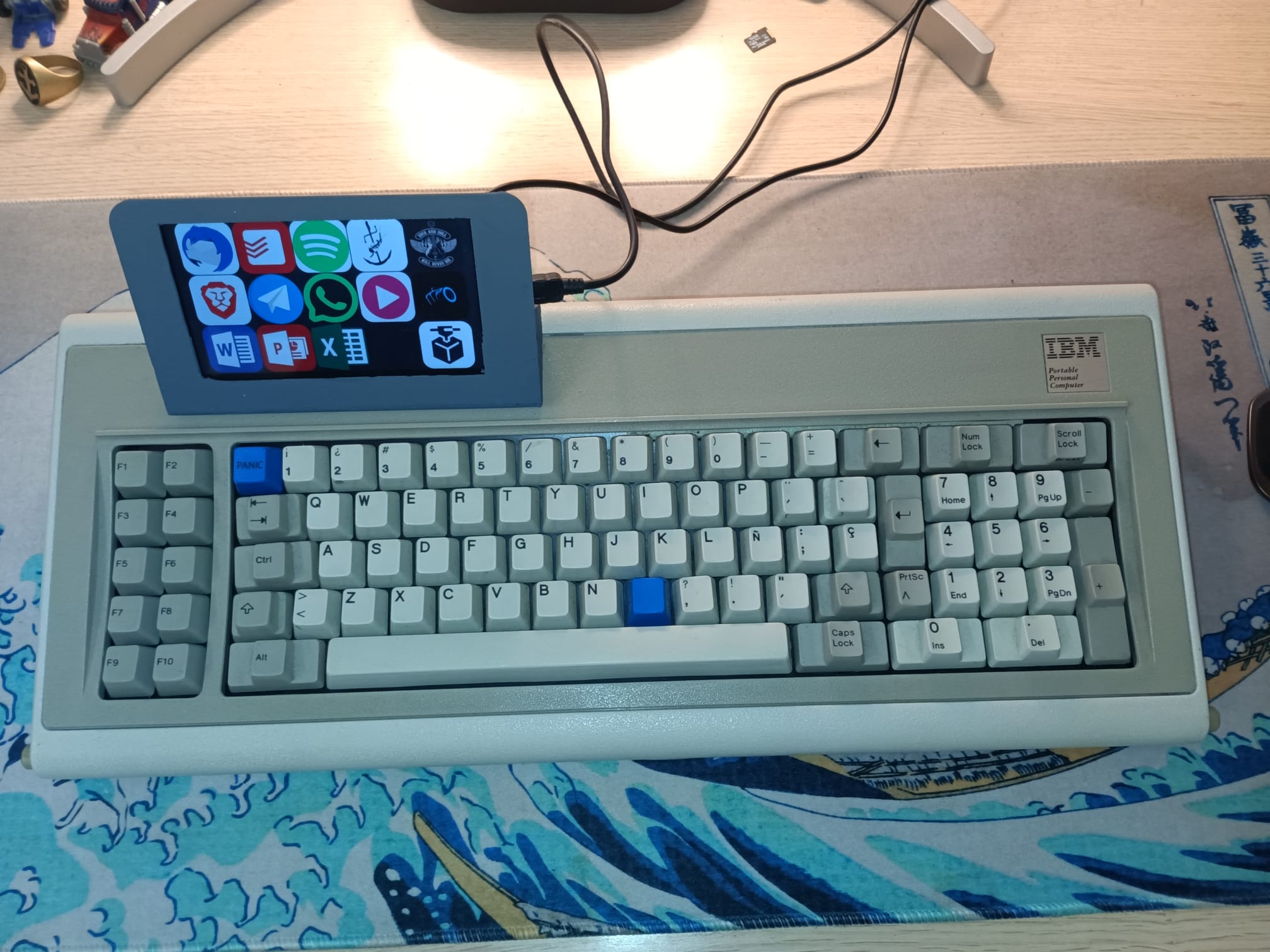

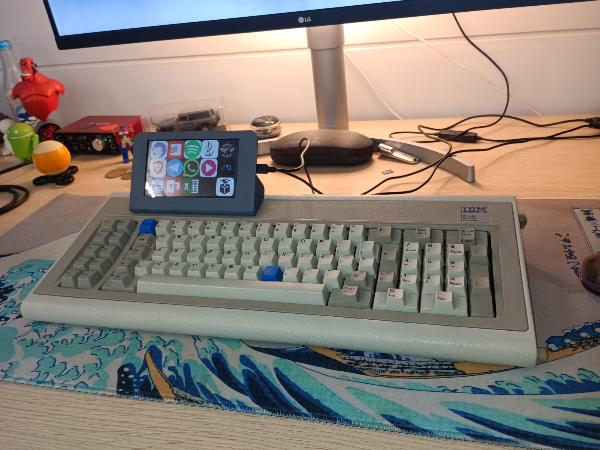

Hi guys. It's been a while since I last posted here, but I would like to show you how my project went.
About a year ago, I purchased an IBM 5155 (the portable computer) keyboard. I wanted to make a soarers converter for it and get it to work, but I lacked some info on the pin-out of the connector to the board, so I was afraid of messing it up. I had the Teensy and everything, but I was procrastinating on it for said concerns.
The other day, I said: fuck it, I will do it. I started gathering all the info I could about how to make the converter and how to wire things up. I found the pin-out in the fantastically complete website https://sharktastica.co.uk/topics/kb_connections by Sharktastica.
So I made the converter, which for most of you will seem like a minor detail, but I am fucking proud of myself as I had almost no experience with either arduino or soldering anything smaller than speaker terminals.

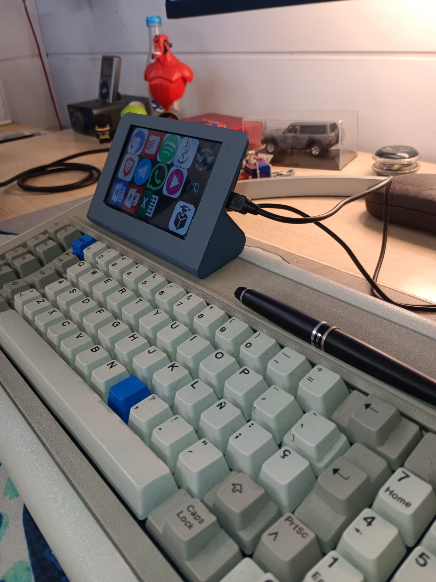

Then I designed and 3d printed an enclosure for my macro screen (that is actually an old android phone running MacroDeck, an app that basically turns a phone into a Elgato macro pad) and made it to fit in the whole for the original 5155 cable.
WhatsApp Image 2022-11-03 at 10.30.38 (3).jpeg (292.88 KiB) Viewed 4259 times
WhatsApp Image 2022-11-03 at 10.30.38 (2).jpeg (293.65 KiB) Viewed 4259 times
WhatsApp Image 2022-11-03 at 10.30.38.jpeg (222.67 KiB) Viewed 4259 times
So now I not only have a functional keyboard but it has a freaking screen with all my macros and shit. I am waiting for a new longer cable to arrive as I am using the last mini USB cable I had which happens to be really short.

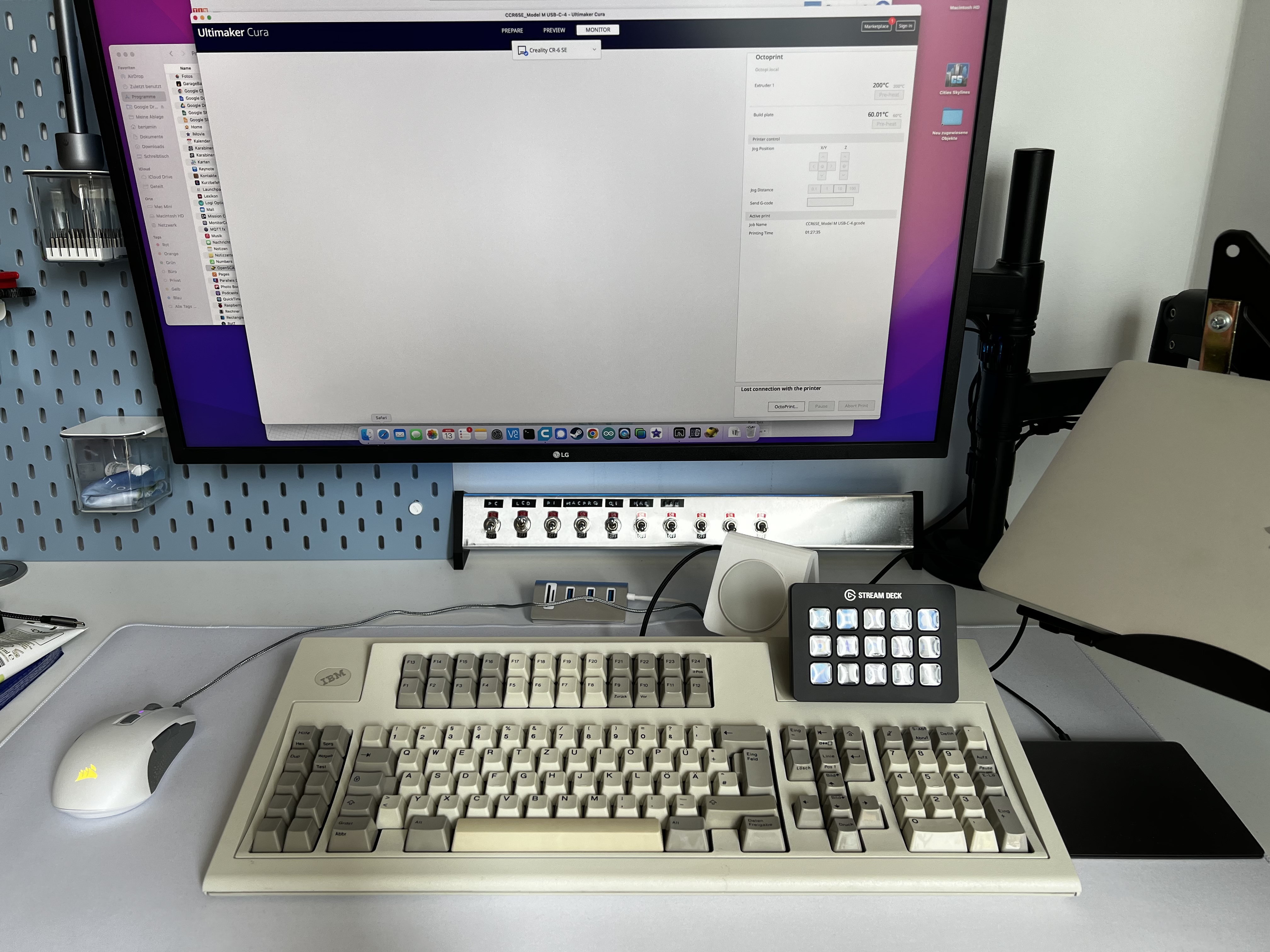

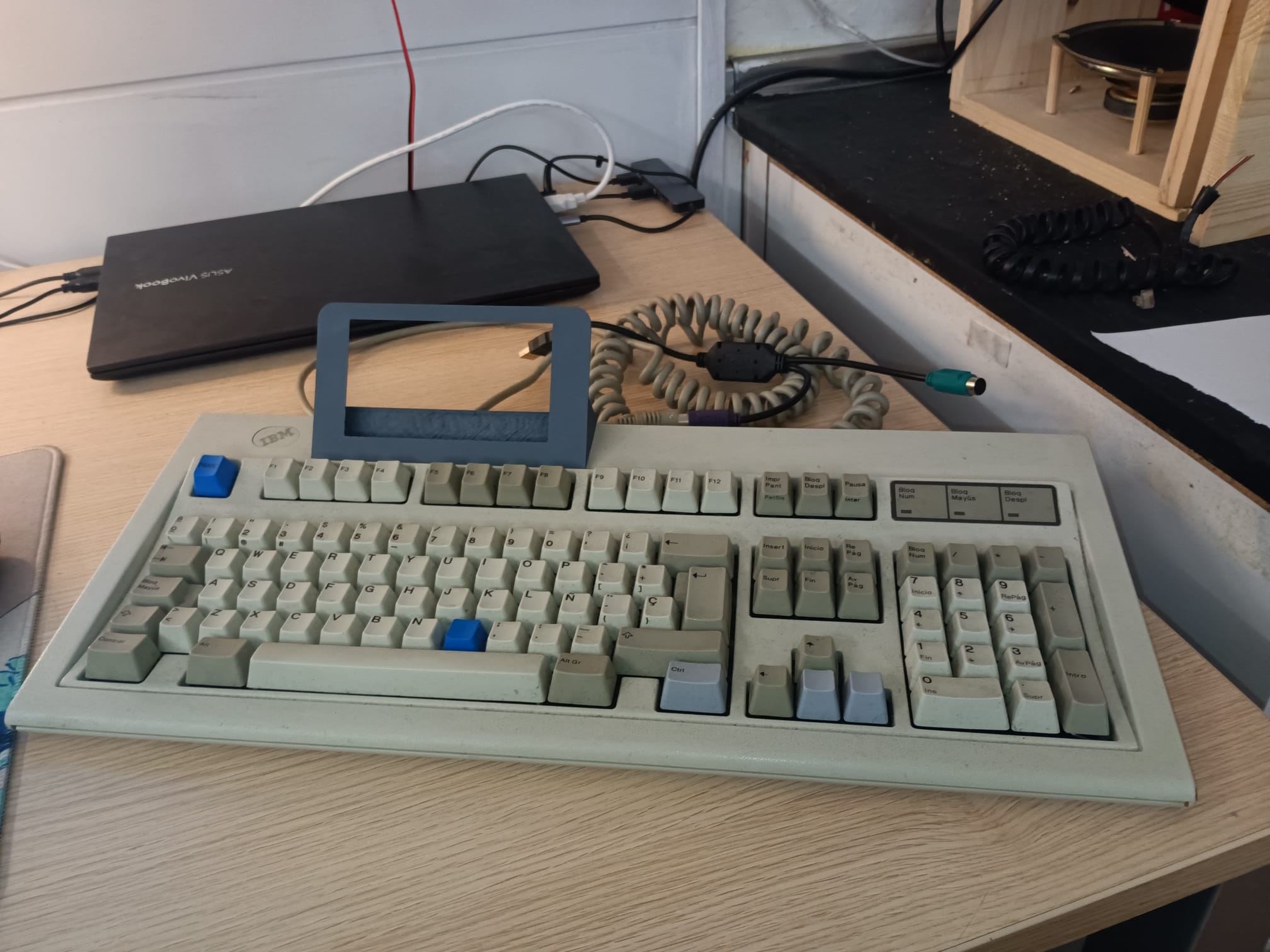

I also made a version of the screen enclosure for my model M, but that one is just placed on top of the "pencil tray" and not lock down by anything.
WhatsApp Image 2022-11-03 at 10.30.38 (1).jpeg (239.22 KiB) Viewed 4259 times
I hope you like it, I am pretty happy with the results, though I will probably look for a lighter shade of grey so the screen holder mimics the IBM aesthetic a bit better.
