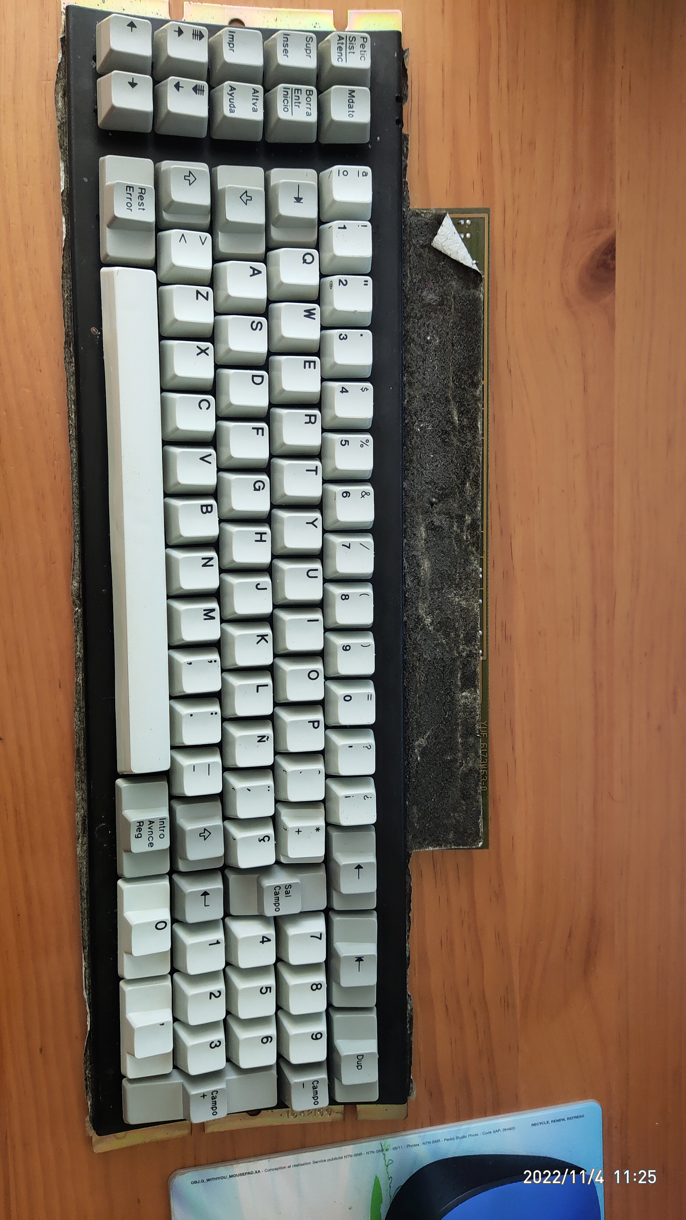

Here's a coupble of pictures of how it looks as of now. I'll take it apart, give it a good clean, new foam and then I'll put it back together and try again.
- P21104-112543.jpg (3.26 MiB) Viewed 4489 times
- P21104-112523.jpg (3.71 MiB) Viewed 4489 times

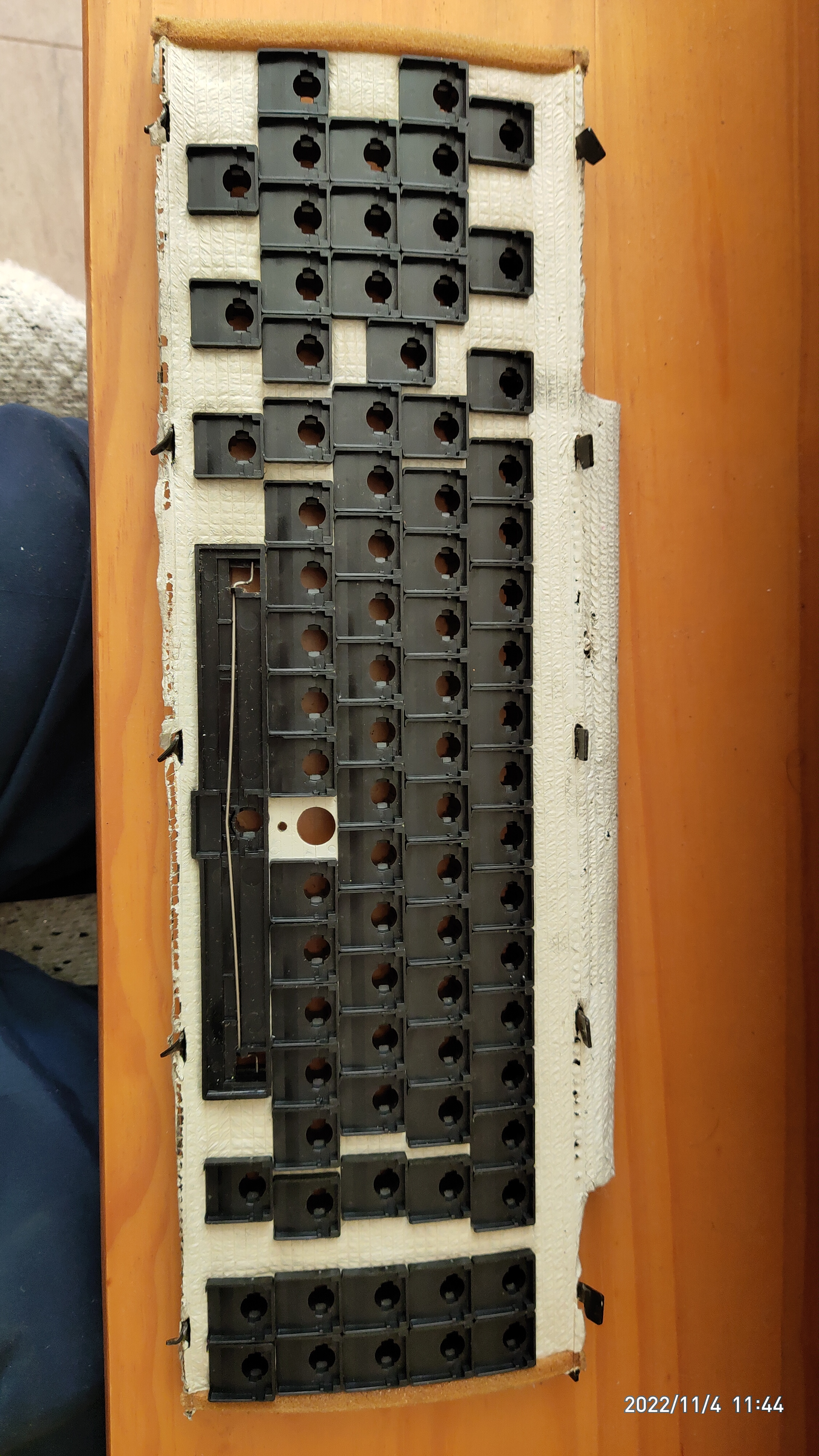

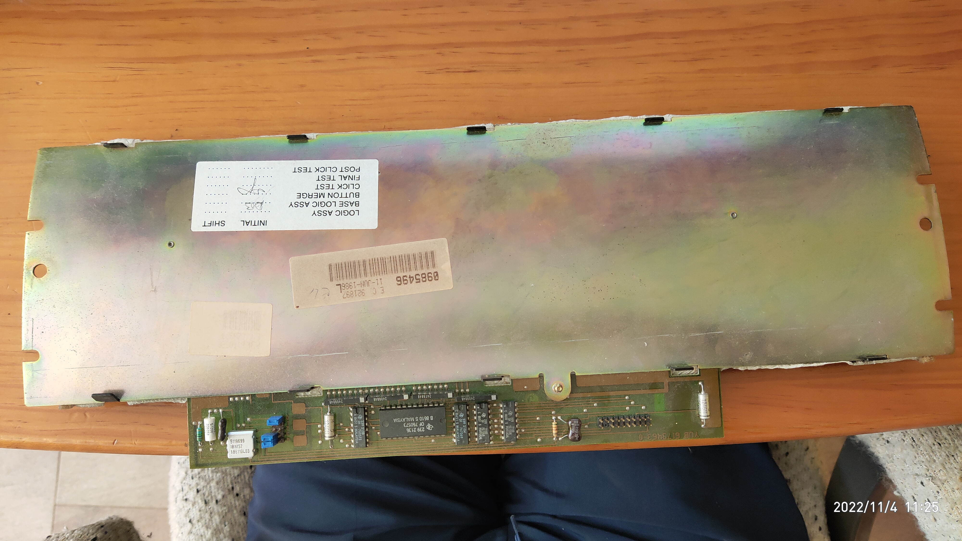

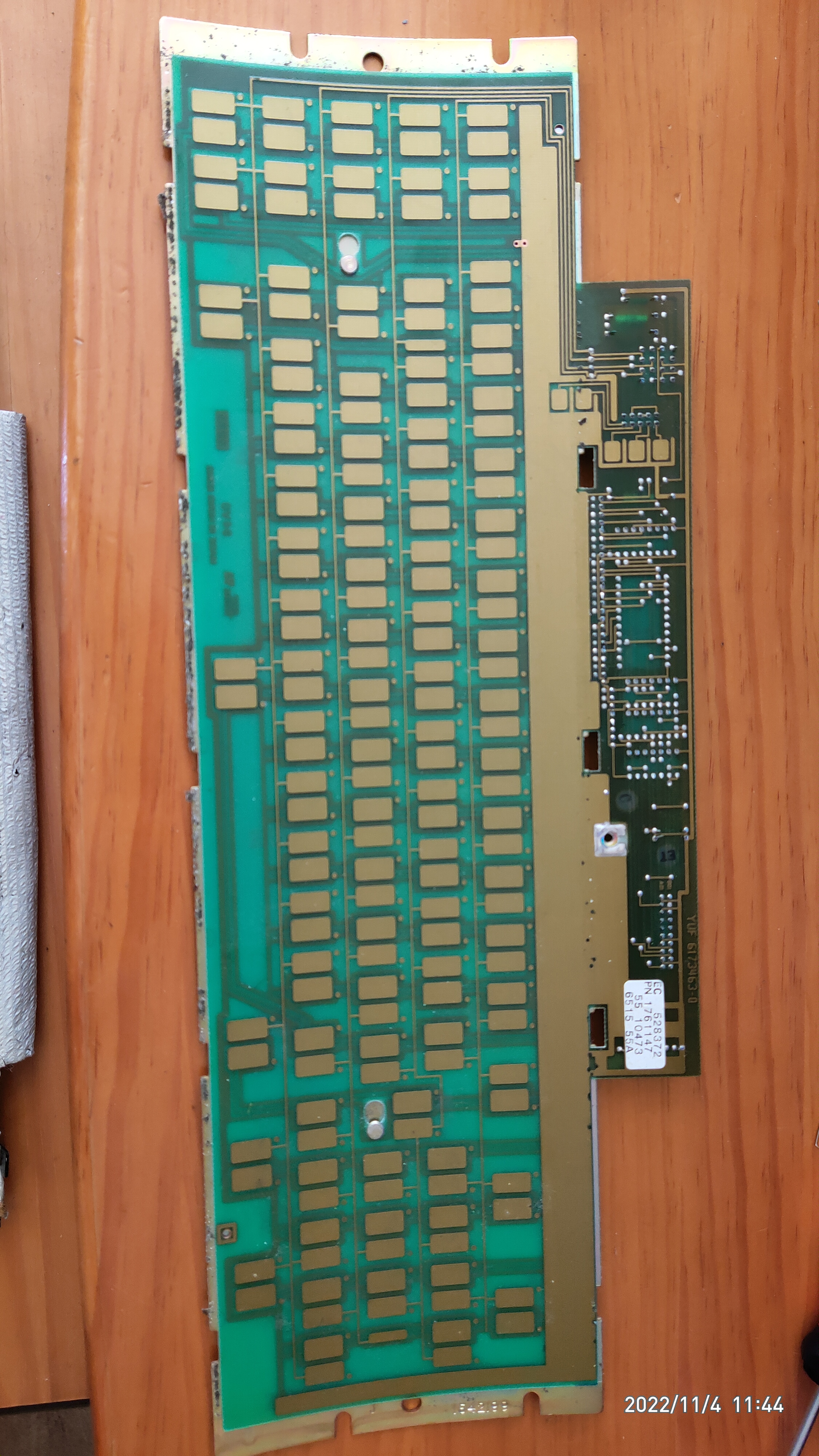

Well... already open. I doesn't look half bad. Not much dirt to speak of (haven't done any cleaning when I took the pictures), foam is degraded but not as much as I thought. Anyway, I'll clean it up, new foam... I'll let you know how it goes.
Still debating if I should repaint the mounting plate. Looks ok, not perfect. I'll se what I do.
- P21104-114452.jpg (3.61 MiB) Viewed 4480 times
- P21104-114448.jpg (3.69 MiB) Viewed 4480 times

Aye, everything looks okay. I’d be tempted to upgrade to an Xwhatsit controller, but you’ve a daunting bit of chopping to do first: either all those little traces or the PCB itself! Before you get destructive, does anyone know if this type of board (and therefore IBM controller) is known to work correctly with Soarer’s converter? IBM made a lot of stuff. It could be that nothing is broken, just not fully supported.
What protocol / code set does Soarer’s converter say it’s using? A paste of the output from scinfo could be informative.
I’d try QMK’s XT converter firmware on the Teensy first and take a look at its output in QMK Toolbox to see if it’s the same there. Probably will be the same misbehaviour, but it’s always good to try low risk options first.
