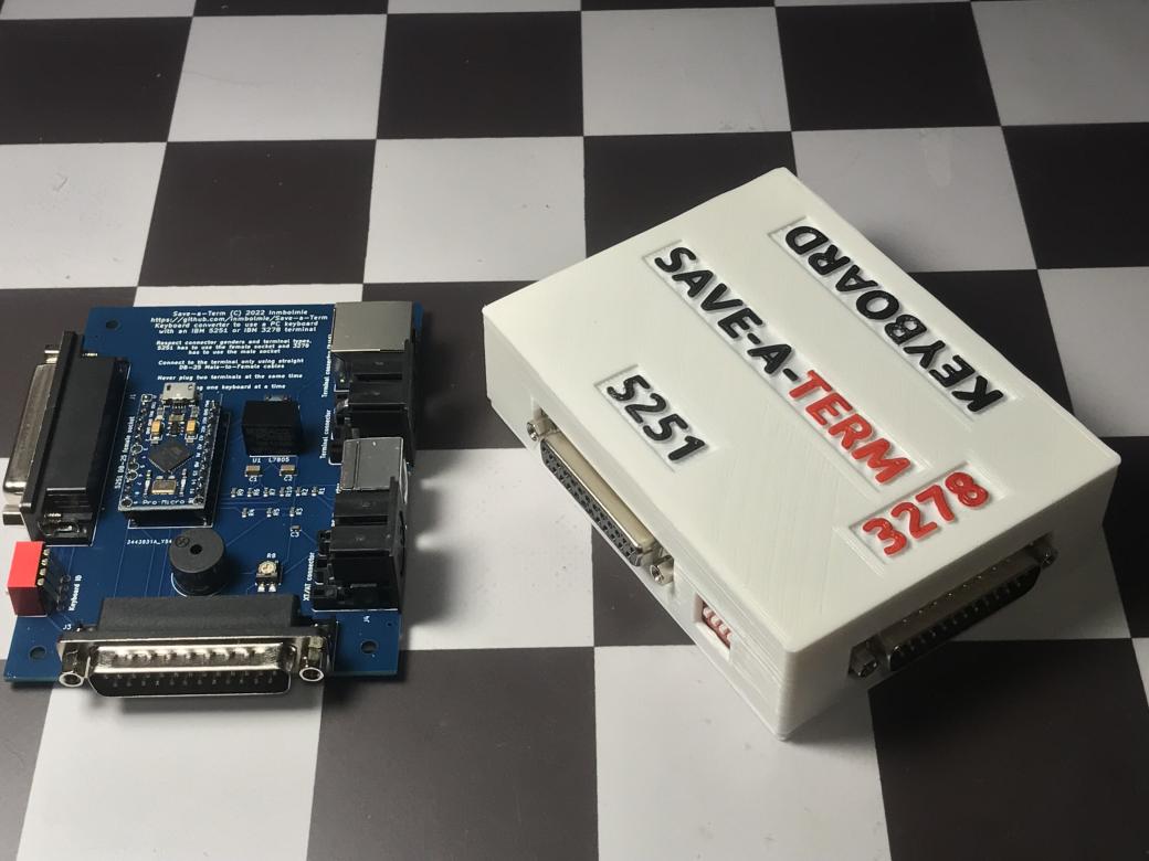

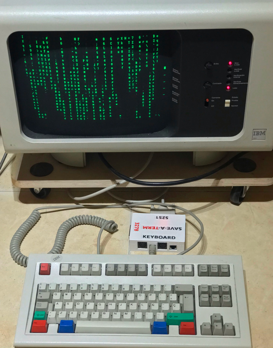

It has been a regular complaint from some owners of original 5251 and 3278 terminals without the matching beamspring keyboard the lack of a cheap replacement if you just want to use and enjoy the terminal. The original stuff is with a reason highly regarded and get pretty high prices well above that of the terminal itself. This situation sometimes sadly ends up with the perfectly functional but unusable terminals being trashed.
This project aims to give an alternative to those users making possible using a regular PC-like keyboard with the terminals. It is based on a modification of the TMK converter, so in fact it is compatible with pretty much anything PS/2-like as it has plenty of connectors onboard: DIN-5 for XT/AT keyboards, PS/2, and both DIN and RJ-45 connector variants for scancode 3 terminal keyboards.
The terminal type (3278 or 5251) is automatically detected and you have a buzzer to replicate the solenoid clicker functionality and keyboard-id DIP switches for complete compatibility. This is only strictly for 5251, 3278 and close relatives, won't work with 3277, 5291, Displaywriter or others.
I won't go deep on technical details here as everything is documented on my Github repo: https://github.com/inmbolmie/Save-a-Term. There you have schematics, firmware, gerber files for PCB fabrication as well as STL files for a 3D-printed matching case.
It is easy and cheap to make it as a DIY project on a prototype board if you don't mind it to be ugly, as it is like your regular promicro TMK except for some extra cabling, a buzzer and a linear regulator. I have also some spare units so if you need one give me a touch by PM if you prefer something assembled.
