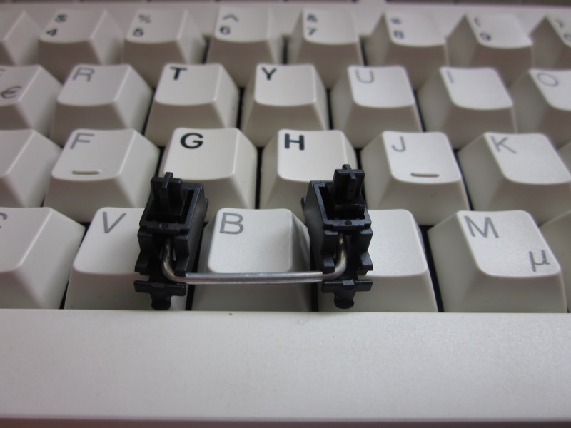

The clack-killing nature of the cherry corporation stabilisers is a deliberate design decision/feature.
A new topic seeing the importance of the subject matter at hand, in light of not being able to find anyone having noticed this before.
My cherry stabilised MX11800 now clacks on all keys.
Took me about an hour (of muckin' about), should be doable in 15mins easy; most is from taking your board apart and getting it back together, and testing what you like best.
I would suggest only those who have at least two spare stabilizers to muck around with this, since it's destructive in nature; and who knows; perhaps you're already unknowingly hooked into the mushy default feel.
So to get the best of both world, easy non-destructive cap swapping, and retaining the CLACK! you will need some pliers, a stanley, and a screwdriver. Some quality duct-tape to test if you'd like to add that is optional.
ENJOY ^^
*note, this was proven on PCB-mounted stabilisers only; having never seen plate mounted ones, no comment on those.
**edit, TLDRthread, pornQuickFix:ImageOn the left what I ended up doing, on the right the stock insert.

Do you have a stabiliser at hand? Look at it and you don't need any more explanation I think... ;)
Don't have a camera handy, but it's just two slices with a knife to get clackin'.
Plus I thought it'd be nice to leave this to those who really want it for a little while. :D

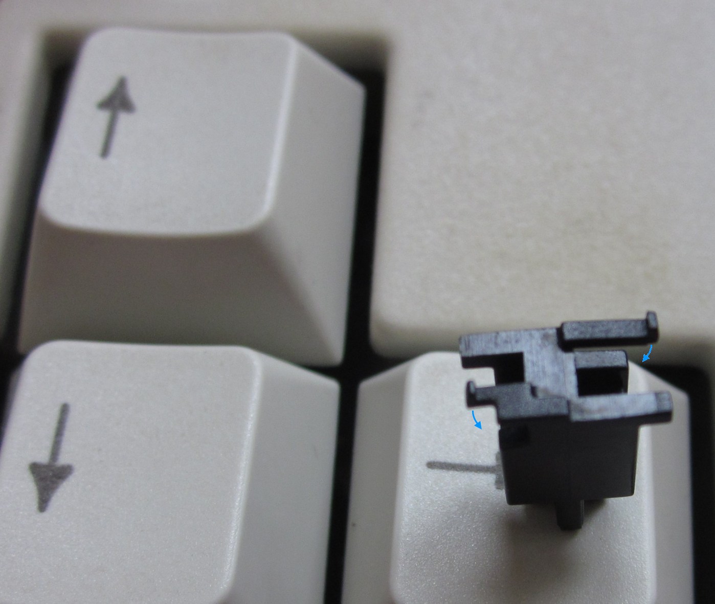

07 Jun 2012, 16:56
Wow, I'd really thought this would be more in demand. Ah well, here's a hint to tide you over 'till I get the rest down.
08 hint.jpg (48.81 KiB) Viewed 27997 times

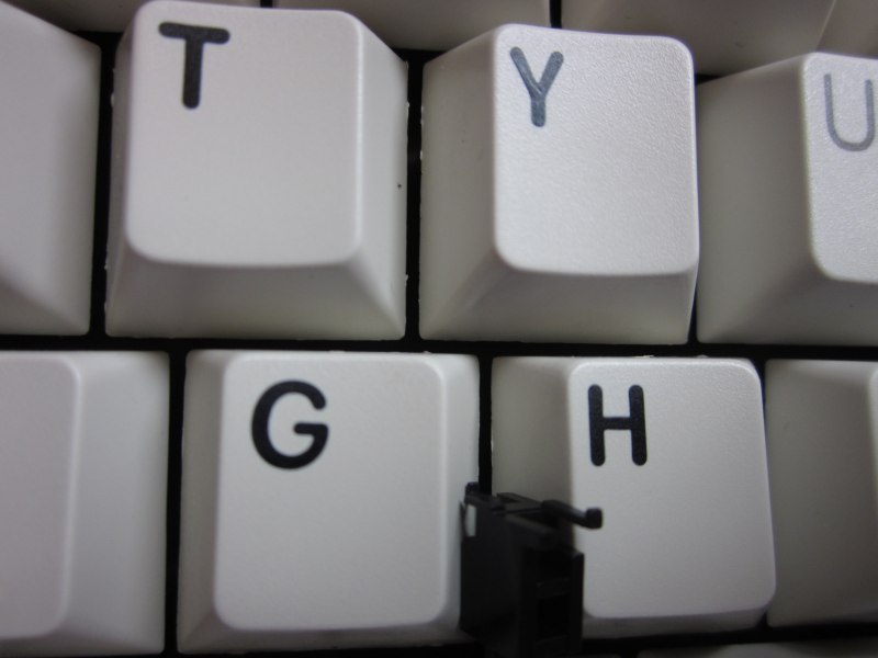

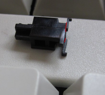

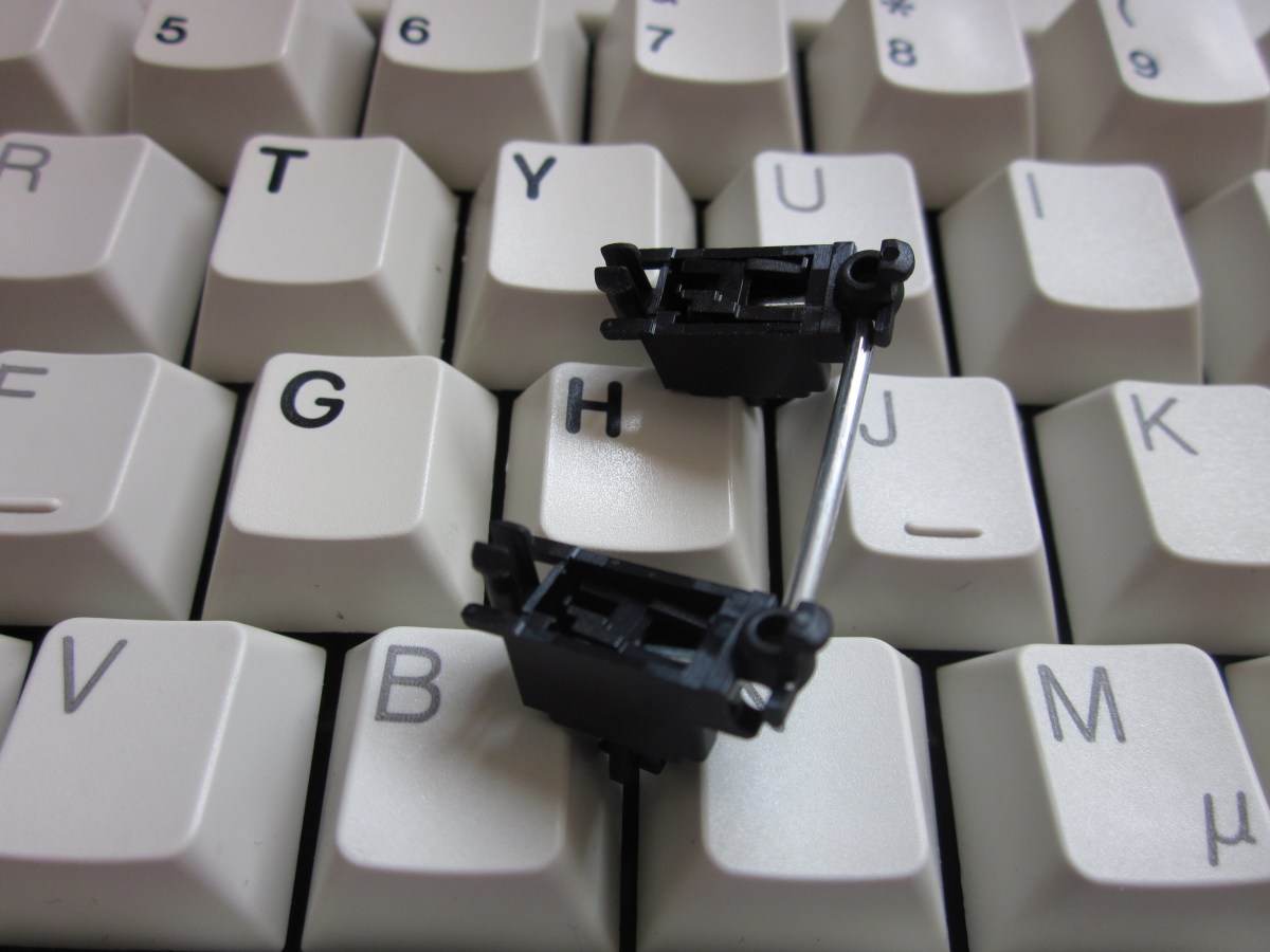

07 Jun 2012, 17:43
grmbl... I could play hard to get (haata quizstyle)
But since I've already got the shots edited I'll drop them, as well since I'd love to hear your reactions to the results.
So take a quick gander and get cutting!
*edit: PICS of fix are in the spoiler:
04 normal view.jpg (60.77 KiB) Viewed 27975 times
05 bottoms up.jpg (131.34 KiB) Viewed 27975 times
10 sideshot.jpg (121.19 KiB) Viewed 27975 times
10 sideshot chop.jpg (31.5 KiB) Viewed 27975 times
12 naked bottom.jpg (197.1 KiB) Viewed 27975 times
12 naked chop.jpg (198.18 KiB) Viewed 27975 times
And the mandatory explanation of cherry's engineering:
12 naked bottom WHY.jpg (197.75 KiB) Viewed 27975 times
Now as addendum; the pliers are for getting the stabs out of the pcb, the knife for cutting the offenders off 8-) , the screwdriver for opening the board in the first place.
And the optional tape is to put a sliver on the bottom of what remains off the stabilizer insert; not quite sure if this helps, but went that way since when I tested on backspace I noticed that the key gave too much clack for my liking, obviously from the inserts hitting the pcb; do take care to make it a small slice that does not touch the metal bar since it'll stick to that making for a very awkward experience.
Also because I noticed a slight metal ring that wasn't there before; which is now indeed still present on the only key I didn't fully cut (to be able to compare the difference I left it as such).
Such being having only lost the two 'feet' instead of the full legs (as the pictures show how to). That didn't satisfy me, hence the full chopping monty.
Result satisfies me for sure (though it's a very fresh mod, so if you break your pcb when smacking enter; all yours)!
@peter, being an MY board disqualifies regardless. :P
@rip, if you don't know nor care, don't troll. appreciated.
There are quite a few people that get heavily annoyed by the mushy-mushy crap that the cherry stabilizers add to the near-bottom-out part of the travel of the switch, myself included. There, I fixed it.
And what makes cherry stabilizers nice is that they allow quick and painless cap-swaps, no swapping inserts between keys, no metal rods bending when people fail to remove them subtly enough, no rods popping out.
Not as if you weren't already aware, hence my remark.
NOW CUT IT! :mrgreen:
*edited to add spoiler tags to circumvent annoying phpbb pagejumping during load.

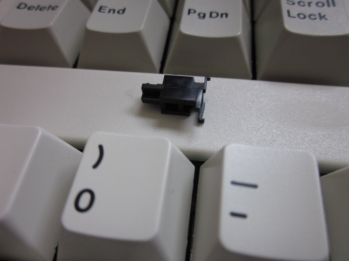

off
07 Jun 2012, 18:16
The tape goes here btw:
12 naked bottom tape.jpg (199.21 KiB) Viewed 27953 times
And use some of that good stuff which doesn't turn into mush (lookin at you icky grey ducttape).

Nice mod, now that I know what you are trying to accomplish! I should drag out my one Cherry Keyboard, the RicerCar SPOS.
Plus I have extras of the G99 stabilizers.

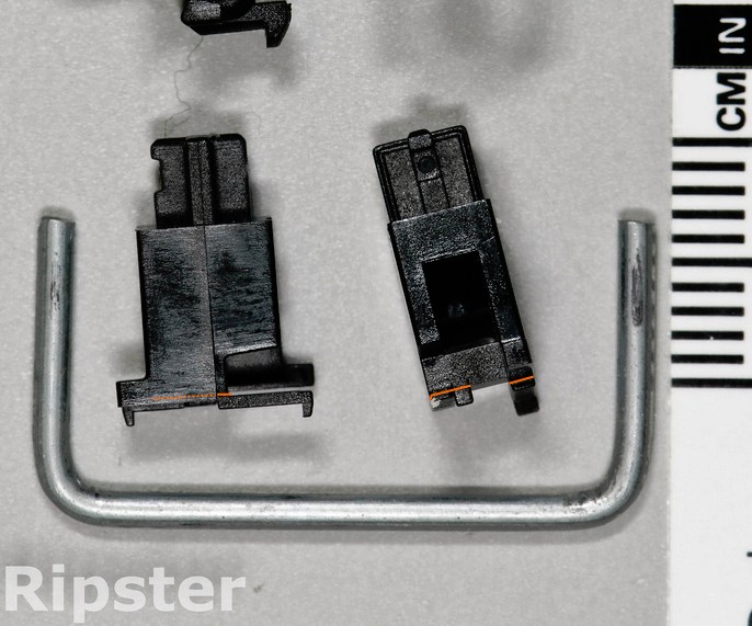

off
07 Jun 2012, 20:18
Awesome, just what this thread needed, some quality pics where you can actually see the shades of black!
Shame about the hair though. Now if you'd be so kind as to cut one of those to show how the end result should be in correct lightning; in which case I'll leave the yelling of 'not like that ffs' behind. ;)
Bring that ricer to the meet in a few weeks, willing to nab it off your hands :D
And yes, the aim is uniformity.
B'sides, I don't have any costar stabilizers, only the prequel to those (as used on MY boards, yuuuck).
For those still in doubt (understandably since I only posted 'before' pics taken after the job (board is back together)), here's the two slices again:
ripsted clear cut pic.jpg (87.25 KiB) Viewed 27927 times
I'll repeat myself here, for anyone interested (I know you are); please do it with a spare first. So you'll be able to change your mind without ill effects; I'm just saying.
It looks as if those legs getting severed here serve to stabilize the insert inside the shaft as well, but I haven't noticed any ill effects myself; perhaps your senses say otherwise.

Rip, are your enter and shift even stabilised? Backspace and other shift clearly aren't, and the 1.75u keys on this board aren't either..
Try the + and enter on that numpad, even though you'll notice it less since they're not part of the typing experience as such; it's about the resonance of the keycap, all keys tap onto the pcb or switch, not entirely sure which makes the comforting clackity clack, but very sure that the keys that are stabilised with default cherry corp ones don't. They mushmash.
Spacebar seems a different beast though, not entirely satisfied with the result on that; but haven't bothered to check how/what's the deal with that.

The mod has been known for quite some time in KBDMania. (see this post back in 2004 http://www.kbdmania.net/xe/116137 )
The plastic legs are designed to reduce the impact of a large stabilized keys bottoming out and the design is causing the mushiness.
The mod point is to get rid of this impact reducing plastic legs so that you could get clacking sound just like other keys. I am not sure how and by how much the impact is causing adverse effect, but if you are hitting the stabilized keys pretty hard, it would be wise to leave them as is because significant amount of impact to electronics is never a good thing.
