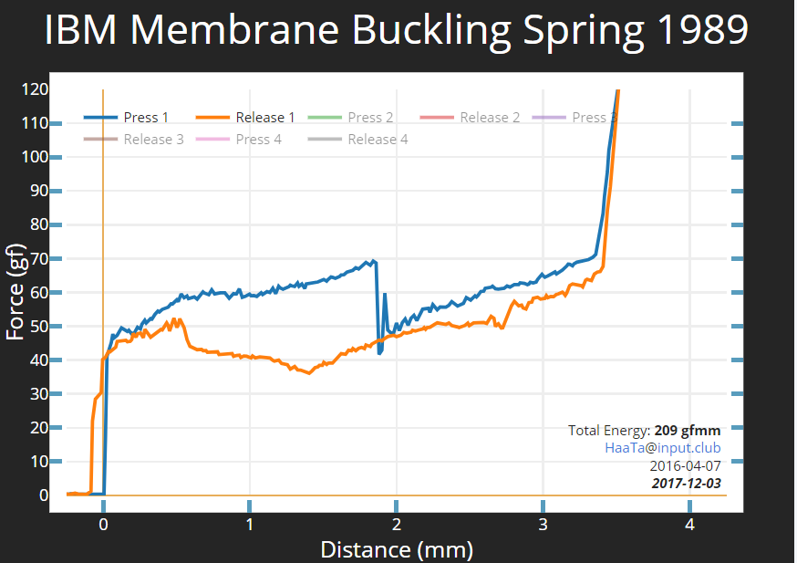

This is actually a pretty interesting question and curious to see where it goes. Problem is that depending on your sources this is either really simple to do or quite complicated. For instance, you will find graphs of buckling spring actuation points online and in them you will see a point where the switch will bottom out after actuation which naturally leads to the conclusion that we can reduce key travel:

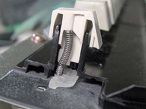

As you can see from this image, the keycap has what I like to call a "nub" that presses down on the top of the spring. At first it would be natural to think that in order to reduce the actuation point we can fit a small washer between the spring and nub, adding tension. But in the following image you will see why that is not exactly viable:

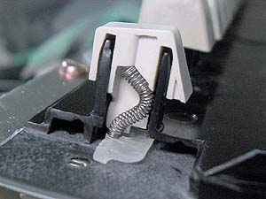

As the spring buckles you will notice that the top of it is no longer fully seated against the nub. If a washer is placed between the nub and spring it will hold in place until the buckling point, but will then become dislodged or cocked at an angle once buckling has been achieved. To keep the washer in place you would need to permanently fix it to the spring or the nub with something like super glue, meaning that it would become a hard mod and not as easily revisable.
