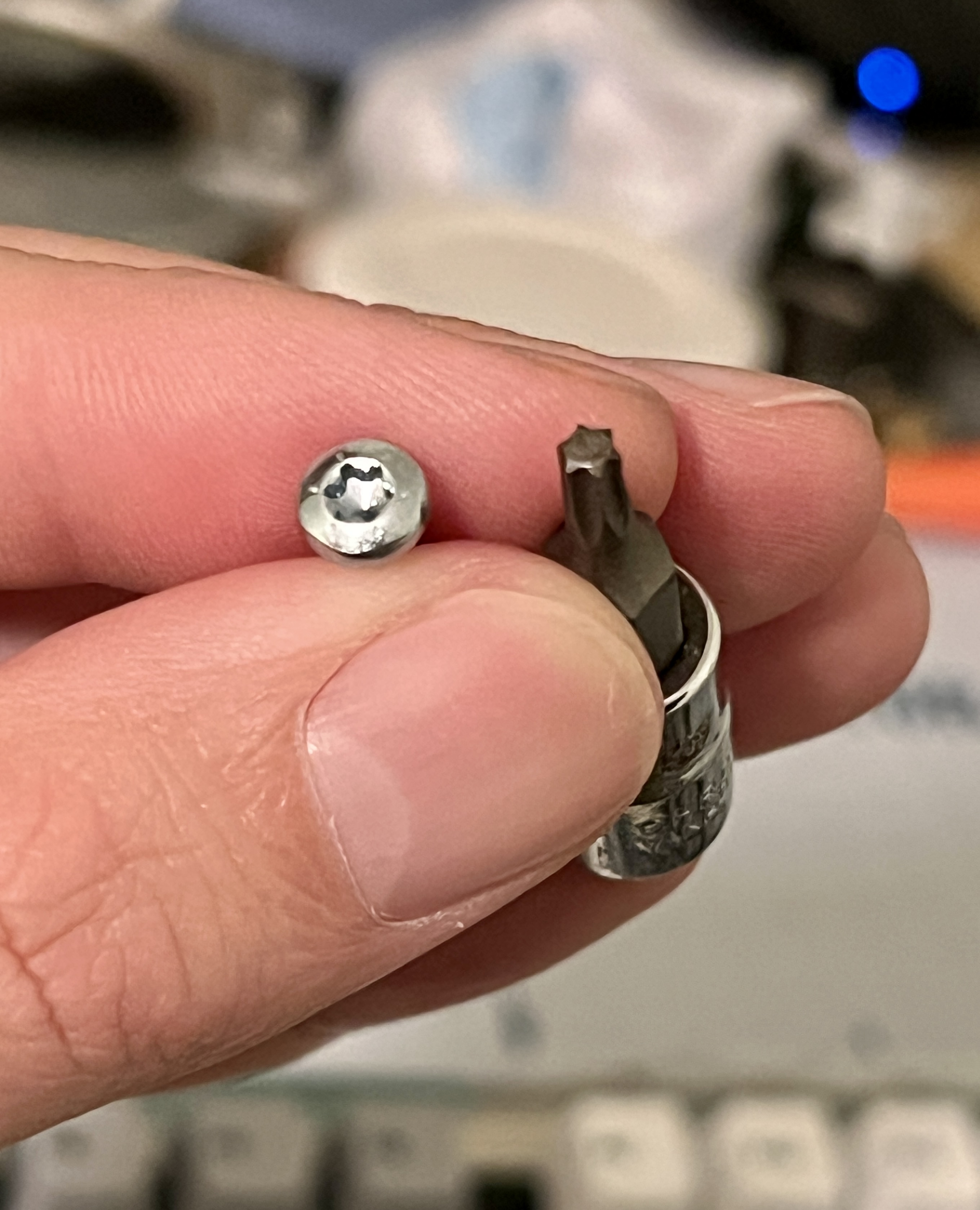

Like the Model M it has four screws. Mine were Torx T-15:
Closeup of the screw and Torx bit:

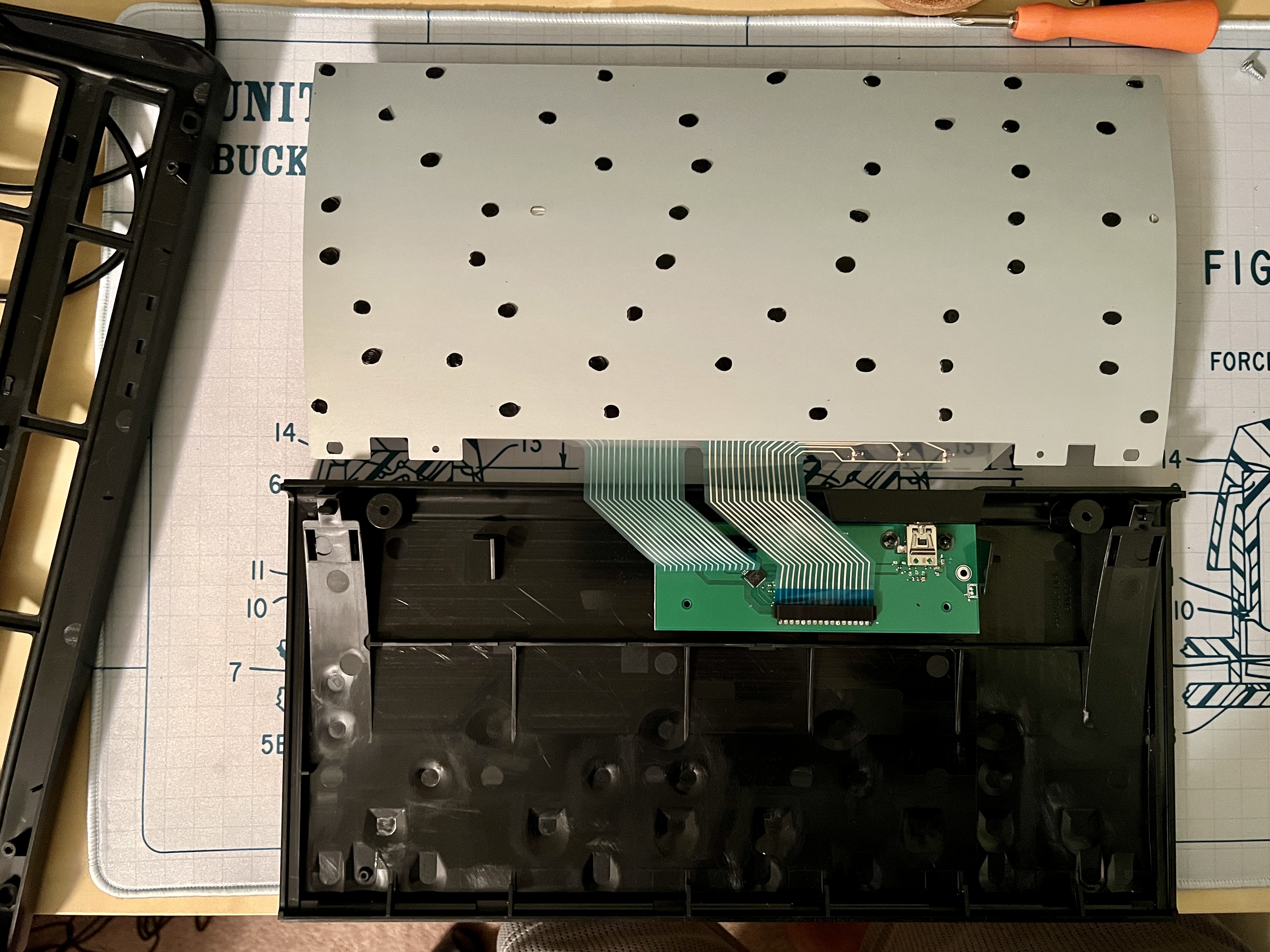

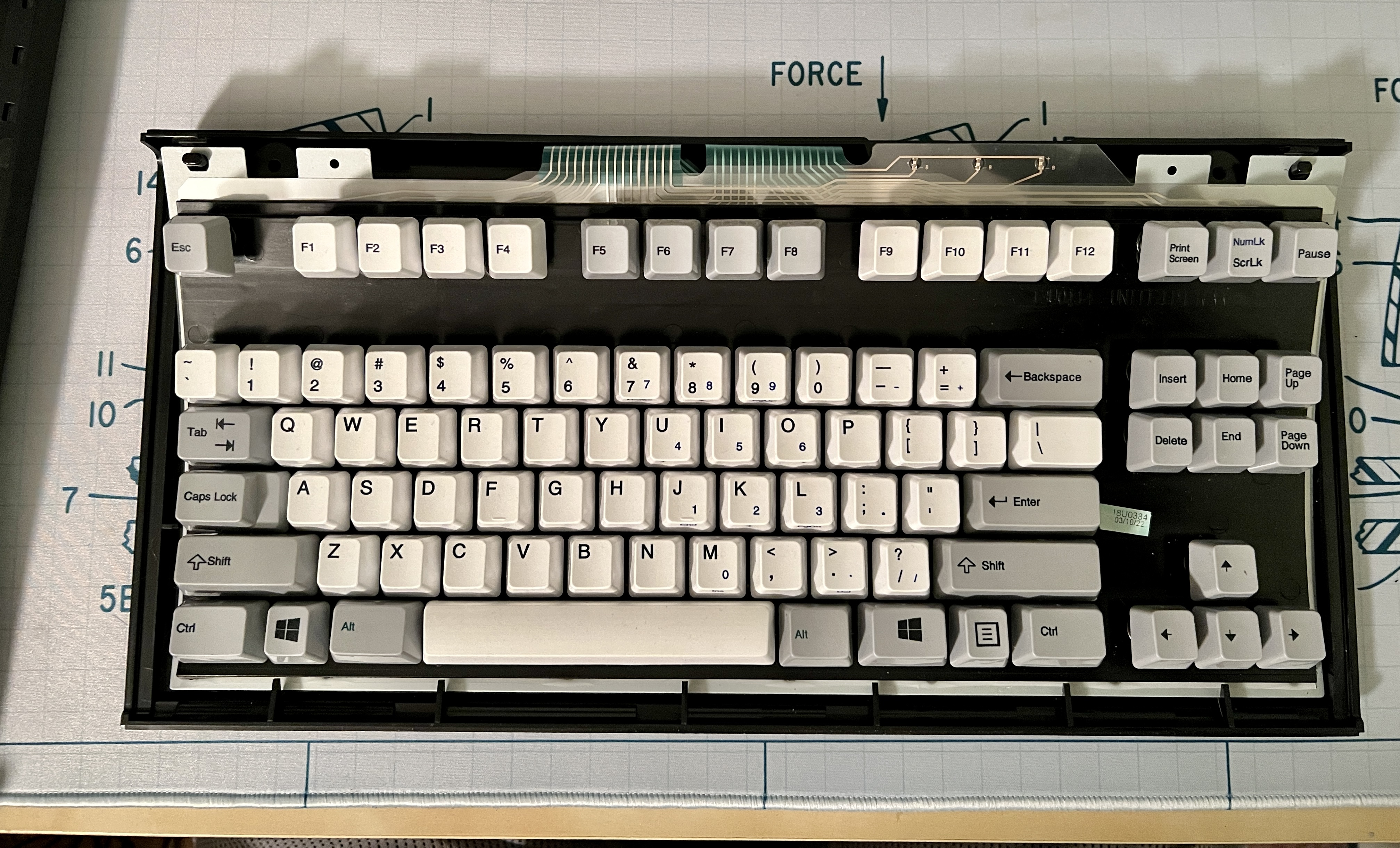

Opened up!
Not ready for a bolt mod:

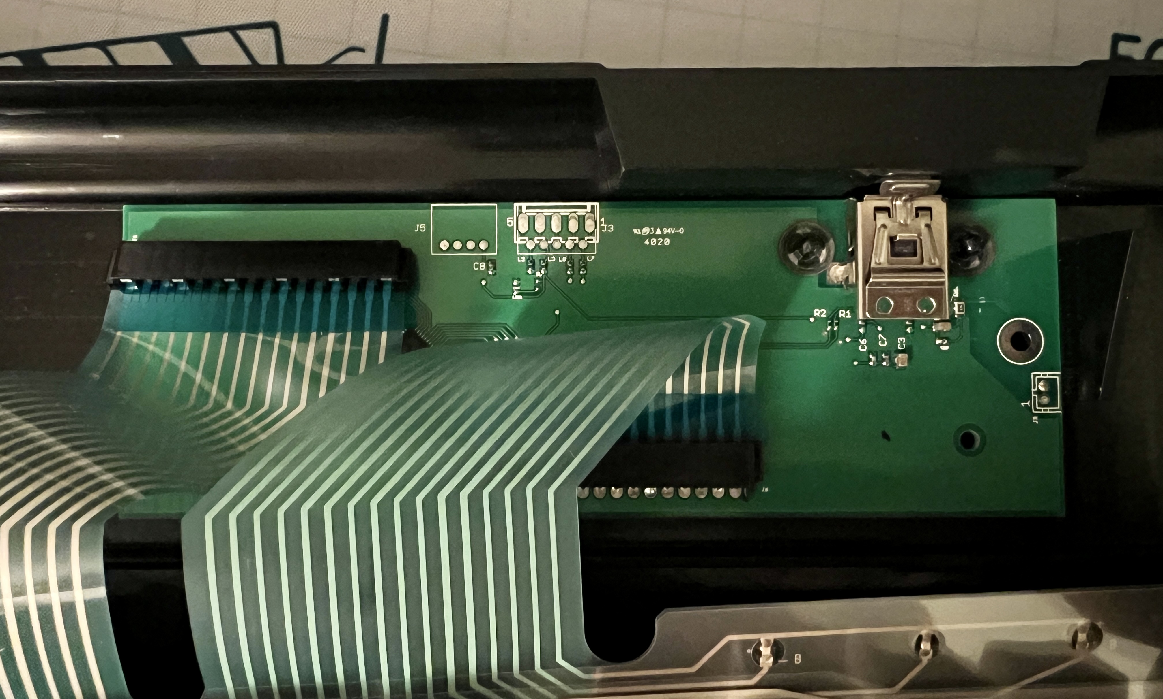

Controller closeup. Not much there. I wonder if a Model M controller would work for those with controller issues?

thefarside wrote: 05 Jan 2023, 18:56 I wonder if a Model M controller would work for those with controller issues?
You can make your own bespoke controller (like the Mstar) but any old factory Model M controller won't work since the Mini M's matrix is larger and completely different to previous Model Ms (including 122-key) and the second membrane flex cable is thus larger than any previous one to reflect this.
05 Jan 2023, 19:14
thefarside wrote: 05 Jan 2023, 18:56Controller closeup. Not much there. I wonder if a Model M controller would work for those with controller issues?
Depends on the matrix and the connectors, plus the physical space available for the PCB and routing a cable out of there. Fundamentally, they are the same technology, but the details vary a fair bit, by the looks of it.
Edit: Sharkey beat me to it. IBM's originals are non-programmable so the changed matrix geometry means they will not work.
thefarside
05 Jan 2023, 22:07
Thanks for the controller feedback. The Mstar from level 1 tech looks nice but costs almost as much as the Mini M :|
