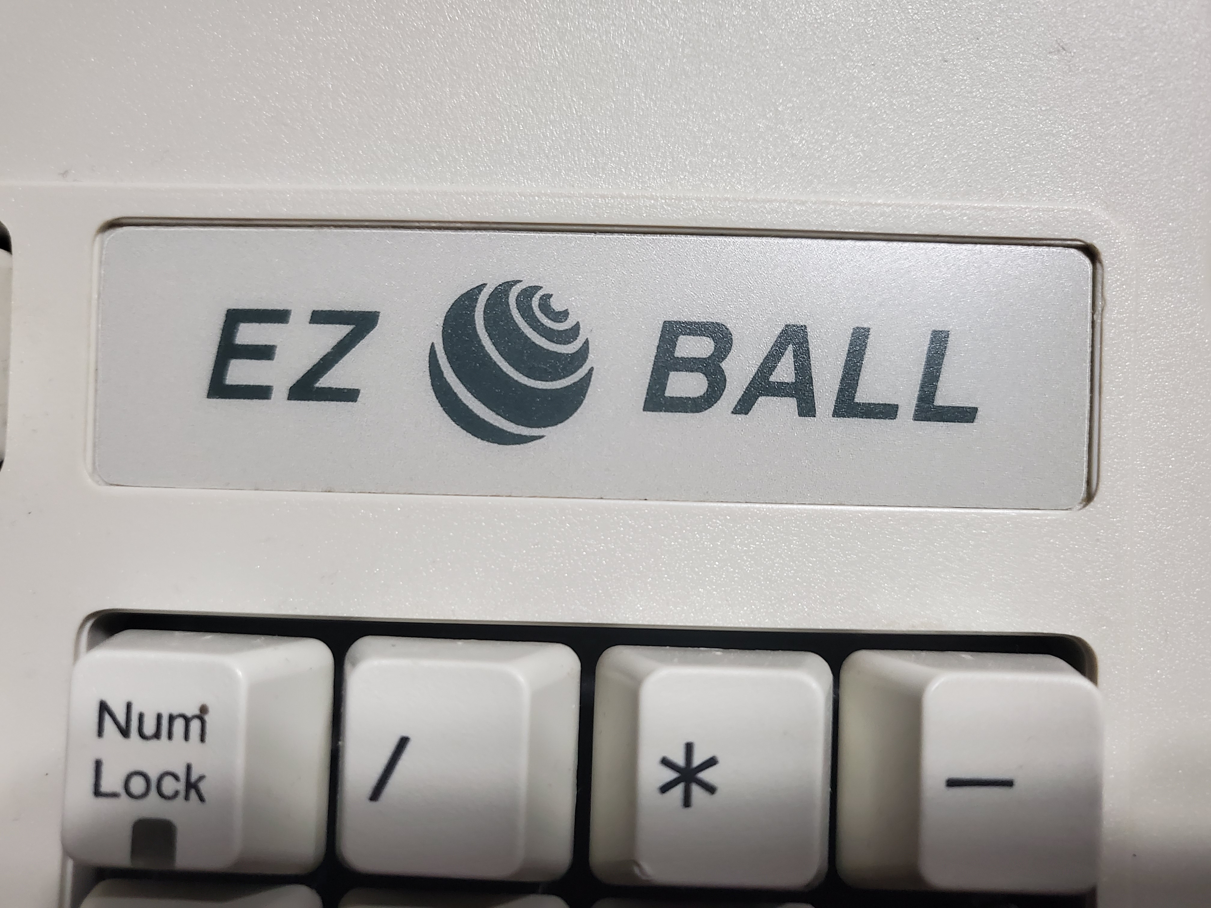

Maledicted
09 Jan 2023, 01:29
Nice write up. These things needed a little more love. These must have been rebranded a few different times, since mine's marketed as an "EZ Ball", but with the Focus model number.
