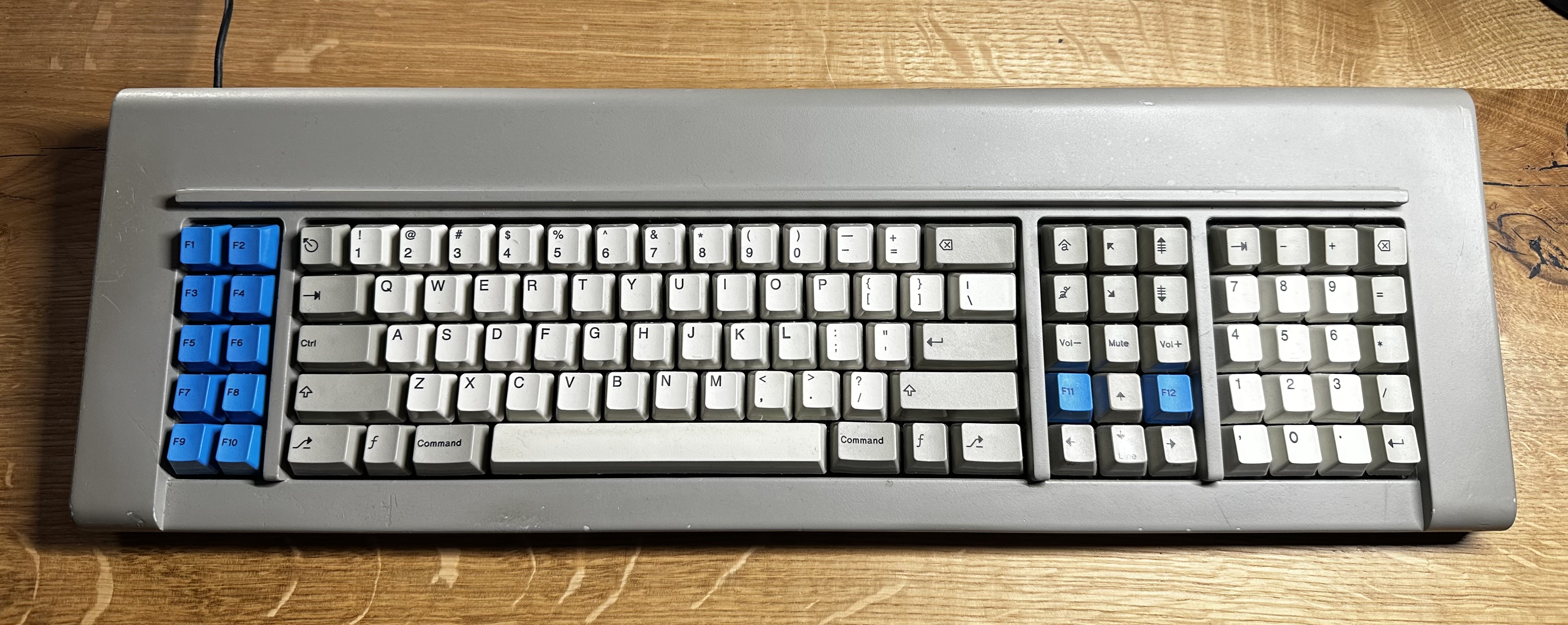

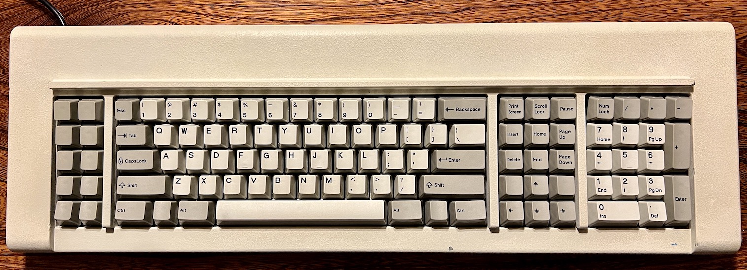

Step 0 F107 Front Before Restoration.jpeg (285 KiB) Viewed 9749 times

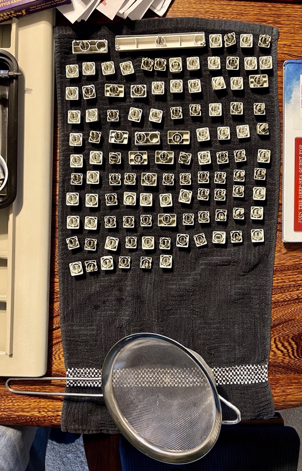

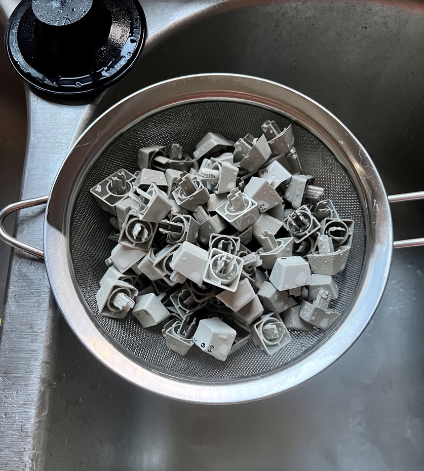

After the denture clean bath I put them in an ultrasonic cleaner and rinsed them.
Step 2a Clean Keys.jpeg (256.64 KiB) Viewed 9749 times
The keys take a while to completely dry so I left them out for several days. I would recommend putting a fan on them if you want them to dry faster.
Step 2b Dry Keys.jpeg (273.9 KiB) Viewed 9749 times

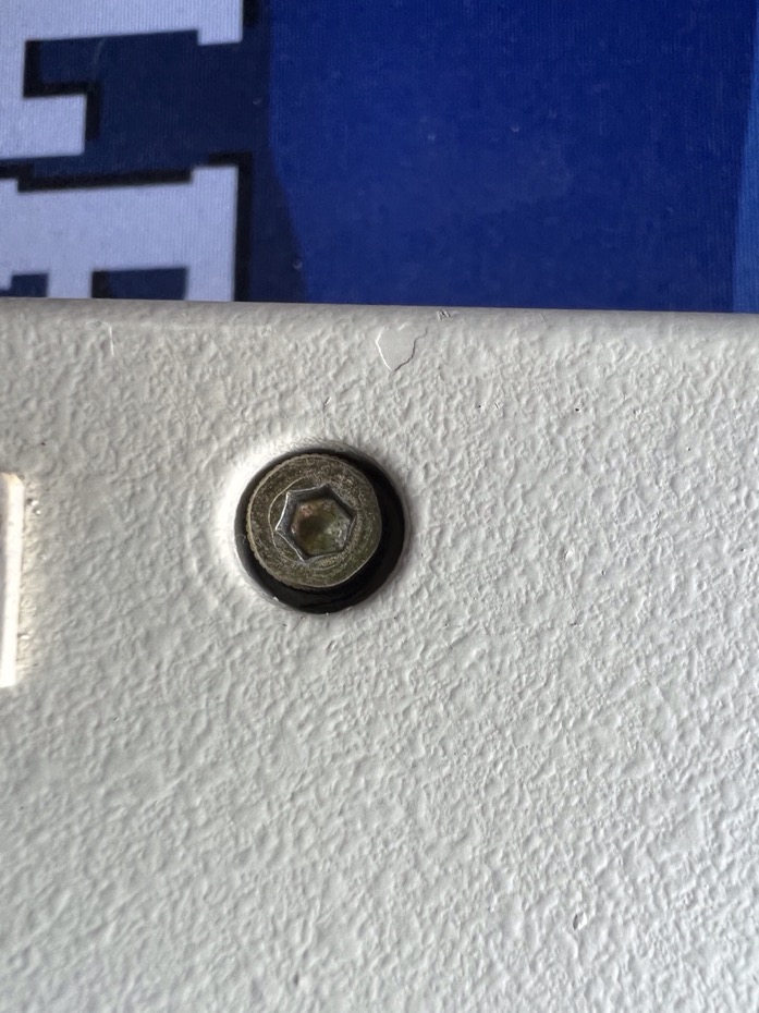

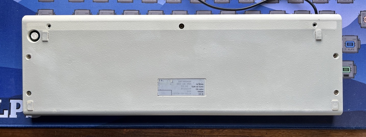

Next I unscrewed the case screws which requires a hex bit.
Step 3a Open F107 Back Case and Label.jpeg (257.41 KiB) Viewed 9749 times
Closeup of hex screw:
Step 3b F107 Case Screw.jpeg (166.45 KiB) Viewed 9749 times

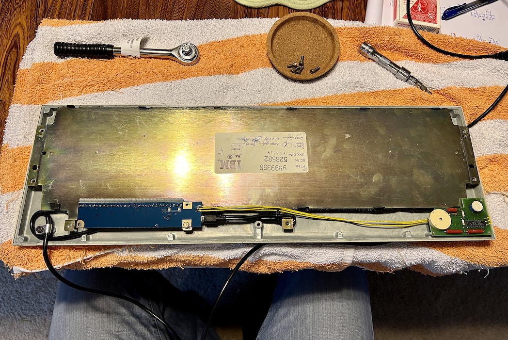

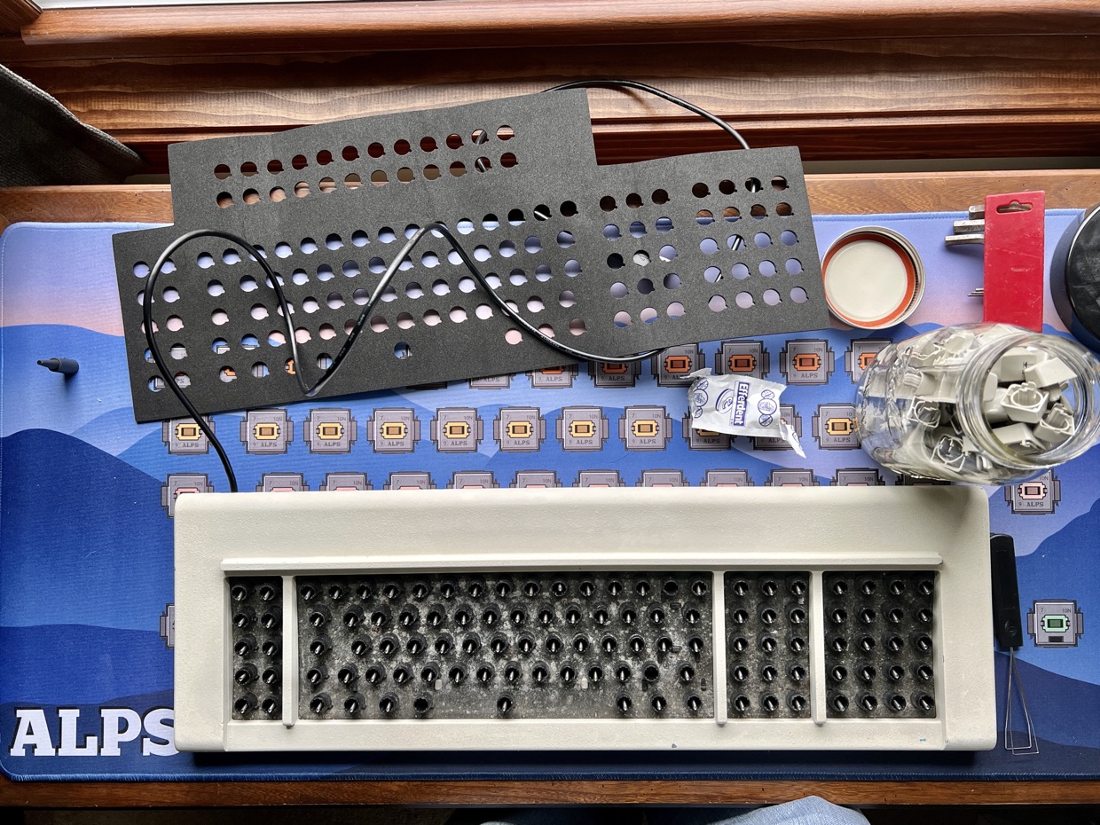

Once the screws are off the back case can be removed:
Step 3c Remove Back Case.jpg (339.1 KiB) Viewed 9749 times

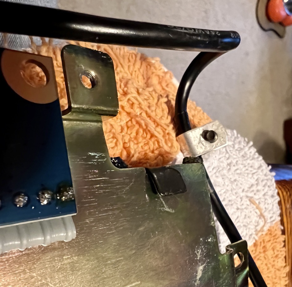

There’s another hex screw holding the cable coming from the controller and after that’s removed the inner assembly can be removed.
Step 3d Remove Barrel Plate Assembly.jpeg (721.66 KiB) Viewed 9749 times

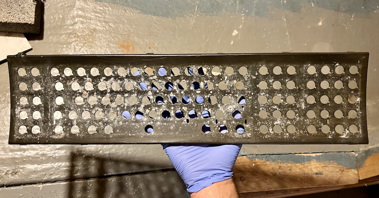

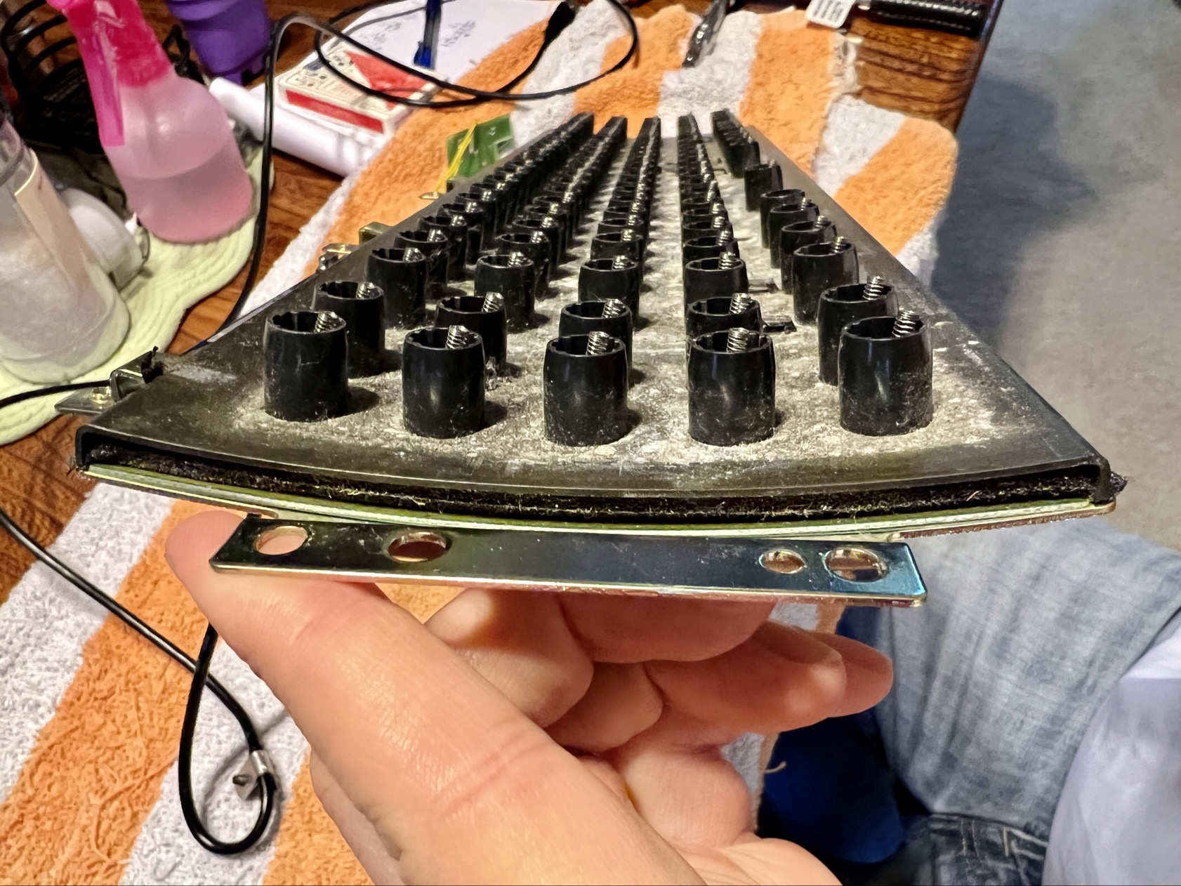

The barrel plate was pretty dirty. I suspected the foam was in bad shape, so the barrel plate would need to be removed.
Step 4a Barrel Plate Assembly Left Side Dirty.jpeg (539.25 KiB) Viewed 9749 times

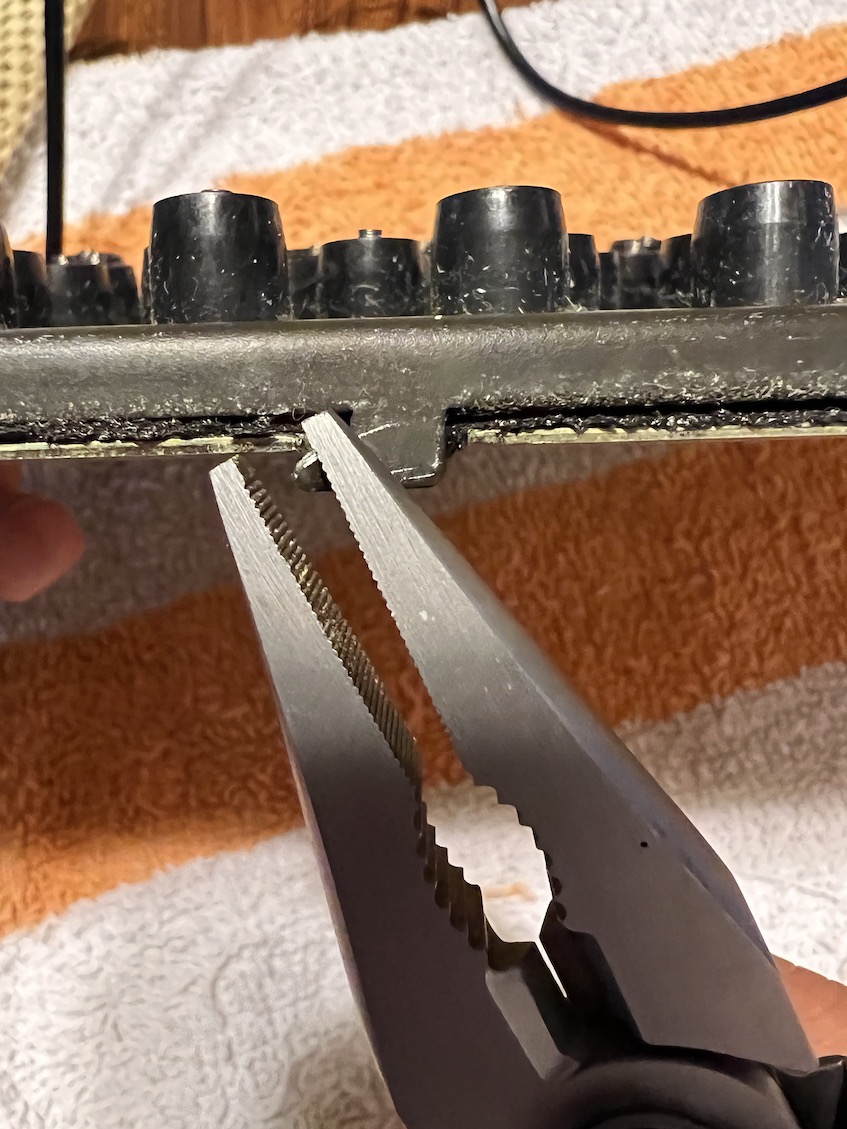

The barrel plate is secured to the back plate with locking tabs that slide together and one that’s bent down onto the back plate.
Sliding locking tabs:
Step 4b Barrel Plate Assembly Locking Tab Closeup.jpeg (448.51 KiB) Viewed 9749 times
Bent locking tab:
Step 4c Barrel Plate Assembly Locking Tab.jpeg (202.38 KiB) Viewed 9749 times

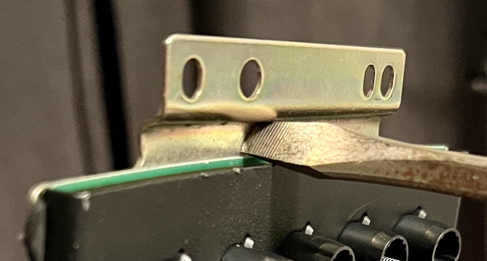

I used a pair of needle nose pliers to bend the locking tab back:
Step 4d Bend Locking Tab.JPG (232.79 KiB) Viewed 9749 times
After the locking tab was bent back the barrel plate needed to be pushed away from the sliding tabs. I put a large flathead screwdriver in between the barrel plate and backing plate that rises to secure to the case and twisted to easily push the barrel plate away and slide it from the locking tabs:
Step 5a Slide to Unlock Barrel and Back Plate.jpg (136 KiB) Viewed 9749 times

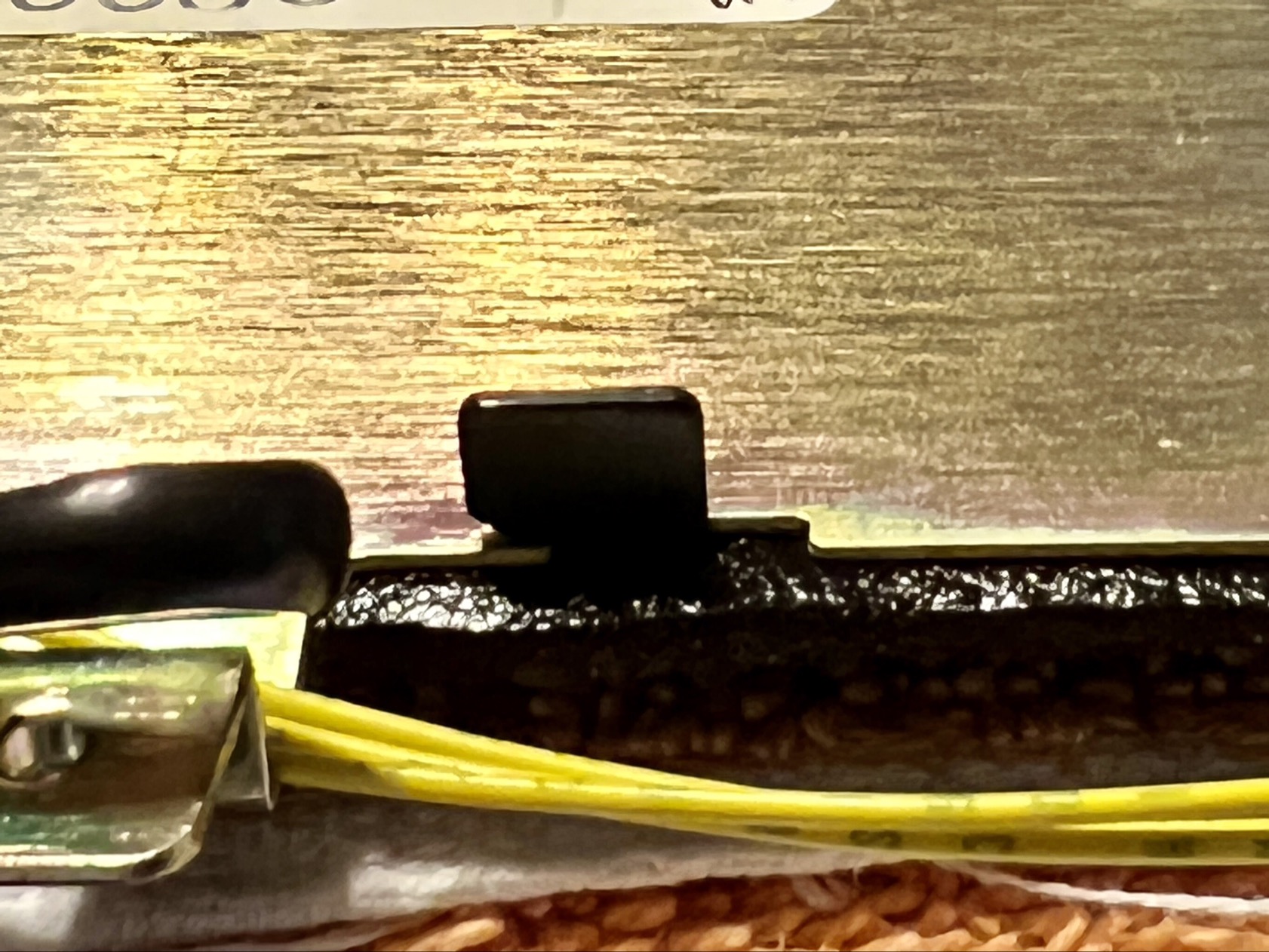

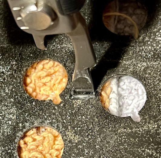

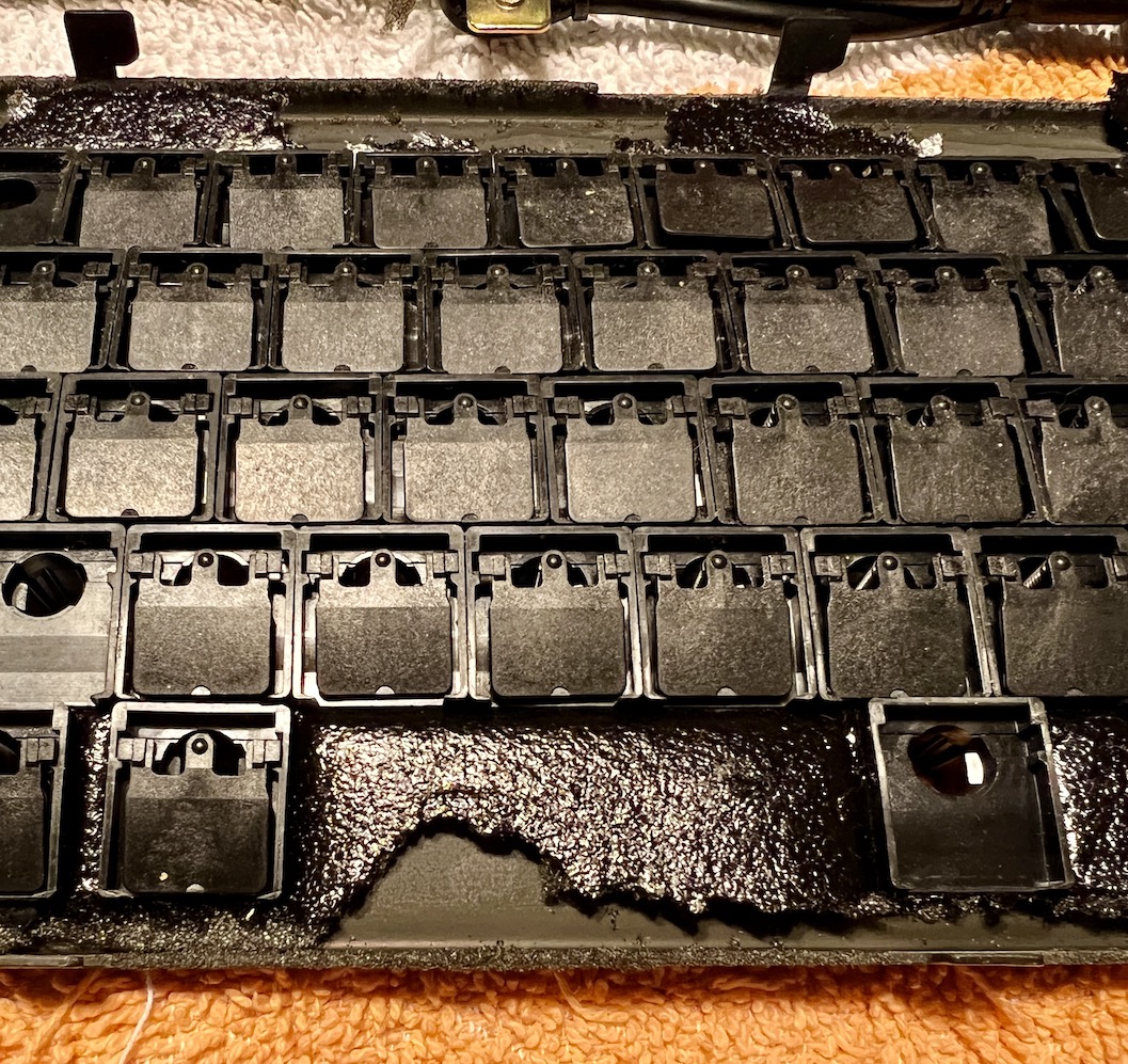

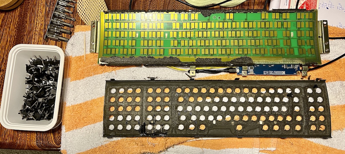

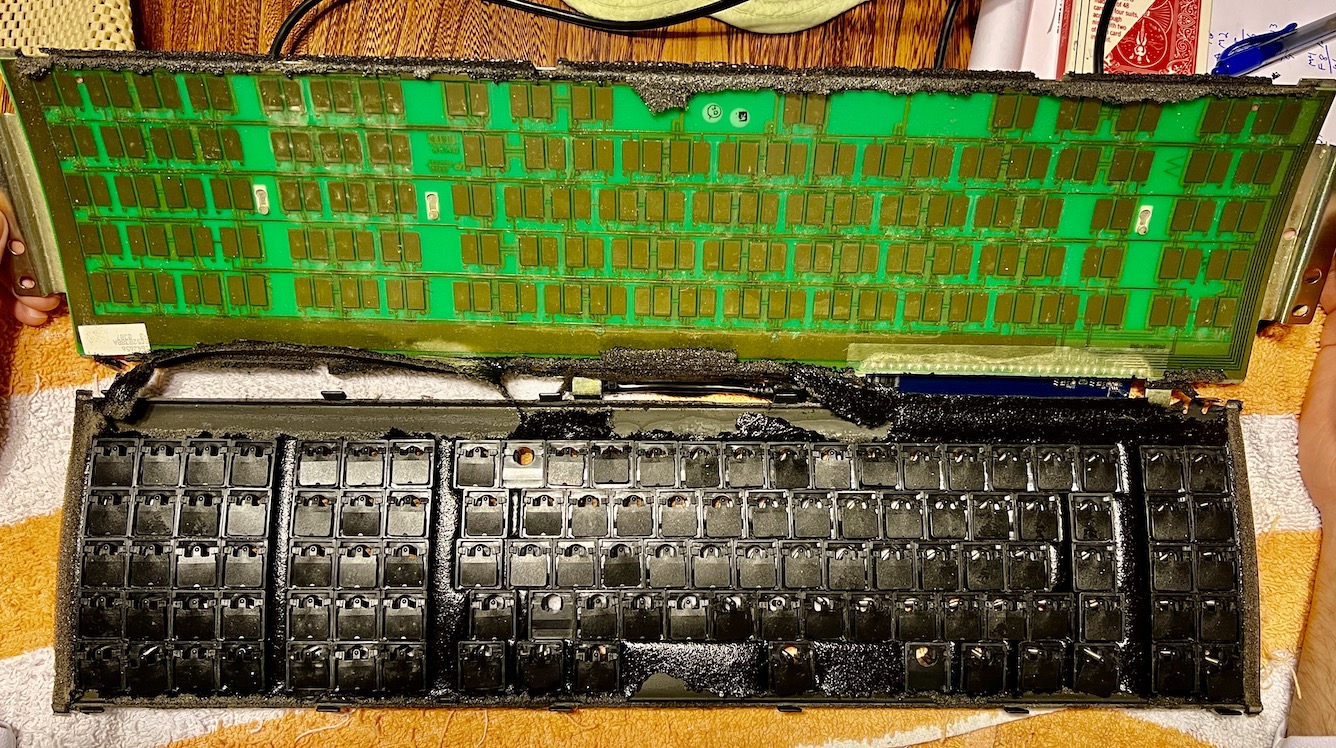

I opened the assembly and could see the original foam was in pretty bad shape:
Step 5b Remove Back Plate from PCB.jpg (541.7 KiB) Viewed 9749 times
The foam is interesting in how shiny it appears. Closeup of the original foam:
Step 5d Barrel Plate Opened Closeup.jpg (505.39 KiB) Viewed 9749 times
Next I removed all of the flippers and barrels:
Step 7 Remove Flippers and Barrels.jpg (377.83 KiB) Viewed 9749 times

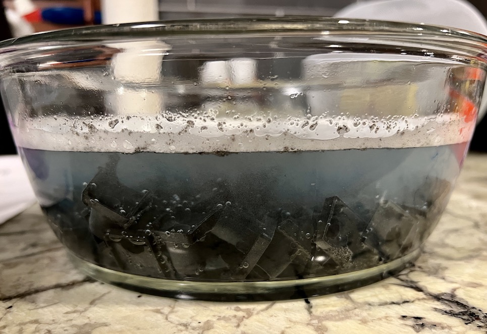

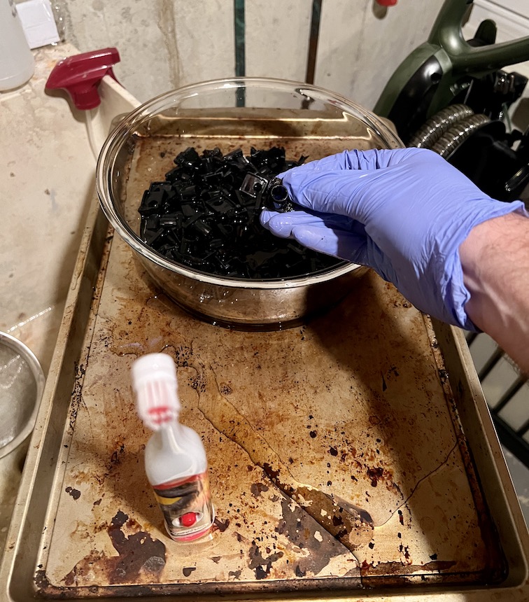

I decided to clean the barrels the same way I cleaned the keys using denture cleaning tablets:
Step 8a Add Denture Tablets.jpg (173.43 KiB) Viewed 9749 times
I added the tablets first, then the barrels:
Step 8b Add Barrels.jpg (242.74 KiB) Viewed 9749 times
Then water to created a nice, bubbly barrel soup:
Step 8d Mix Together.jpg (180.59 KiB) Viewed 9749 times

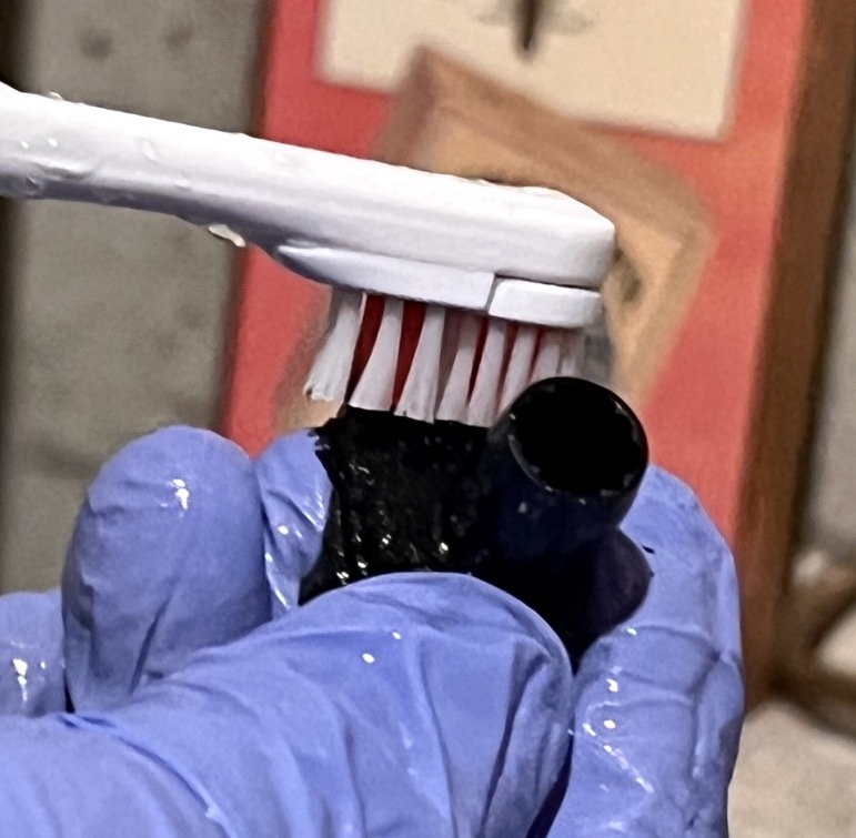

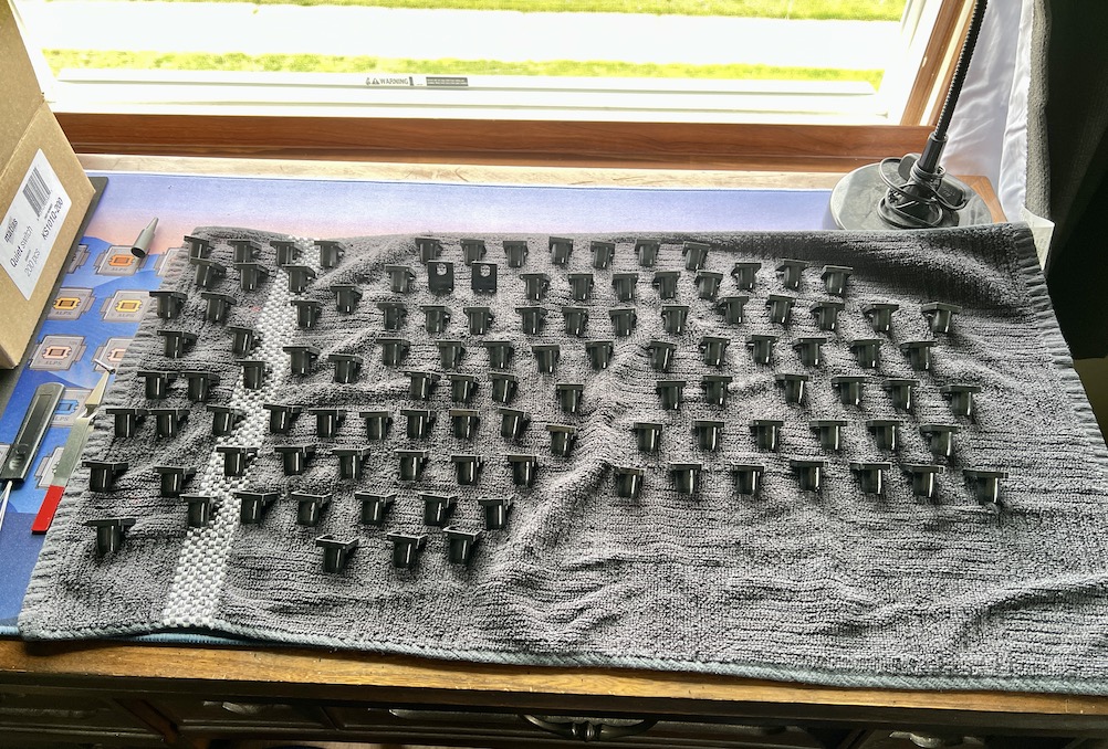

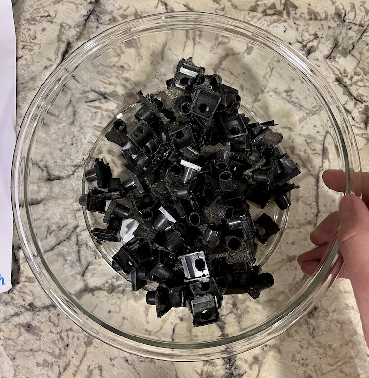

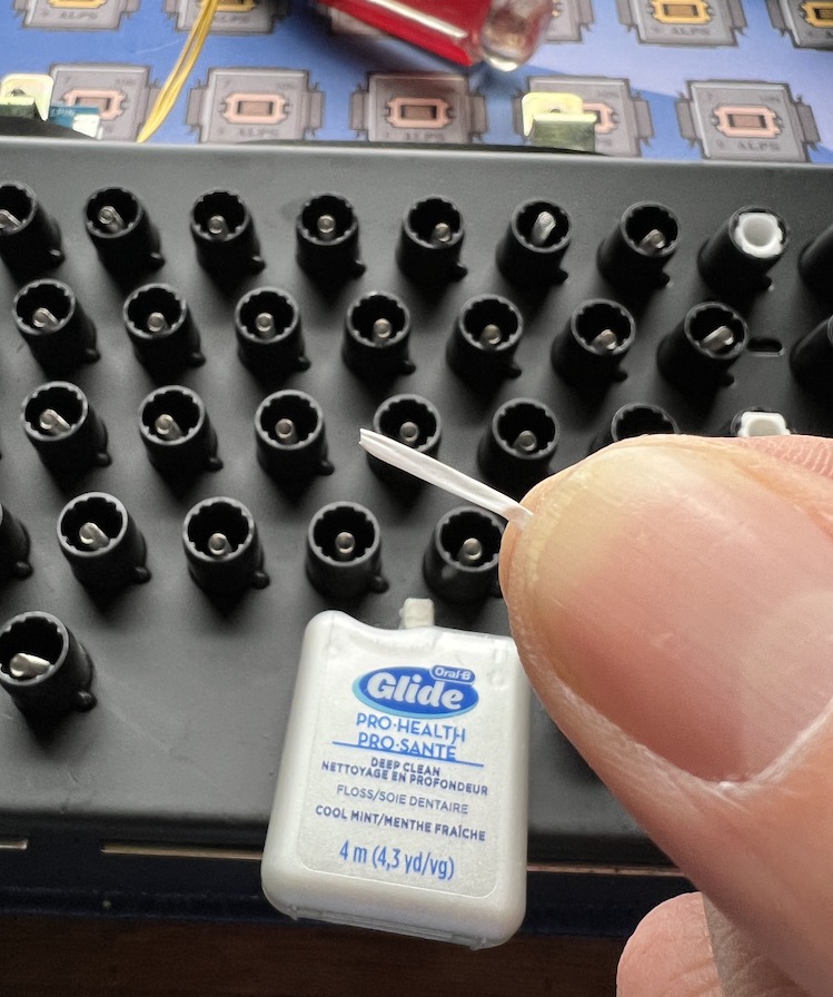

I let the barrels soak for an hour or so and noticed the foam didn’t completely come off, so I used an old electric toothbrush to remove the remaining foam. I used an old baking tray to keep track of the barrels:
Step 9a Clean Foam from Each Barrel.jpg (238.74 KiB) Viewed 9749 times
It was tedious and took a long time to clean them all, but the barrels were just like new after:
Step 9b Clean Foam from Each Barrel.jpeg (112.17 KiB) Viewed 9749 times
Then I let them dry near an open window:
Step 9d Dry Barrels.jpg (342.94 KiB) Viewed 9749 times

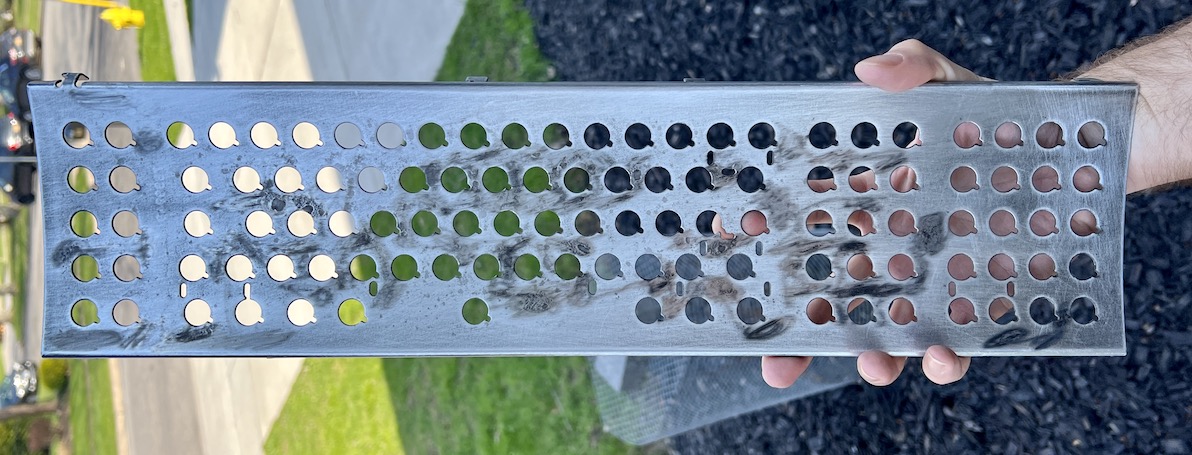

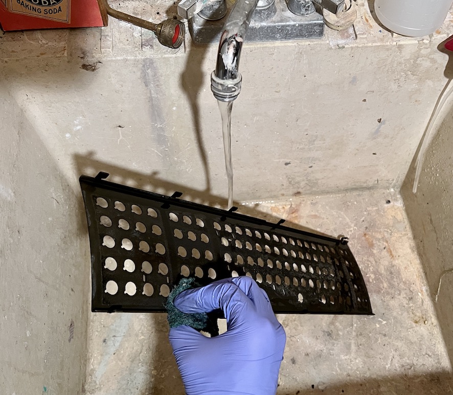

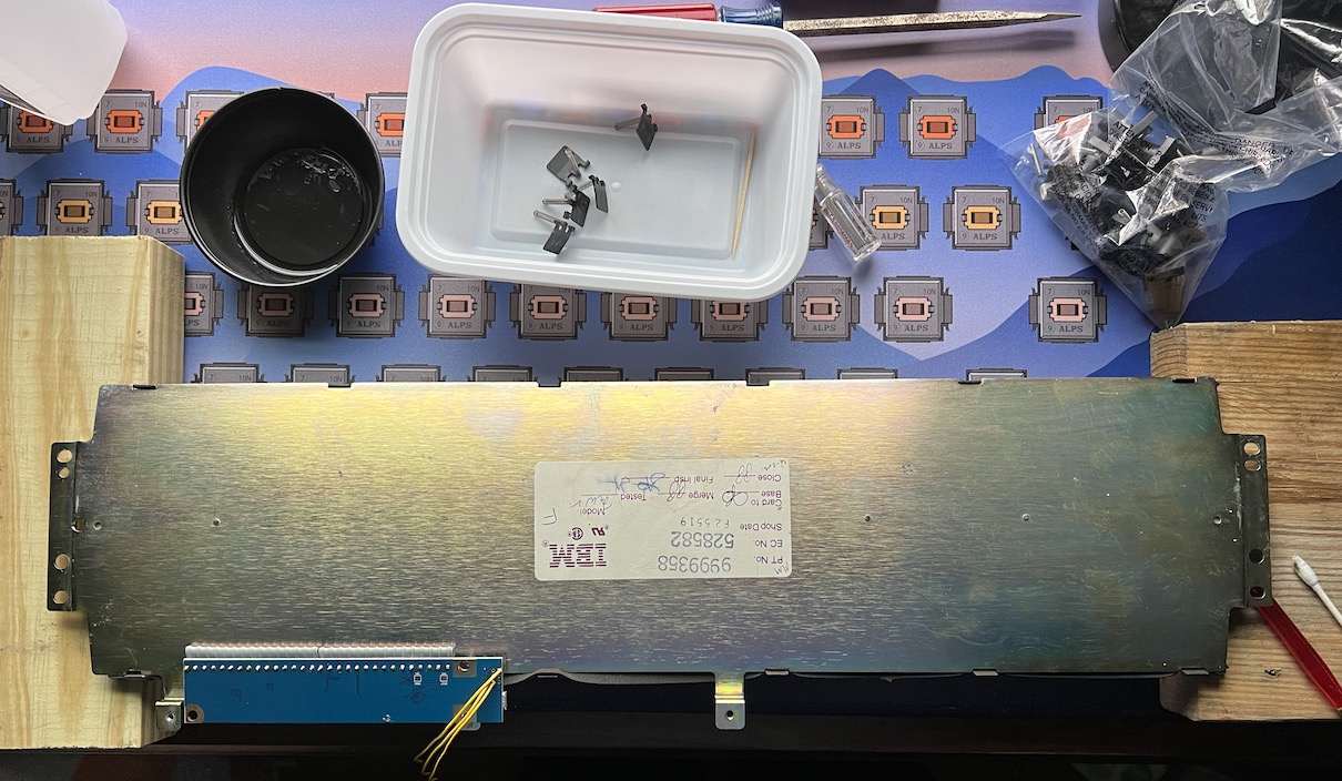

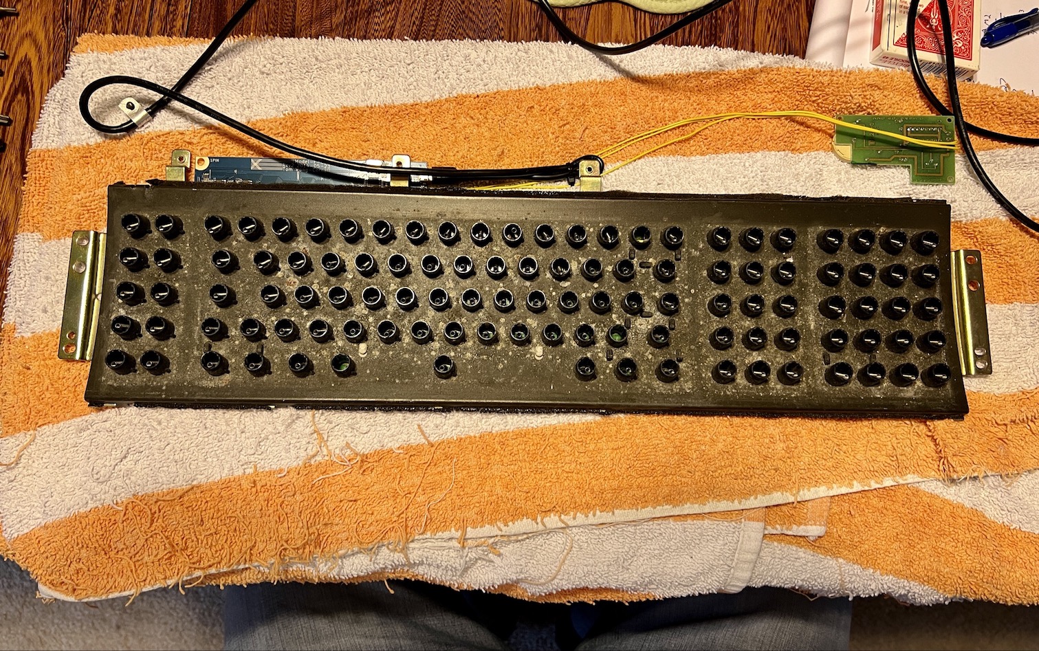

Next I cleaned the barrel plate, running it under water and using a scrubbing pad to remove the remaining foam and debris:
Step 11 Clean Barrel Plate.jpg (223.97 KiB) Viewed 9749 times

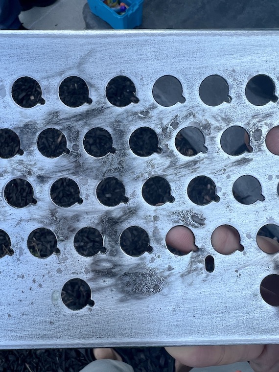

The barrel plate was clean, but showing signs of corrosion and pitting. It needed to be painted so next was sanding to prep for paint.
Step 12b Cleaned Barrel Plate Ready for Sanding.jpg (313.26 KiB) Viewed 9749 times

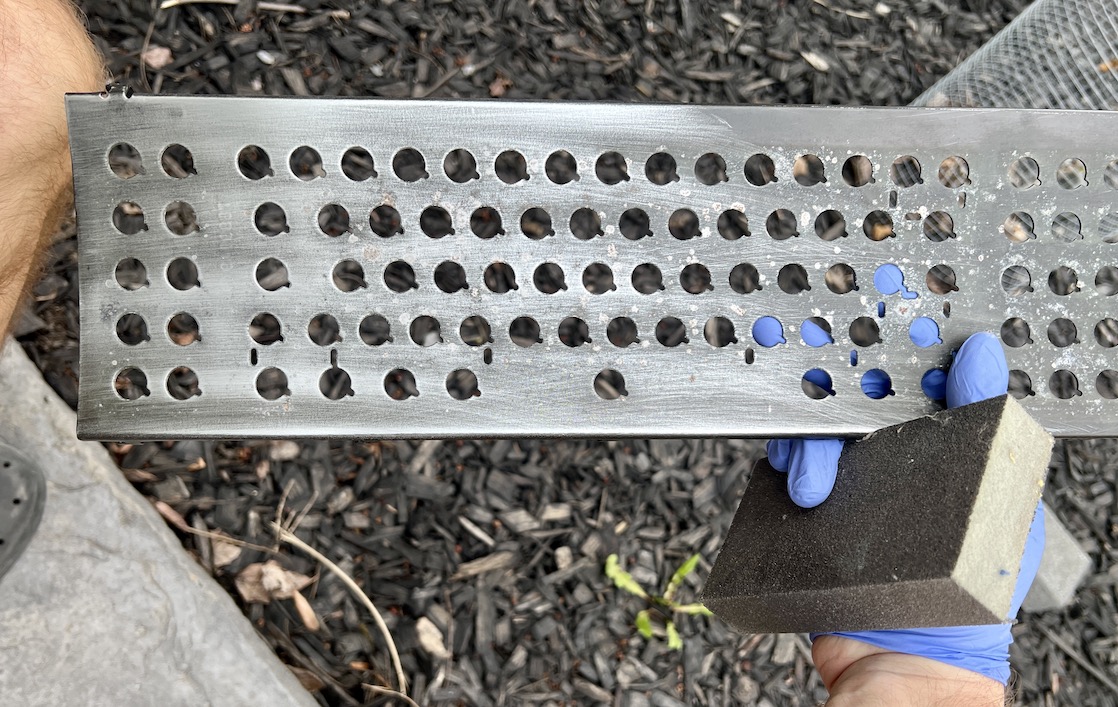

I used a rough (100-120 grit) sanding block to get the original paint off and any rust.
Step 12c Sand Barrel Plate to Prep for Paint.jpg (312.28 KiB) Viewed 9749 times

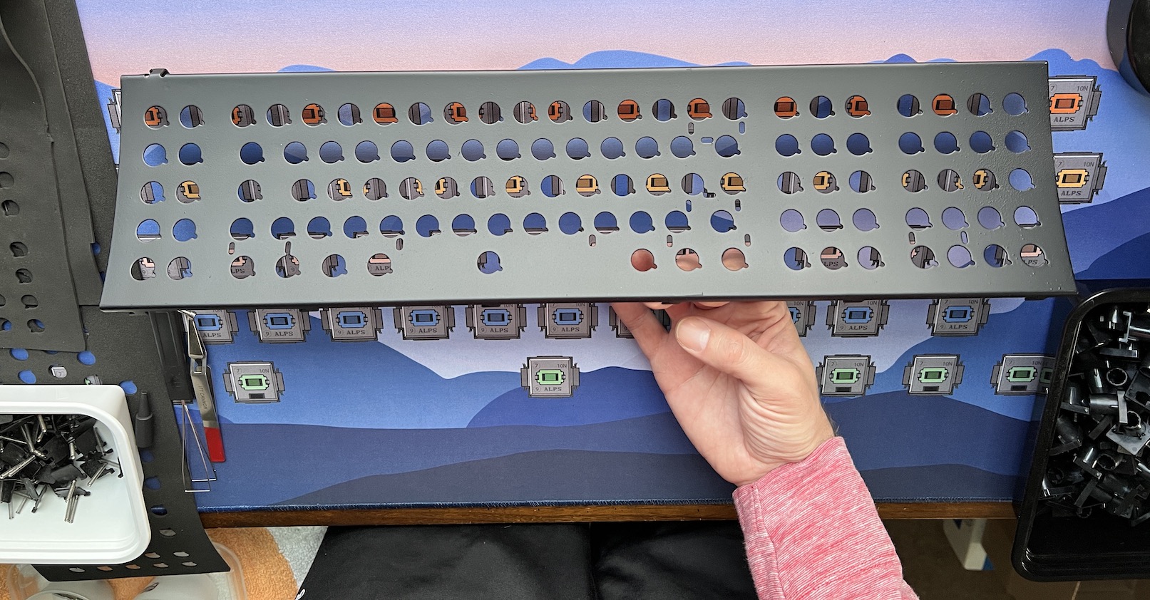

I kept sanding until you could see mostly metal.
Step 12d Sanded Barrel Plate to Prep for Paint Front.jpg (203.23 KiB) Viewed 9749 times
The corrosion was more apparent after the sanding.
Step 12g Rust and Corrosion Needing Paint Protection.jpg (191.42 KiB) Viewed 9749 times

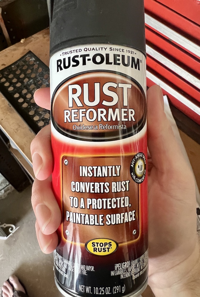

I chose Rust-oleom Rust Reformer because I had it laying around in the garage and it seemed like it would work.
Step 13a Rustoleum Rust Reformer.jpg (268.82 KiB) Viewed 9749 times

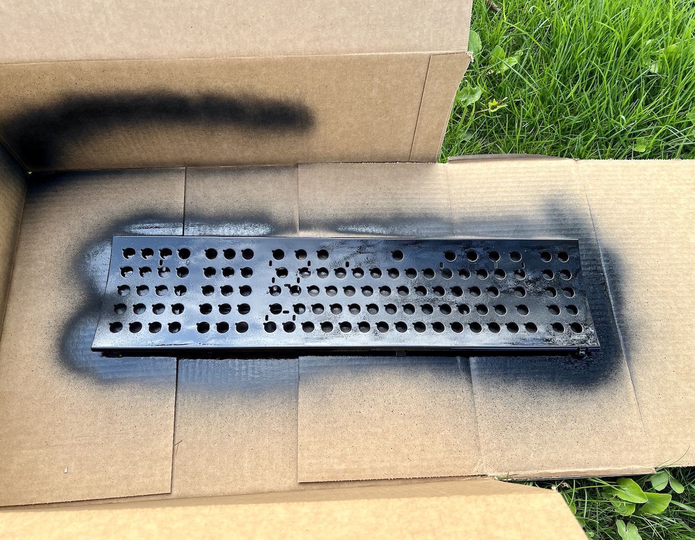

I sprayed several coats, waiting a day after each coat based on the experience of another person’s restoration, to ensure a good seal.
Step 13b Painting on Cardboard.jpg (604.11 KiB) Viewed 9749 times
After a few coats it looked brand new!
Step 13c Painted Barrel Plate Front.JPG (439.09 KiB) Viewed 9749 times

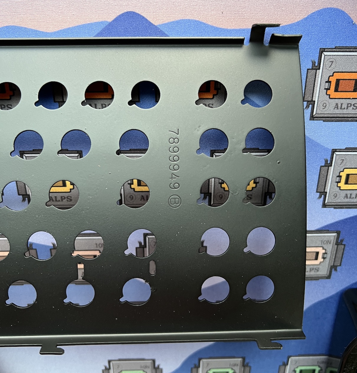

Closeup of the back of of the barrel plate showing the part number?
Step 13d Painted Barrel Imperfections 1.JPG (468.36 KiB) Viewed 9749 times

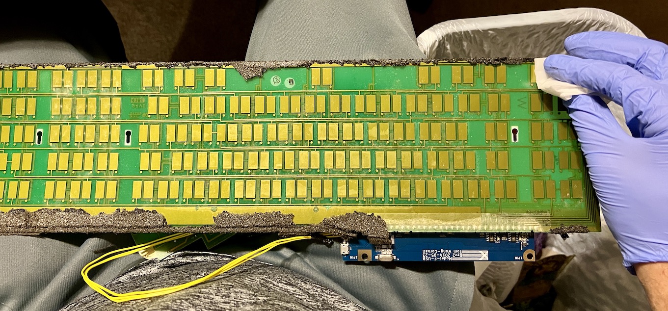

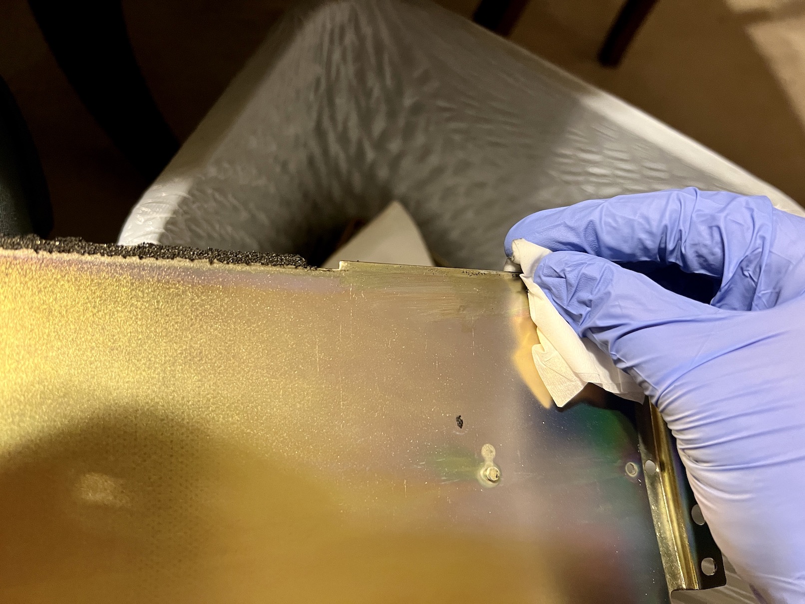

I then cleaned the foam on the back plate with an alcohol pad.
Step 14 Clean Foam from Back Plate.jpg (433.45 KiB) Viewed 9749 times
Along with the PCB. Note: I learned on a Focus keyboard using less than 90% alcohol results in an opaque film on the PCB. I don’t think the film damages the PCB, but I recommend using a higher concentration to be safe.
Step 15b Clean Old Foam from PCB.jpg (365.59 KiB) Viewed 9749 times

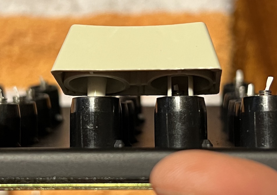

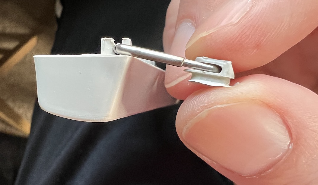

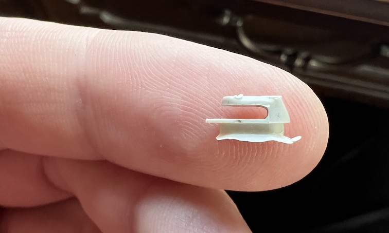

Next I reinstalled the spacebar stabilizers. These are plastic, old and might not survive the reinstallation, so I recommend having a backup plan. My backup was to use steel spacebar tabs from the New Model F project. These would need to be glued to the barrel plate but would be a good replacement. You could also make your own by bending a small steel tab and gluing it to the barrel plate, or 3-D print a “U”.
https://www.modelfkeyboards.com/product ... tabs-pair/
Step 16a Reinstalling Spacebar Stabilizers.JPG (59.98 KiB) Viewed 9749 times

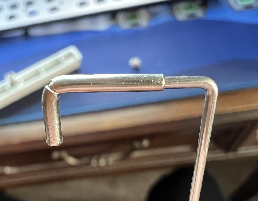

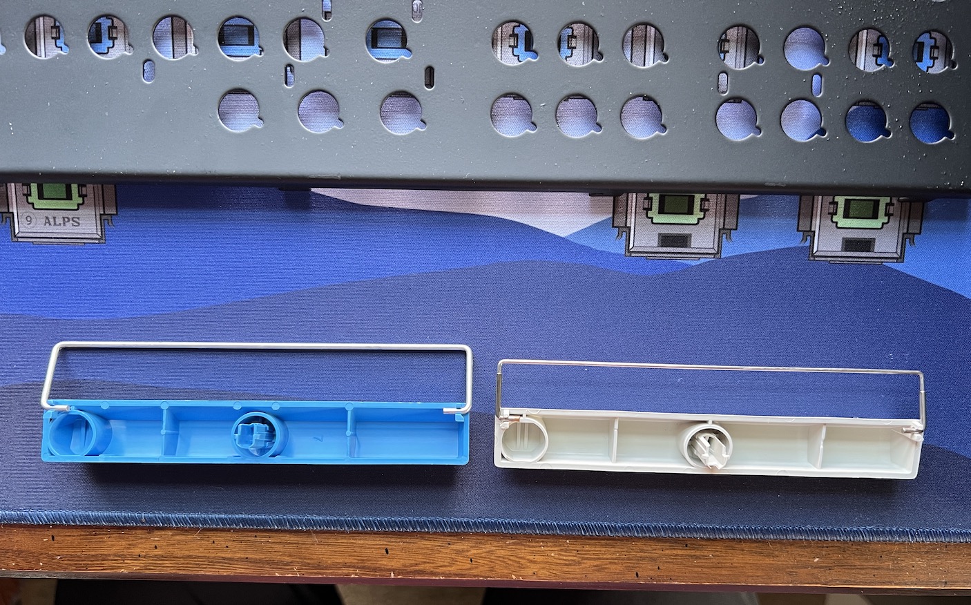

The F107 spacebar stabilizer wire has a shorter height than the Model M, so I recommend keeping it unless you can install new stabilizer inserts.
Step 16b Spacebar Stabilizer Comparison.JPG (473.39 KiB) Viewed 9749 times
The Model M stabilizer wire is thicker, and can’t be used with the original stabilizer inserts:
Step 16c Spacebar Stabilizer Comparison.JPG (111.06 KiB) Viewed 9749 times

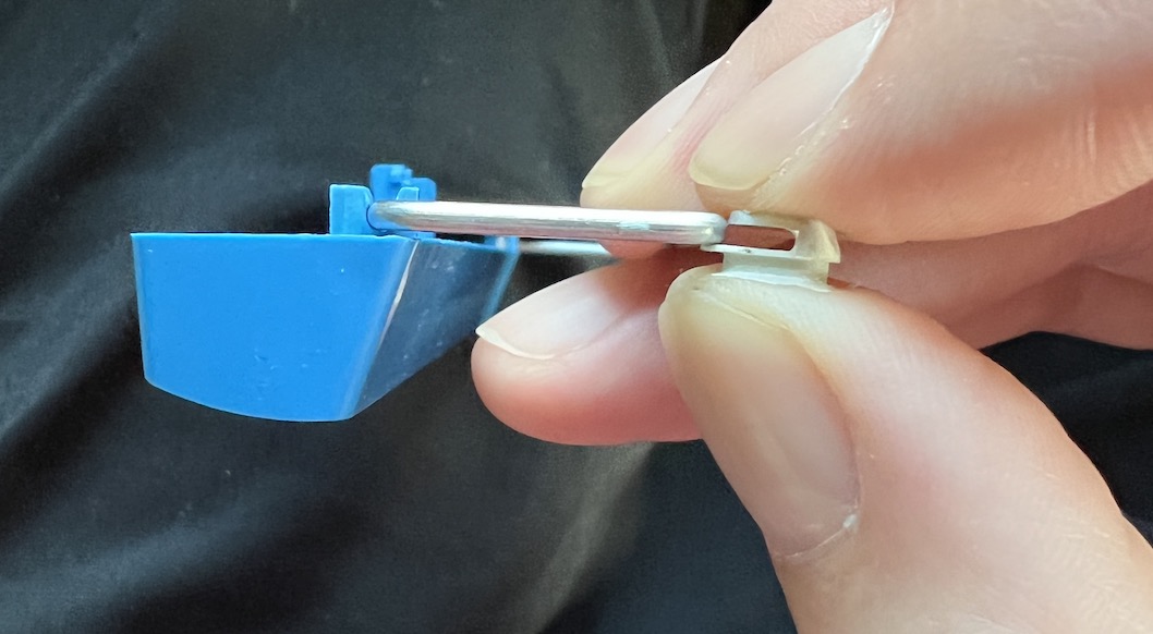

The original F107 stabilizer is made of several parts, with thicker pieces attached to the end to fit the spacebar.
Step 16d F107 Spacebar Stabilizer Wire.JPG (129.28 KiB) Viewed 9749 times
The thicker piece allows the wire to fit in the original F107 and new Model M spacebars.
Step 16d Spacebar Stabilizer Comparison.JPG (117.59 KiB) Viewed 9749 times
I installed the inserts without breaking them by fitting a small flathead screwdriver into the insert and pressing down into the barrel plate.
Step 16e Spacebar Stabilizer Installation.JPG (118.37 KiB) Viewed 9749 times

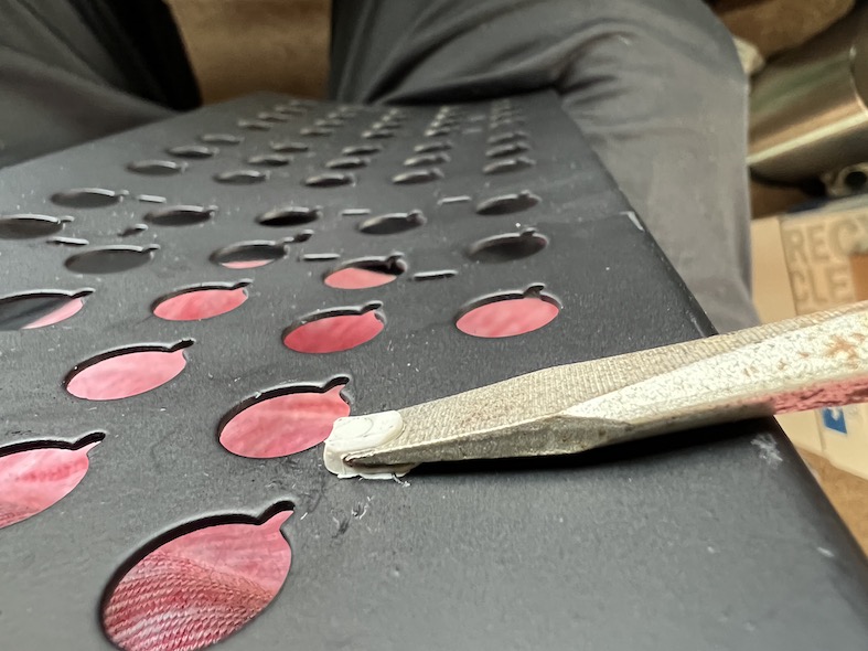

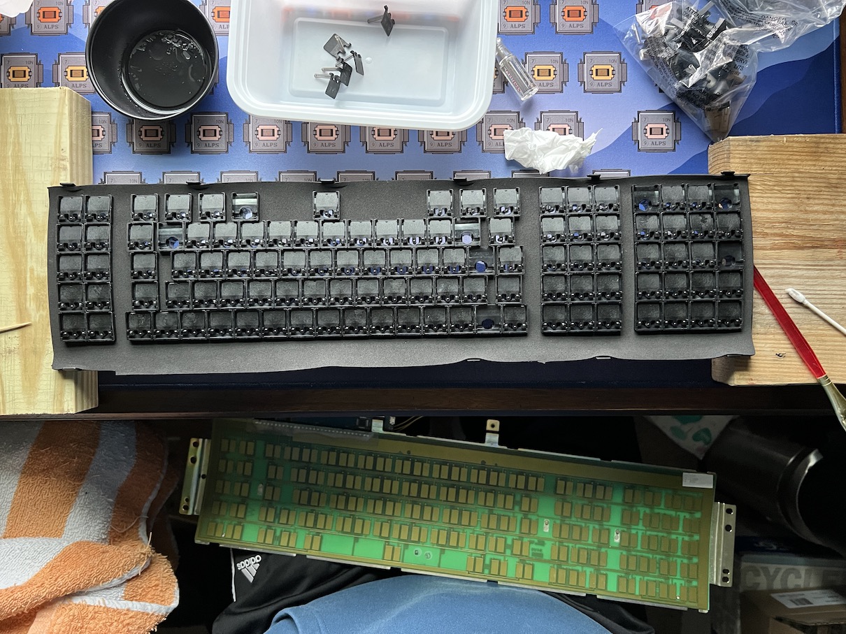

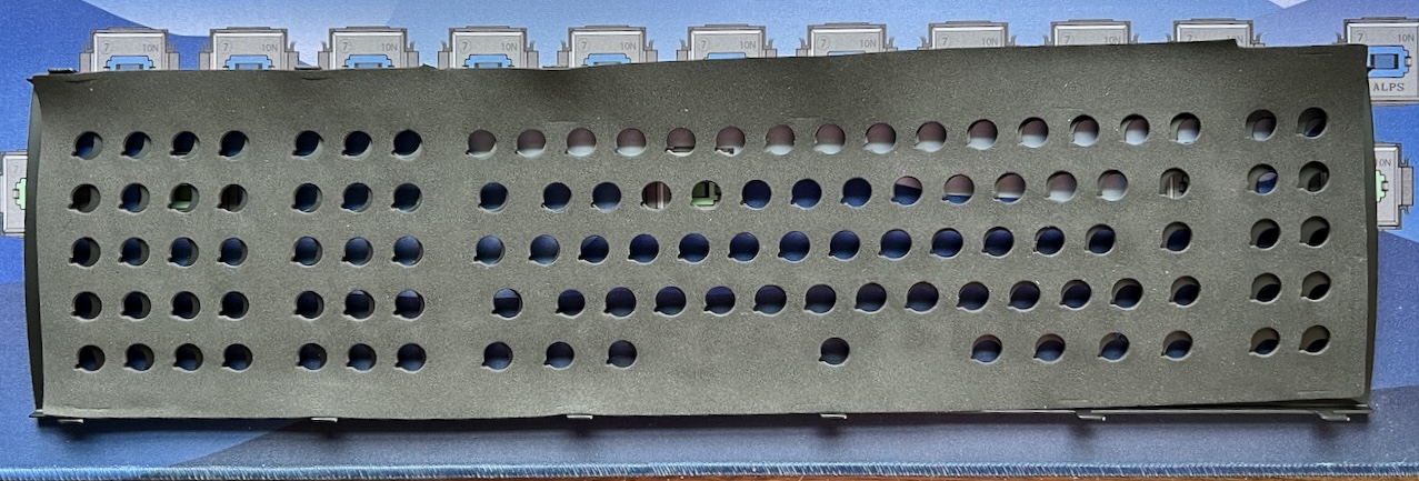

Next I put a new foam mat onto the back of the barrel plate.
Step 17 Put Foam Over Barrel Plate.jpg (265.45 KiB) Viewed 9747 times

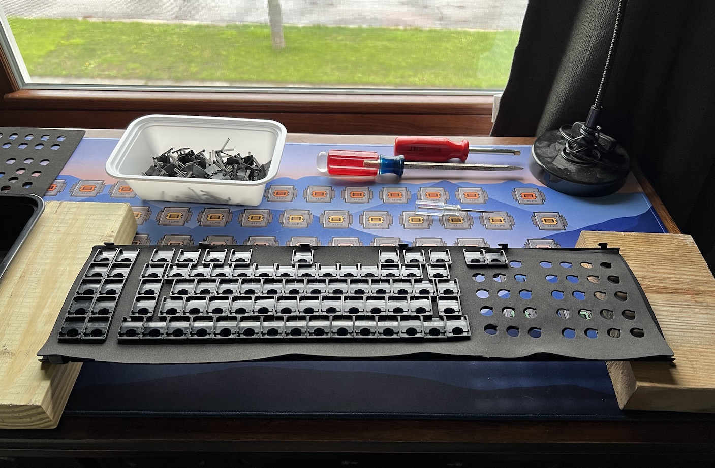

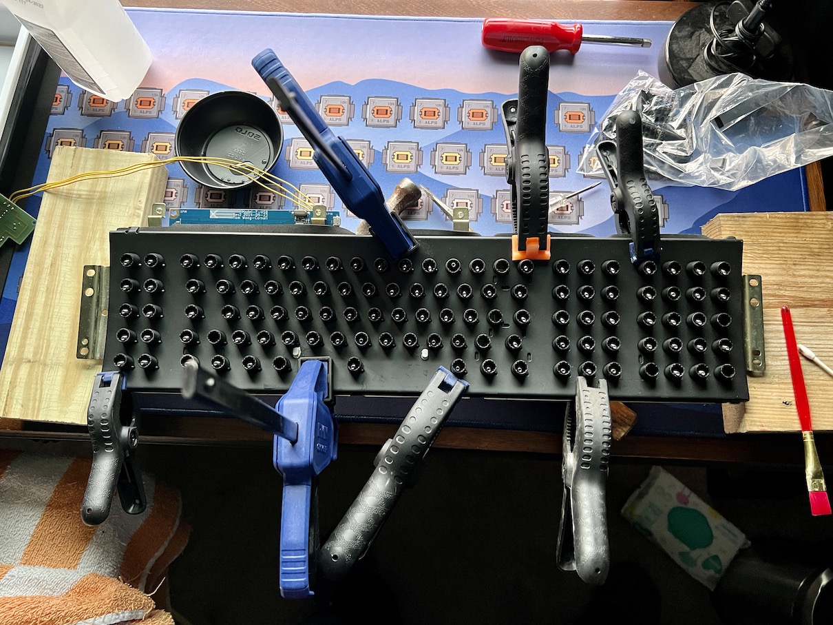

I mounted the barrel plate onto two blocks of wood to raise it from the desk, allowing me to insert the barrels.
Step 18c Install Barrels.JPG (410.78 KiB) Viewed 9747 times

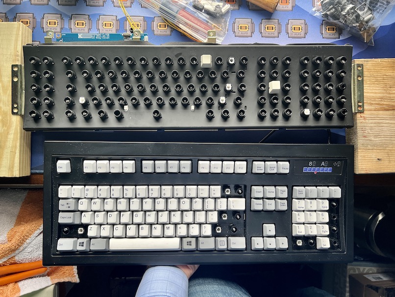

Next I installed the flippers. I’m converting the layout to ANSI, so I didn’t install flippers for the backspace, right and left shift.
Step 20a Put PCB and Back Plate on Barrel Plate Assbly.JPG (398.49 KiB) Viewed 9747 times
Then the back plate goes back on.
Step 20b Put PCB and Back Plate on Barrel Plate Assbly.JPG (280.54 KiB) Viewed 9747 times

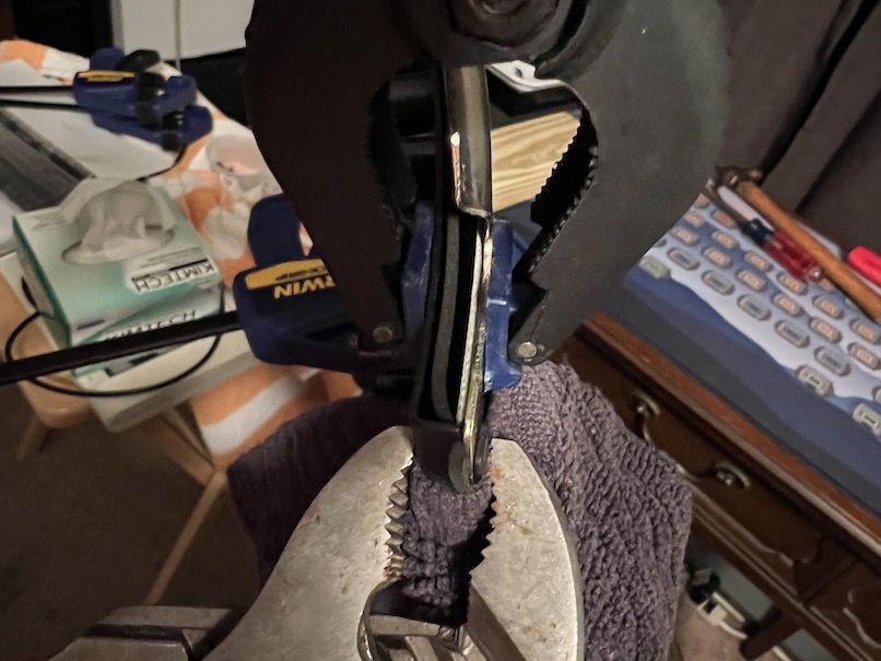

I flipped over there assembly and clamped the top and bottom together to make sliding the the back plate into he barrel plate locking tabs easier.
Step 22 Clamp Backplate and Barrel Plate Together.jpg (383.56 KiB) Viewed 9747 times

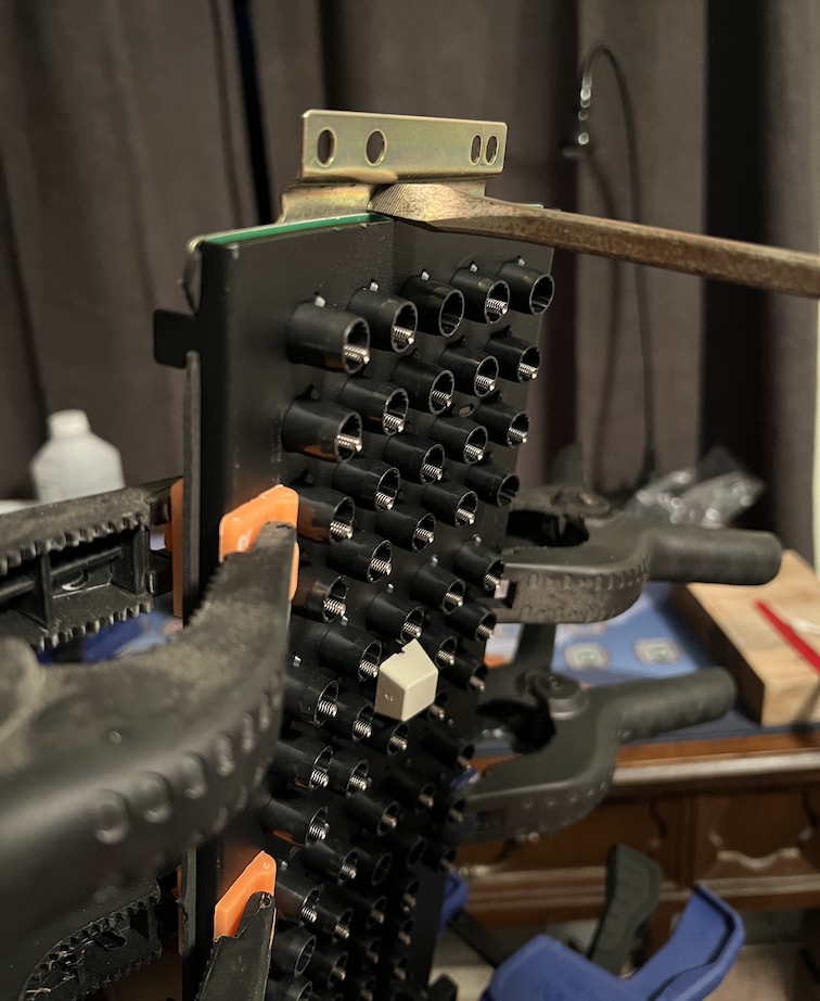

I slide the two pieces together I inserted a large flathead screwdriver between the mounting bracket and barrel plate and turned it, pushing the barrel plate into the back plate slots.
Step 23 Use Force to Push Locking Tabs Together.JPG (155.46 KiB) Viewed 9747 times

Then came the floss mod. I think the floss cleans up the sound and removes most of the resonance from the springs, perfecting the sound (in my opinion :))

I installed the keys starting with the ones using stabilizers. Just in case there was an issue.
Step 27 Install Keys with Assbly Vertical.JPG (111.04 KiB) Viewed 9747 times
I was using a key set from the New Model F project and it came with its own stabilizers which ensures compatibility, but I wound up having one issue with the + key. My fix was to use rubber bands to offset the barrel a bit which gave it the right orientation and allows the key to work perfectly.
Step 28 Barrel Adjustment for New Model F Keys.JPG (215.32 KiB) Viewed 9747 times
Finally it gets all buttoned up and is ready to go! I’m using the xwhatsit software to define keys and have had no issues.

Fantastic work! It takes courage to tackle restoration of something as rare and desirable as an F107!
darkcruix
13 Jan 2023, 13:36
Indeed, looks great. I love the overall configuration of it and ANSI mod. I kept the Num Pad with all individual keys as it gives me a bit more room for additional keys (as if they are needed on a F107 :)). You also did catch an F107 in good shape. I need to powder coat mine at some point.

Great work. I like that you only did the essentials and left the original paint on the case. Mine was powder coated before I acquired it.
thefarside
14 Jan 2023, 15:04
I’ve considered painting mine and ordered a set of dark grey caps from ellipse thinking I’d go for an industrial look, but don’t want to alter the original paint because it’s in good shape. I wonder if I could use something like plasti dip to have a new color but preserve the original paint?
Just because I installed the dark grey keys and the contrast was a little too much for me :lol:

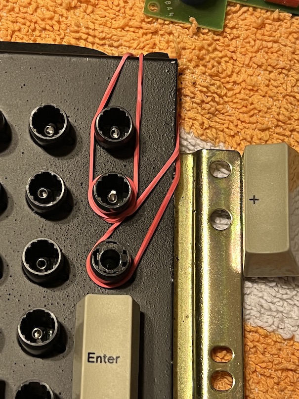

Nice job, and curious to see that fix with the rubber bands. I would suggest using polyurethane plastibands instead, as the rubber ones will wear off and release the pressure pretty quickly.
Maledicted
14 Jan 2023, 22:52
thefarside wrote: 14 Jan 2023, 15:04 I’ve considered painting mine and ordered a set of dark grey caps from ellipse thinking I’d go for an industrial look, but don’t want to alter the original paint because it’s in good shape. I wonder if I could use something like plasti dip to have a new color but preserve the original paint?
I've worked with plasti dip before. It is really forgiving stuff. That's some really old paint that looks like it is already chipped in at least one place though. I know I wouldn't risk making it worse myself.
If you wait a few decades, yours might be the only beige one left. lol
inmbolmie is right about the rubber bands. They're going to turn into goo eventually.
thefarside
14 Jan 2023, 23:15
Thanks I'll switch to polyurethane bands. I don't want any surprises if/when the rubber bands go. I'm definitely going to preserve the paint, but I might look into plasti dip if it's safe. If not it'll stay original.

Love the fresh look of a painted barrel plate. An often overlooked detail that you don't really see once everything is put back together. Also it looks like I am going to need to find more clamps...
thefarside
17 Jan 2023, 19:10
Sheepless wrote: 17 Jan 2023, 11:52 I sometimes daydream about finding various keyboard unobtainium for cheap at a yard sale. Though I'm not sure I could ethically give a grieving widow pennies for her late husband's "garage full of junk" when it's actually worth a fortune.
You never know. The 4704 keyboards were exclusively used by banks which makes finding them very difficult. Although one user found an F77 in a pile of garbage outside a bank. If I see treasure hunting opportunity I’ll usually check it out.
