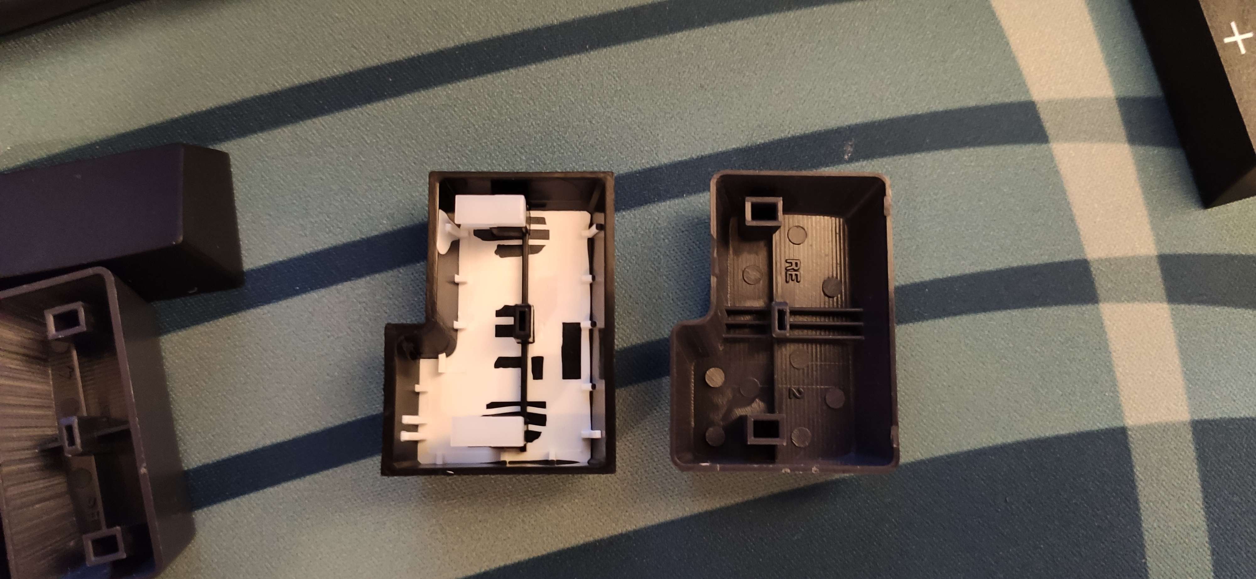

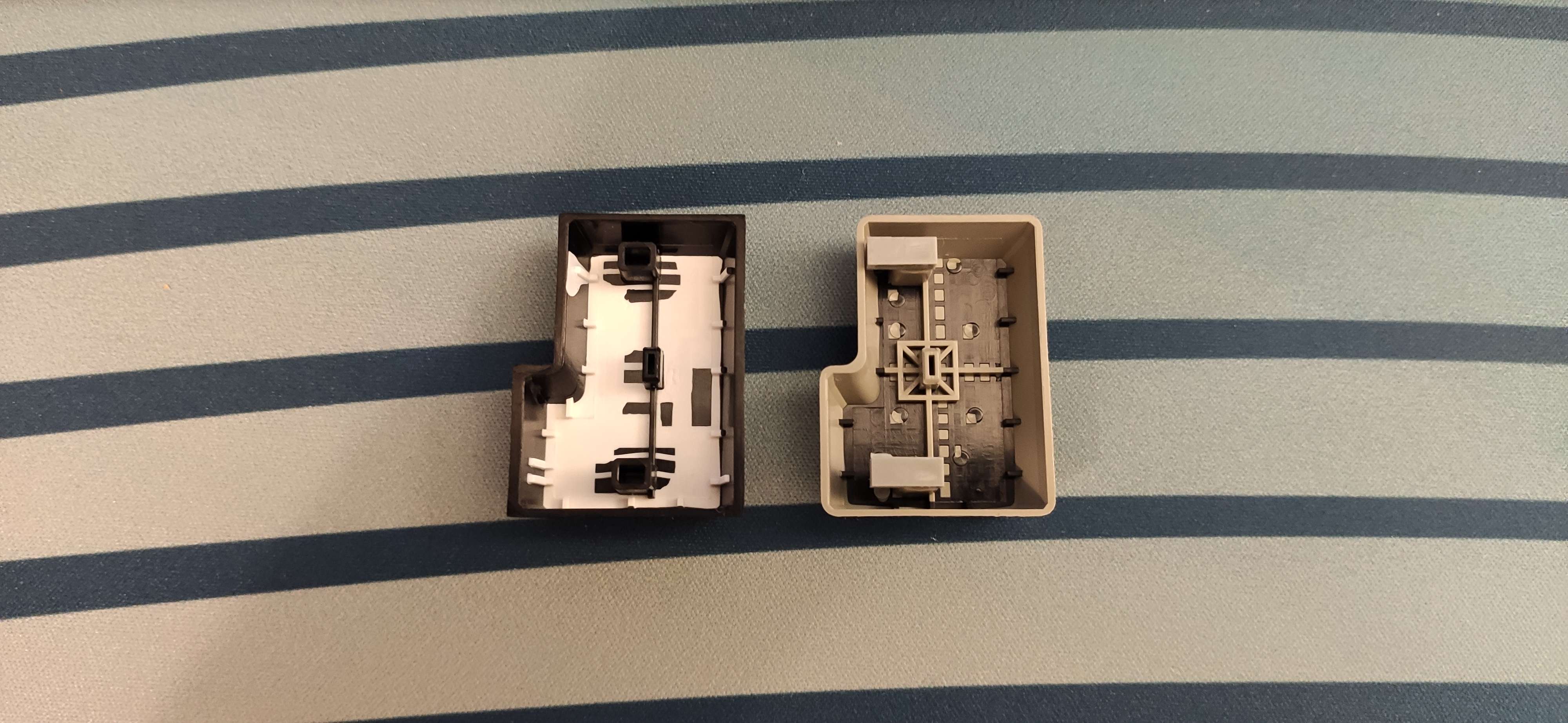

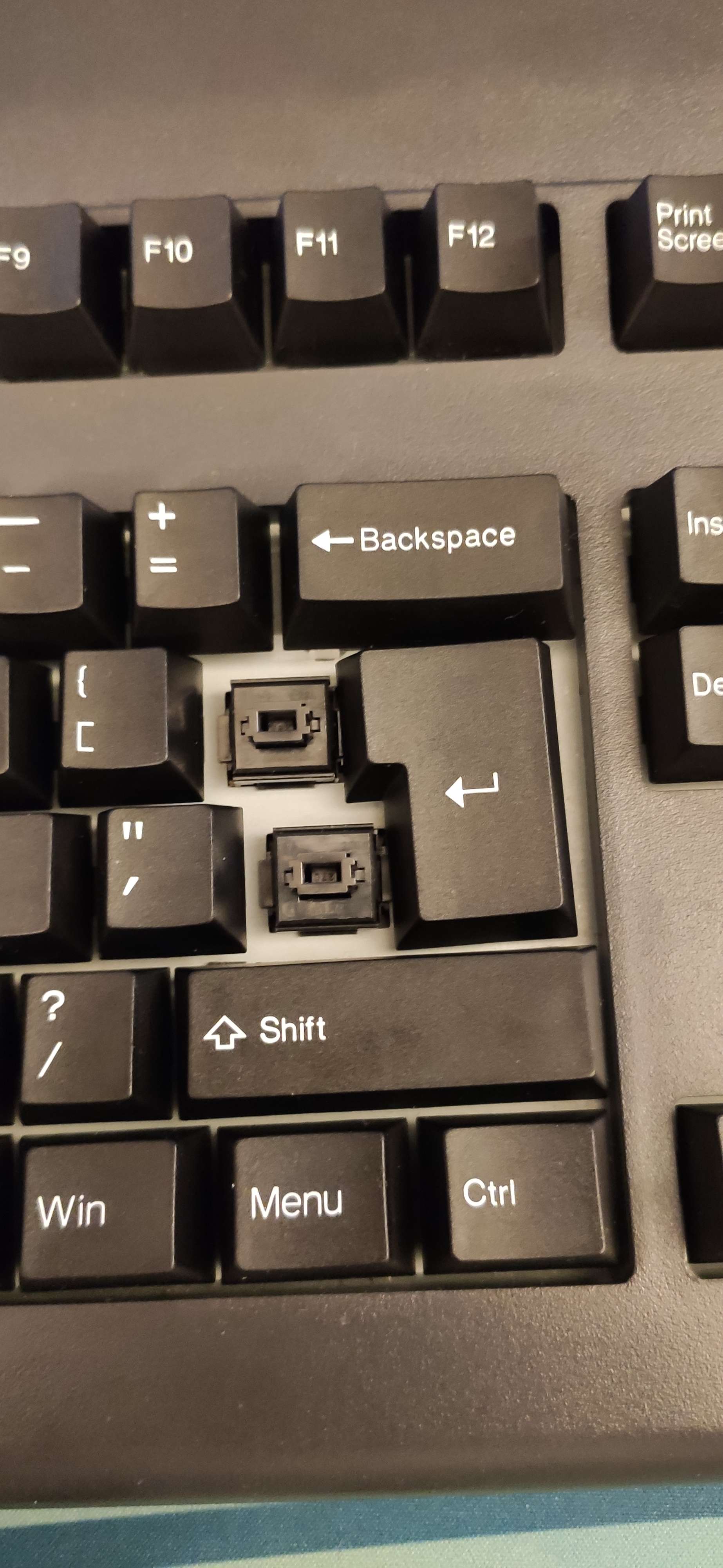

just so you know, i bought the set specifically for a black winkey dell, the stem of the tai-hao enter is in the middle while the dell uses an offset.
same goes for an iso focus fk-2002.
"mounted" on dell:
are there any vintage iso boards with such offset like on the tai-hao enter? please let me know.
im very sad.

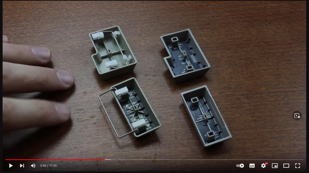

chyros even made a video saying especially iso dell and focus keyboards would be compatible (besides spacebar)
https://www.youtube.com/watch?v=SNQXgoAgVKY
even shows the enter keycap (dell and taihao) in one frame
i do see it now but did not when i watched the video..

We've talked about Alps ISO Enter keys at least a couple times in the past. There were at least four different stem locations:
viewtopic.php?f=56&t=23960
viewtopic.php?f=2&t=21573

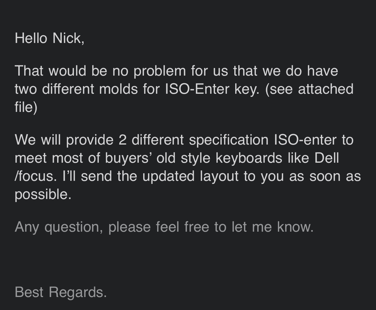

As I´am somewhat responsible for getting tai-hao to produce the ISO DE Version of this Set and iam in already in contact with one of their reps, i forwarded this issue to them as well. Thank you very much for posting it here.

Update:
06 Feb 2023, 13:51
Now that’s constructive feedback. :D

Uh, which two? There are four (?) different possibilities for the ISO Enter stem position.

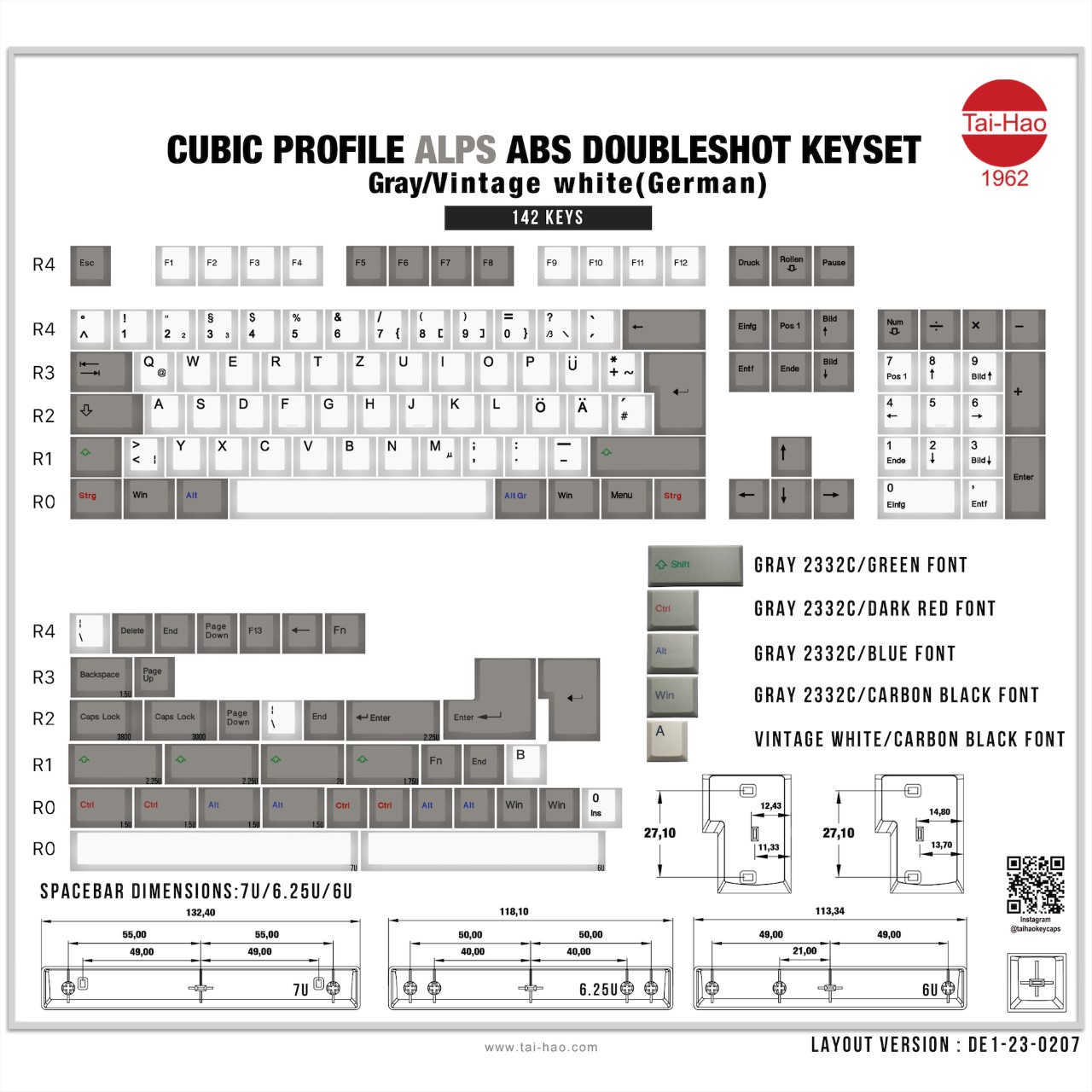

Update:
Tai-Hao sent me the new Layout. They added the DELL / Focus compatible Enter Key and another stepped caps lock for greater compatibility.
