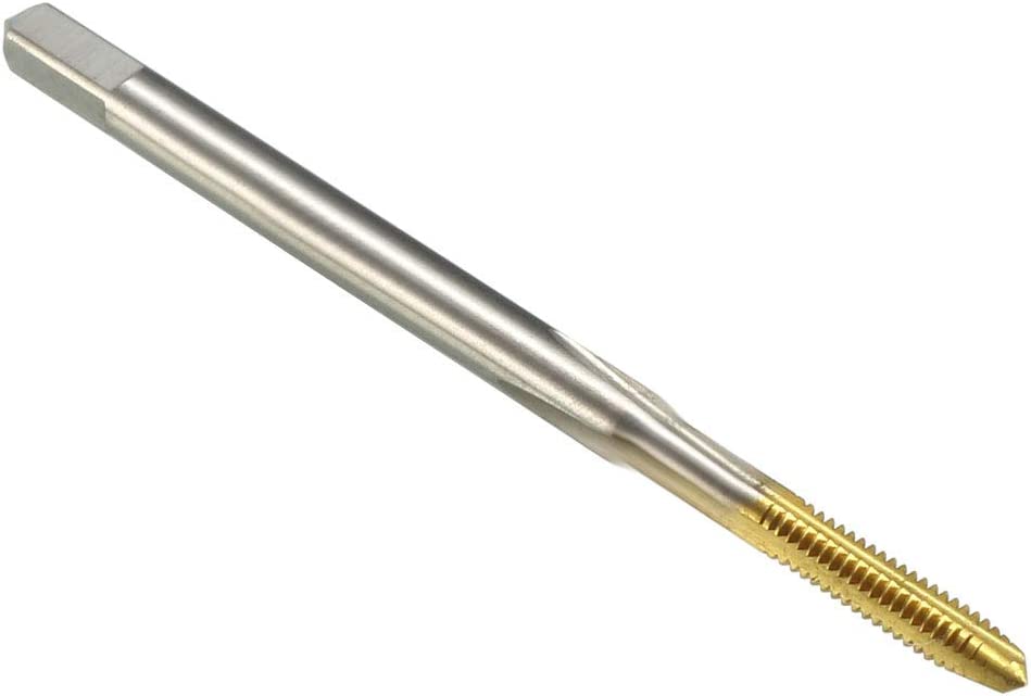

But just to be very clear, that's the tap drill size, meaning, that you must use one of these tools to cut the threads if you use that drill size:
I believe these tools cut away material rather than deforming material.
I don't think I've seen anyone perform a bolt mod with one of these tools. The geekhack bold mod wiki says using them is optional, and it's definitely not optional with a 1/16 hole size when using M2 machine screws.
If you plan to not use one of these tools, then you must go with something that is >= major diameter of the screw. Your .pdf recommends 2.1mm for Close fit, and 2.2mm for Standard fit.

pandrew wrote: 10 Mar 2023, 05:56 But just to be very clear, that's the tap drill size, meaning, that you must use one of these tools to cut the threads if you use that drill
The nomenclature is somewhat confusing; the tool that your picture shows is called a machine tap, but the procedure is that you first use an undersized drill bit called a tap drill, whose diameter is about 75% of the major thread diameter, and then follow it with a tap if you want to cut in the threads rather than let a screw cut them. However, if you drill into plastic, you don't have to use a tap, you can just drill a tap hole with a tap drill and then put in a screw, which will cut its own thread.
If you drill for a close fit or standard fit, the screws will not stay inside the plastic part and it will be more of a pain to assemble the whole thing together.

engr wrote: 10 Mar 2023, 06:14 However, if you drill into plastic, you don't have to use a tap, you can just drill a tap hole with a tap drill and then put in a screw, which will cut its own thread.
I very much disagree. Taps actually cut away the material, that is, they result in shavings removed from the hole after you use them. While self-tapping screws, only push on and deform the material they are screwed into. That's why self tapping screw thread profiles are thin (thread angle is small), and the threads are farther apart from each other (thread pitch is higher). It's a lot less comfortable to hold a self-tapping screw thread between your fingers (compared to machine screws), because the threads are like thin blades. This results in less material being displaced smaller distances (when compared to machine screws). Machine screws are not designed to do that, they are instead designed to support more weight. And screws in general don't cut away material.
Some very brittle plastics can't even handle self-tapping screws. For example I can't find any examples of self-tapping screws used for acrylic.

pandrew wrote: 10 Mar 2023, 06:35 Taps actually cut away the material, that is, they result in shavings removed from the hole after you use them. While self-tapping screws, only push on and deform the material they are screwed into.
Yes, self-tapping screws are better in that respect. My concern with them would be their compatibility with nuts because of the different thread and having a shank slot at the end.
A pilot hole, followed by a tap to form thread, followed by a machine screw would probably be an ideal solution from the standpoint of minimizing the risk of cracks, but it's also the most labor-intensive one.
