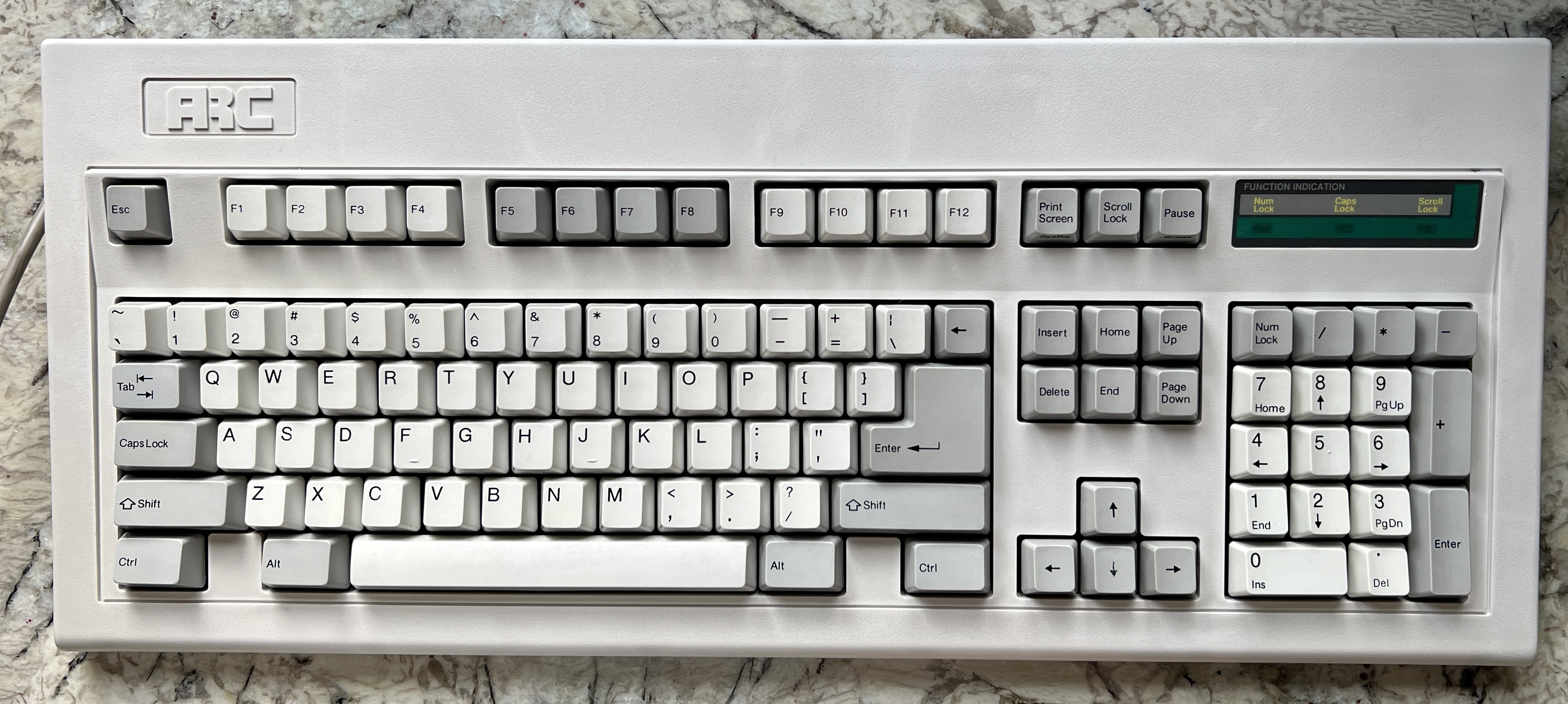

You can also find cherry switches in the Chicony KB-5181, but that keyboard can also come in a variety of other switches. Pics for reference:
