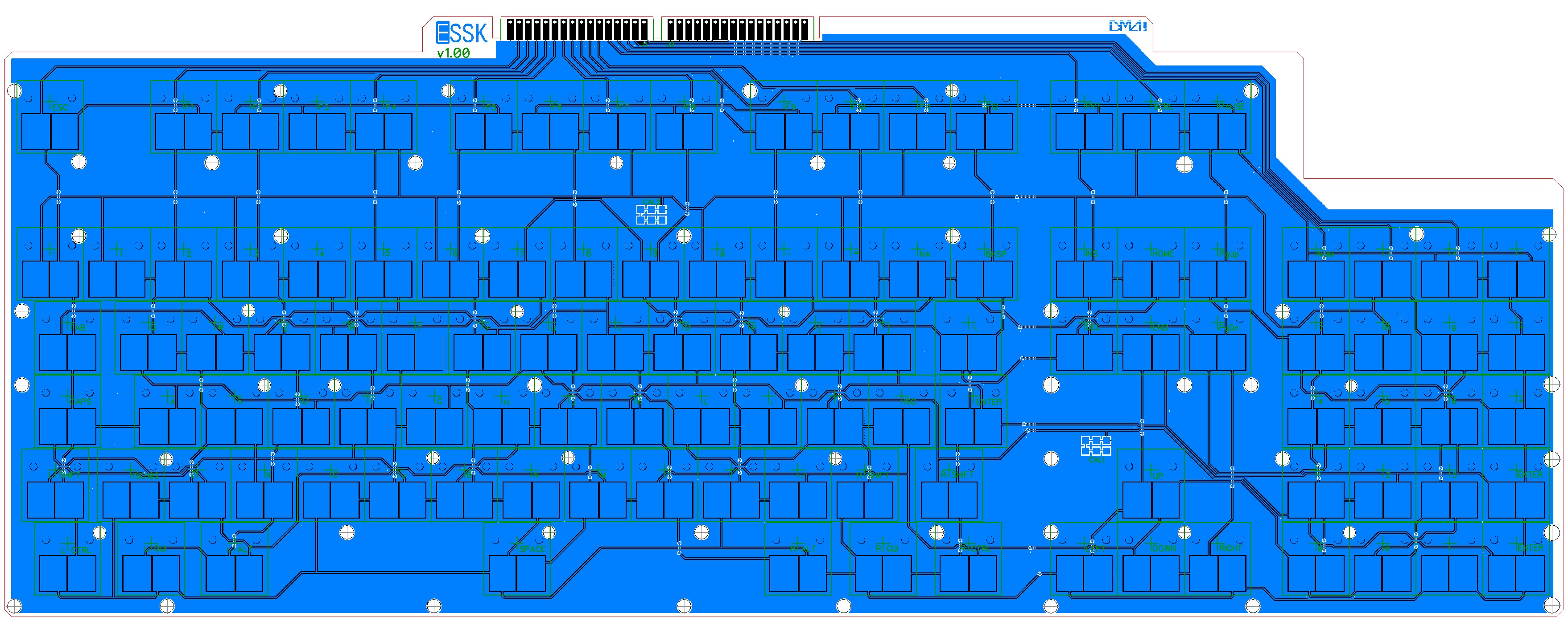

Everybody knows that capsense requires good grounding of all the metal parts inside keyboard.
However.. what if.. what if you bring ALL YOUR GROUND WITH YOU?
wcass did it for his CSSK using 4-layer board. But 4-layer boards don't bend that well..
So I spent 3 days of my unemployment and drawn this (just ordered 5 of those (SSK versions) from jlcpcb, ended up paying about $9 per SSK board).
The bottom side is basically one huge-ass copper pour.
This supposed to have a _really_ strong signal - even xwhatsit shouldn't have any trouble reading those. Let's see if I'm right, lol.
If I'm right - there might be a GB.
Since 0.6mm boards are now cheap - I'm gonna use that old idea of using triomate FFC sockets for the controller-board interface, to avoid soldering.

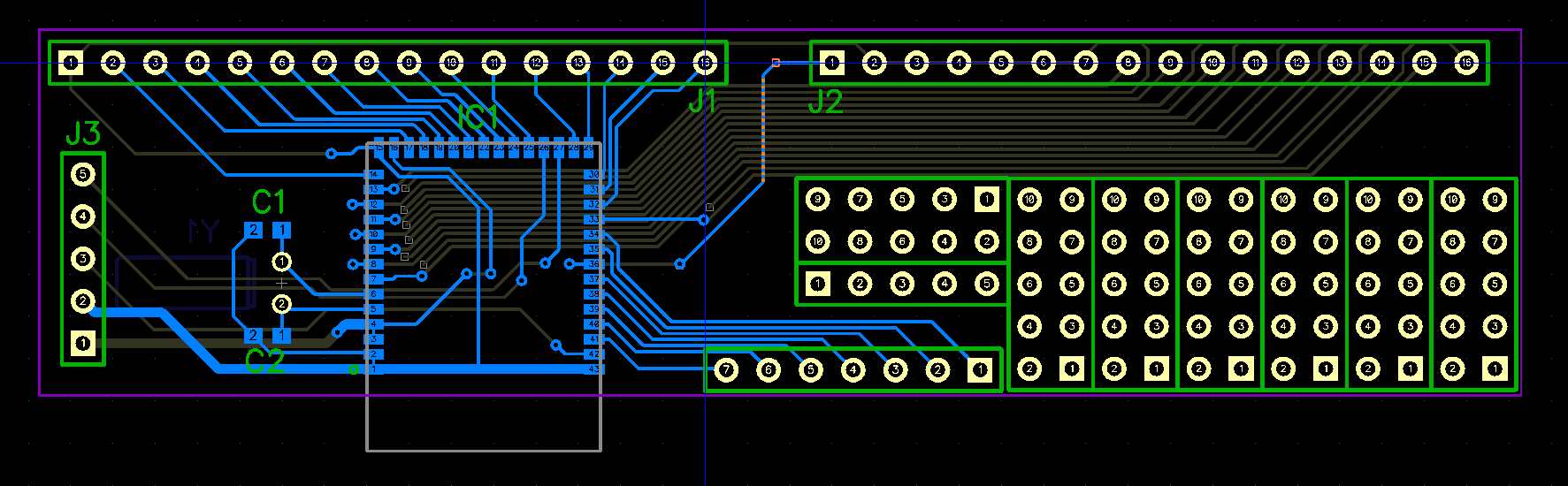

Also, this will be a prototype controller for those boards:
it's currently more of a breakout board for the BLE module - but it will be a fully functional NKRO BLE capsense controller powered by 2 AA/AAA batteries. Later on, if there's any interest, there will be a version with Li-ion battery charged from USB (and may be even wit USB interface - although not sure about that, will need to essentially reimplement V-USB for cypress for USB to work..)

Matrix is exactly the same as FEXT PCB - the only material change is that keys are now components - which allows to quickly change the pad geometry. Did you know that FSSK PCB was missing one flipper stand (that round dot above the pads) somewhere in the middle of the alphanumeric block? I accidentally discovered that when converting to components :D

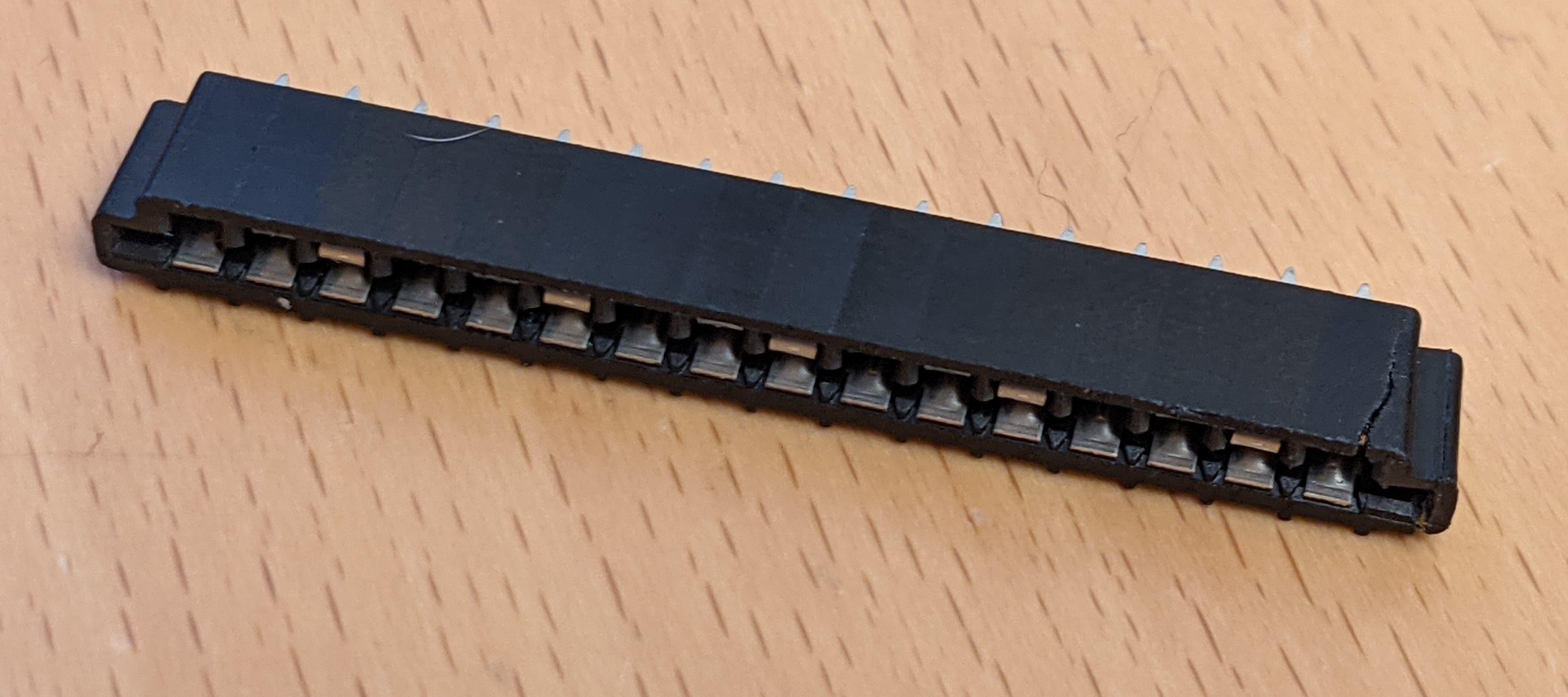

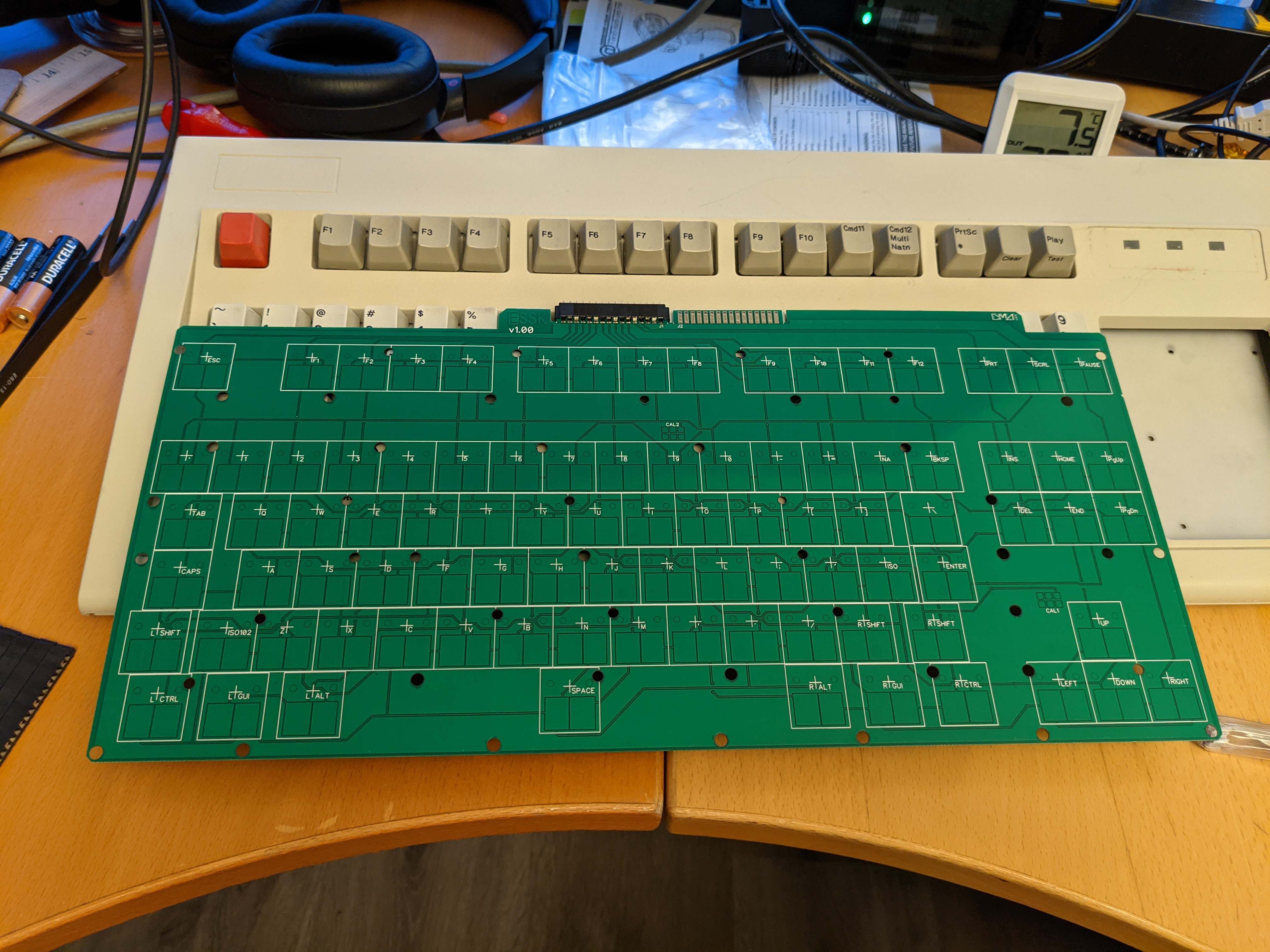

Got the boards.
The good:
* the triomate mates to 0.6mm PCB without apparent damage, and I've got the footprints right.
The bad:
* triomate insertion force is, like, 2 kg, and removal is just a tiny bit less. The holes on the edge of the board (why did I even?) probably didn't help.
* The socket bulges ~0.1mm in the middle when inserted.
* I managed to tear the socket's side trying to pull it off the board:
So, 0.4mm board will work like a charm (also it's ENIG-only, so will look much cooler, too). wcass, if you're here, your idea to use triomates to connect sense card to the controller is verified working, yay!
This is it - I scratched my itch, thank you for your attention. Probably won't even assemble the controllers, because why?

ESSK board seems to provide ~1.95x better SNR and also actually works without conductive backplate (as a bare PCB on the table) - although in that case it's only ~1.72x better than fully assembled FSSK with IBM-style PCB.
I'm now trying to understand why (so I've made a capacitance meter from oscilloscope and a signal generator and measured FSSK, ESSK, XTant, F122 and wcass' single keys he made back in what, 2014? - both encased and bare PCB). I'll probably post a summary someday, but just measuring took me about 12 hours - it's quite a tedious process, with 180 datapoints per board (7 boards so far).

wcass wrote: 05 May 2023, 00:53 Great to hear that the Triomate works. Do you think this would work on a 0.4 mm board?
Welcome back! Not sure - it's designed for 0.3mm+-0.05mm, while triomate tolerates 0.38mm officially and has wider tolerances. Also 1mm pin pitch worries me a bit - tracks will be quite thin and might delaminate, plus positioning will be _really_ finicky because pins will need only, like, 0.2mm to slip off the track and short to the adjacent one.
