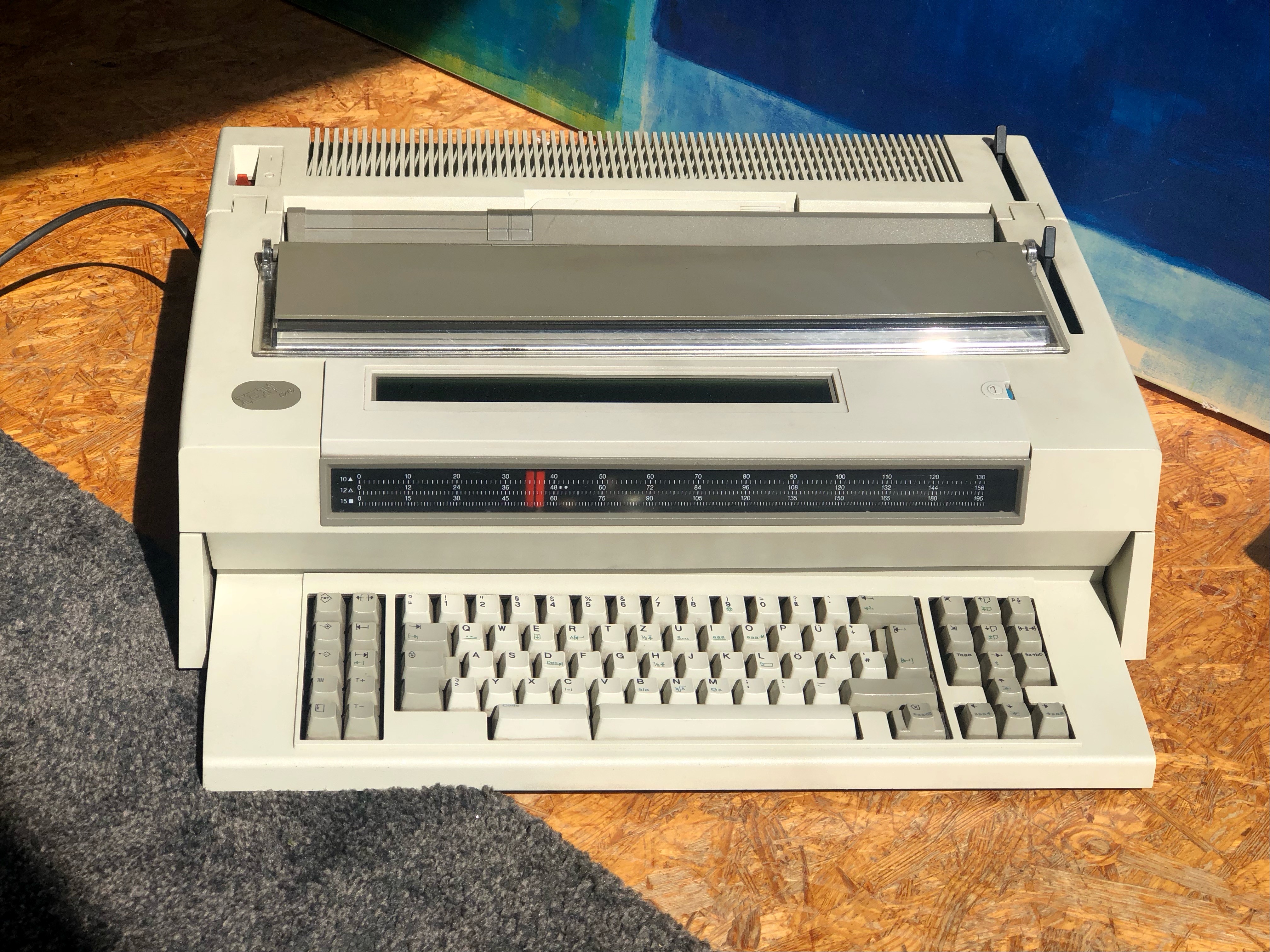

My Father recently gifted me this IBM Typewriter he got from a Friend @Work.
He told me:" Its from IBM and it makes Clickity Sounds, is it this like the Model M you´ve told me about ?"
I was very impressed, since he is not into keyboards at all. (He uses an old Chicony with MX Blues I gifted him for Christmas and he IS into Typing on it, but has no knowledge about keyboards otherwise)
Edit:
He had the Choice between the Chicony KB-5181, a blue Badge Model M and a Cherry G80-3000 HAD.
I confirmed that he was indeed right, its a Buckling Spring Keyboard Assembly.
But I was wondering, are those Typewriter´s capacative like Model F´s or "normal" Buckling Spring like the Model M ?
I am also wondering if i should go through the hassle of converting it to a usable keyboard like here:
viewtopic.php?f=7&t=27724
Probably only will do that if the assembly is capacitive.
How can I check if this is the case ?

kmnov2017
19 Apr 2023, 10:57
That specific model has a model M type keyboard - a quick feel test will confirm that. There were a few older models that had the F style keyboard (IBM 85 for example).

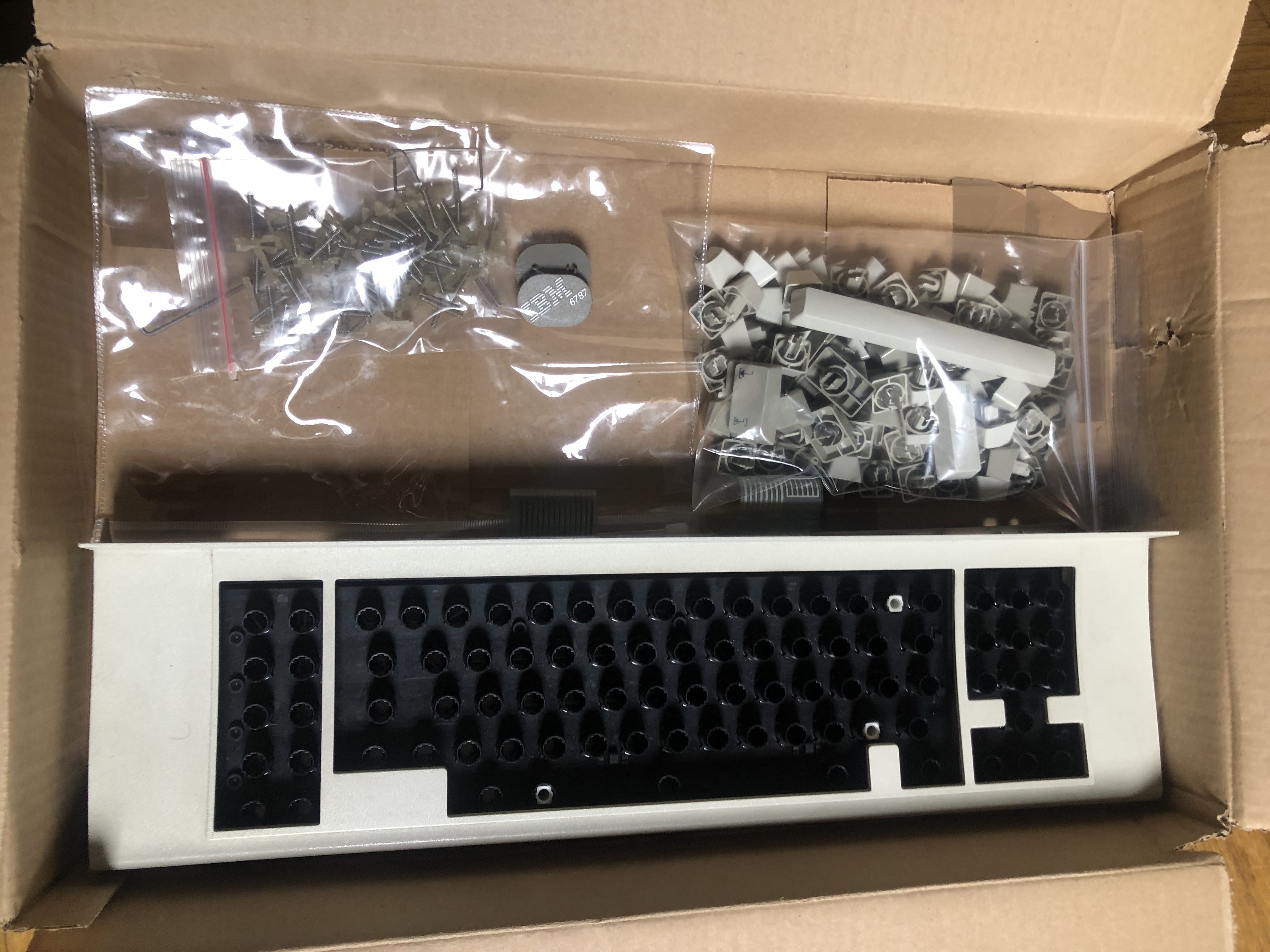

Yesterday I took it apart & disassembled & cleaned the Keyboard Assembly. Almost all of the plastic rivets where broken, so I decided to remove the remaining ones to really deepclean the board.
Will post a few pictures when I get home.
Edit: sadly didnt have time for a few pictures, as I was in quite a rush.
well, thats how the projects looks for now. I ordered some 2,2x6,6mm Screws to screw-mod the Board. After that, ill see what I will do with the project. I spotted a crack in the barrel plate, while its very thin, its also quite long. I planned on fixing it with superglue, maybe ill try to plastic weld it together with my soldering iron.

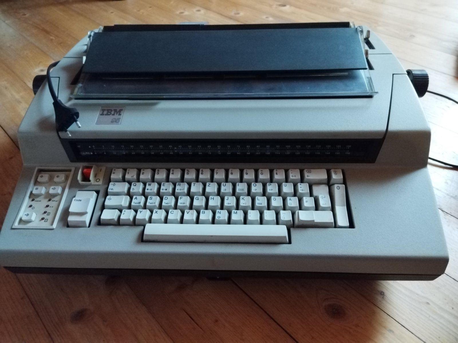

Update: Just scored an IBM 95 :D
Someone actually put it up for free yesterday on Kleinanzeigen. ( perfect timing, as usual)
Was just local for pick up , but a small fee and some kind words later i convinced the very nice seller to send it to me.

Is in in Qwertz? What is the german product name? I did a little bit of searching around and I couldn't find any records that it was marketed and sold around here.
Could you post the link to the (deprecated) Kleinanzeigen-Listing? I wanna take a peek

TNT wrote: 21 Apr 2023, 17:46 Is in in Qwertz?
Oh yeah it is 8-)
TNT wrote: 21 Apr 2023, 17:46 Could you post the link to the (deprecated) Kleinanzeigen-Listing? I wanna take a peek
https://www.ebay-kleinanzeigen.de/s-anz ... 1-192-6670

Maybe you can somehow incorporate the big toggle switch on the right, the power switch and also the left panel in your build. Shame the plastic safety hatch of the power switch is gone. There's so much potential here! I'm excited to see what you're going to do with this one.
Oh, and before you toss any of the remains out (if you're planning to even do that, that is), please drop me a quick message before.
