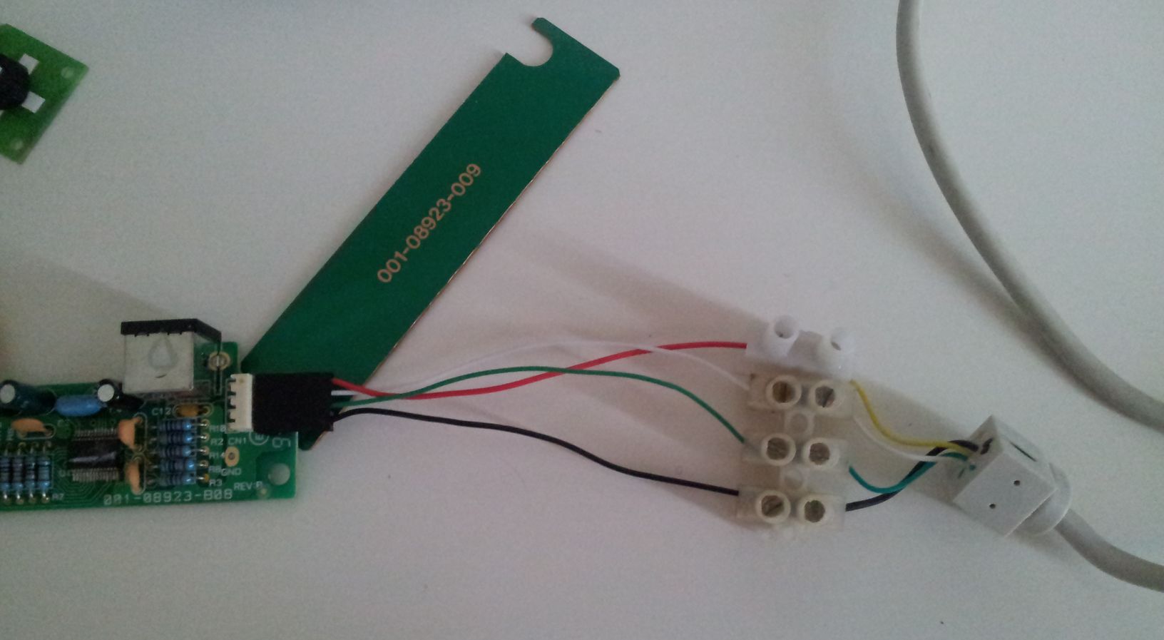

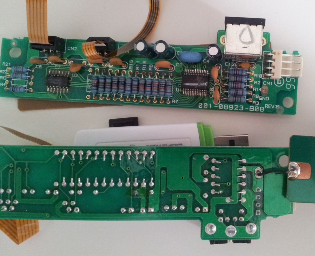

Trackpoint Pinout.jpg (150.87 KiB) Viewed 12088 times
this are my 2 Trackpoints view from up and down.
if i connect the trackpoint to the PS/2 connection, the TP does not work.
I don't know what todo? :?

Is that the controller for the entire keyboard or just for the trackpoint part? What is the white connector in the top picture on the right for?
CeeSA
04 Sep 2012, 10:54
this is only the controller of the TP i think. Look at 3rd pic in the op, the white 4pin connector is the connection from the TP controller to the keyboard controller.

Did the TP and the keyboard controller have separate ps/2 ports?
CeeSA
04 Sep 2012, 11:22
i think so. Looking at the 3rd pic from tipo33 the cable to the PC split up in 2 directions. To the TP and to the keyboard.
Maybe it has 2 ps/2 connectors at the other end. But then i don't know for what is the ps/2 connector direct at the TP.

ok, got it:
TP pinout.jpg (104.44 KiB) Viewed 12065 times
I am still wondering for what is the PS/2 connector at the TP unit for?

Maybe you can connect an external mouse and it will be patched through.
Glad it works now, even though that controller is huuuge. :)

Input Nirvana
09 Sep 2012, 06:16
Yes, you can connect a mouse to the extra ps/2 port. Is that what you're asking?
This is what I used with the Split Kinesis project.
Turns out the Kinesis Advantage is a PS/2 controller through and through, with a separate, active USB converter pcb in the case. I always thought is was for the extra USB ports and maybe a 'staging' pcb.
Input Nirvana
23 Oct 2012, 02:43
I don't think the question ever was answered.
The keyboard has 2 completely separate and independent controller pcbs. One is for the keyboard ONLY. The other is for the trackpoint ONLY. The power cord is actually 2 power cords in 1. At one end there are 2 ps/2 connections. At the other end there are 2 4 pin block connections, one for the keyboards pcb and one for the trackpoint pcb. The track point and the keyboard are not interconnected in any way. You can remove the trackpoint and still use the keyboard and use the trackpoint in your mod.
As for the ps/2 connector on the track point pcb...you can plug another ps/2 item into it and it will work. It's a 'flow-thrugh' connection.
