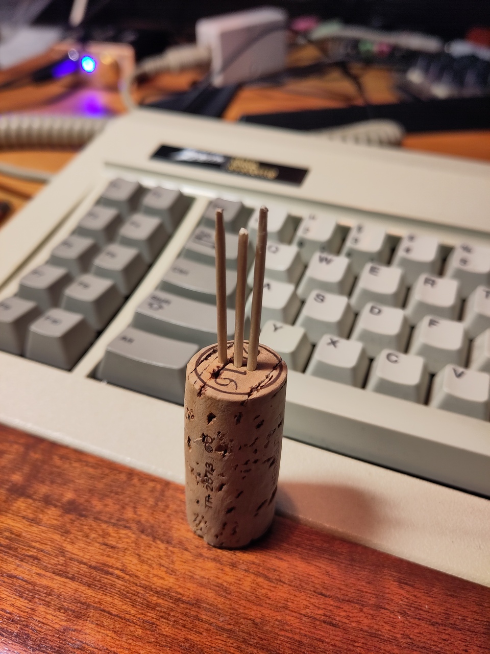

As I am also in the process of restoring a Harris Digitran, I can vouch for the toothpick method.
However, what I found to be a lot more gentle on the sliders is not just flat squaring them off, but rather giving them just a tiny bit of a tapre towards the end. That way you don't have to push in super hard. Instead, insert both picks just enough and slightly force them apart (outwards) while simultaneously pulling the slider out. Slow and steady is key. Works like a charm for me, no broken sliders yet.
Btw. judging from my board and your photos it seems to me the sliders originally came with some kind of lube applied to them. Which is now dried up and collecting all kinds of dirt and dust, hence the scratchy experience ...
Your keycaps probably don't even need polishing, do they? Looks like they barely yellowed, or at the least did so very evenly
TNT
03 Oct 2023, 17:10
I retract my statement, just pushing them in works just as well. In my case, it's not even neccessary to square of the toothpicks at all.
I may present you the pinnacle of modern, german engineering: The Digitran Slide Extract-O-Matic :mrgreen:
