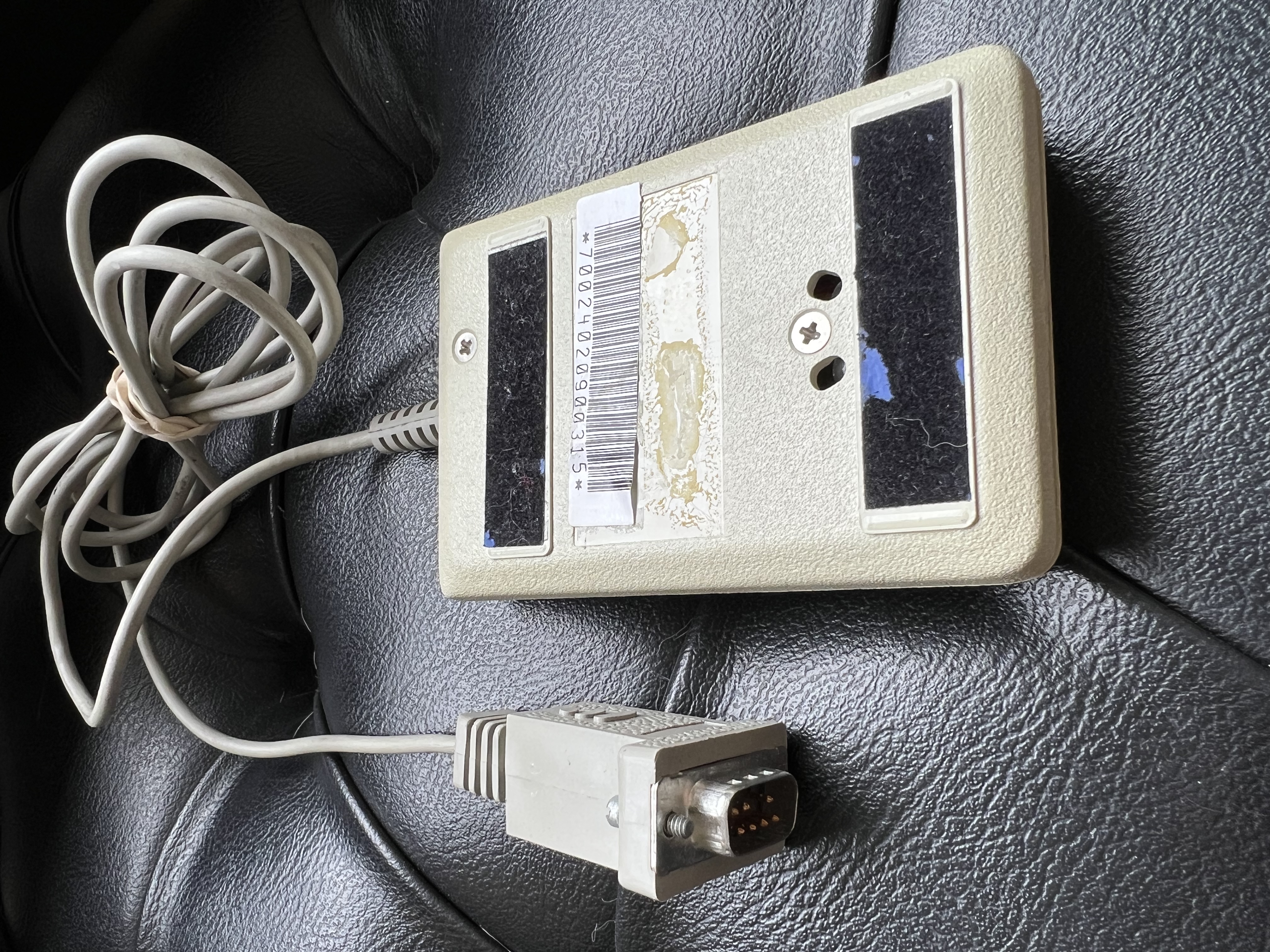

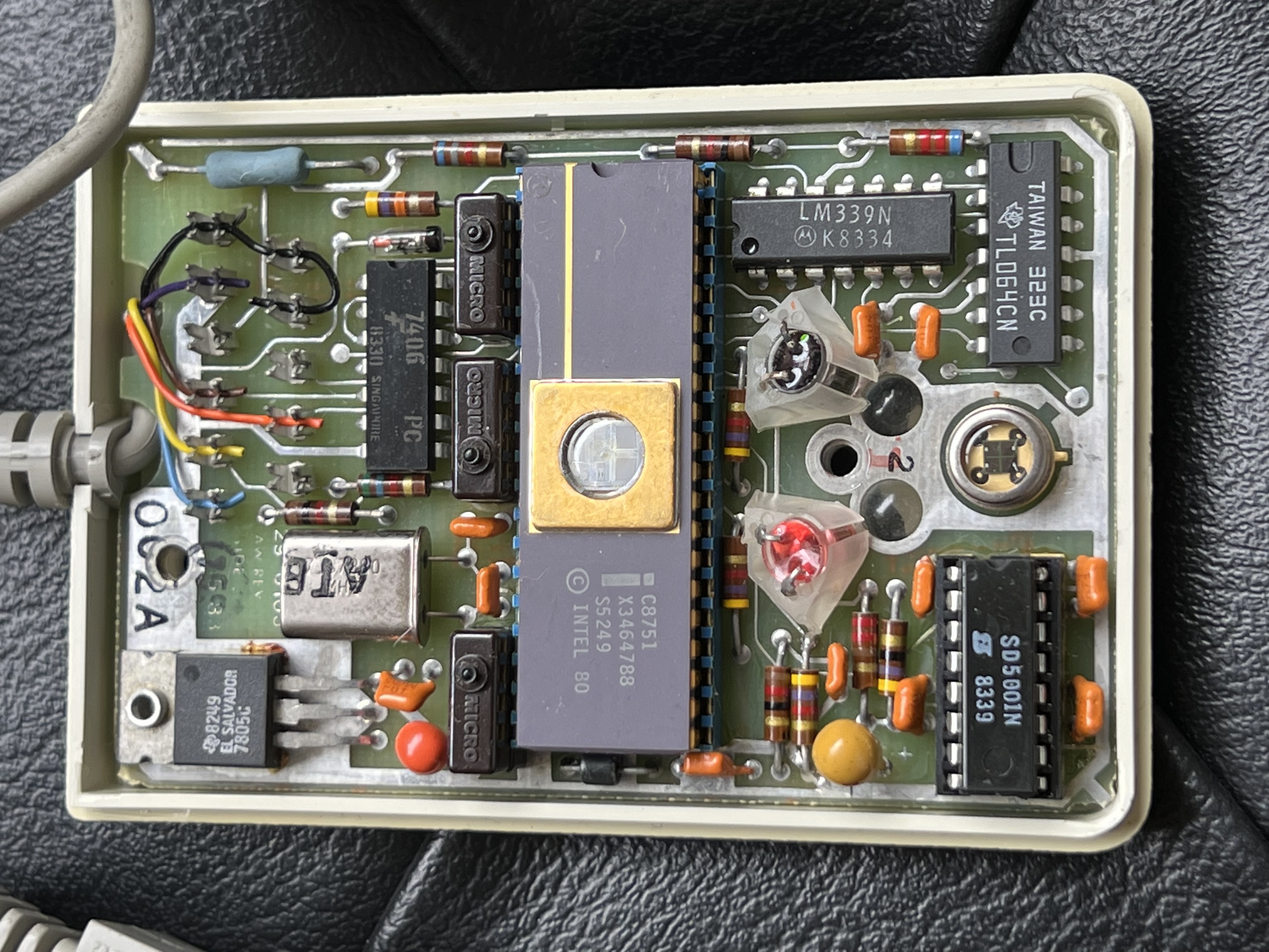

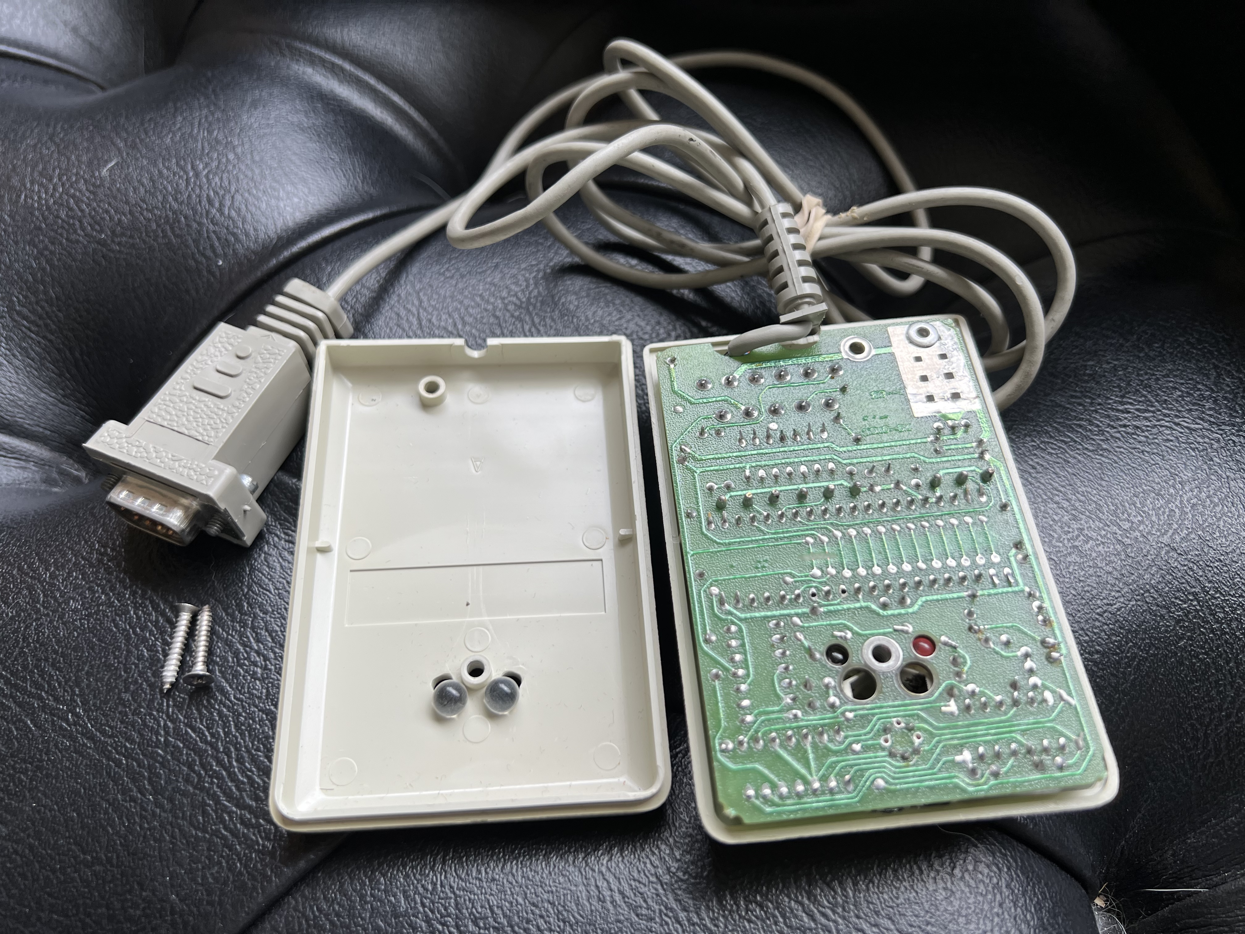

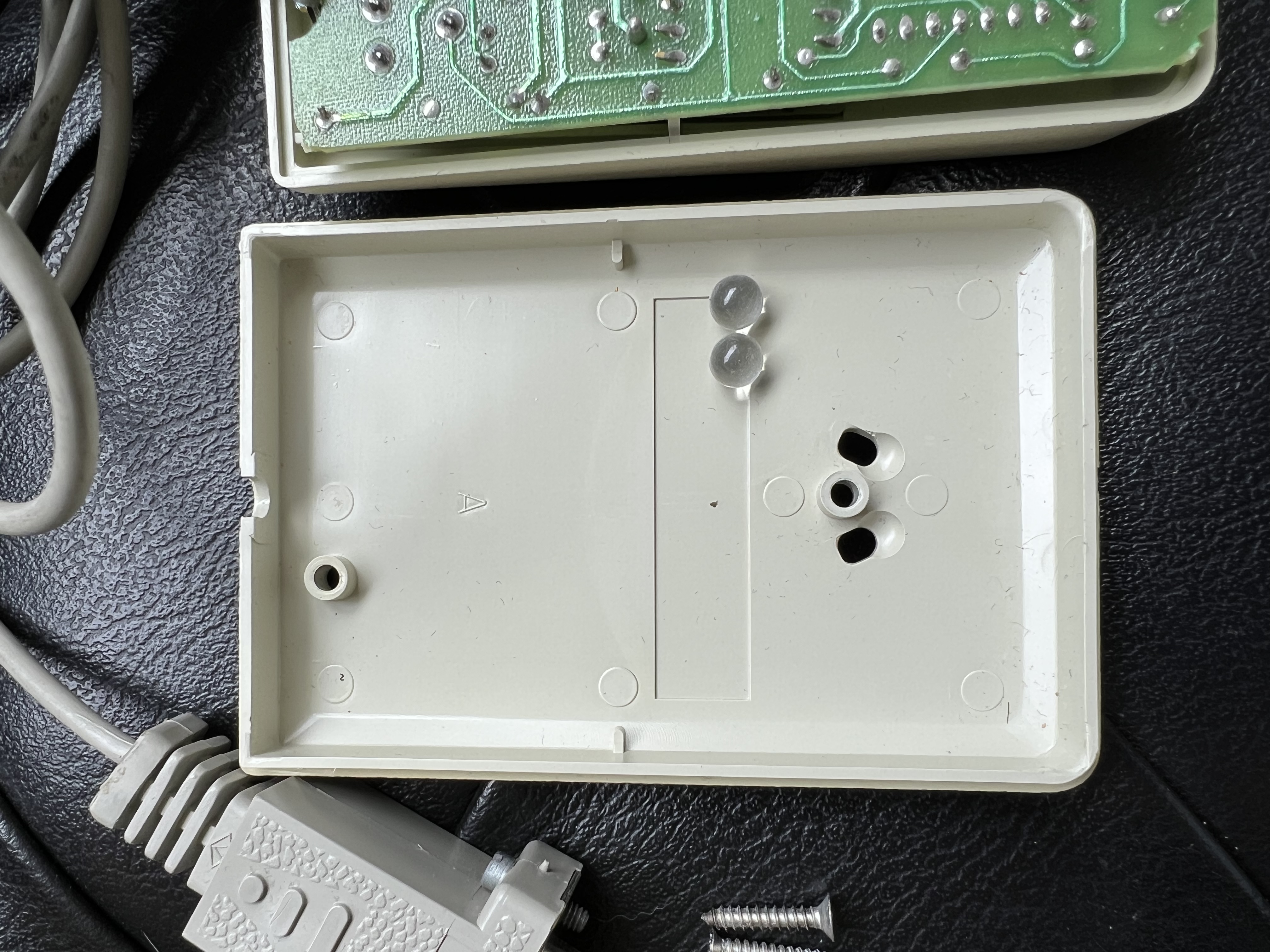

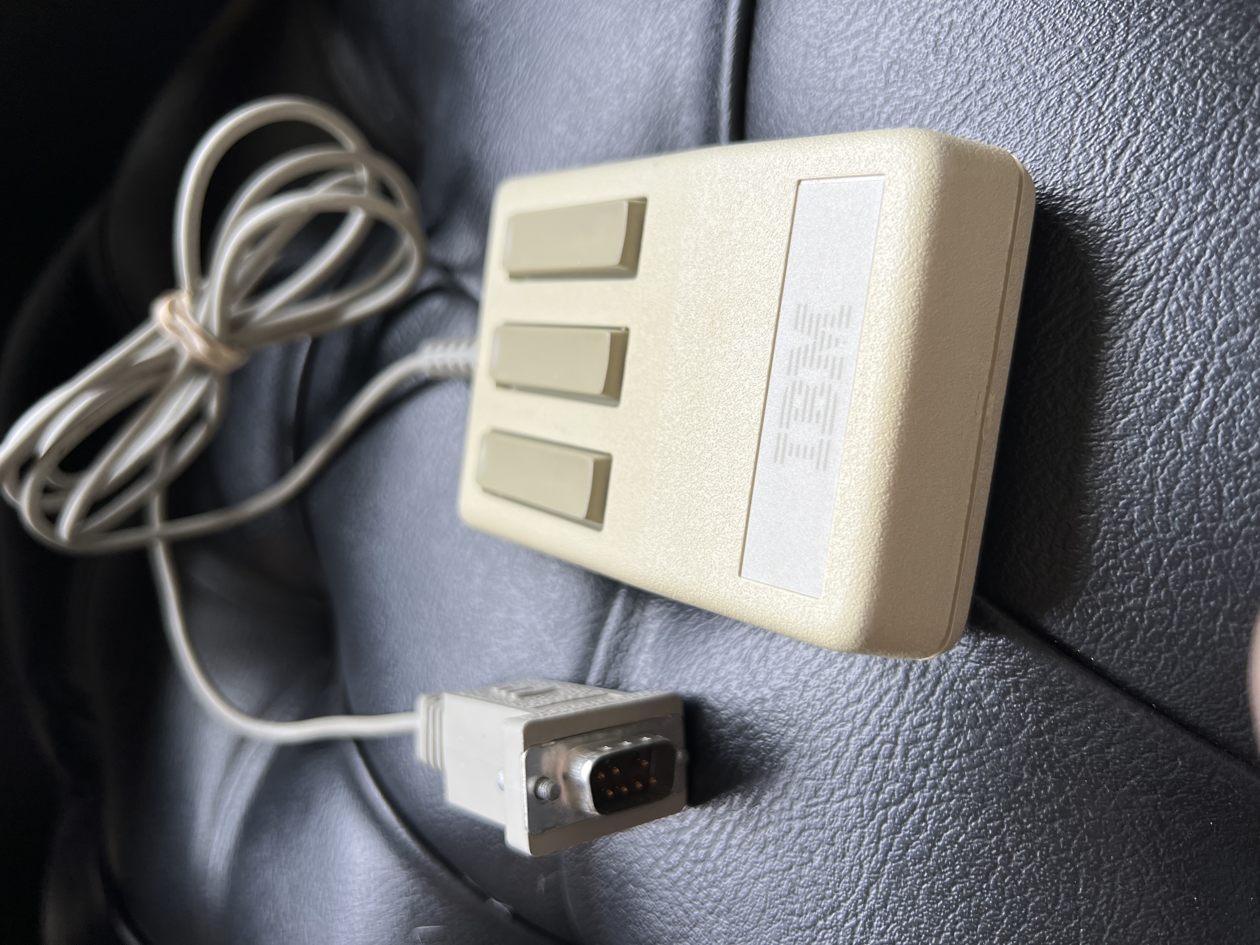

Ran across this on Friday in a recycling center, tangled up with some serial mice. I can't find any reference to this mouse on Google Images or the web, or its 9-pin female connector.
Edit: This was also placed on top of the Intel microcontroller.

24 May 2023, 22:19

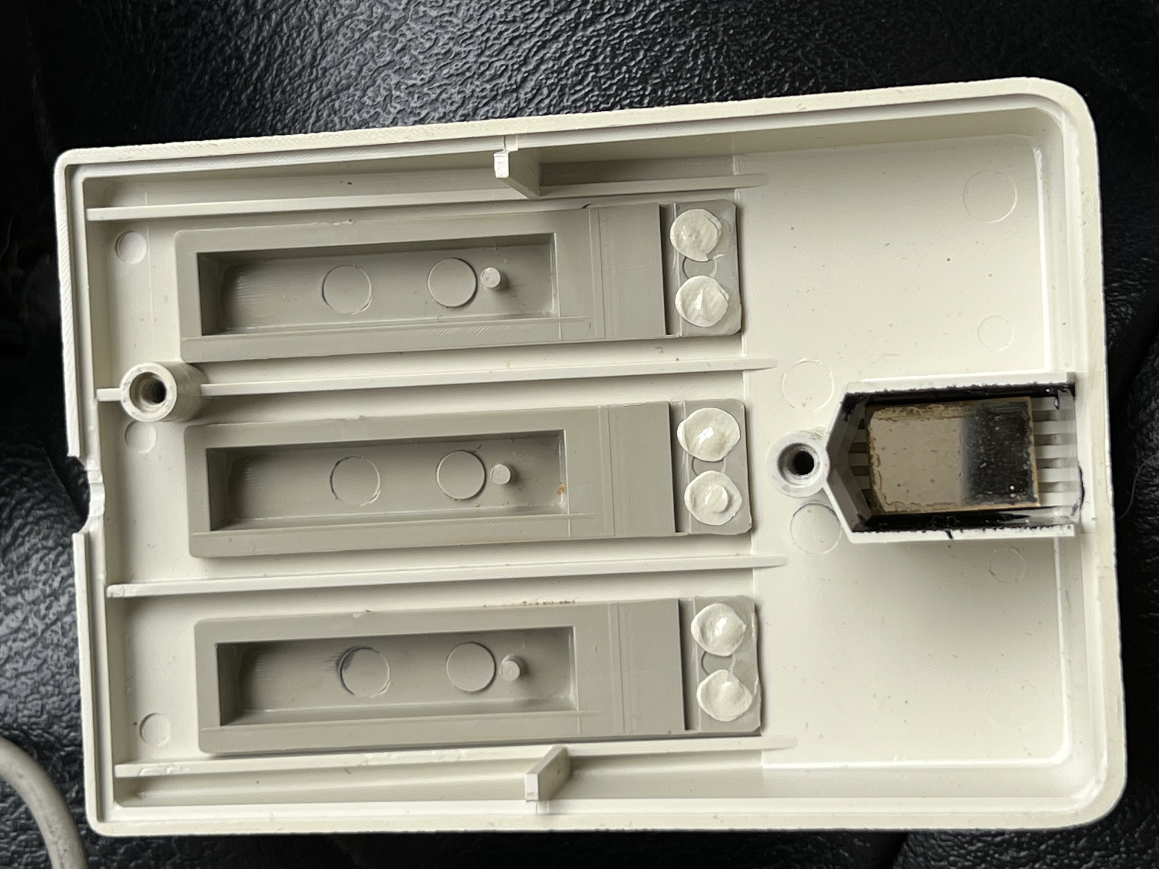

Yeah, they seem a lot alike! Looks like a similar optical mechanism, and the bottom is laid out almost identically. So is the slope. There's a longer sticker on the top with the IBM logo, the buttons are boxier, and it's textured like the older PC/XT/AT.
I do think it's serial, but female instead of male. I wonder where it plugged in? Maybe a special card? Maybe there's a male-male adapter that can be used to plug it into a com port.
That mousepad is interesting, does seem really strange. The way it's set up, I bet this one probably needs the same thing, which would be a little disappointing if I can't find one.

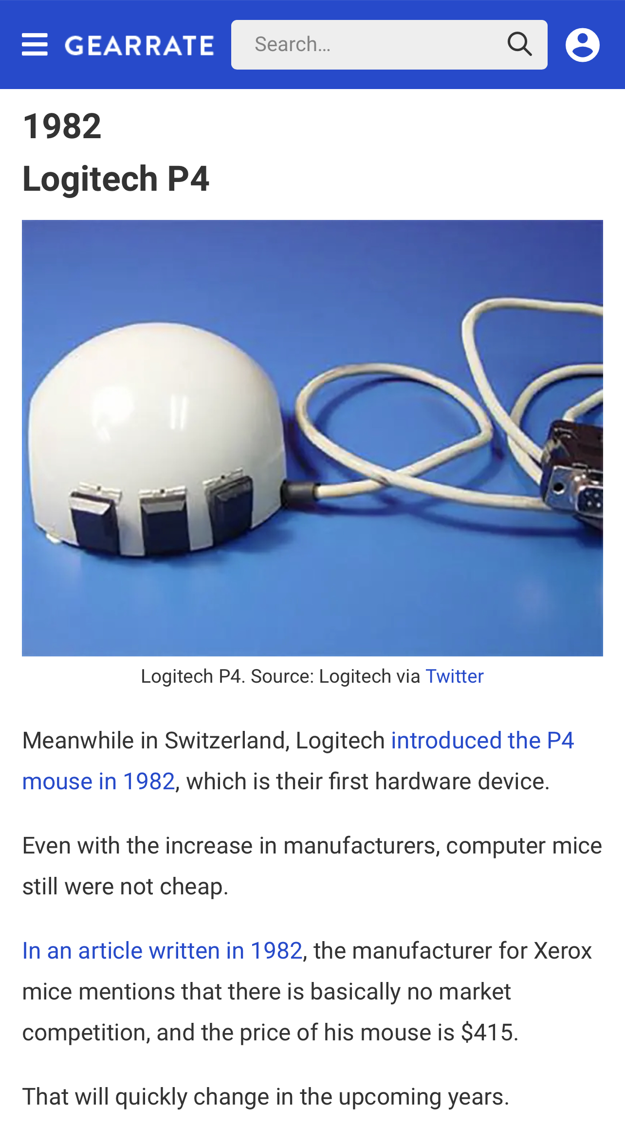

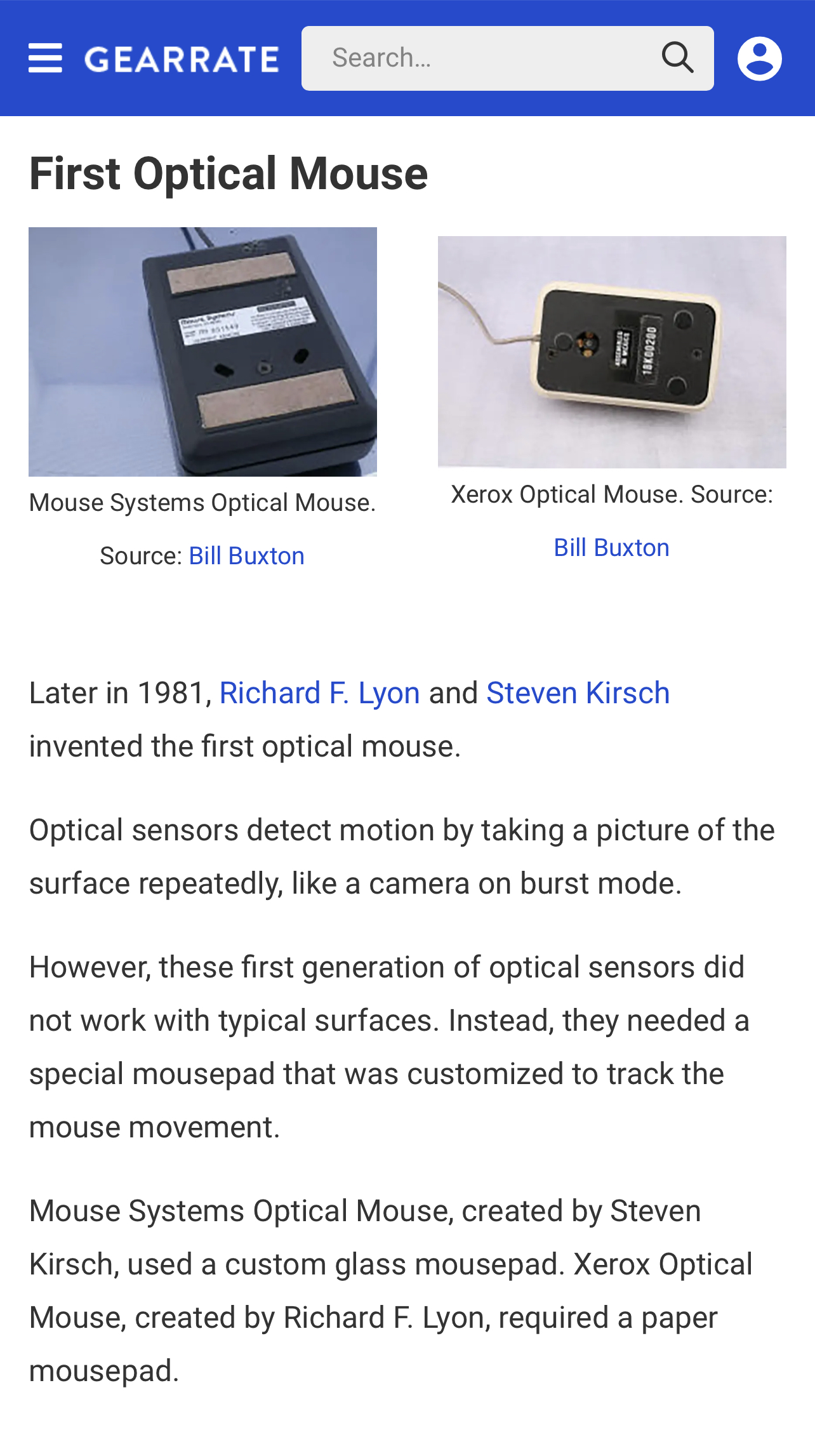

More findings: 1981 invention of the optical mouse, and a 1982 mouse with a female connector.
From: https://www.gearrate.com/en/mouse/history/

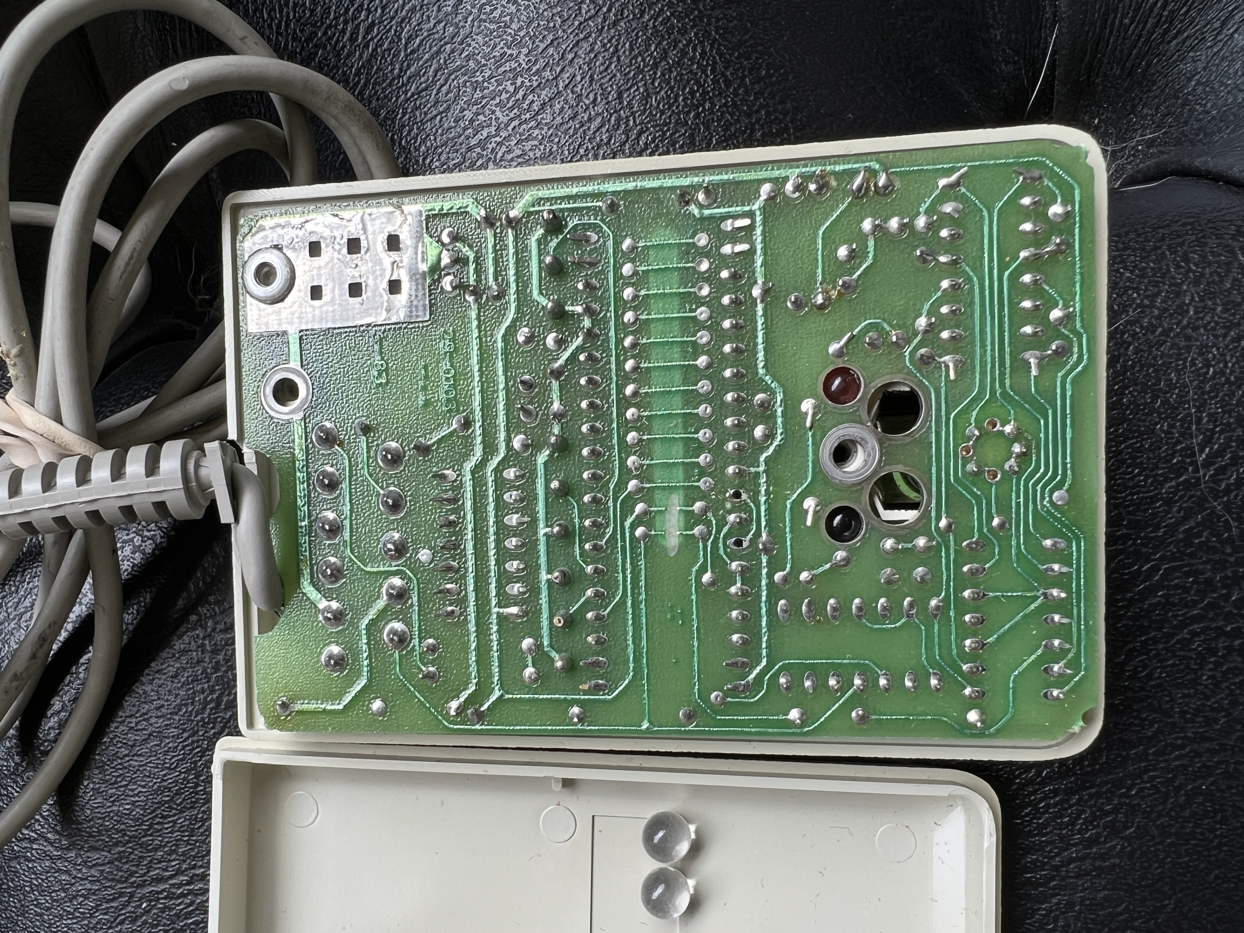

Here's a teardown of a Mouse Systems mouse. The electronics are completely different, but otherwise the inside looks much the same, with some mechanical differences.
http://kuzyatech.com/optical-mouse-the-old-way

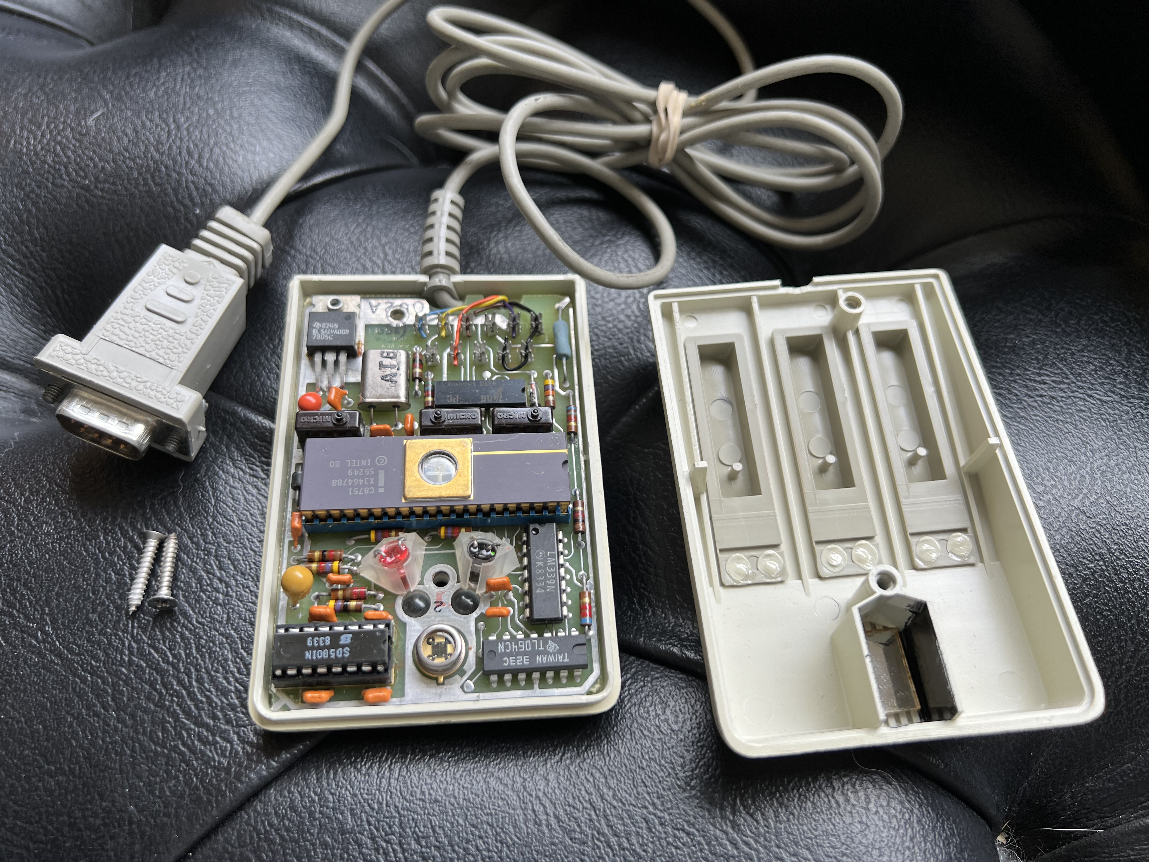

It appears to be an IBM 5277 Mouse (source 1, source 2). It's intended for IBM 3270 family colour/graphics terminals (3179-Gx, 3192-Gx0) and PC-based emulators (3270 PC AT/G and 3270 PC AT/GX). The earliest mention I can find on IBM's Offering Info portal is June 1984 at a price of $340 USD (around $1k today!). It was withdrawn in December 1997. It was made by Summargraphics for IBM.
Note the "7002" at the start of the barcode number? That coincidentally is the feature number for the IBM 3270 Personal Computer AT/GX Option Kit - a kit that allowed various optional hardware (including a 5277 mouse) to connect to an IBM 3270 PC AT/GX.

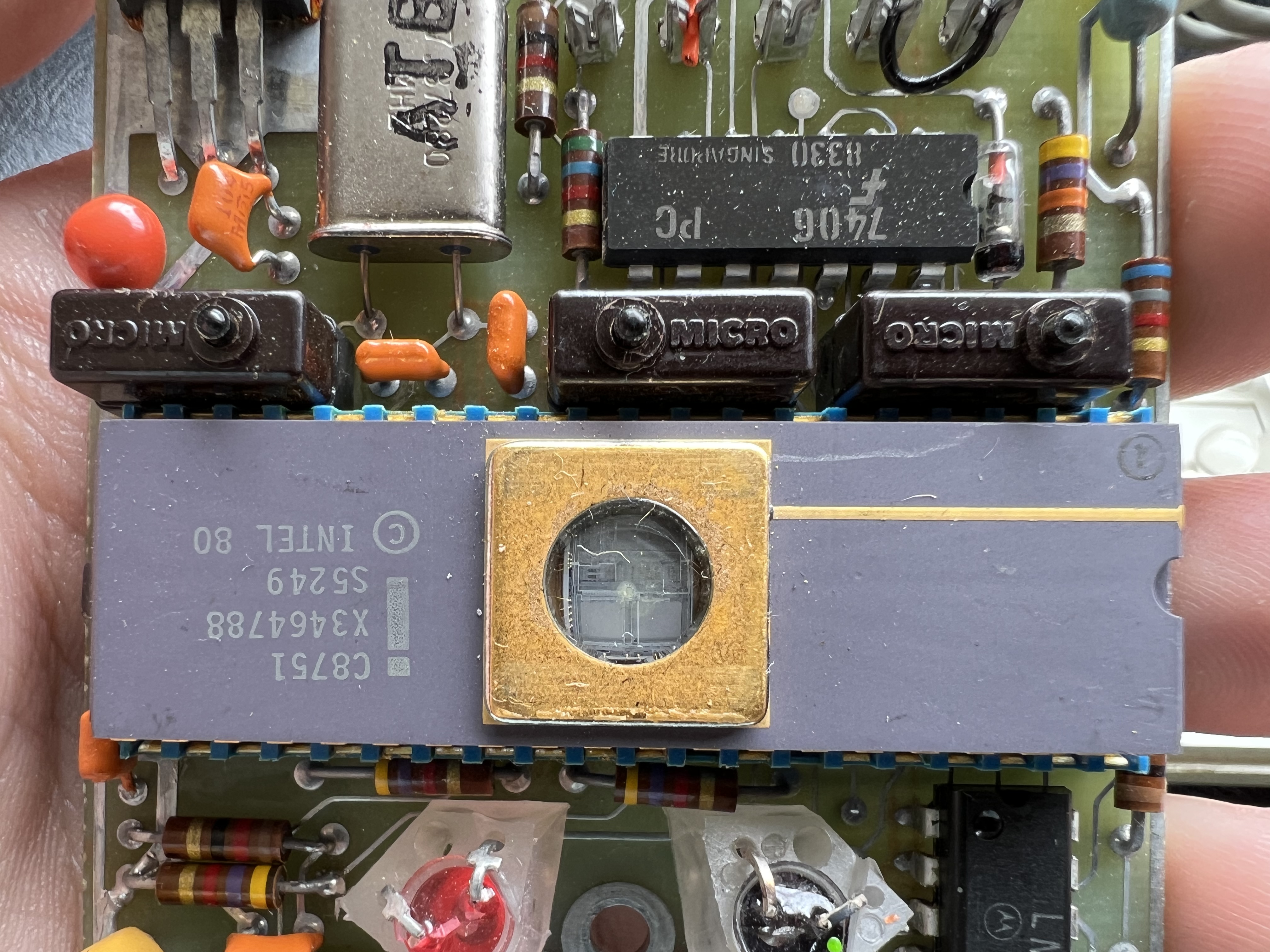

If you dismantle it again it might be a good idea to put a label over the EPROM window in the MCU - it'd be a shame for stray light to wipe the firmware.
