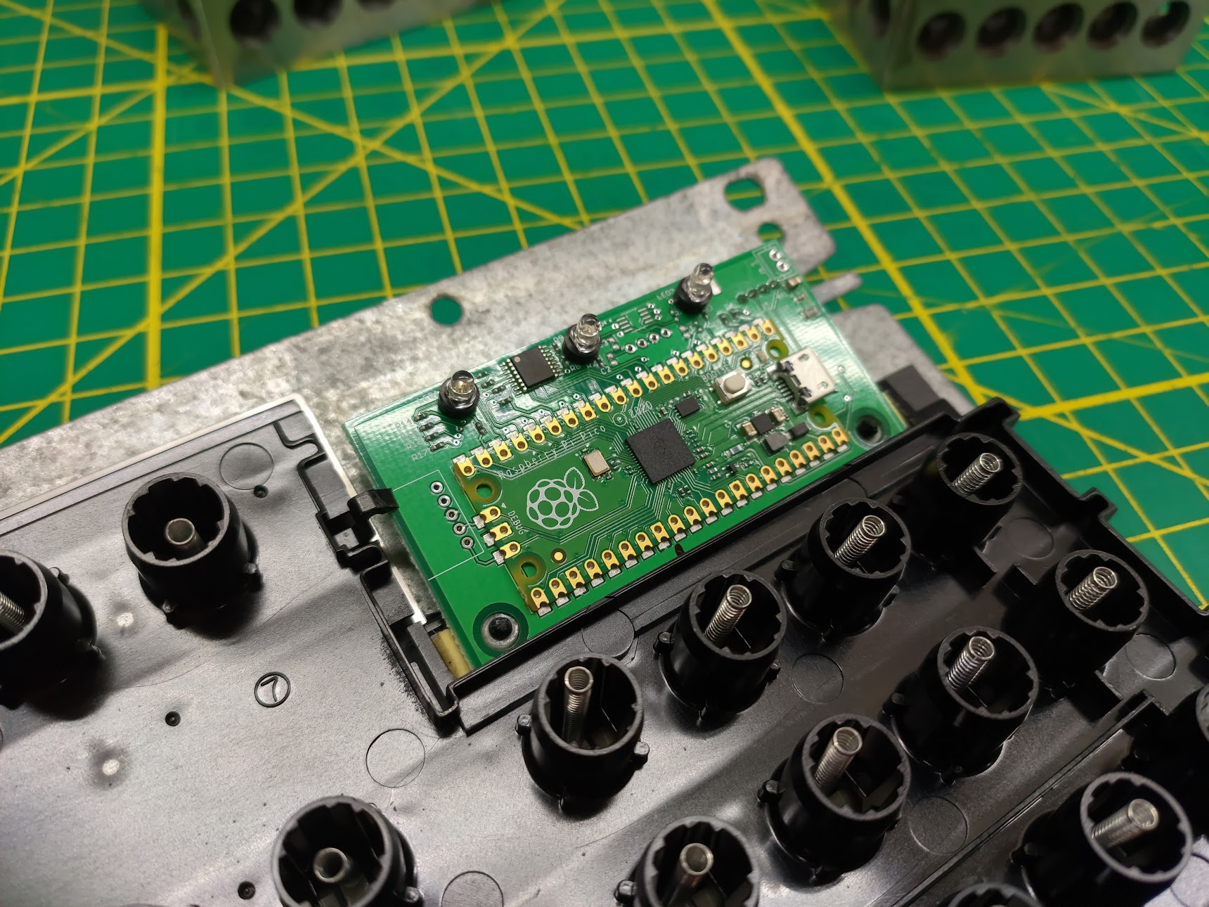

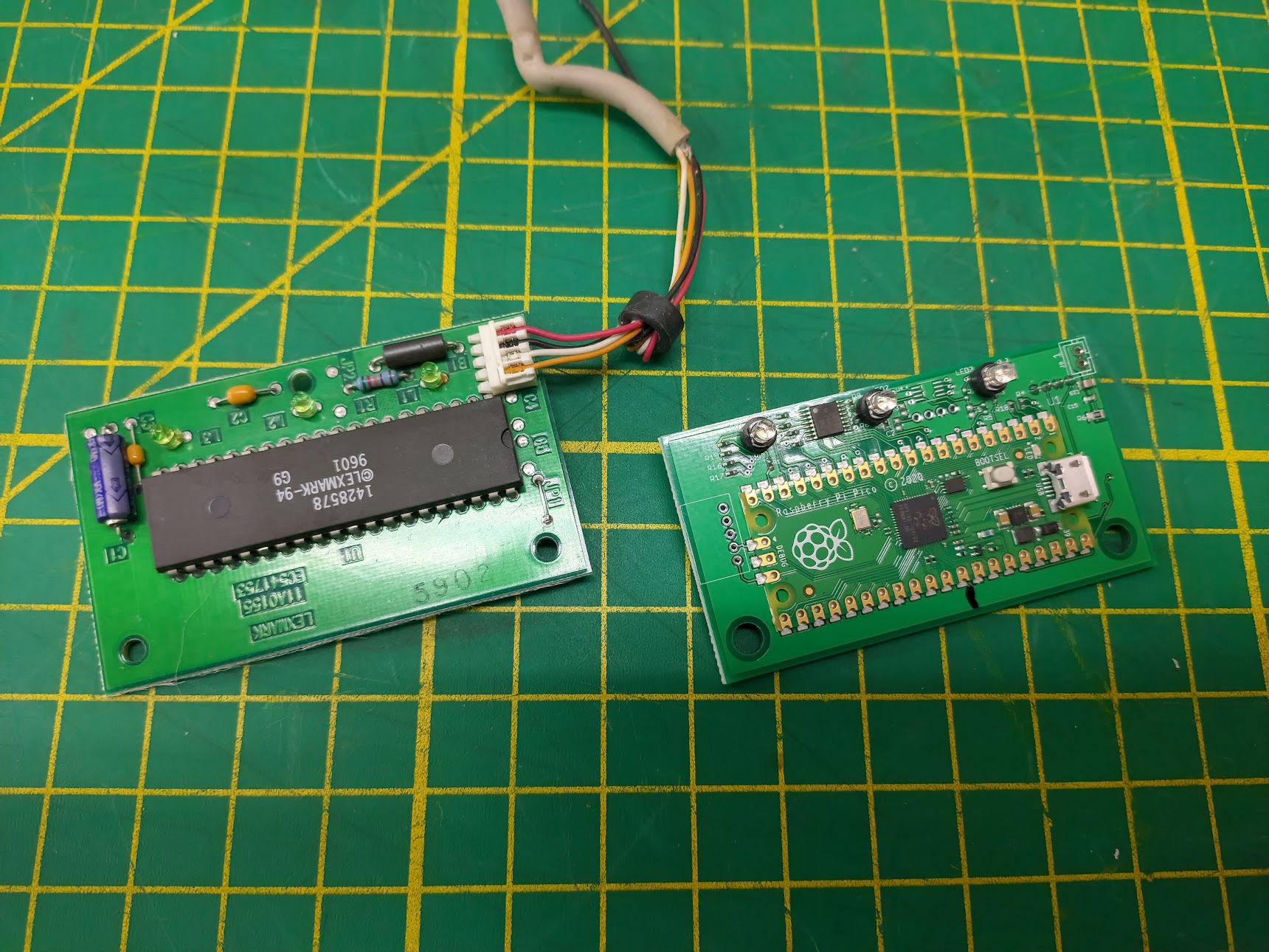

I was able to get the Unicomp Pico controller working with a 1996 Lexmark but it required a membrane swap and some 3D printed spacers. Both the pre and post 2013 Aristides firmwares didn't want to work with the old membrane. The board was in need of a deep clean and screw mod anyway so not an issue.
Controller was ordered via two $12 customization fees and specifying "Pi Pico controller card for the New Model M" in the notes field. To get the new membrane I ordered via this page and said it was for Keyboard P/N UN4944A. This order process could definitely be streamlined :roll: .
The spacers are just 3D printed cylinders with 3.2mm ID 4.3mm OD. They snugly fit over the pegs on the barrel plate and hold the membrane and PCB centered. The combo works fine with unicomp_classic_ultracl_post_2013_aristides_2862_vial.uf2 firmware.

I mentioned this in a Reddit thread that has gotten zero responses thus far, causing me to conclude that nobody else has yet tried this (which seems a little surprising?), buuuuuuut...
...contrary to Sharktastica's otherwise-excellent and very helpful write-up which suggests that these new "Aristides" controllers *should* essentially be drop-in replacements for any recent Unicomp models, I can get them to fit neither in a Classic from 2018, nor in an Ultra Classic from 2020. The issue is the thickness of the new Aristides PCB vs. the old Ruffian one: the Aristides is eeeeeever so slightly thicker, and it's too thick to fit between the bottom edge of the two screwhole posts and the top edge of the Numpad area of the barrel plate (above which the controller is supposed to sit)! So irritating!!
I can only conclude that they must have made this gap SLIGHTLY wider in the barrel plates they have been manufacturing ever since bringing the New Model M to the market. Either that, or I suppose they didn't even modify the barrel plate then, but did so only after the new controller was ready and shipping (in which case anybody trying to replace their old controller in New Model Ms that shipped prior to this year will still face the same problem)! I can think of no other explanation.
But the question that I have is: WHYYYYYY.
I haven't gotten around to it yet, but I think I'm going to be forced to file down either the bottom edges of the screw posts, or the bottom edge of the new controller's PCB right around the two screw holes. I'm somewhat nervous to do the latter, though, since I don't want to accidentally nick/cut into the ground plane...

The PCBs are thicker but they still fit. I also installed one in my 2014 GE Medical Unicomp. You just need to use a worrying amount of force and come in from the right angle.

jsheradin wrote: 04 Sep 2023, 01:16 The PCBs are thicker but they still fit. I also installed one in my 2014 GE Medical Unicomp. You just need to use a worrying amount of force and come in from the right angle.
I mean...I guess I can try yet again? But I've already tried a handful of times, and yes also changing up the angle of approach. I have even tried approaching the screw posts from the side, by sticking a corner of the PCB in between them and then sliding it over to the left or right. Nothing doing.
This was my experience as well. They fit, but something seems tighter. I tried 3 Unicomps (a 2019 Classic, a 2019 Ultra Classic and a 2020 New M) and it fitted them all.
NathanA wrote: 04 Sep 2023, 00:25 I can only conclude that they must have made this gap SLIGHTLY wider in the barrel plates they have been manufacturing ever since bringing the New Model M to the market. Either that, or I suppose they didn't even modify the barrel plate then, but did so only after the new controller was ready and shipping (in which case anybody trying to replace their old controller in New Model Ms that shipped prior to this year will still face the same problem)! I can think of no other explanation.
The New M used to use the same Ruffian controller as all their previous USB keyboards. Looking at this photo of an opened Ultra Classic and New M side by side (and when I looked IRL), the barrel plate appears to be the same. Only the metal backplate is different between those two (and the Classic). I don't see why they'd make new barrel plate moulds to suit a new controller when they could make a controller to suit the existing moulds. And whilst the fit is worryingly tight, I was able to fit the new controllers. It's unfortunate it's different (I'm guessing they used different PCB manufacturers with differing tolerances because IMO the difference wasn't immediately obvious to me), but one thing I found that made mounting easier was that on my 2019 Ultra Classic, I inserted the PCB into the barrel plate and got one of the screw holes lined up (the one closest to the keyboard edge seems to go in easier), pushed the PCB down and then just started screwing whilst holding the PCB. Eventually, the right side aligned and the fit seems to be successful since I'm typing on this "Aristides'd" Ultra Classic right now!
The guide is due a few updates, so I will include references to your experience (and a link to this thread) to help make future readers aware of the difficulties. The other planned changes include:
  • A section on how to identify if your recently made Unicomp keyboard has the new or old controller inside without having to open the keyboard (i.e., using USBDeview on Windows or lsusb on Linux)
  • Updated info on new Mini M controller not shipping worldwide
  • More info on ordering the new controllers separately from Unicomp
Thanks to feltel and jsheradin for your posts that helped me with updating the latter two points, I'll be sure to reference both of your posts when the update goes live.

sharktastica wrote: 10 Sep 2023, 01:09
[...] one thing I found that made mounting easier was that on my 2019 Ultra Classic, I inserted the PCB into the barrel plate and got one of the screw holes lined up (the one closest to the keyboard edge seems to go in easier), pushed the PCB down and then just started screwing whilst holding the PCB. Eventually, the right side aligned and the fit seems to be successful since I'm typing on this "Aristides'd" Ultra Classic right now!
I was eventually able to get one of my Aristides controllers into my Classic from 2018. But it was **NOT** easy. I just kept ramming the new controller PCB into each screw post on either side multiple times until it would manage to wedge itself in. In the end, I was actually left with multiple small black plastic shavings that were quite obviously sheared off of the bottom edges of the screw posts.
And even then, the fit was FAR from perfect. Unlike the outgoing Ruffian controller, I never was able to quite make it feel like the Aristides controller's two bottom holes were sitting perfectly "flat" on top of the two screw posts. Like you, I ended up just forcing the screws into the posts and tightening them down as hard as I could. This caused the controller to tilt back some, but it still sticks up at a slightly greater angle than the original controller, and thus the LEDs are uncomfortably bumping into the lock light cut-outs at the top of the chassis. Because of this, when closing the case, that right side would NOT lay flat naturally. I had to hold it down to screw the darn thing shut from the back with the hex screws.
The keyboard works perfectly fine and all keys register, so there is good contact being made between the membrane pads and the pads on the back of the controller. But the actual fit of the new controller inside the case is terrible.
I would love to actually see a full-size Unicomp board in person that was fitted with an Aristides controller from the factory, because I just can't believe that the fit is this naturally bad for all of them; if it is then the guys on the factory floor assembling these things must be going nuts. Or maybe the plastic molding for the barrel plate on my 2018 Classic is just slightly outside of expected tolerances, or something.
I'm going to try my 2020 Ultra Classic next, but the last time I tried, it was JUST as resistant to having the Aristides installed into it as my 2018 Classic was, so I expect it's going to be a very similar story. Perhaps I will pre-empt the hard part by taking a knife blade and scraping away some of the plastic on the bottom of the two screw posts before trying to force it in...
sharktastica wrote: 10 Sep 2023, 01:09(I'm guessing they used different PCB manufacturers with differing tolerances because IMO the difference wasn't immediately obvious to me)
I'm wondering if the new controller PCB has more layers than the old one does, which would have necessitated an increase in thickness? Either that, or they just plain messed up on the order & ordered the wrong thickness.
I also halfway wonder if they made an initial order with the wrong thickness, discovered the issue, and this has been corrected on future batches. And they might possibly be using thinner boards on their own production line by this point. But they perhaps still have older stock from their initial order kicking around, and are fulfilling the orders they're getting from their own customers for loose controller boards from that stock... :|
